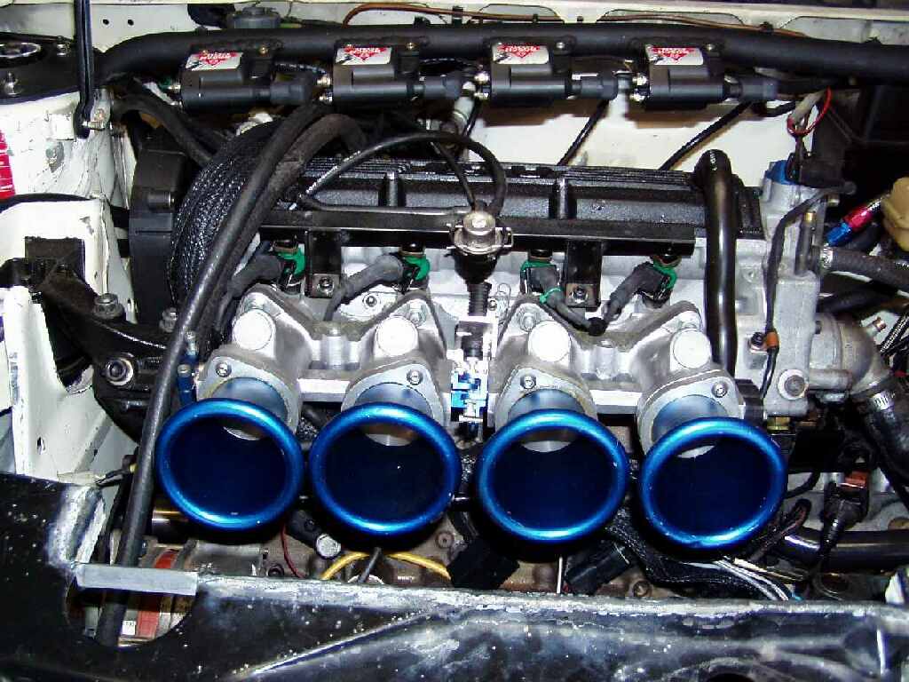

This is the 2L race engine I've been building for the past two years. I finally fired it up briefly to run the cams in, then I'll run it in on the dyno after I've finished the air box. I doubt it's going to crack 239hp like Colin's however, in it's current spec.! If it pulls through 210 I'll be more than happy as it currently has a hydraulic head, limited to 7500. After this coming season I'll put the big solid head on and lift the limit. For the tech heads, here's the spec.:
2L block
nitrided 86mm crank
forged pistons, 11.8:1
big valve 1.9L head
48mm TB's
GTi6 extractors
Autronic ECU
M&W CDI

Looking good Peter, I like the coil packs! I'll look forward to seeing how it does.

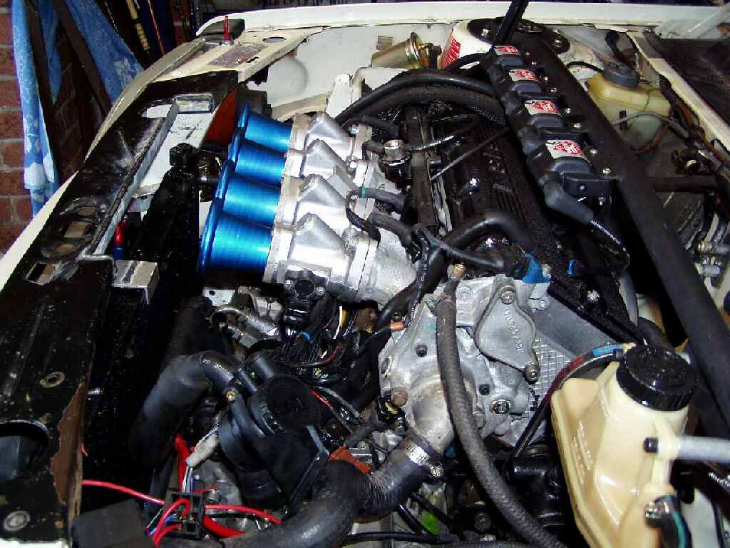

in the first pic the engine looks to be dropping on the near side ? If you compare it to the strut brace.
I like the way you have mounted the coil packs, i'll have to let des know about that to see if he can do the same with my v8 coil packs :D
Sexy trumpets, am hoping to get mine anozised along with my spacers very soon for the same tarty effect :D
What's a M&W CDI ?
I've checked the engine with a spirit level. The gearbox mount is adjustable. The strut brace is highest in the middle of the car. M&W are local manufacturers of the Rolls Royce of ignition systems. They supply to Motec. I have a Pro-14, a four channel unit, fed from the four ignition outputs out of the Autronic ECU.

:( looks lush, what bodys are they?
david932
what are these like then price wise compared to the other manufacturers? are all body pretty much the same with a different brand name or are some better than other?
They're approx. AUS$550 each from memory and ram tubes $60 each. Much the same as any quality TB. The best ones have roller bearings on the spindles.

cheers. i am debating a tb setup but all i ever seem to see is jenvy set ups, altho im aware theres quite a few other manufacturers. are 48mm made for top end power or do they have much low down or mid range grunt?

Are the TBs and the intake manifold tapered in the same way as the trumpets?
The bores of the TB's are parallel at 48mm, then the inlet manifold tapers from 48 to 42 (I think) at the head face.
