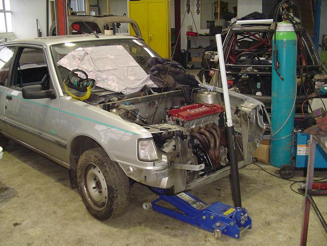

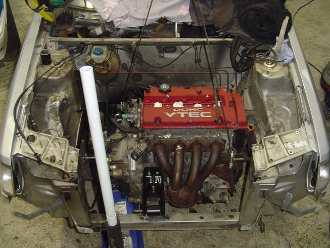

My 309 Trio project is well under way and I thought i'd tease you with some early pics:
johnrobertgordon
4000 rpm madness. The engine is such a neet little lump, looks tiny in the 309.
Sandy
It's a surprisingly good fit and the only cutting required was to improve the location, it isn't strictly necessary. I want this car to handle to my liking too!

It's the 2.2 H22A7 from a 1999 Accord Type-R. It's old school on/off VTEC like the DC2 engine. We're also putting a K20A i-VTEC in my friend's 309 at the moment and the S2000 RWD 309 is well under way too. I was dead lucky and picked up a set of ex-BTCC direct to head bodies for mine, which are a straight fit!
