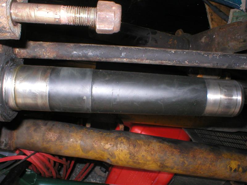

Would fit these shafts back on?
I bought the beam as recon'd by someone before it was sold to the guy I got it from.
By the looks of it, it had been refurb'd but quite badly as there was no metal cup on the base of the shaft on one side. The trailing arm movements ate the cross member seal and water infiltrated and washed away the grease around the first bearing.

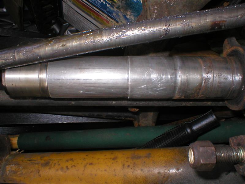

No, they are beyond being used again imo.
One looks to have some kind of a machined sleeve on & the other has bearing imprints from the inner bearing surface which I've never seen before.
Graham.
futura
damn it I paid £170 for that beam, which I thought was good! :P
That first shaft looks U/S with damage around the outer bearing. That shaft was clearly replaced as part of the recon, but without the outer cup fitted on the shaft it was never going to seal properly on the seal and premature failure was inevitable :P
The second shaft it's hard to tell from the photo - if the inner bearing area is just polished then it'll be fine, whereas if it's pitted then it's U/S
futura
The shaft from the second photo is only polished not pitted, at least that would be a small consolation if I could re-use it.
