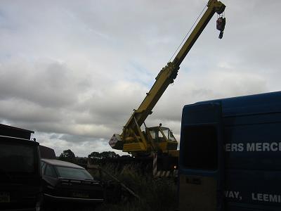

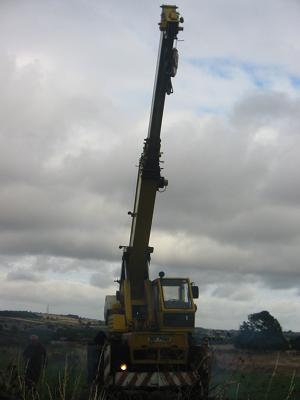

Glad I'm not the only weirdo not to use a hoist!
my mate forgot his hoist when we went to collect a 2.0 8v turbo engine, lucky this bad boy was there :D
