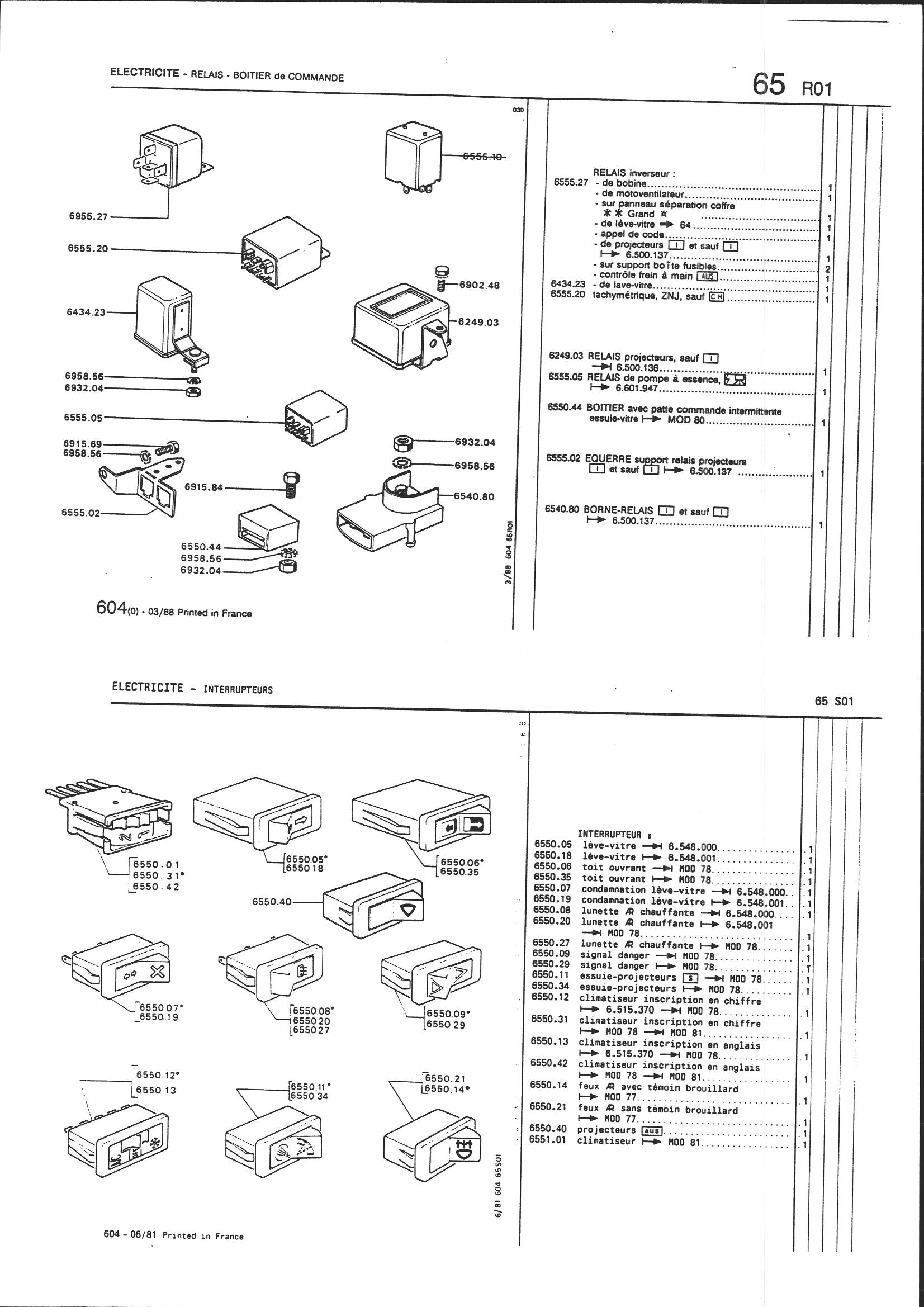

You better know what you're looking for and even then it's tricky. Part number is 1452.05 so starting with 1 it should be in group 1 "ENGINE EQUIPMENT"... but it's not. Maybe it was on another car parts catalog but on the 205 catalog it ended up in group 6:
https://www.miamistu.co.uk/pug/GB/205F/6/65Q01A.HTM
https://www.miamistu.co.uk/pug/GB/205N/6/65Q01A.HTM
"RELAY" what kind of relay? Who knows. It's a bit better for the 309 catalog:
https://www.miamistu.co.uk/pug/GB/309F/6/65Q01A.HTM
But what about the drawing? Well it's the previous kind of tach relay (1452.10) with another form factor and connector, even better on the 309 catalog because on this car it was never used.

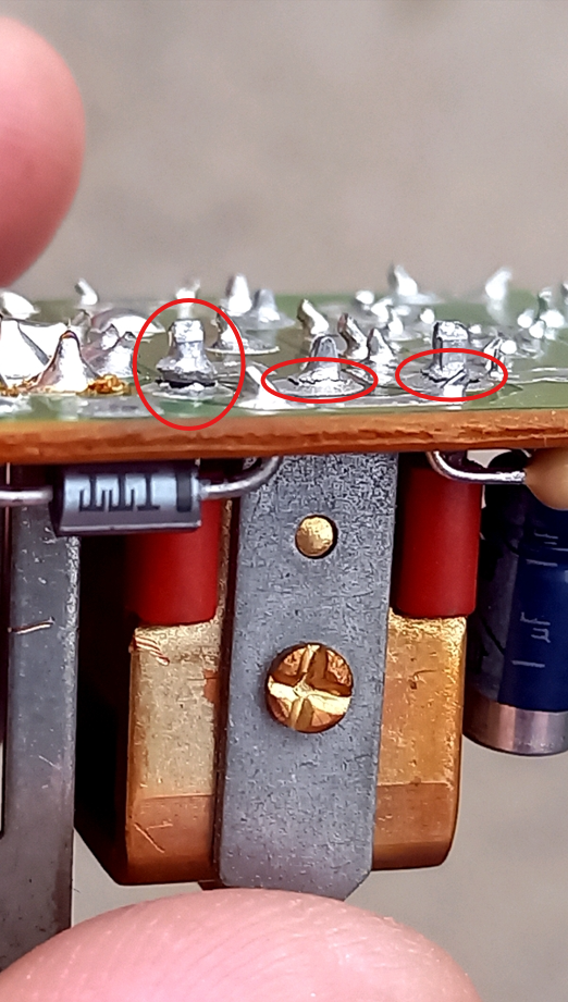

It looks like I can repair the faulty one.

DamirGTI
Certainly !
That's an easy one , and common issue .
Just heat up and add some more solder and will be good .
Check if there's cracked diodes , and that the wire from the relay coil to the terminal isnt split .
