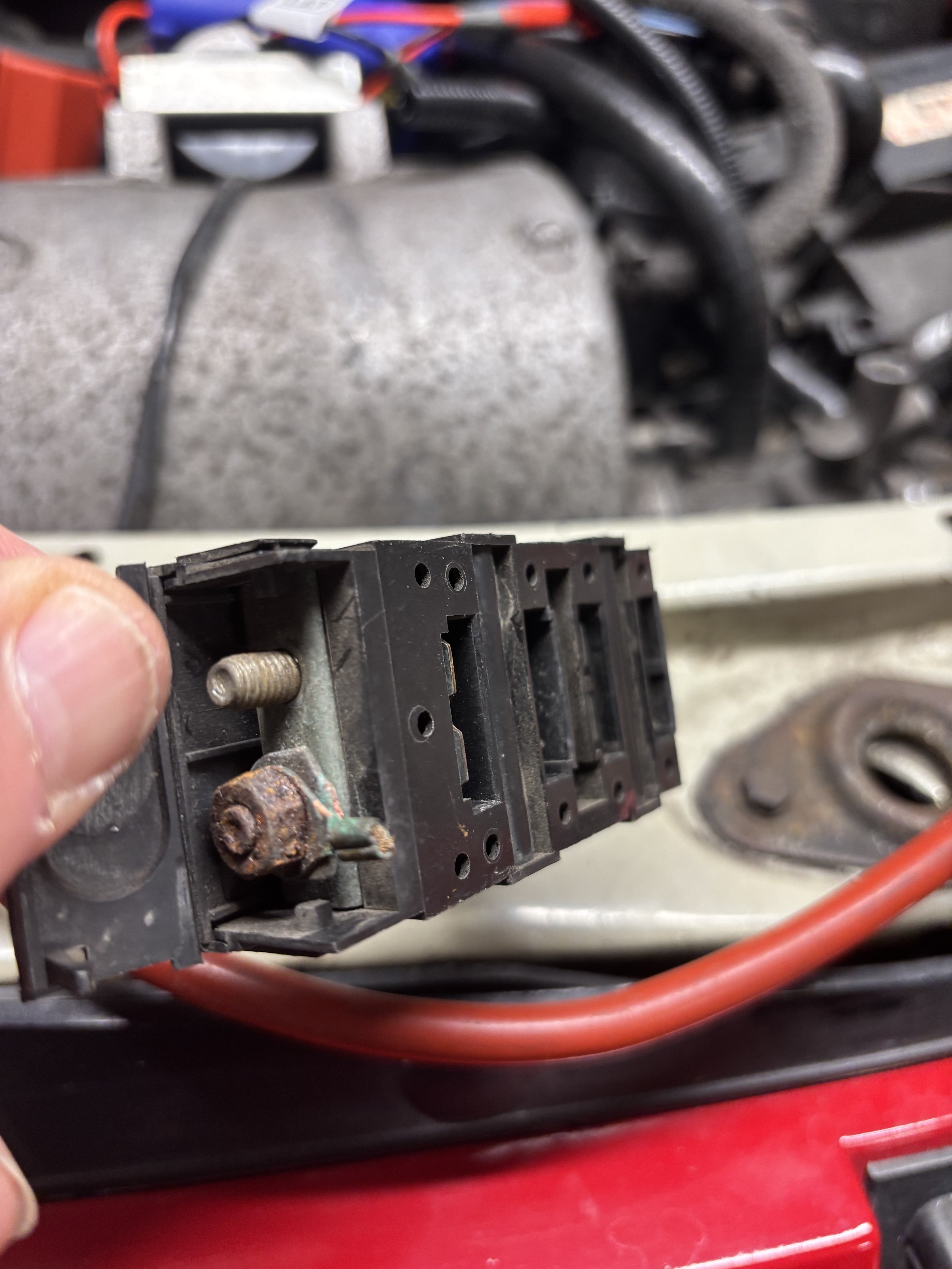

fuse in shunt overheating then blowing taken it out and only thing that look dubious is a wire missing from the end !!! Can’t find anything to attach it to . See attached picture, anyone know what should go here ?
that is the yellow wire that should be feeding to the battery positive terminal, without that the car will have no 12v power at all, only the battery starter and alternator will get power
