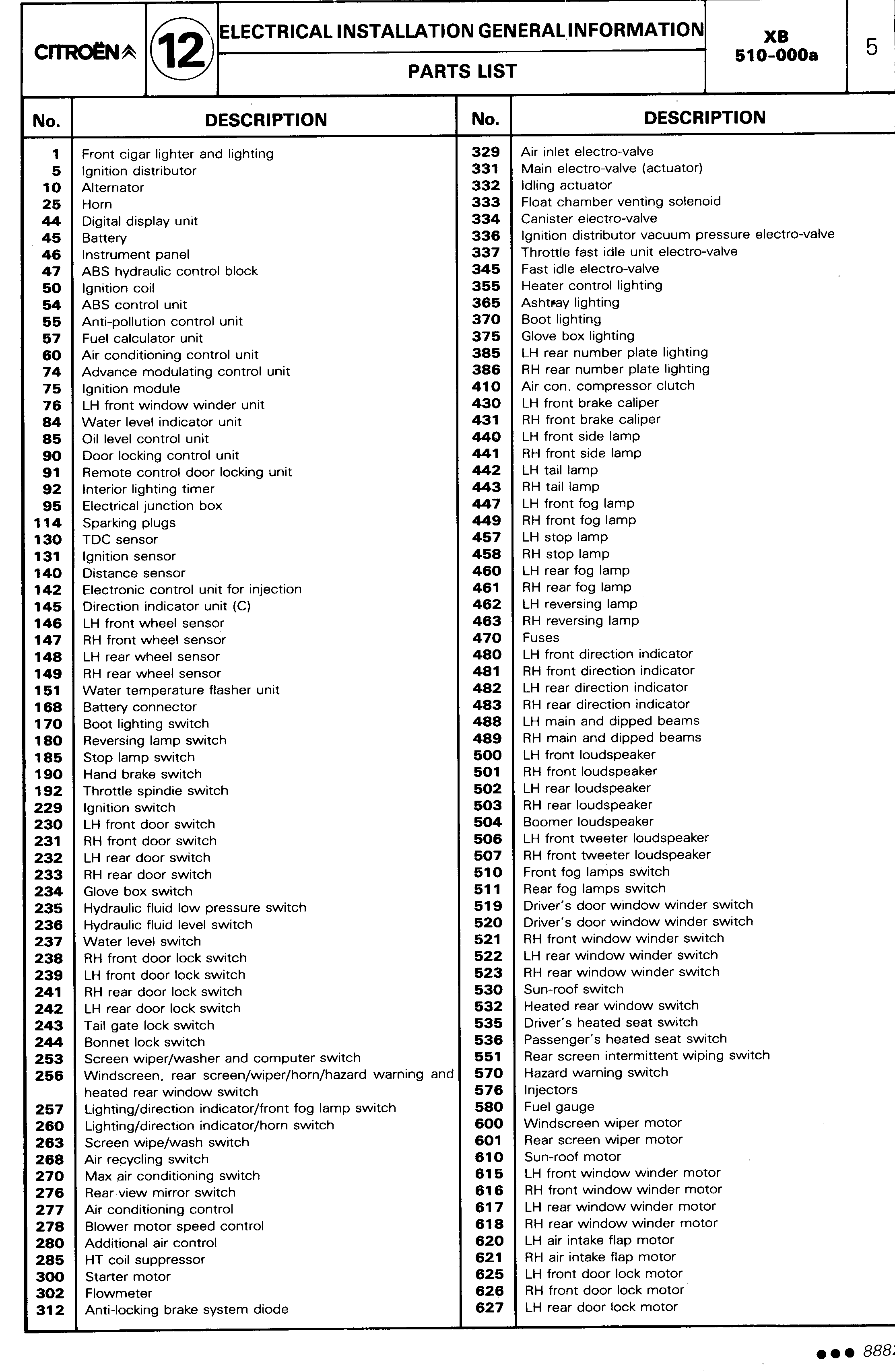

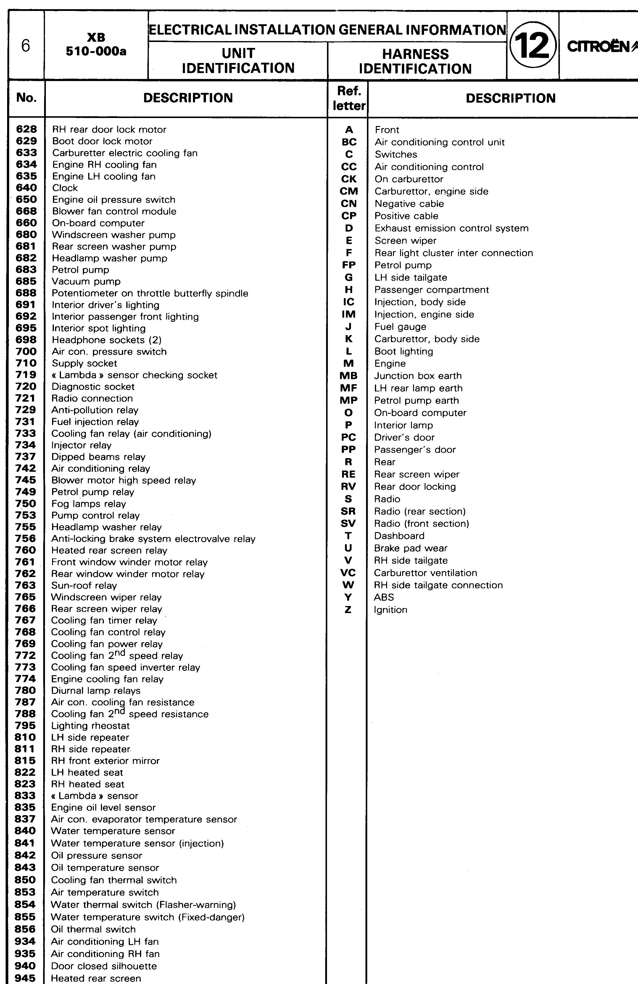

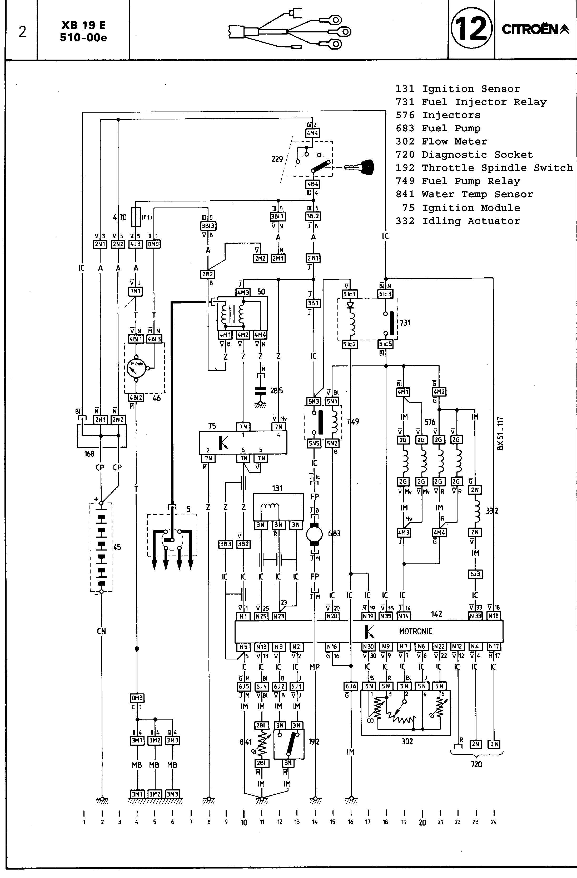

SRDT 255 Posted April 12, 2025 Here is a 35 pin ML4.1 Motronic diagram: 1 Share this post Link to post Share on other sites
Omorgan 2 1 Cars Posted April 12, 2025 Thank you @SRDT, Do you have a key for the photo? I don't know what Item 285 is from the coil. It appears to be a ground, however that disagrees with the markings on the top of my coil so I'm unsure. The rest of the diagram has been spot on so far, really helpful! Thank you. Share this post Link to post Share on other sites
welshpug 1,737 Posted April 12, 2025 (edited) Pin 4 on the coil going to component 285 is just a connection for a suppressor, the black female spade. Never actually seen one connected there. The cut wire is not on the diagrams, so i have no idea what that's for. Edited April 12, 2025 by welshpug 1 Share this post Link to post Share on other sites

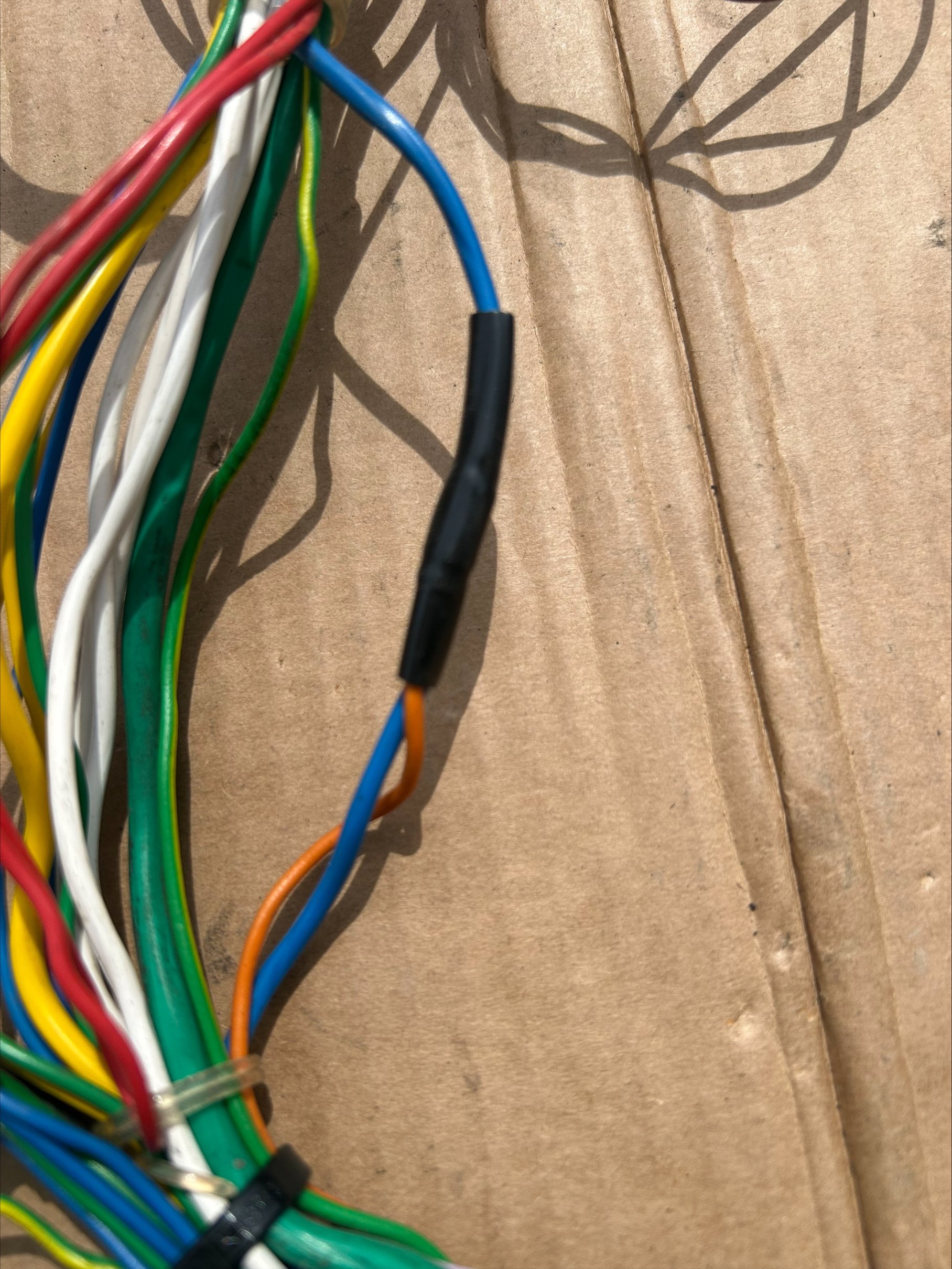

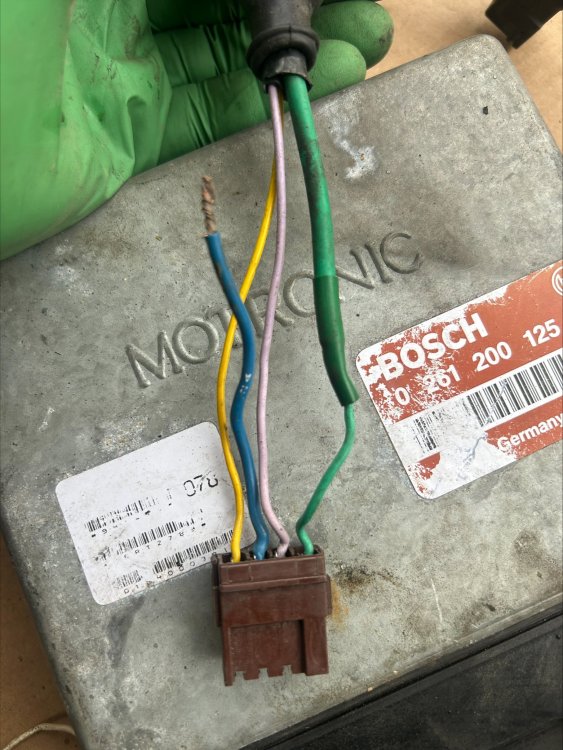

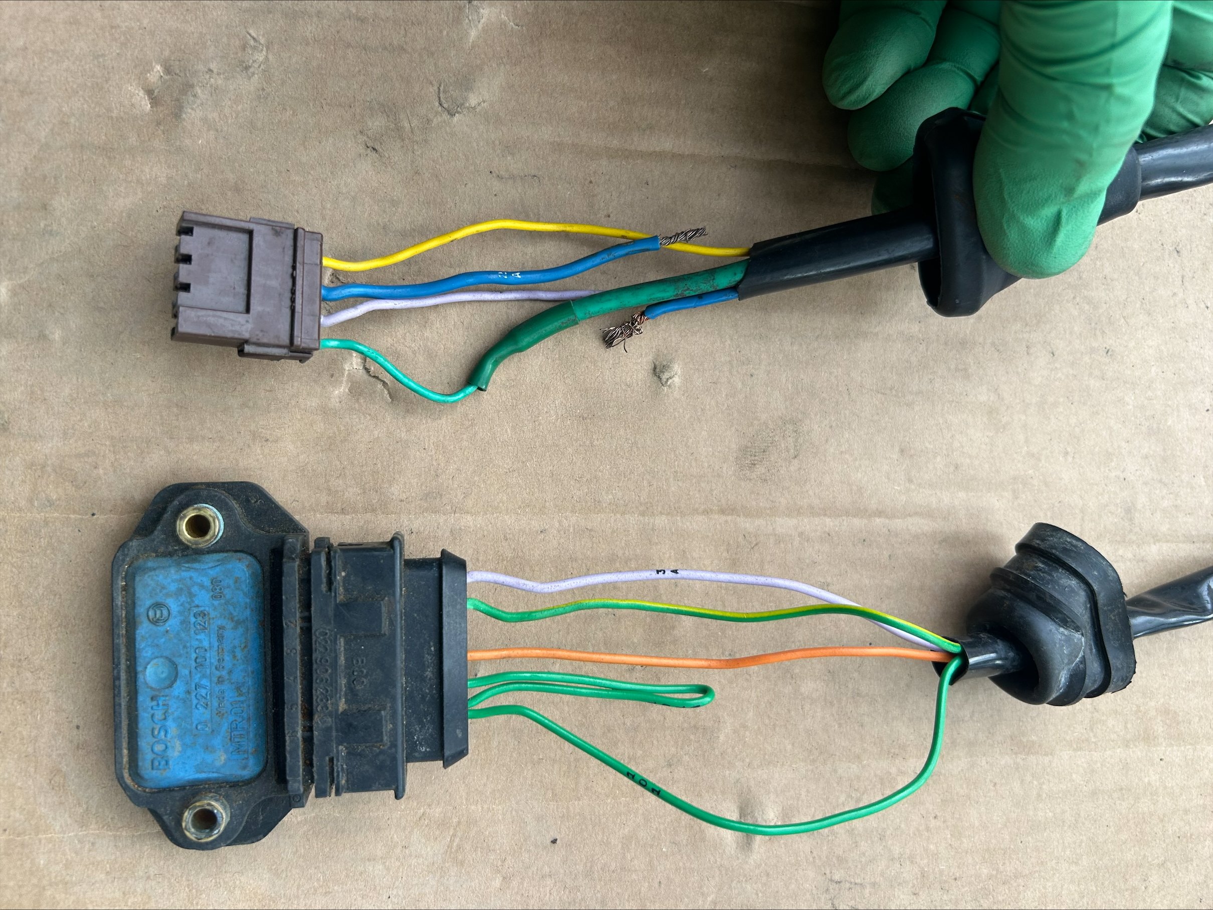

hoodygoodwood 78 3 Cars Posted April 17, 2025 I am doing a similar thing to you by stripping my loom back and removing unwanted wires and making one or two repairs before i fit it to my 309 , it was taken out of a 1989 405 Mi16 at the same time as the engine and box etc and i would say it has been cut where it goes through the bulkhead . ECU is 0 261 200 125 and AFM is 0 280 202 202 . The picture shows my 4 way coil plug , the blue wire ( no 2 ) was cut to tee in an imobiliser . Green i believe powers the rev counter and i think would be no 112 in the Haynes wiring diagram . The 2 other wires may be 3A and 2C , i will try to check these . 1 Share this post Link to post Share on other sites

hoodygoodwood 78 3 Cars Posted April 18, 2025 These are my coil and ignition amp plugs , i have not removed or moved any of the contacts just stripped off the black tape and black tubing . Starting from the top on the coil plug - position 1 to 4 , then ignition amp plug - position A to G . Position 1 - yellow 32 - to brown injection relay Pos 2 - blue 2A - positive supply - joins orange wire in loom bundle - see 2nd pic . Pos 3 - lilac 3A - wire goes direct to ignition amp point A . Pos 4 - green - to revcounter ? via some connections/shielding Position A - lilac 3A - direct to coil plug . Pos B - earth M3 - to shielding on rev counter wire . Pos C - no wire - blank . Pos D - orange 2B - to joint with blue wire 2A - see 2nd pic . Pos E - green 101 - looped to position F . pos F - green 101A - to ECU . Pos G - no wire - blank . 1 Share this post Link to post Share on other sites
Omorgan 2 1 Cars Posted April 18, 2025 Thank you for taking your time to do that that mate, you have no idea how helpful it is to be able to compare without looking at diagrams over and over. Would you please be able to tell me which position on the brown relay the yellow wire goes to please? Mines not connected at all. Also, does the blue wire 2A (and orange) go to the ignition barrel? I assume thats the switched live supply to the coil. Again, thank you. Share this post Link to post Share on other sites

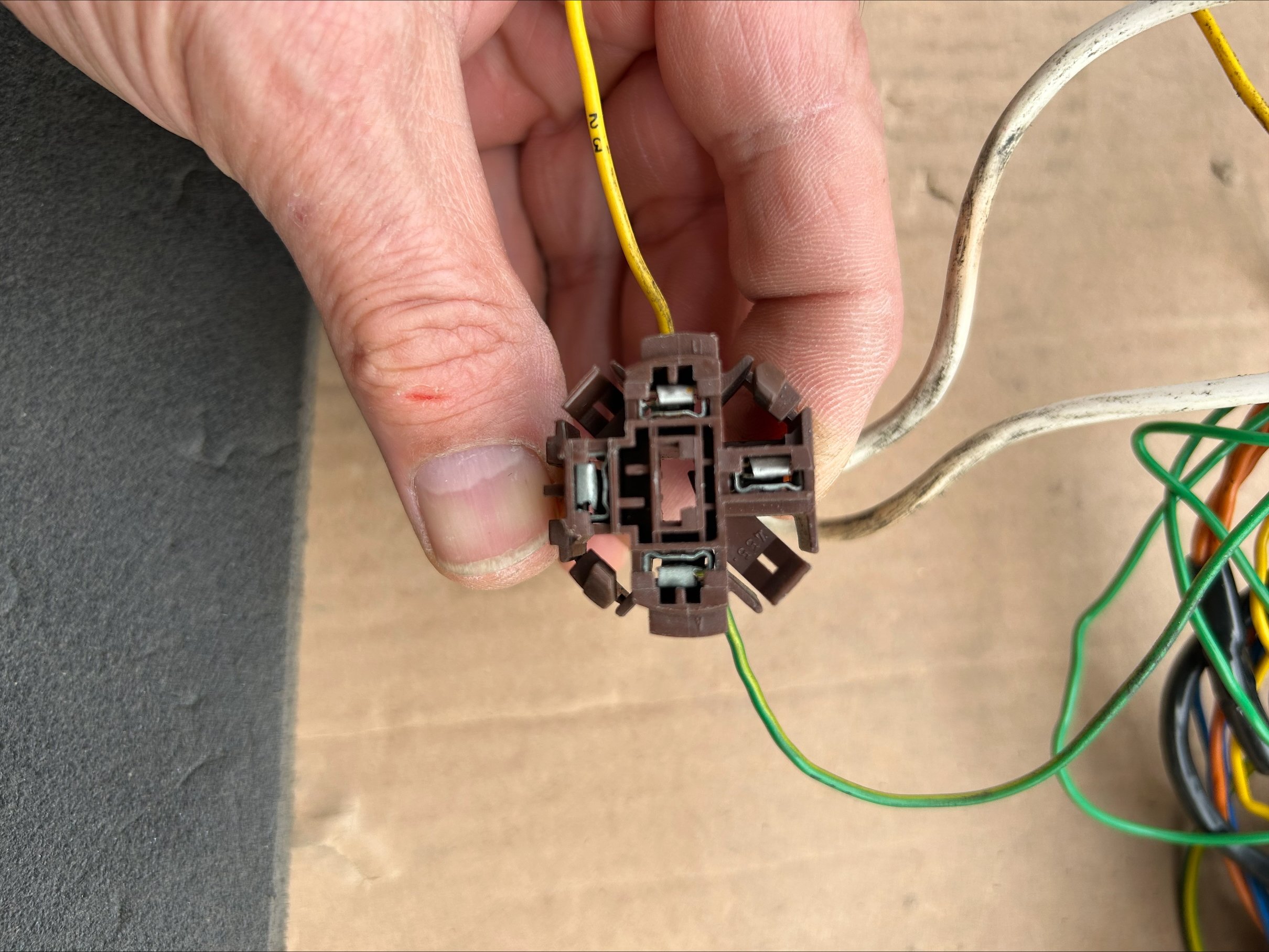

hoodygoodwood 78 3 Cars Posted April 18, 2025 I am working from the same page of a Peugeot 405 Haynes manual as you are , its been helpful but laying the loom out and tracing every wire is the best way . I have removed everything not directly related to running the engine and its going to be modified to fit the Mi16 and engine bay once its in the 309 , all the connections coming from sensors etc into the ECU i am happy with but its going to take some research to sort out the wires going into the car as the loom was cut ( i would guess ) where it goes through the bulkhead . The blue wire 2A does go into the car , according to the Haynes diagram it turns into 2 then 32 where it goes into the ignition switch . The yellow wire goes into the brown relay ( injection supply ) , the other 3 are thick white wires 20 and 1A plus yellow/green M44 . I will see if i have a pic of the relay . 1 Share this post Link to post Share on other sites
hoodygoodwood 78 3 Cars Posted April 18, 2025 The Haynes manual wiring diagram shows different wires on the brown relay compared to what i have on mine , the thick white wires 20 and 1A are the same but i have yellow 32 and yellow/green M44 , Haynes has 1B and 36 . There must be some detail changes over the years because the Haynes diagram has wires for a knock sensor and lambda which is a later thing i thought ( 3 row ECU ? ) 1 Share this post Link to post Share on other sites

hoodygoodwood 78 3 Cars Posted April 20, 2025 This is the brown relay ( injectors ) plug , i have removed the relay so you can see the orientation of the spade connectors . Left ( by my thumb ) is thick white 20 Top is yellow 32 Right is thick white 1A Bottom is earth M44 What car is your loom from , it seems to have some differences ? Share this post Link to post Share on other sites
Omorgan 2 1 Cars Posted April 20, 2025 All of that is the same as my loom, which I believe was from a 405. The only difference is I accidentally bridged 32 and ground last year while troubleshooting and melted them. All I should need to do is run 32 from the coil and the ground to the main loom ground, as well as an ignition live to pos 2 of the coil to have them the same. Share this post Link to post Share on other sites
