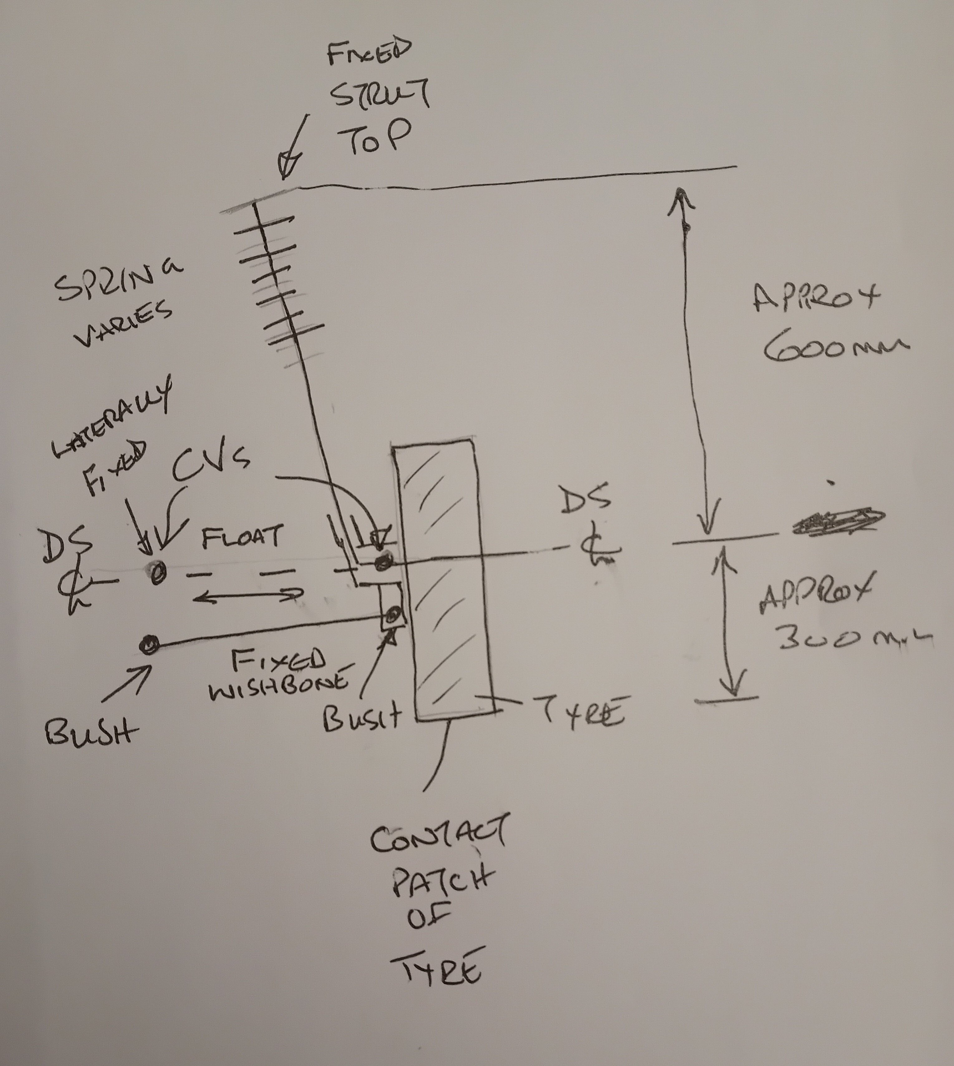

PhilNW 66 Posted January 6 Done a fag packet sketch of the suspension (attached) which show the static and moving parts that could result in reduction in end float. Think the next step is to take the measurements without the drive shaft but need to replicate the additional suspension movement as a result of body roll. Do you use the uprated engine mounts? I have been told that some people have added an extra bush to the upper engine mount to limit sideways engine movement. Couple of things I can’t explain to myself yet is 1 – the progressive reduction in end float and 2 – 205s have had a lot of competition use and abuse and I have never personally heard of this problem. Share this post Link to post Share on other sites
PhilNW 66 Posted January 6 Another thought - presumably other 205 racers in your class haven't had this problem (or confessed they have....). Share this post Link to post Share on other sites
ArthurH 12 Posted January 6 We do use uprated mounts. Under the battery tray is a BakerBM mount, on the OS wing is a 'competition' Vibra technics mount: https://www.vibra-technics.co.uk/peugeot/205/455/PUG402MX/right_hand_side_engine_mount. The car was fitted with this type of mount when we bought it - but we have replaced it with a new one. Experimentally, we put a block of wood where you described to prevent the mount from flexing towards the OS, but it made no difference. There are several other Peugeot 205s on the CSH grid and a lot of 'camaraderie' in the paddock, but none of the other 205 drivers have ever experienced anything like the issue we have. In fact, at least one of them had problems caused by the DS being too short! Share this post Link to post Share on other sites
