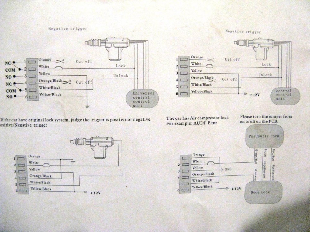

I've an older kit (only remote unit without motors/actuators) which i got few years ago from an mate for free .
Wiring diagram from that kit attached down below .
Mine is Ph1 , and my central locking (via key) stopped working long time ago when i send it to the bodyshop for full respray , while at it , they decided to replace the drivers door with an base model item and the main central locking motor/actuator was long gone along with that scrap door !
After that , i was unable to find suitable main motor/actuator thus having non working central locking for years now .
Tried fitting motors/actuators form an Ph1.5 205 donor , but the wiring on the Ph1 seems different thus that didn't work either ?! eventually i gave up .

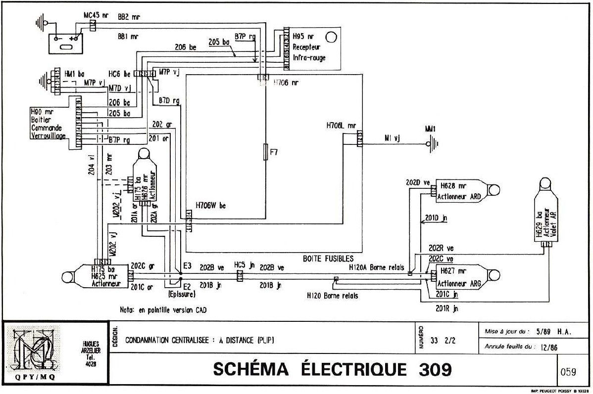

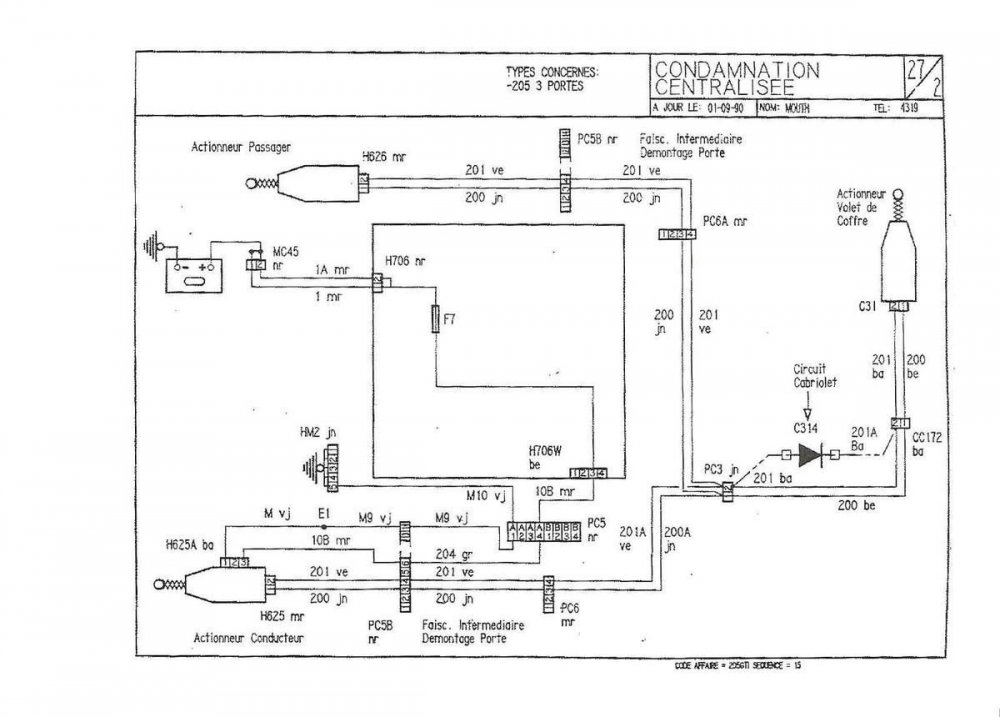

As for what i said about the pinout of the control box it was for the 309 but it's not the same on the 205, the control box is the same bdw.2021264393_309centrallockingwithPLIP.thumb.jpg.f73999f91c6b86ee4a303574a1473b05.jpg
ob_2868d6_27-3-condanation-centralise-pl
You can probably directly replace the old control box by the new one if you want. I think there was a kit like that for old Citroëns but it should work the same on a 205.
