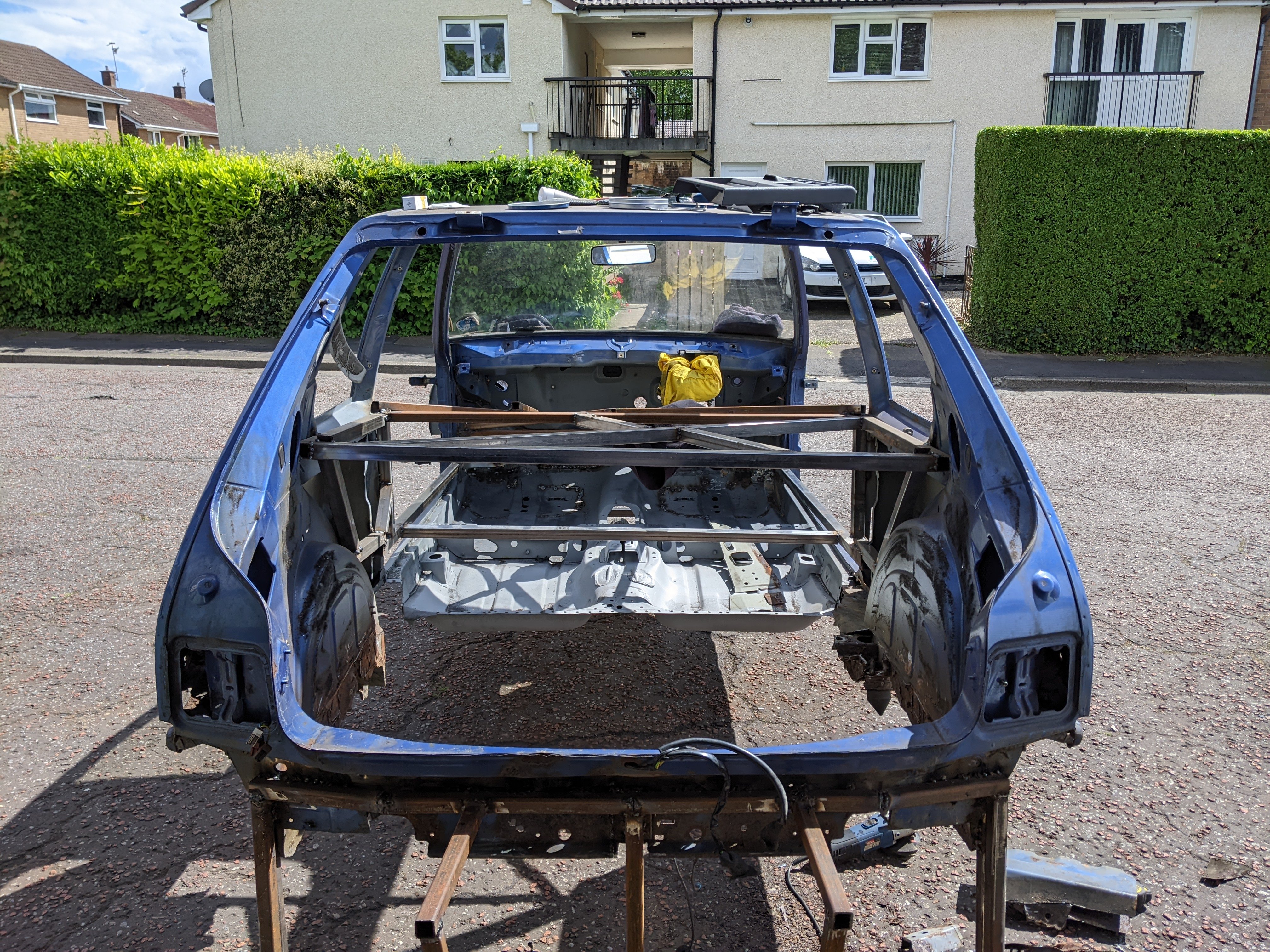

Leslie green 165 Posted April 28, 2022 Good idea if its going to narrow it would be at the bottom then door wont fit , hope you get it sorted and no doubt it's a big job Share this post Link to post Share on other sites
Gerwyn 15 Posted April 30, 2022 Floor in , just weld it in now. 2 Share this post Link to post Share on other sites

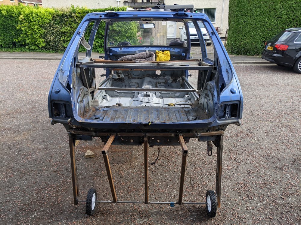

Gerwyn 15 Posted May 2, 2022 When you have to improvise. 1 2 Share this post Link to post Share on other sites

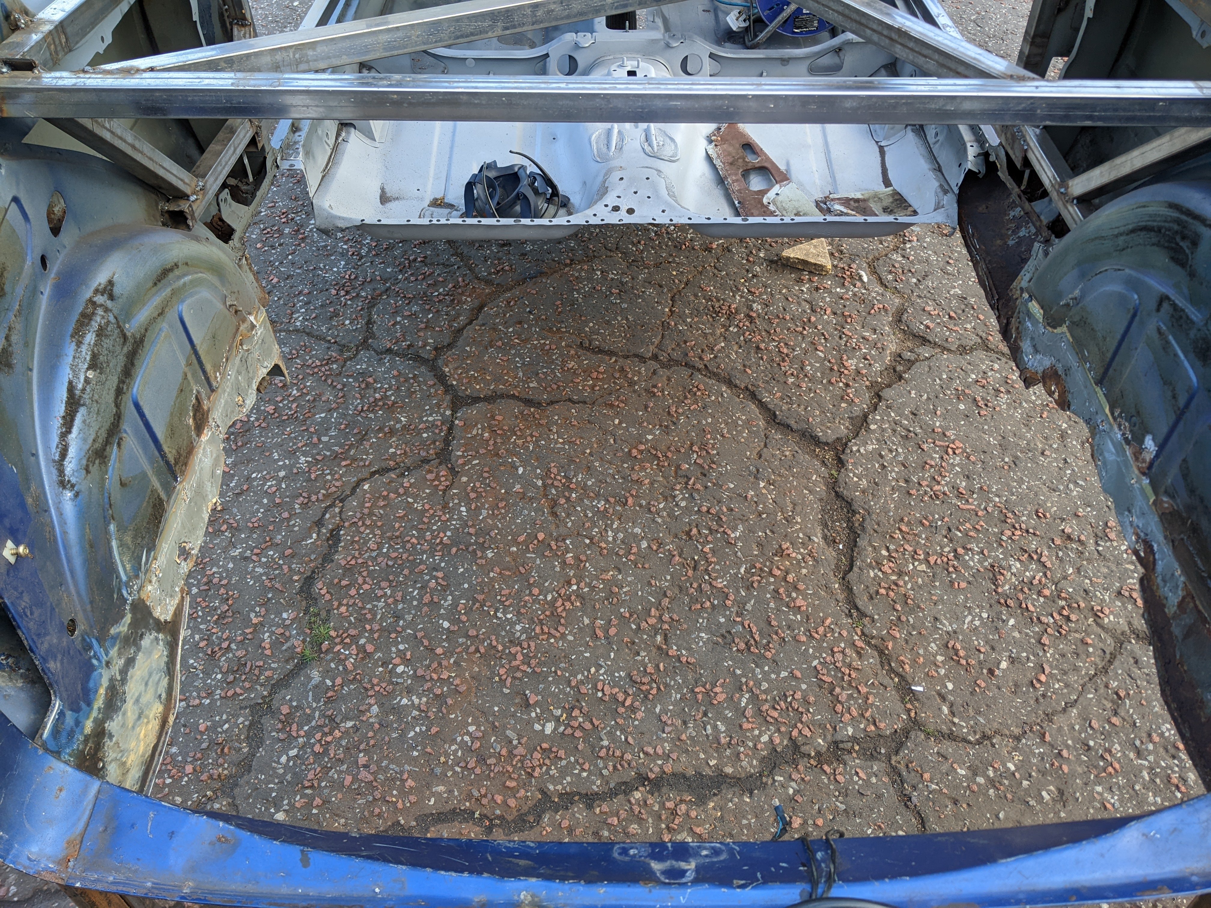

Leslie green 165 Posted May 3, 2022 Was it tricky to get the floor in past the chassis rails ? Share this post Link to post Share on other sites
Gerwyn 15 Posted May 5, 2022 On 5/3/2022 at 8:33 PM, Leslie green said: Was it tricky to get the floor in past the chassis rails ? Absolutely, had to jack up rear n/s take wheel off and support with axle stand right at the very back of car ,remove jack , cut away some of the rear floor where floor pan meets. Lots of other fettling and definitely not easy but achievable. 1 Share this post Link to post Share on other sites

Gerwyn 15 Posted May 21, 2022 On 5/10/2022 at 4:05 AM, Gerwyn said: Cheers bud. Many thanks for the links Let's start on replacement of the rear floor.... who needs big rims lol Share this post Link to post Share on other sites

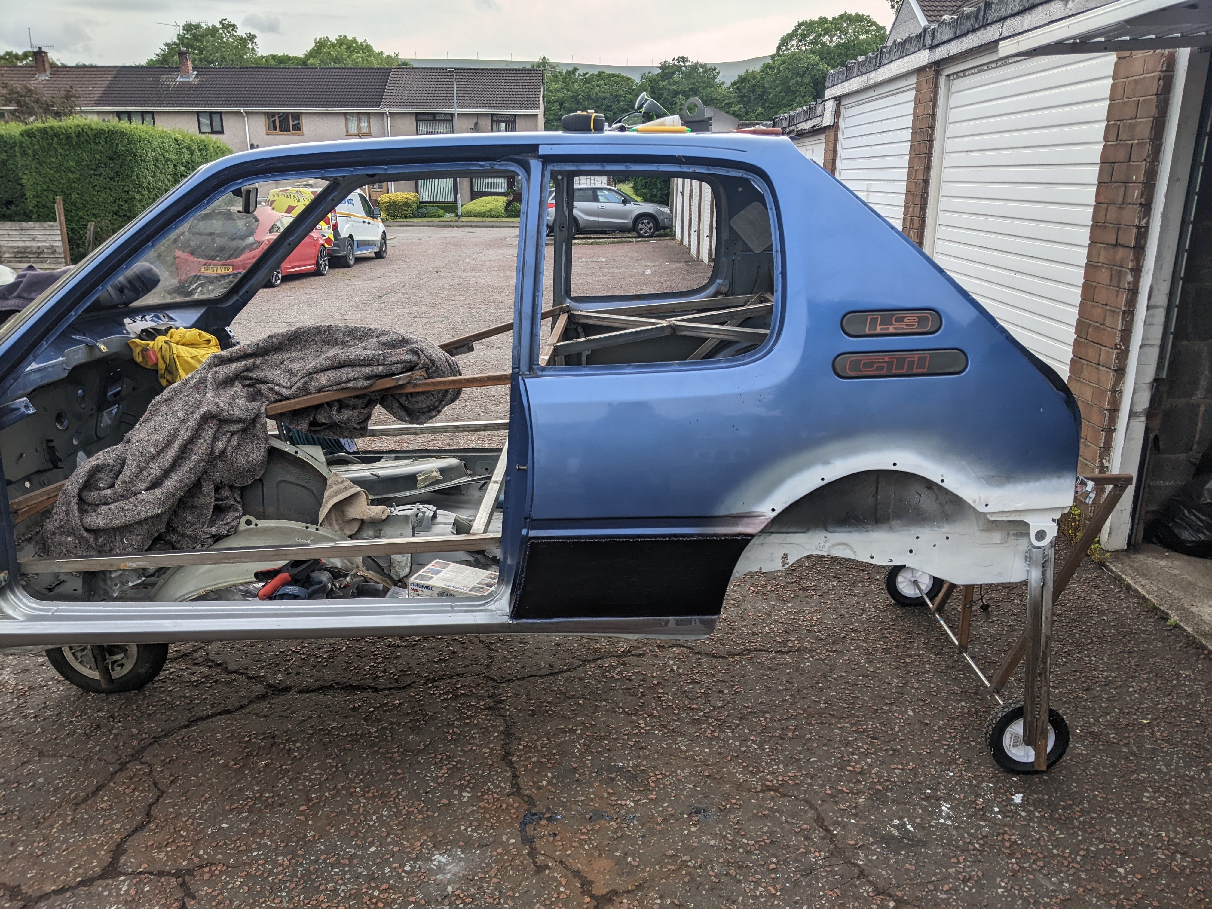

Gerwyn 15 Posted June 23, 2022 New lower rear quarter weld in place on top of new sill. Good panel purchased off retro race and rally, had be cut to fit but quality part. 1 Share this post Link to post Share on other sites
Leslie green 165 Posted June 23, 2022 That looks a great job won't be long till its done at this rate Share this post Link to post Share on other sites

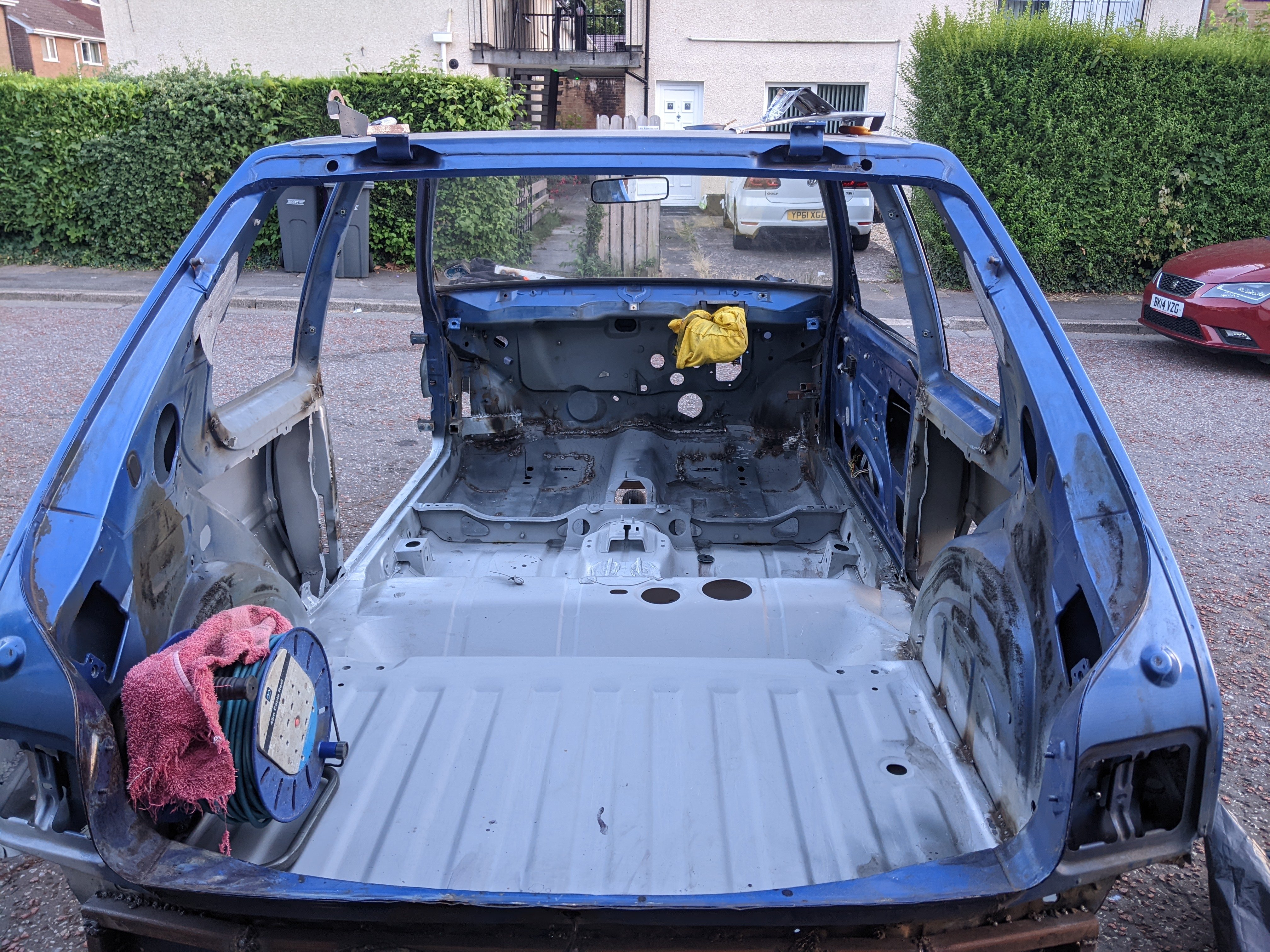

Gerwyn 15 Posted September 2, 2022 Well the rear floor section has been fitted for roughly a month, offside sill fitted and lots of fabrication to the offside rear wheel arch. It's taking shape VERY slowly Share this post Link to post Share on other sites
Leslie green 165 Posted September 2, 2022 (edited) Excellent progress looks like a solid car again now Edited September 2, 2022 by Leslie green 1 Share this post Link to post Share on other sites

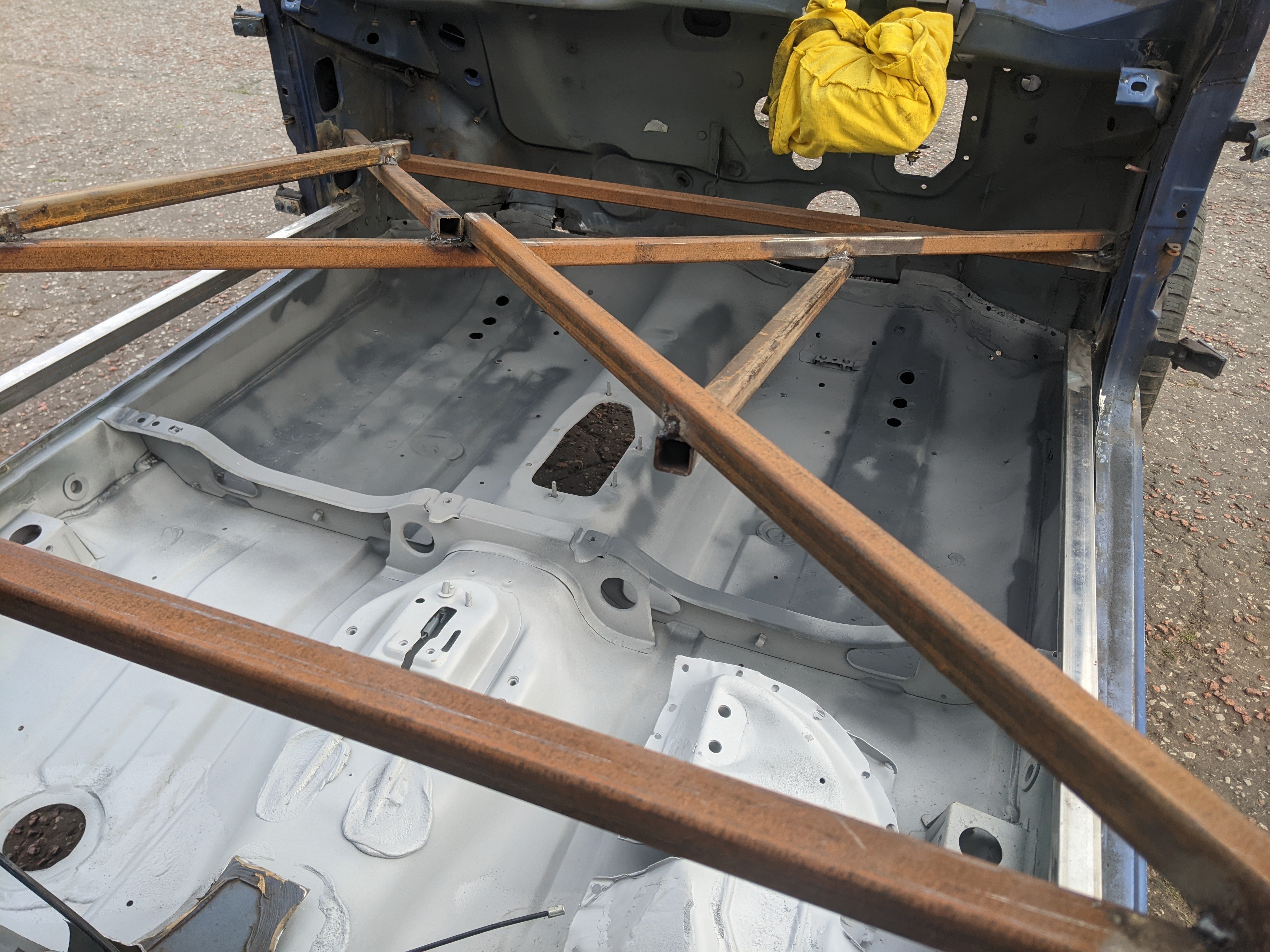

Gerwyn 15 Posted September 7, 2022 On 9/2/2022 at 10:01 PM, Leslie green said: Excellent progress looks like a solid car again now Looks a lot better without all the bracing. 1 Share this post Link to post Share on other sites

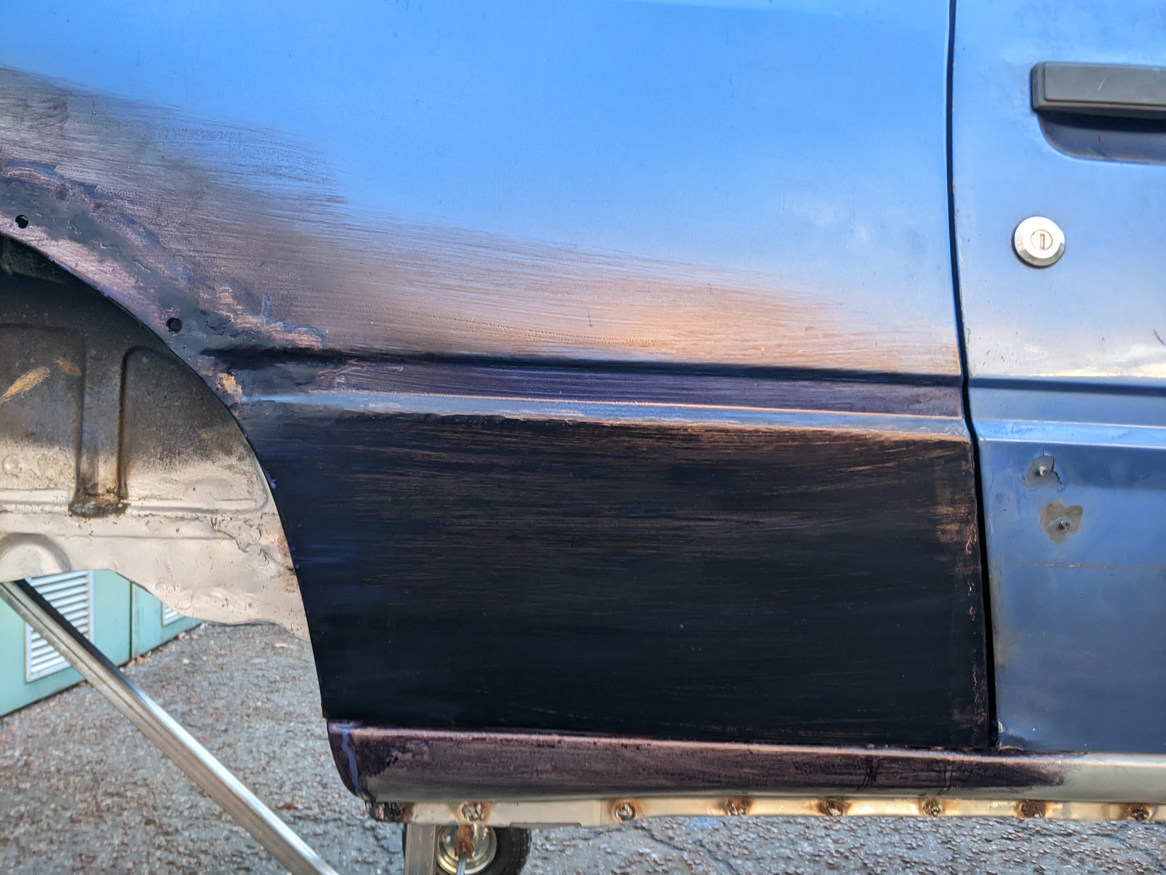

Gerwyn 15 Posted September 23, 2022 Rear lower quarter welded into place Share this post Link to post Share on other sites
Gerwyn 15 Posted September 23, 2022 Arch repair and sill Share this post Link to post Share on other sites
Leslie green 165 Posted September 24, 2022 Nice job that's that side solid again now 1 Share this post Link to post Share on other sites
