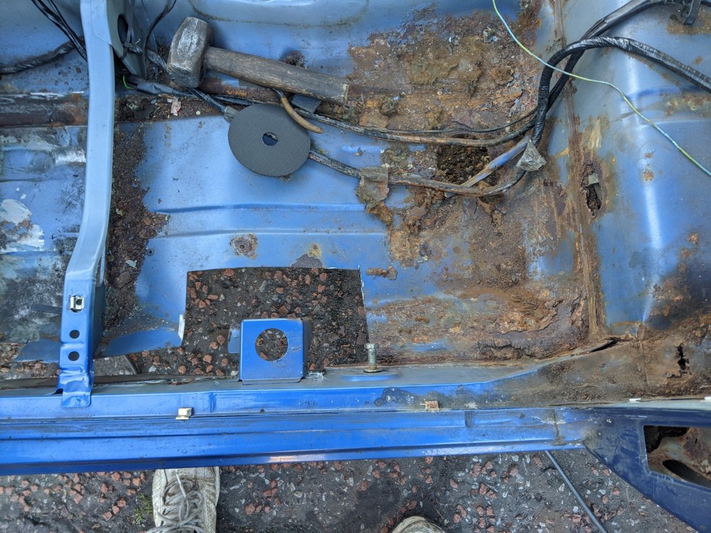

Gerwyn 15 Posted January 13, 2022 Hi , just joined .... again. Just bought my latest 205 project and to say it's a bit rough is an understatement. Lots of rust and engine stripped and no bolts to attach all ancillaries, going to be expensive job . Also any help would be appreciated as looking for floor pans. Great club Share this post Link to post Share on other sites
Gohn 62 Posted January 14, 2022 holey moley the peugeot shop lists different panel sections at different times those aren't listed at the mo you could send em an email : pr.classic@mpsa.com thought maybe baker bm might have done them too but there's nothin on their site either any 205's in breakers yards will probably have the same corrosion as yours anyway it looks like a fair bit of fab work ahead, bite off a bit at a time 1 Share this post Link to post Share on other sites
DamirGTI 322 Posted January 14, 2022 Done far worse than that ! .. usually it look's the worst than it actually is . Floor repairs are bit more easy as , doesn't need to be "perfect" as far as looks (pop the carpet over and say nobody about it) .. like the other external parts of the shell which need careful patching welding filling painting etc. . Bits needed for patching that up can be made from scratch from sheet metal , or can find an donor 205 with good floor and cut the parts you need for the repair . D 1 Share this post Link to post Share on other sites

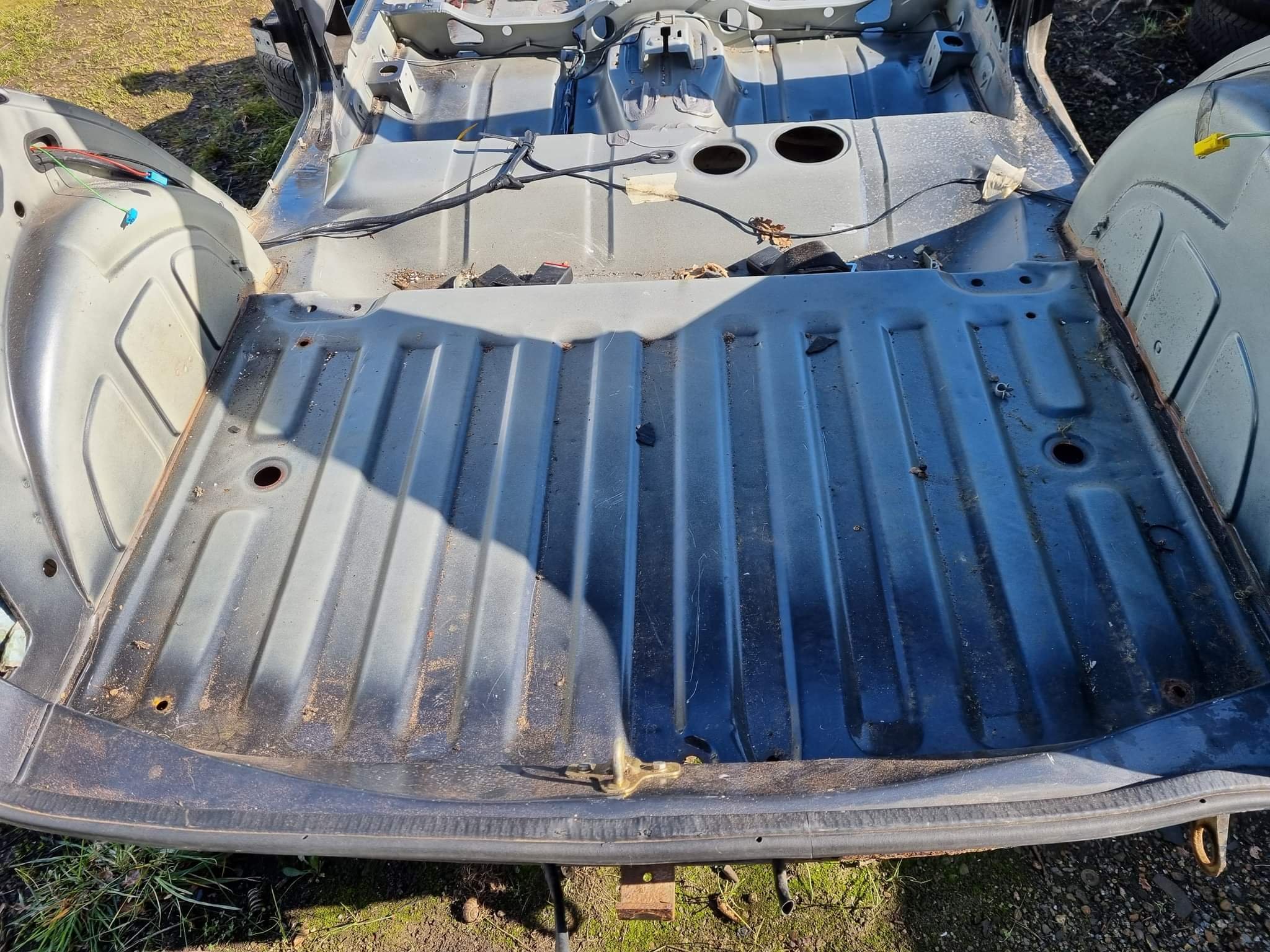

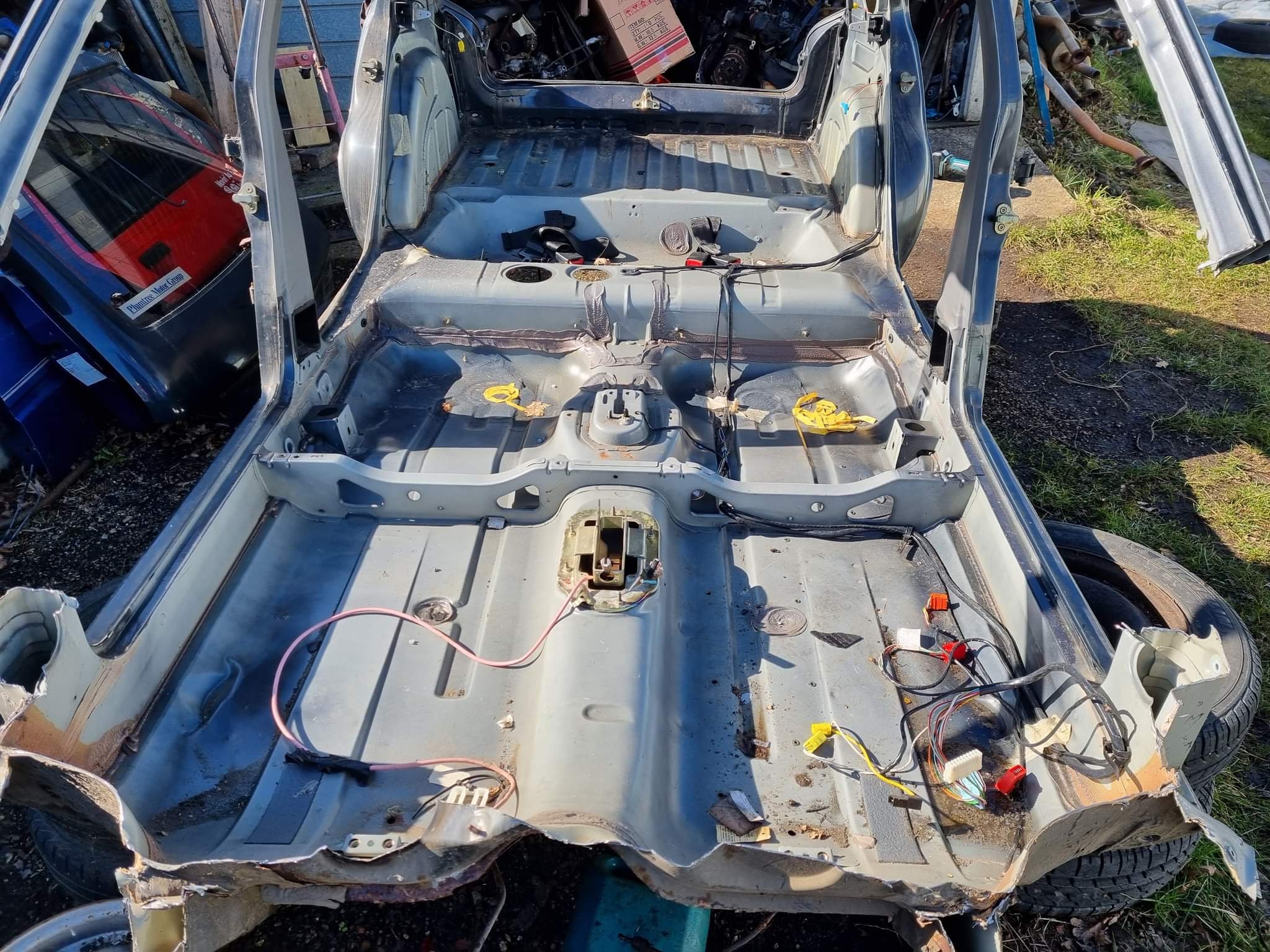

Gerwyn 15 Posted March 22, 2022 Floor found, time to get cracking. Share this post Link to post Share on other sites
Leslie green 79 Posted April 2, 2022 (edited) Great find , that looks just about the right size to cover all the rot Great to see cars like this being saved now Edited April 2, 2022 by Leslie green 1 Share this post Link to post Share on other sites

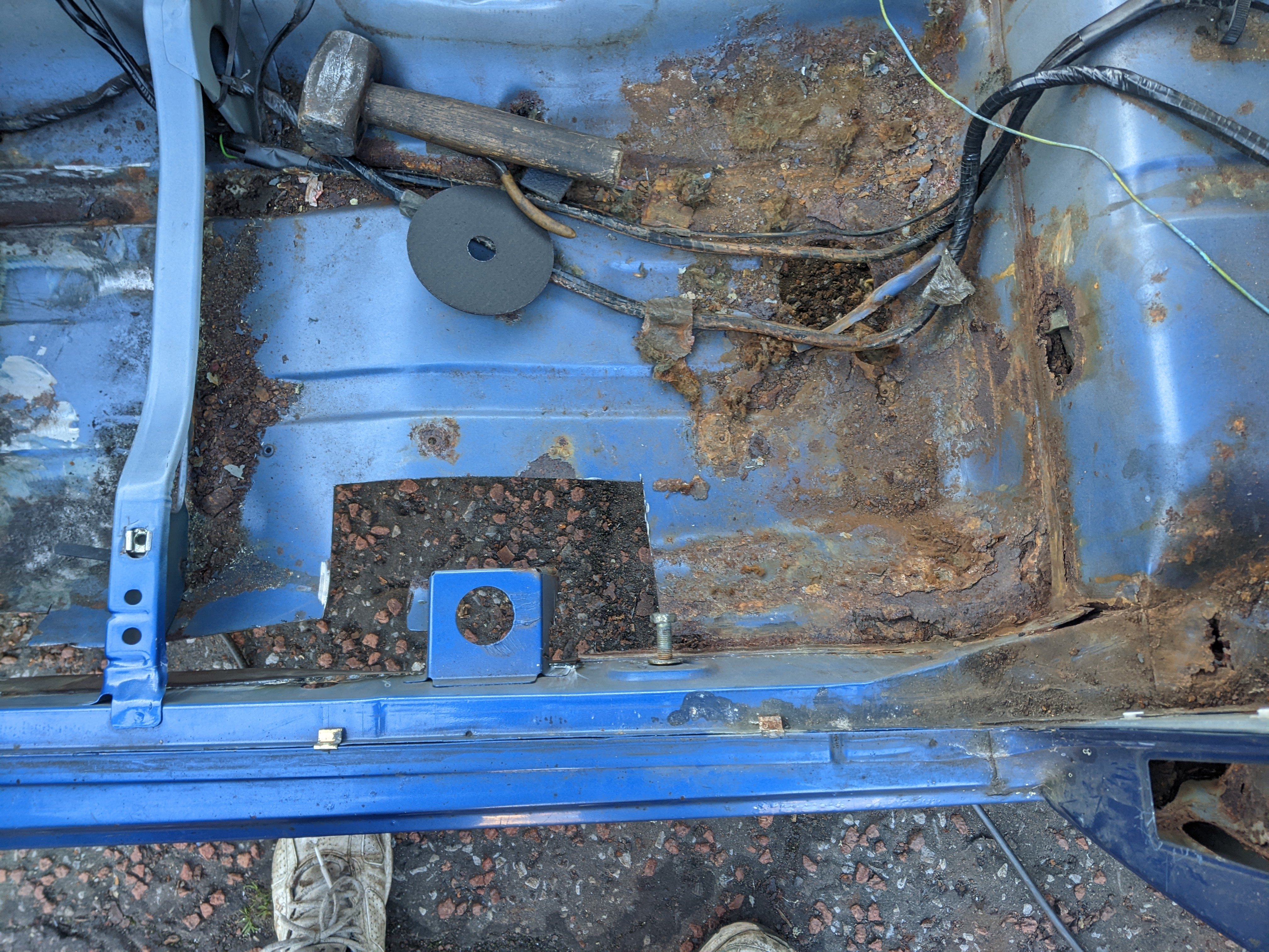

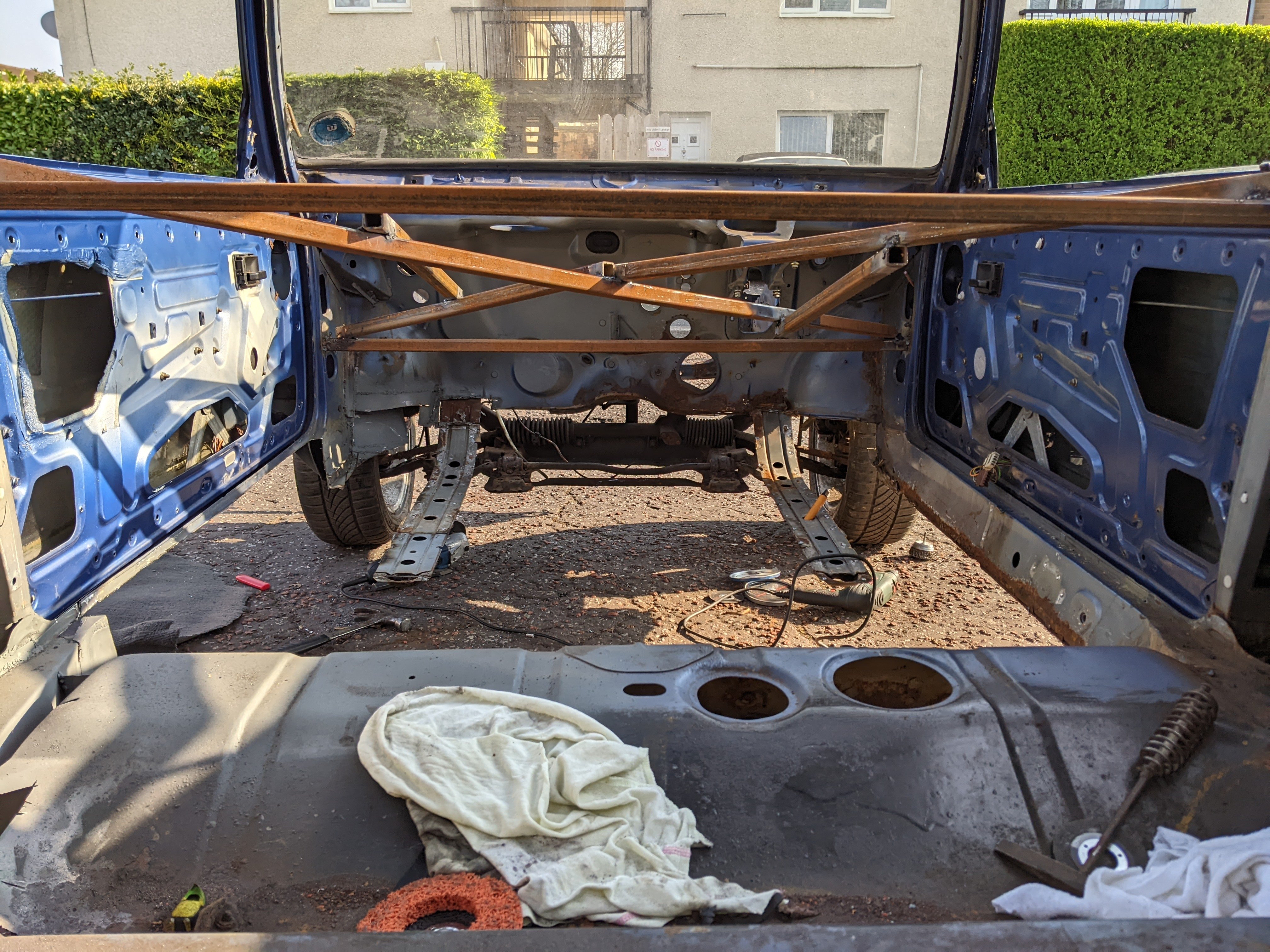

Gerwyn 15 Posted April 20, 2022 Work has commenced 1 Share this post Link to post Share on other sites
Wallby 39 Posted April 22, 2022 That seems like a lot of work ahead! Any reason why you've started with such a bad one? Sentimental value or anything? I can bring mine over anytime, might be handy if you need to see how something fits etc Share this post Link to post Share on other sites

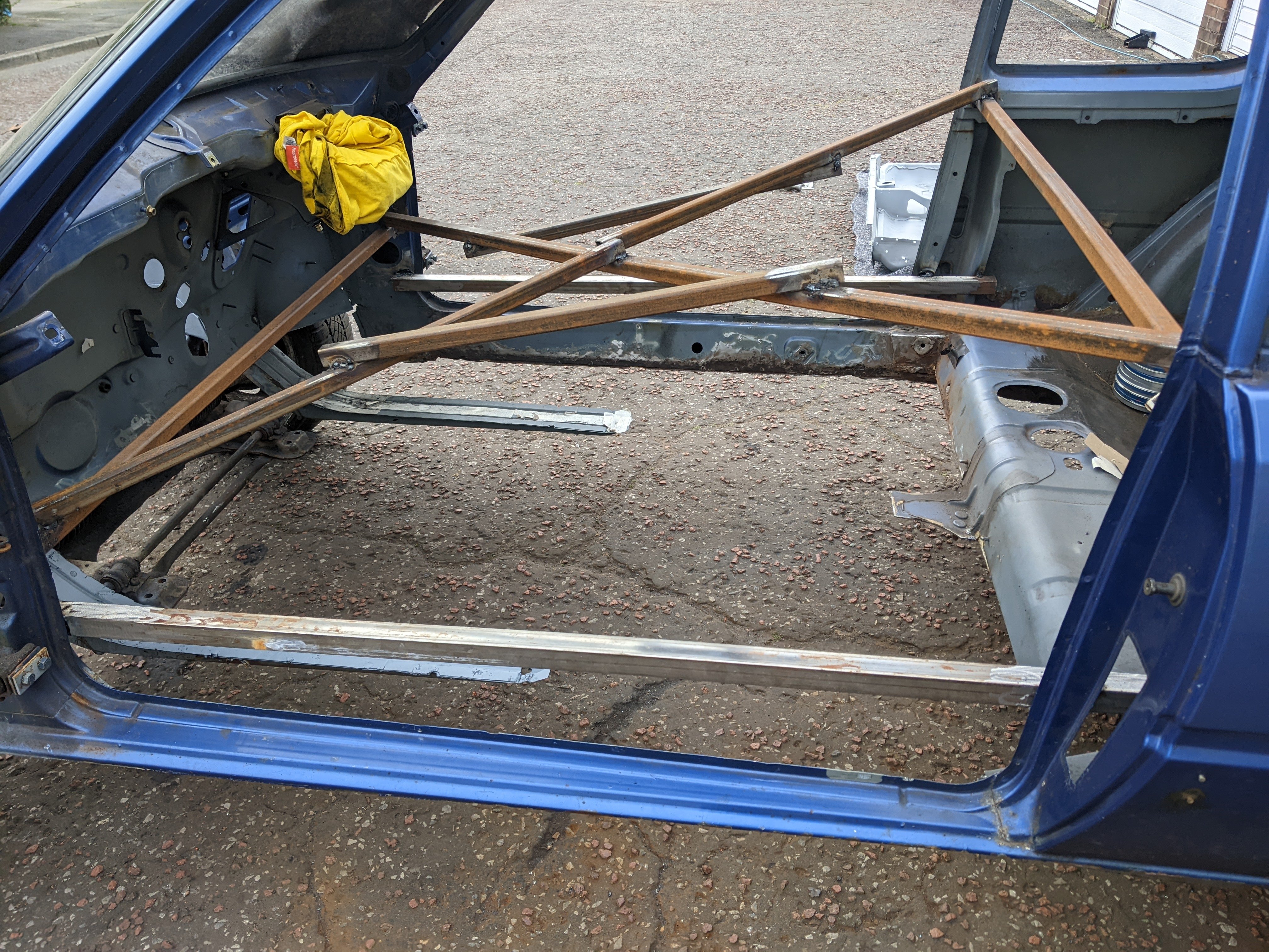

Leslie green 79 Posted April 24, 2022 (edited) That's great you are cracking on with it , id have put a bar just above where the inner sill on left has been cut off as well from A to B pillar to stop any possible movement . Are you trying to fit it in one piece ? id think with the seat brace off the floor it would be quite flimsy and flexible so could bend a bit to fit in through the boot without doing any real damage . Not sure how it would fit in otherwise without cutting it in half down the tunnel. Edited April 24, 2022 by Leslie green Share this post Link to post Share on other sites
Gerwyn 15 Posted April 25, 2022 On 4/22/2022 at 11:40 AM, Wallby said: That seems like a lot of work ahead! Any reason why you've started with such a bad one? Sentimental value or anything? I can bring mine over anytime, might be handy if you need to see how something fits etc I bought on ebay and was worse than expected so had to go with it. Share this post Link to post Share on other sites
Gerwyn 15 Posted April 25, 2022 19 hours ago, Leslie green said: That's great you are cracking on with it , id have put a bar just above where the inner sill on left has been cut off as well from A to B pillar to stop any possible movement . Are you trying to fit it in one piece ? id think with the seat brace off the floor it would be quite flimsy and flexible so could bend a bit to fit in through the boot without doing any real damage . Not sure how it would fit in otherwise without cutting it in half down the tunnel. I did consider another brace as you said but think it might limit access . I'm hoping to fit in one piece including inner sills , the bracing is quite heavy gage so cannot twist diagonally or up or down...... FINGERS CROSSED 1 Share this post Link to post Share on other sites
DamirGTI 322 Posted April 25, 2022 Did something similar years ago ... but only left half of the floor and some random patches on the right side . Be careful while welding the floor back in , as even with the bracing the panels will move/distort if welding too long , fast and/or at higher amperage . Cooling the welds with wet rag/sponge helps . Wish you all the best results with this project ! D Share this post Link to post Share on other sites
Gerwyn 15 Posted April 25, 2022 10 hours ago, DamirGTI said: Did something similar years ago ... but only left half of the floor and some random patches on the right side . Be careful while welding the floor back in , as even with the bracing the panels will move/distort if welding too long , fast and/or at higher amperage . Cooling the welds with wet rag/sponge helps . Wish you all the best results with this project ! D Much appreciated for the advice. Hopefully shouldn't have to much heat as only refilling the spot welds. Share this post Link to post Share on other sites

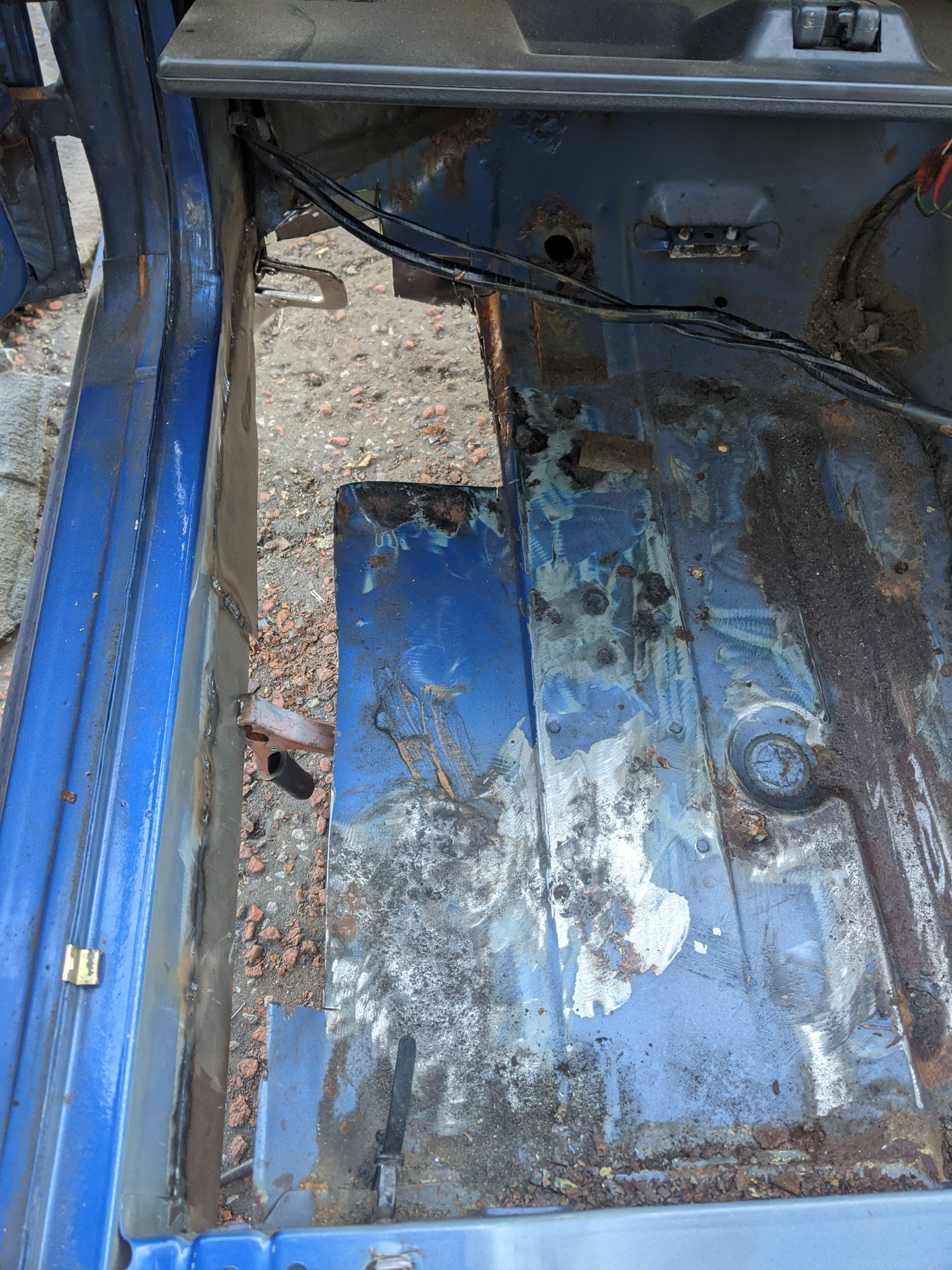

Gerwyn 15 Posted April 28, 2022 Surprising how much work involved Share this post Link to post Share on other sites
Gerwyn 15 Posted April 28, 2022 On 4/25/2022 at 8:34 AM, Gerwyn said: I did consider another brace as you said but think it might limit access . I'm hoping to fit in one piece including inner sills , the bracing is quite heavy gage so cannot twist diagonally or up or down...... FINGERS CROSSED I did fit extra brace's...better be safe than sorry for the sake off twenty minutes. 1 Share this post Link to post Share on other sites
