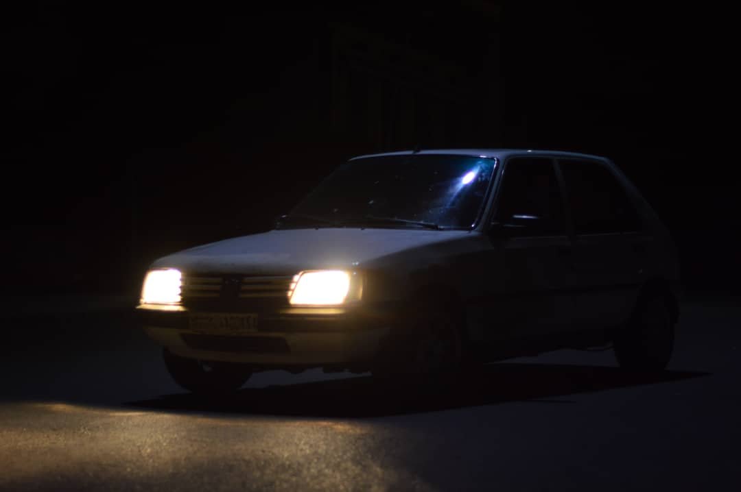

Hello I'm 18 years old , I bought a pug 2051.4 this summer .. unfortunately I can't afford buying and upgrading to a new bigger engine like a 1.9 GTI
can someone help me with some ideas to gain more power please ? because my friends are making fun of my car but I really love my 205
is swapping the carburetor would be a good move ? and is there any specific carb model ?
and Thanks
