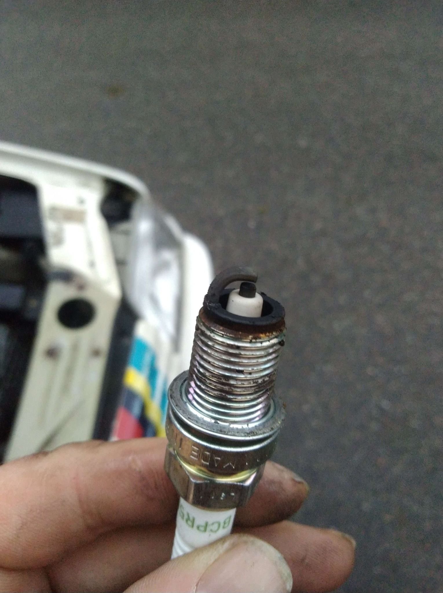

I also think its a fuel problem, but how can I check it? If I pull injectors out, there must be than replaced some seals etc before going back, am I right?
this is plug right after cranking the engine

Fuel presence test is easy if it doesn't start , immediately after cranking with no start by pulling the plugs out and looking at them visually if they're wet from non ignited fuel , and sniff/nose test them for the smell of it too !
Hi Damir,
I posted photo of plug right after cranking, I dont see it as it was wet, looked dry to me....but still I can smell petrol from plugs, but it looked to me like petrol was more on the thread of plug neither on top

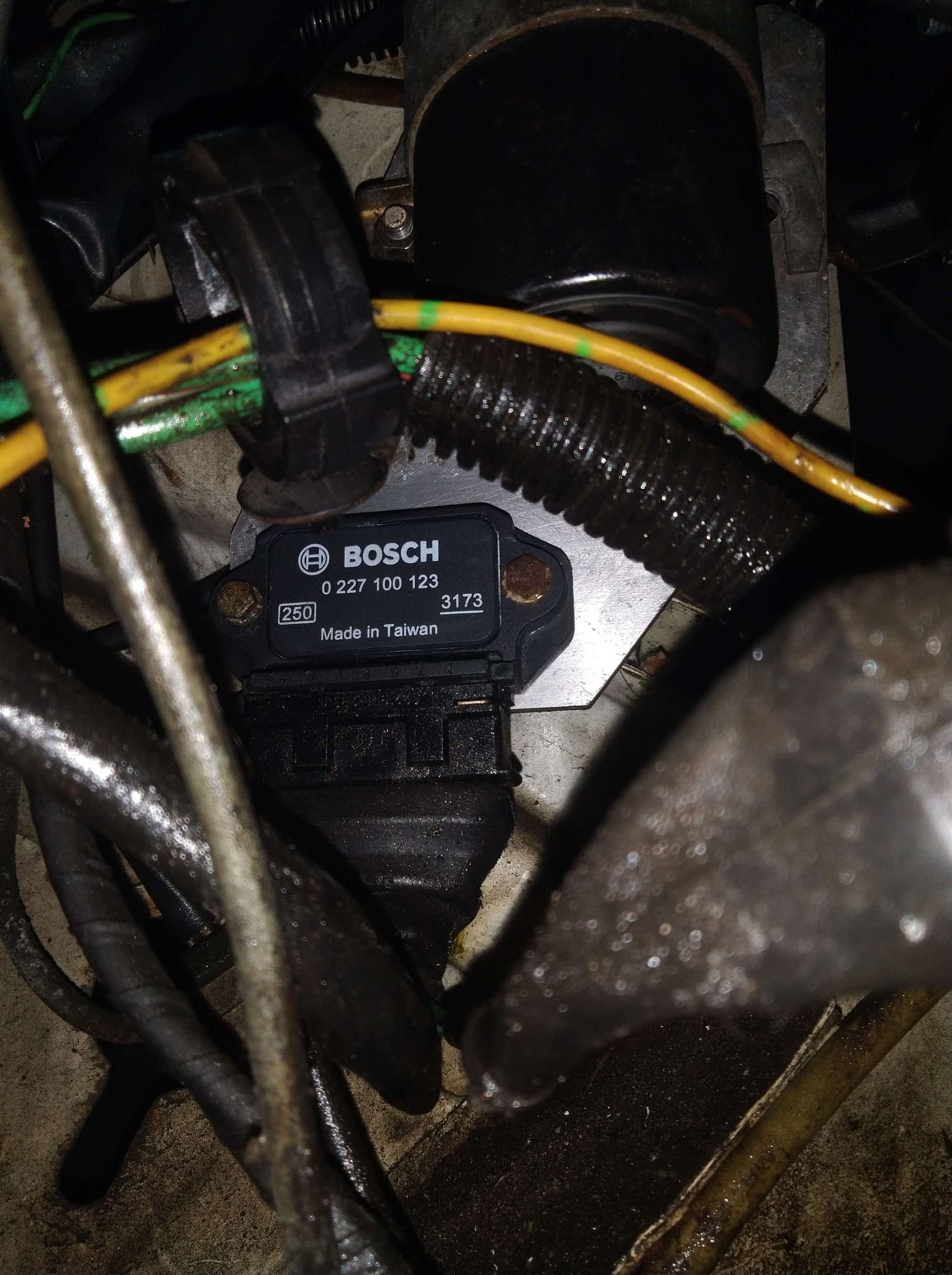

Amplifier:
is Bosch, will post photo
I wasnt changing it, but I told guy who was servicing car, to place a thermal paste underneath the new module, like 10 times, and on photo I see some "gray" stuff behind amplifier, so I believe he did not forget this, I was really pushing on him to not forget this
I also took the old amplifier (bigger gray-white Duceliier) and tried to replace a new one, no change happened
