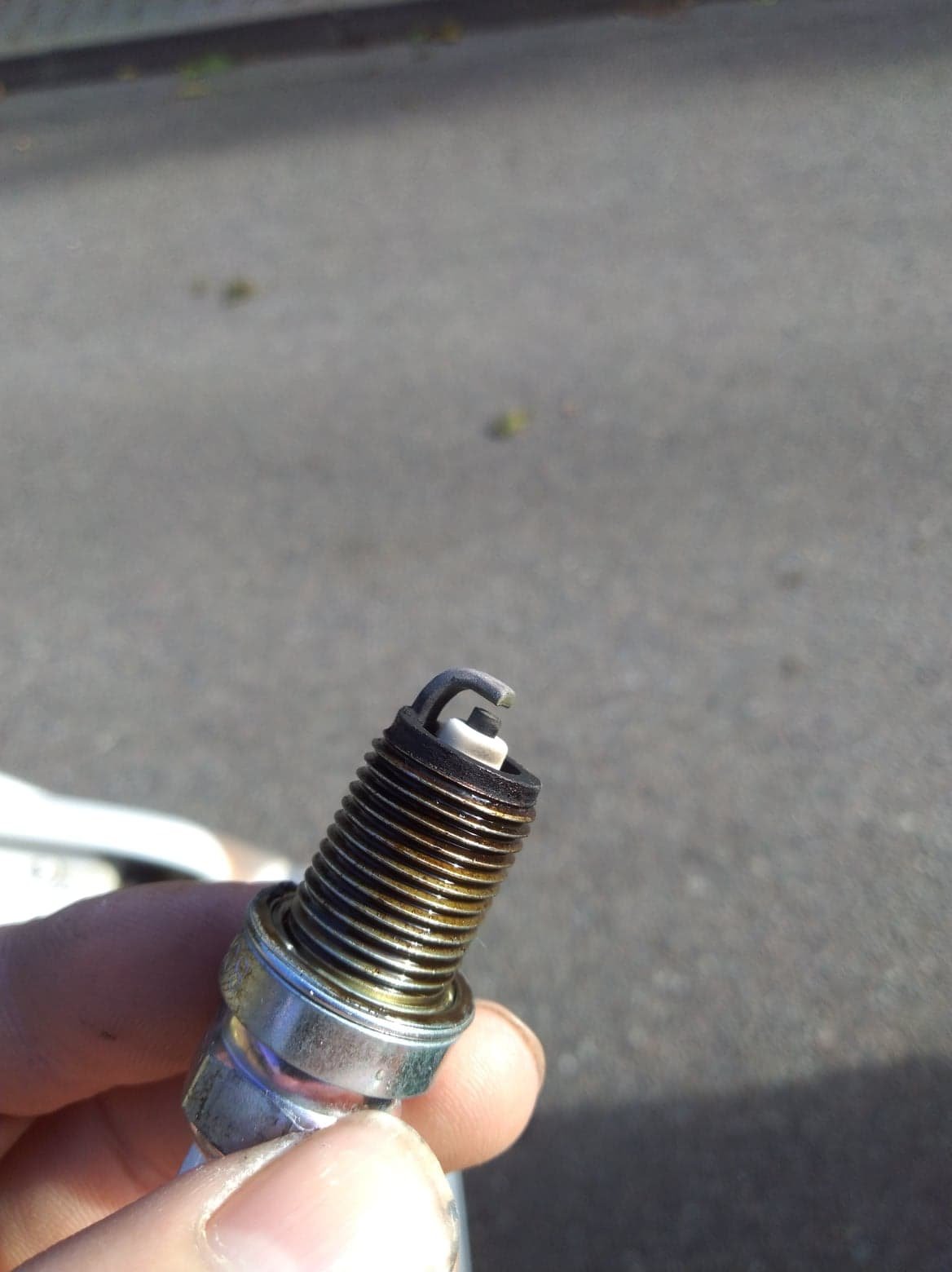

So I pulled a spark plug out of car and tried for sure if there is a spark, it is... so problem with fuel or bad distribution of sparks
Since I dont have pressure gauge for a petrol, I have to order some....

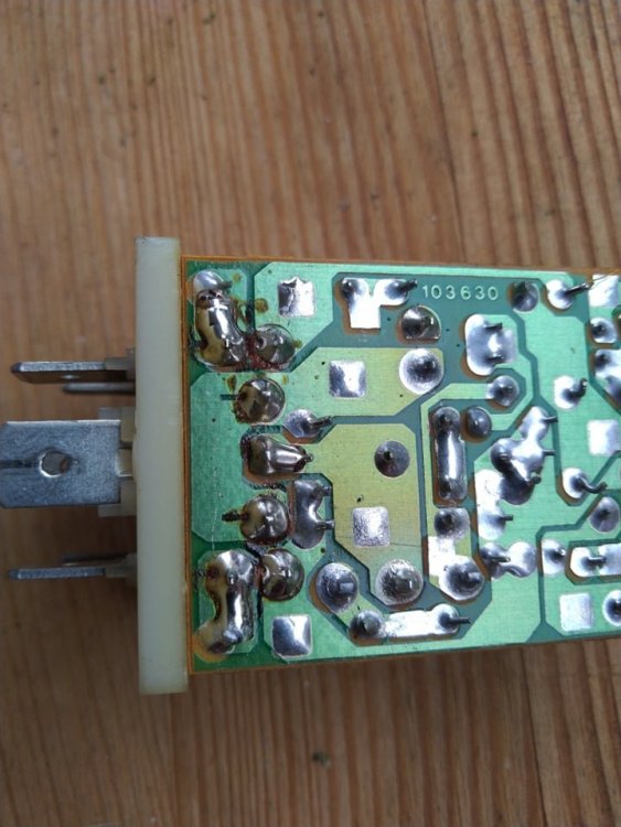

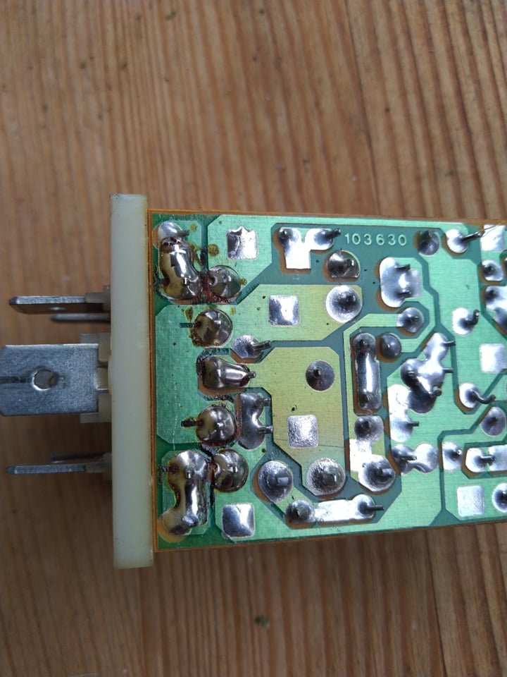

so I took out the tachy relay and I think I found a problem?
Those coil values are within specs .. but still doesn't mean it's 100% good , coils are a bit tricky to test best done under load with the oscilloscope .
What kind of coil is it ? square or cylindrical ?
Bottom part of the relay looks like was heated up , thus the flux (brown stuff) has run out from the solder joints .. probably because of the current it does tend to heat up a bit ... check the relay connector , if the connector terminals are dirty/oxidized clean them .
Some flux types are conductive , not sure about that one , but best to clean it up as it's corrosive too ... old toothbrush or fiberglass pen , and some contact cleaner (medical benzene is really good for flux cleanup) and scrape that brown layer off .
How does the other side of the relay looks like ? any burnt diodes or resistors ?

HoRSiCZeK
spark looked like on photo right after pulled from car
I tried plugged spark out of engine against block to see for sure there is a spark, and yes it is
sparks are quite new, I run on them about 500 km
I dont see any dead parts on tachy board, only "dmg" is on the other side, but if I smell it really stinks like burned electronics, it really hit me in da nose when I opened it next to the car outside
Edited by HoRSiCZeK
Can't recall from memory what those lower terminals of the relay are for , but check with the multimeter if there's continuity in between the joints which leaked flux might've bridged together .
It was under some higher temperature that's for sure , that's why it smells "funky" too .. i had one of those relays caught on fire before , it really does stinks awful .
Clean it up as even if it's not conductive it is corrosive .. clean/scrape that brown deposits around the joints , plug back in , try to start and see what happens .
yea friend few mins ago send me your photo of that burned one :D
I will take tachy tommorow to work, we have some isopropyl etc in there, so will try to look at it with colleagues...
but still I ordered replacement to be sure

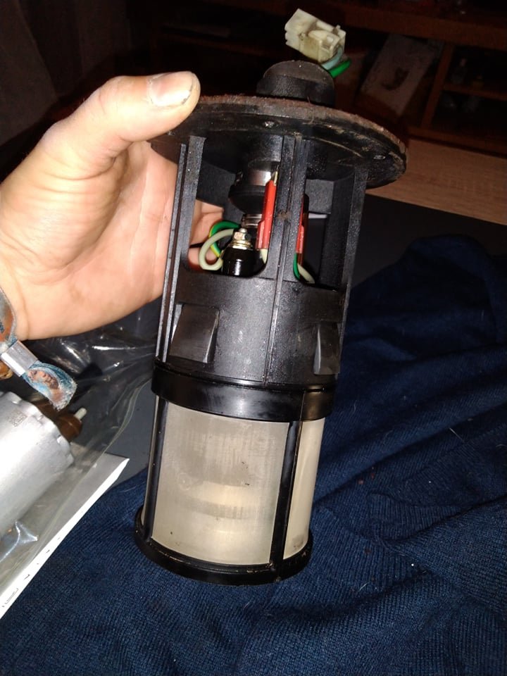

So new pump at home, old pump already taken out of the car, but I cant get the pump filter down.....!
Can pls someone tell me how to take pump filter down? I am pushing trying to rotate it but it doesnt even move.... I dont want to screw it...
Release the filter from the bottom of the housing, then the collar  - says manual, but how? :)
Wedge body filler metal spreader or similar inside the housing groove and carefully work around to separate it/break the bond , then rotate a bit on the sides and pull down and it'll pop off .
