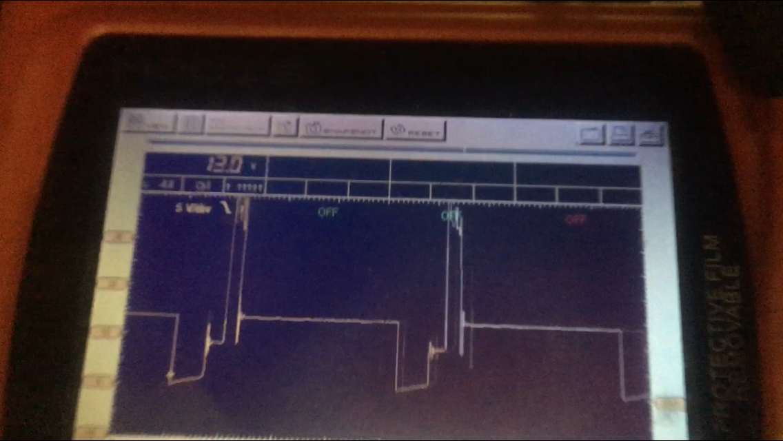

Cheers for getting back to me. Im actually using an oscilloscope for voltage checks on the coil trigger wire for that exact reason.
But unlike the correct signal which you should get on that wire (attached) i am getting a 9v flat line.
Just trying it understand what controls that system and how sensitive it is. I.e would it give me the symptom ive got if it detects an issue on the line

Fuel pump will run yes. No voltage to any injectors as it need a signal similar to the picture i sent to enable the injectors to know when to fire.....
