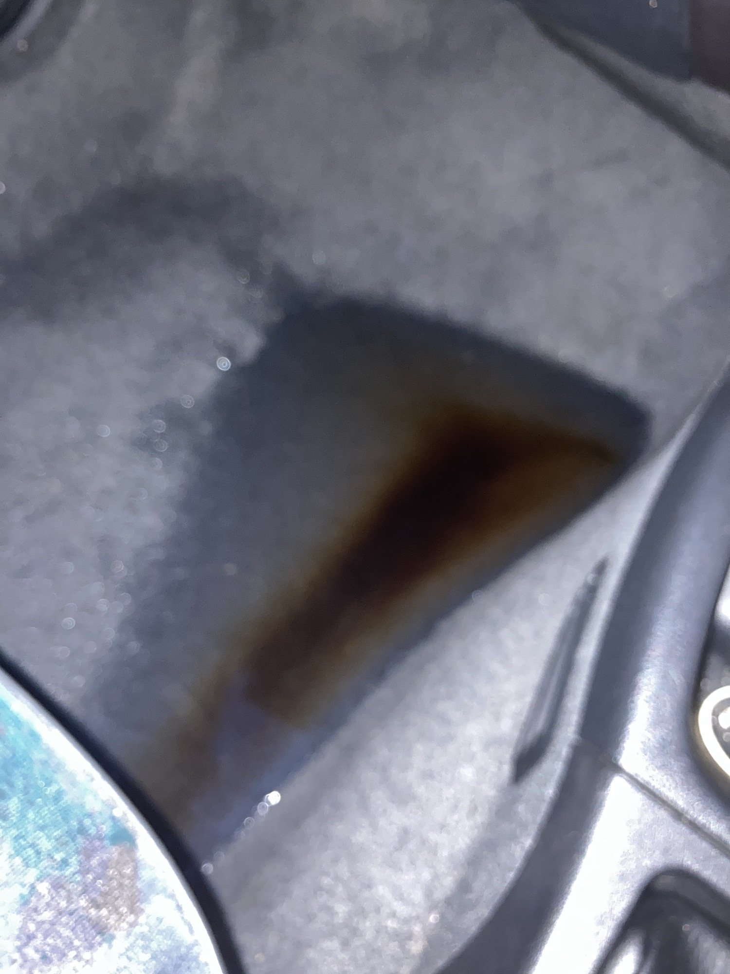

I need to replace the heater matrix in my turbo diesel 306 (Coolant found in the passenger footwell, blower reeks)

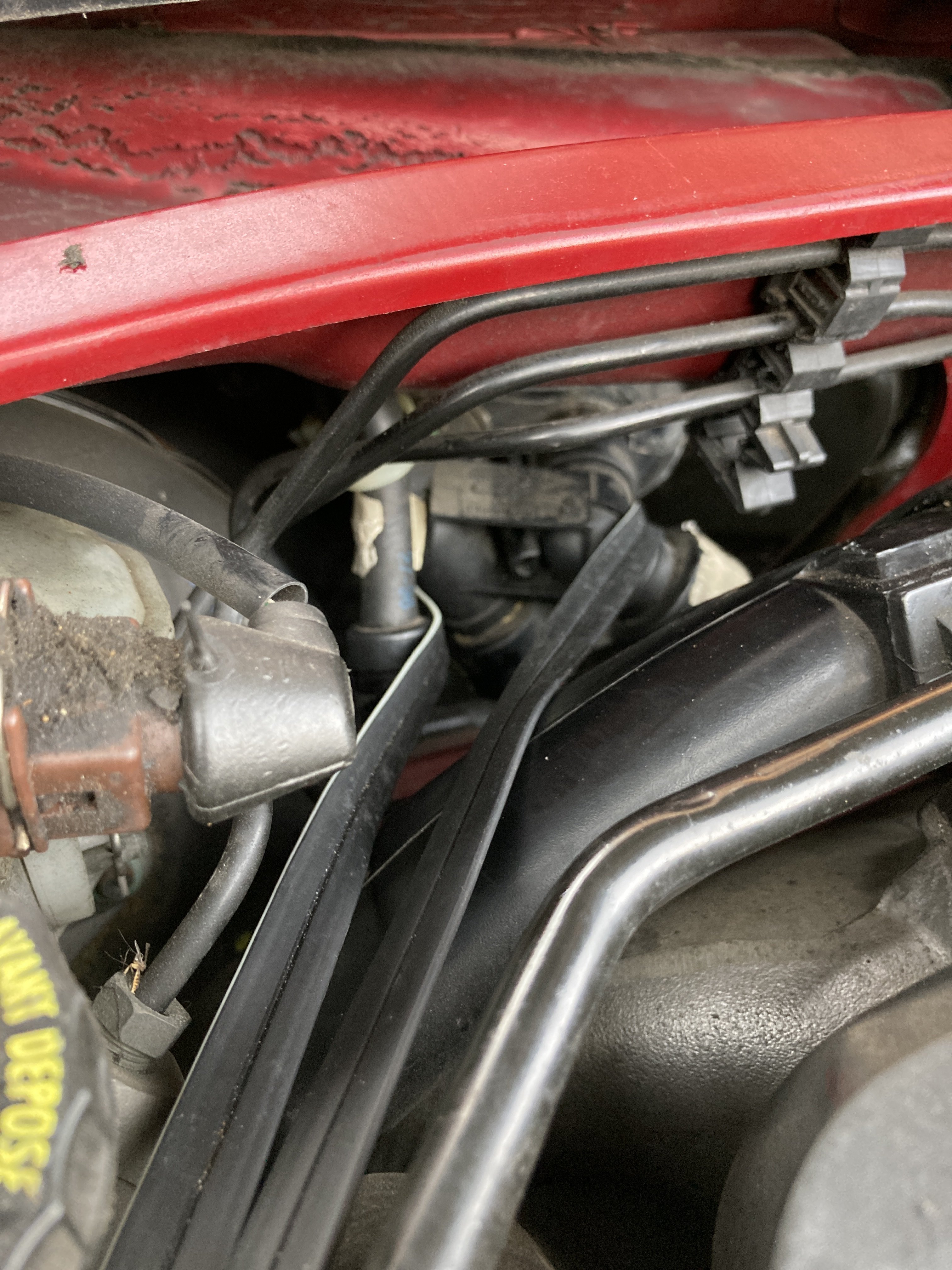

Seem to think I broke the matrix pipes on mine where it comes out of the bulkhead, double pipe thing, very brittle plastic/clip affair
I damaged the matrix side of this on my new matrix forcing it through the rubber bung on the bulkhead but luckily I got it to stay together until the car was scrapped a few years later.

can’t get the bastard matrix pipes out
any ideas? moving the little clip to the right and trying to pull them out but nothing budges
even tried to use some cable to pull it out but nowt!
Danez
never mind, immediately after posting that i managed to lever it out with a hammer handle :lol:

Yeah that’s the bit I broke, well done :P
