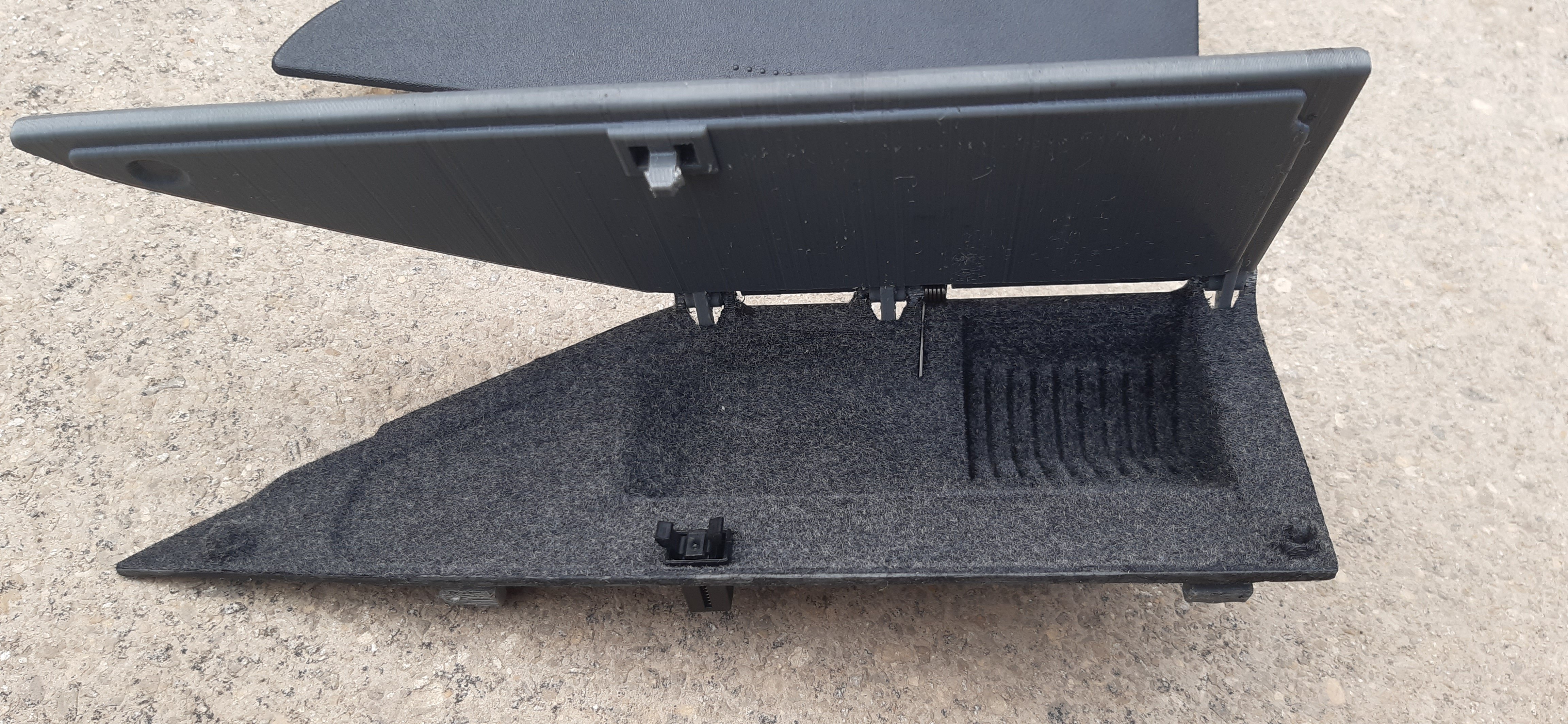

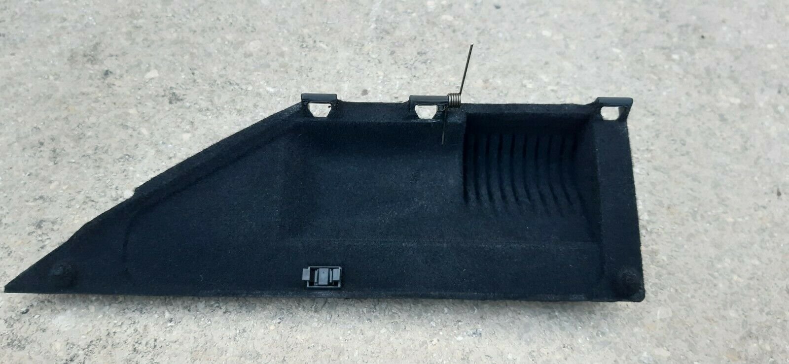

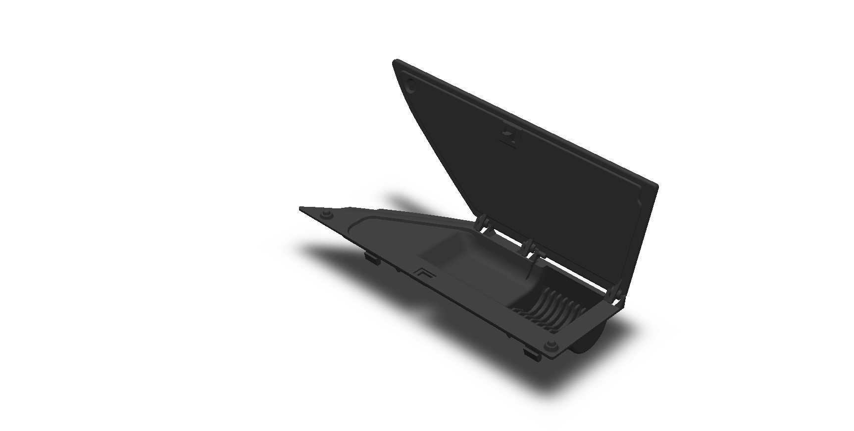

ALEX 100 1 Cars Posted July 28, 2020 Now with Lid! Still to print a lid. might be a bit too difficult to print but we'll see. 3 Share this post Link to post Share on other sites

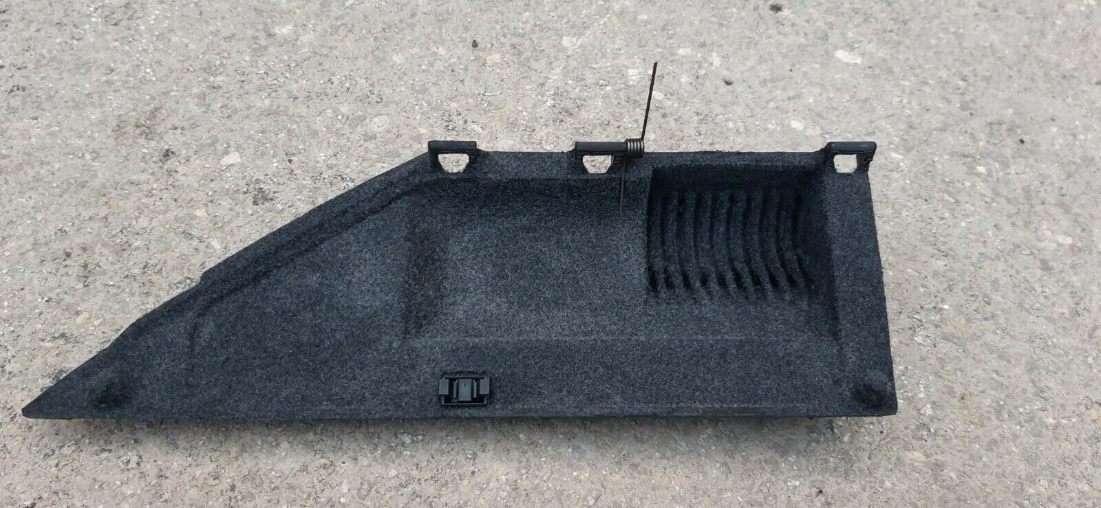

ALEX 100 1 Cars Posted July 29, 2020 6 hours ago, Nobby21 said: Yes I'd be up for one too... Stil not had chance to print a lid yet but I'll keep the project updated when I get around to it. On another note the small batch of test springs arrived and they fit perfectly. So If anyone is wanting one let me know. Forum members the price is £30 Delivered (Uk Postage). Share this post Link to post Share on other sites

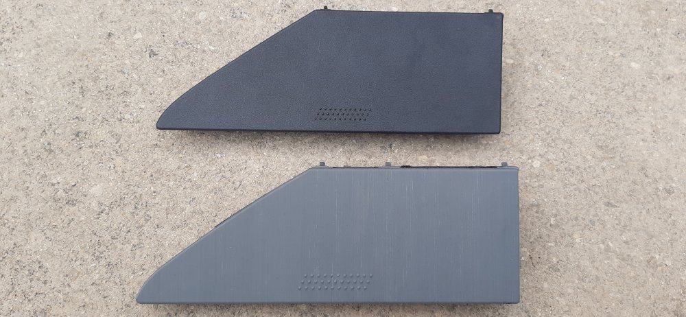

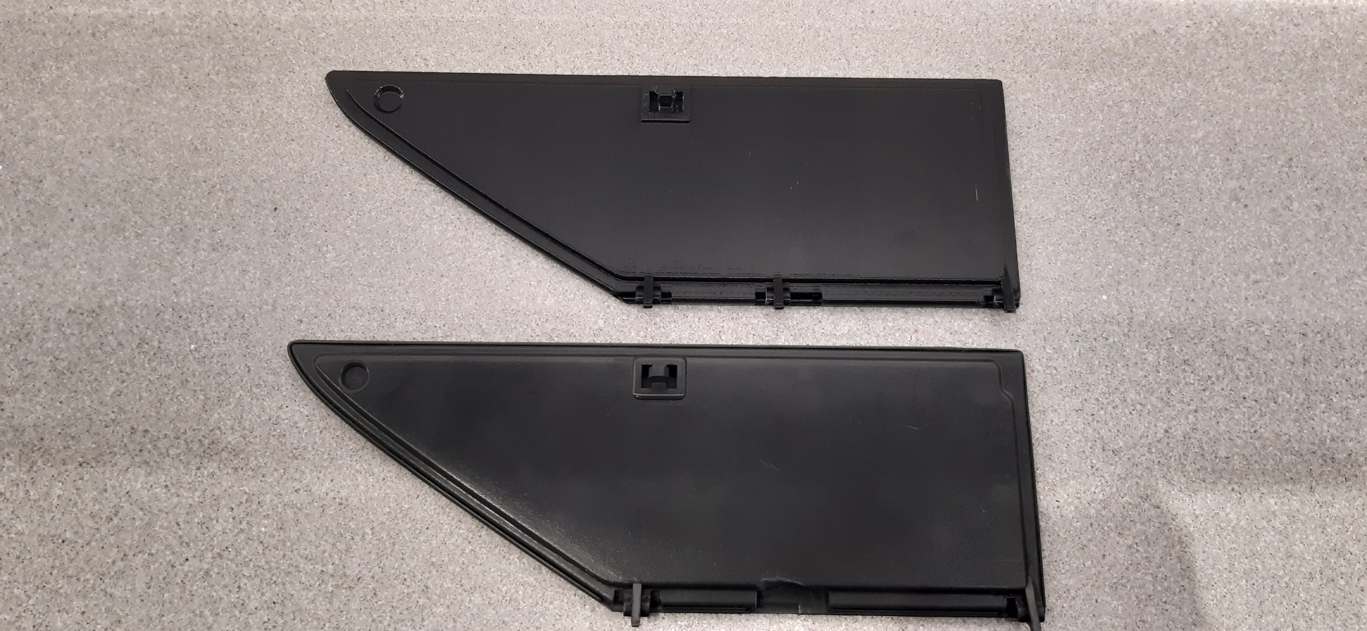

ALEX 100 1 Cars Posted July 30, 2020 First test print of the lid in PLA. Looks good but still needs a little work. Fitment is very tight as the PLA doesn't flex that much but I'm hoping PETG will be better. Share this post Link to post Share on other sites

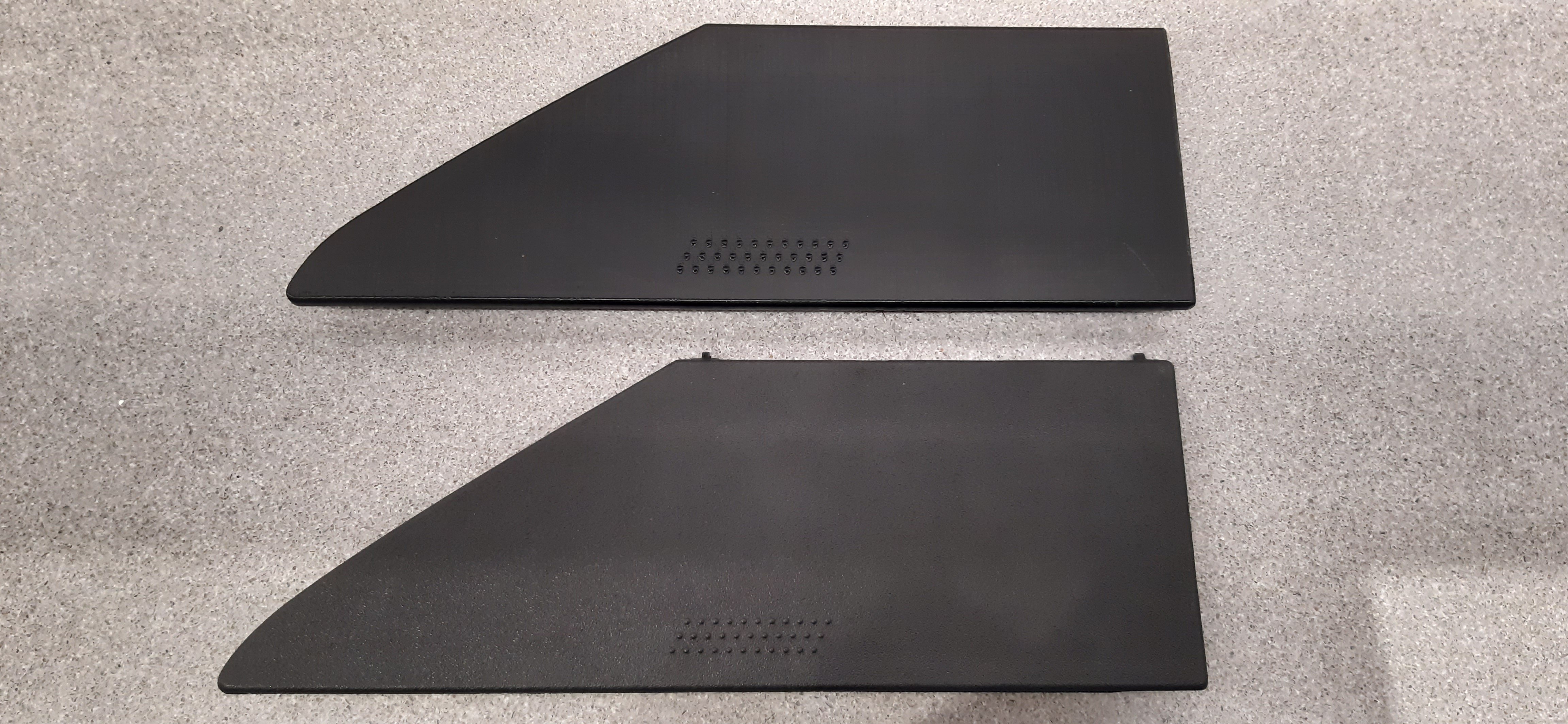

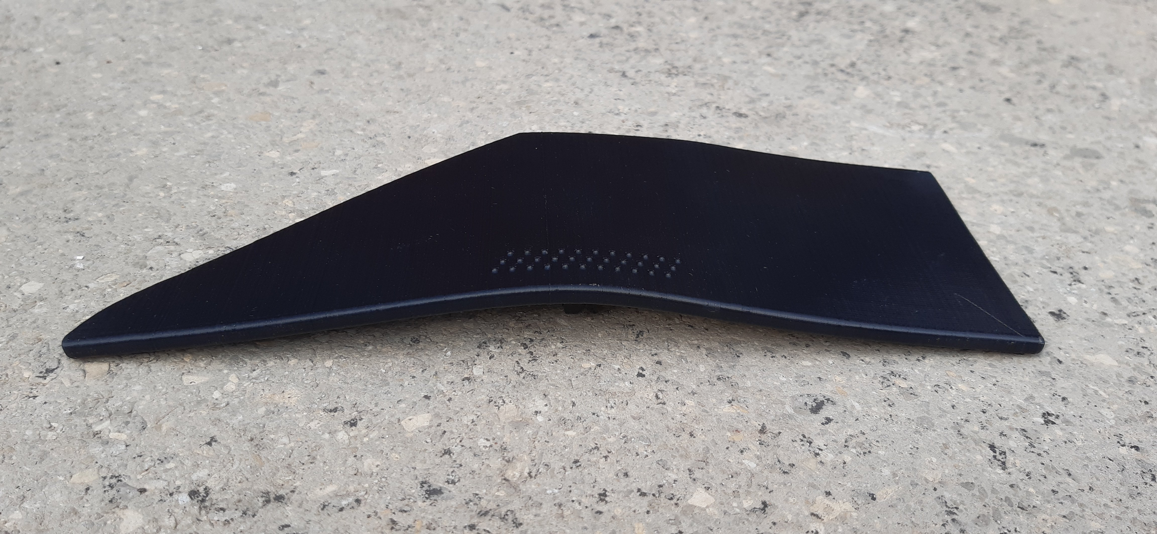

ALEX 100 1 Cars Posted August 7, 2020 With the hottest day we had for some time I thought I'd do some product testing to see if PLA prints would survive in the car on hot days. I placed the PLA printed lid in the missus car in the sun on the dash for 2 hours, see photo..... So It's a No then lol. A new roll of PETG arrived this morning (what I printed the bases out of). From what I've read online it should withstand hot days in the car. Down side is the finish isn't quite as good as PLA also takes much longer to print. I'll post up the results soon. Share this post Link to post Share on other sites

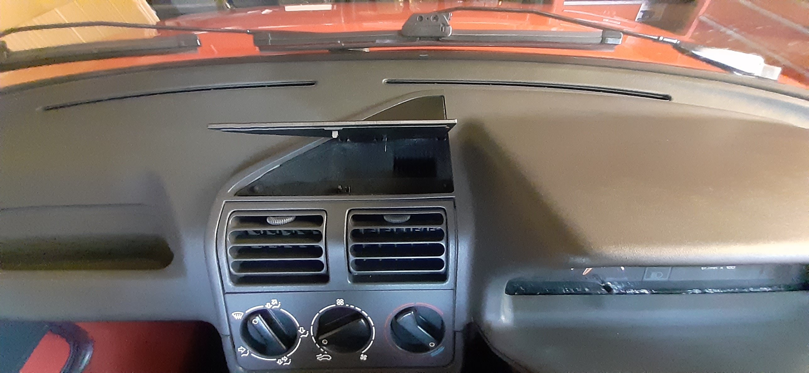

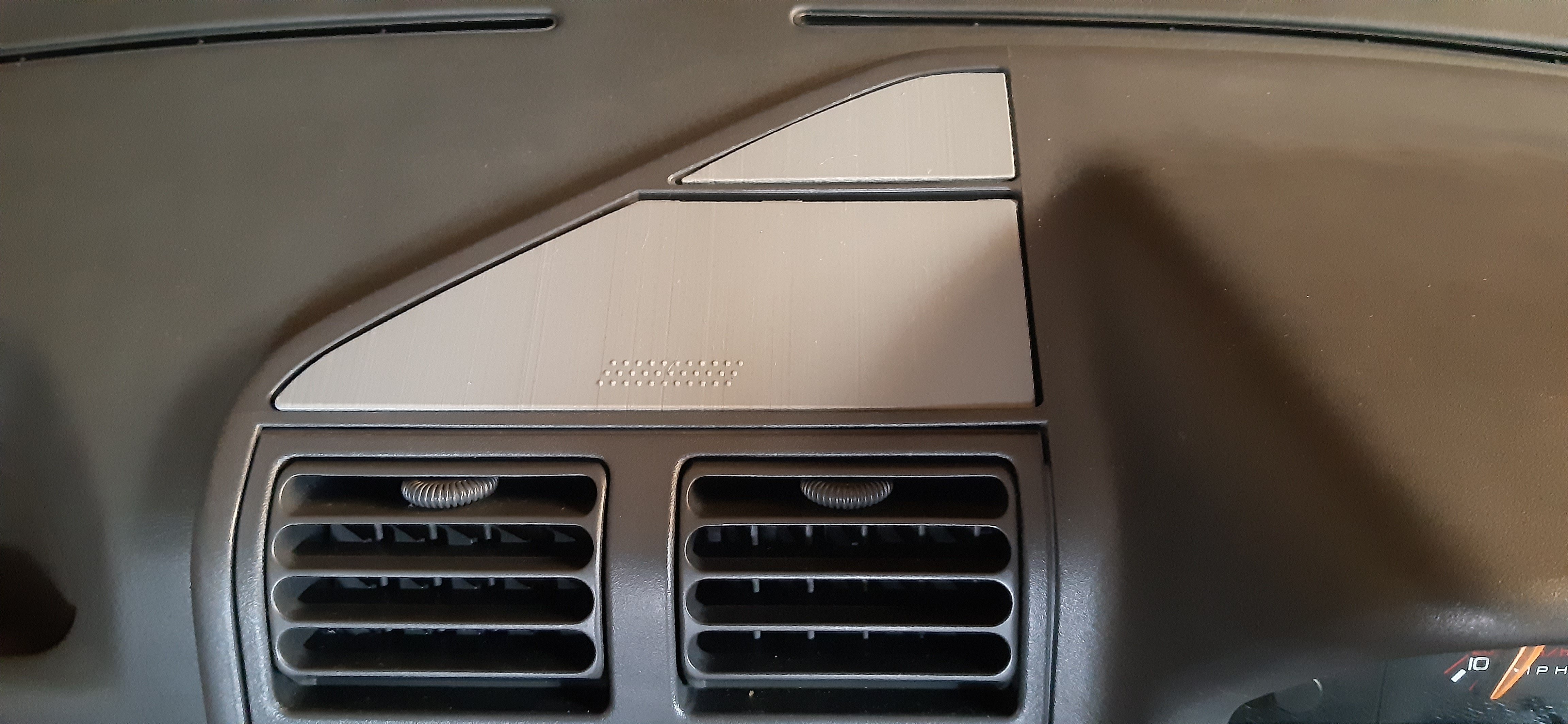

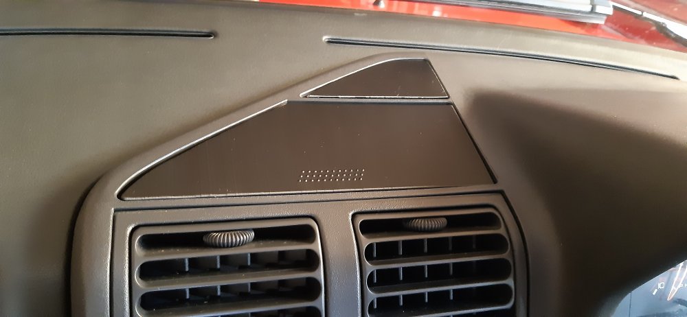

ALEX 100 1 Cars Posted August 8, 2020 (edited) So While waiting for the roll of black PETG to arrive I printed a grey PETG one. I had no idea what shade of grey I would get but it is a bit lighter than the pase 1.5 grey shown in the photos. I did the inside anthracite flock and Ill try it in my phase 1.5 grey dash tomorrow and post up a pic installed. Still no complete black cointrays yet, but wont be long now. For anyone wanting one, complete trays (base & lid assembled, flocked with new clicker and spring) will be £45 posted for forum members. Or if you want a matching little triangle that sits above the cointray aswel it will be £50 posted. Please send me a PM if your interested. Edited August 8, 2020 by ALEX Share this post Link to post Share on other sites

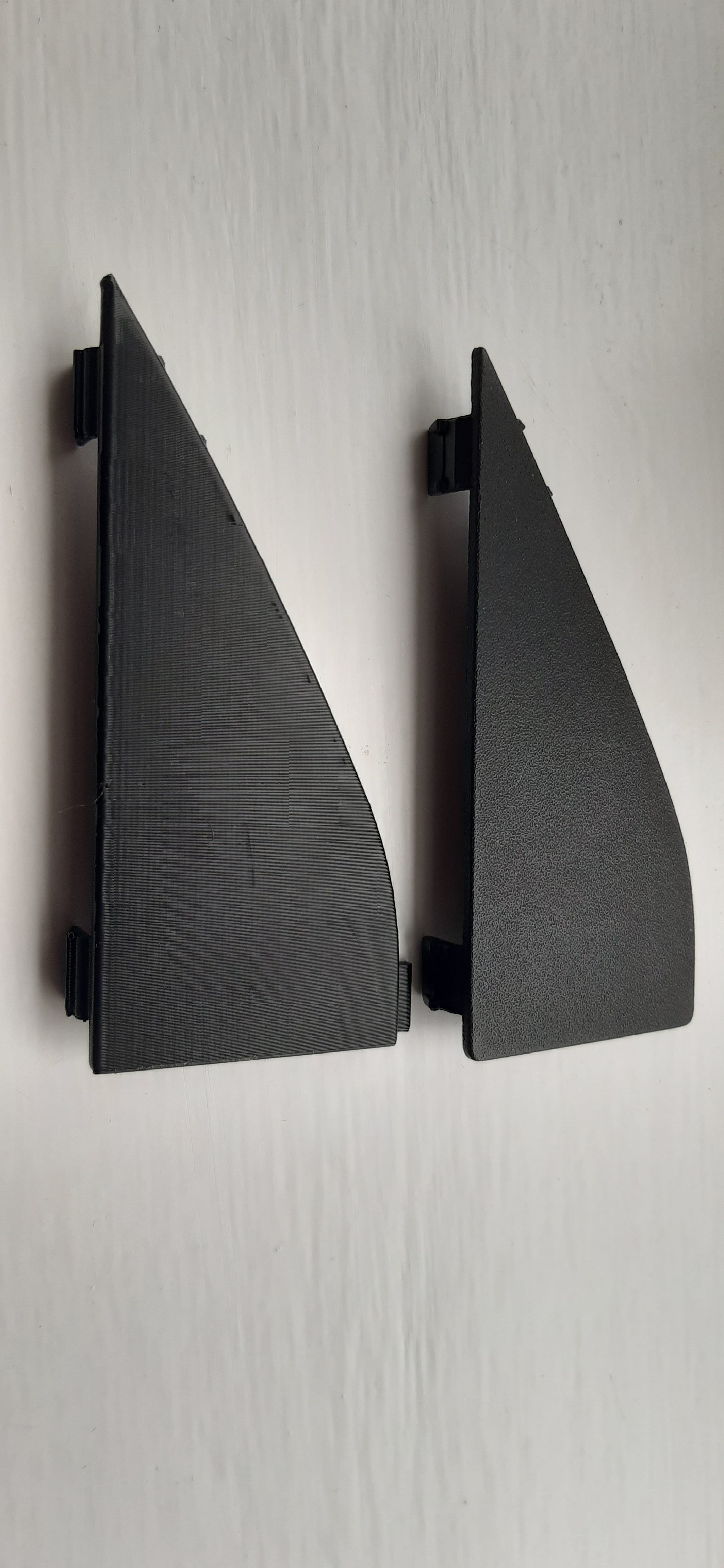

ALEX 100 1 Cars Posted August 9, 2020 So the Grey is too light to match the phase 1.5 grey.. obviously. But what are your thoughts? Noticed a few problems with the complete tray assembly so still a little way to go. Got the small triangle printed in good quality PETG tho. Looks good and fits perfectly. Share this post Link to post Share on other sites
ALEX 100 1 Cars Posted August 10, 2020 Complete cointray assembly made from black PETG shown in a phase 1.5 grey dash. Share this post Link to post Share on other sites

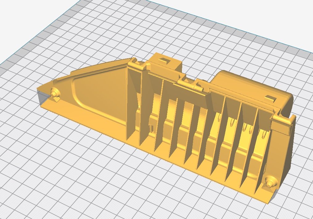

ALEX 100 1 Cars Posted August 30, 2020 For those interested. Here's the reason for the delay on the availability of the trays. The cura default supports waste a load of plastic and looked messy so decided to make my own. The tray design has also been improved..again 2 Share this post Link to post Share on other sites

ALEX 100 1 Cars Posted September 6, 2020 (edited) On 8/31/2020 at 12:30 PM, Gohn said: Geez, that's awesome to see! great work especially encouraging cause the dash on all the australian 205's makes like a violet and crumbles after 20 odd years in the brutal summers/UV conditions your cosmetic improvements are good, only I'd settle for a dash that was actually structurally sound. the australian sun is like a slow motion lump hammer, with timelapse before your very eyes while you breath shallow you will see it disintegrate all of the fixing points break off and the individual pieces crack into ever smaller and smaller pieces I would like to offer my sincere encouragement to do the whole centre console (fascia and subframe too) across to the drivers binnacle I'd pay several hundred for that in glass filled nylon, polycarb, PETG or whatever PLA is, and you can hold me to that PETG seems to be at the limit of what Im capable of on the CR10 printer. I haven't tested the PETG one in the car on a hot day (as the weather has been s*it here lateley) but I've read its good for upto 80°C before going soft whereas PLA goes soft at around 50°C. I used my laser thermometer and it measured 53°C on the melted PLA one above, and Its was about as hot I've experianced it in a car here in the UK with the windows up. I like the idea of a full dash cad model, printing it would be a challenge though.. would probably need to be in pieces and glued together as my print bed is only 300mm (1ft) square, though larger printers are available. If I ever get bored enough it might happen one day, but its probably unlikley as work seems to be picking up. Is Covid19 pandemic over?.. I bloody hope so! :-b Complete tray assemblies are available on ebay, As I get raped by ebays commission I'm selling these at £45 posted complete with the little trianlge. Just send me a PM if youre interested. Edited September 6, 2020 by ALEX Share this post Link to post Share on other sites

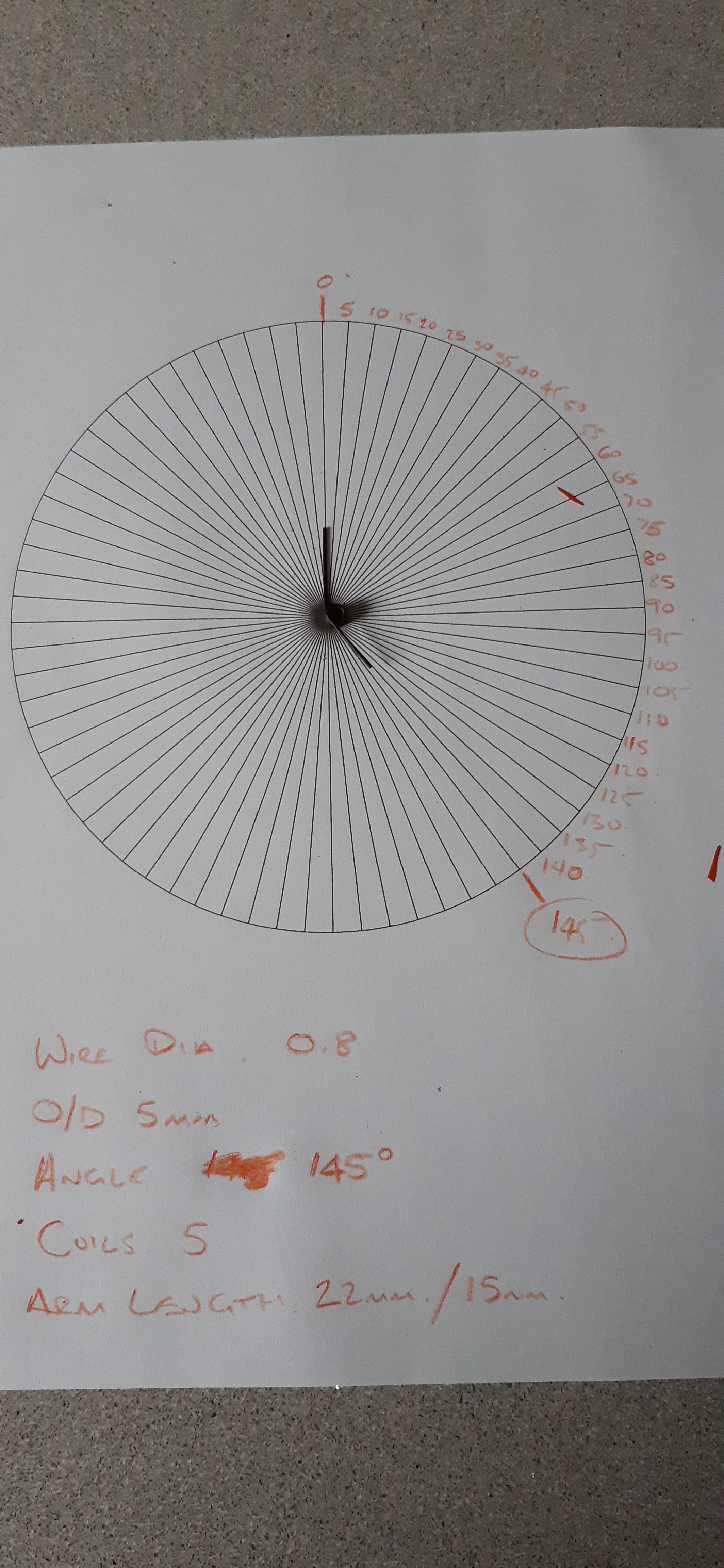

ALEX 100 1 Cars Posted September 6, 2020 On 8/11/2020 at 3:48 PM, stuart_knight6 said: I could do with a coin tray spring though if you know the sizes.... Sorry for the delay. Wire dia 0.8mm Outer dia 5mm Coils 5 Arm length 22mm longest /15mm shortest Angle 145 deg. Share this post Link to post Share on other sites
