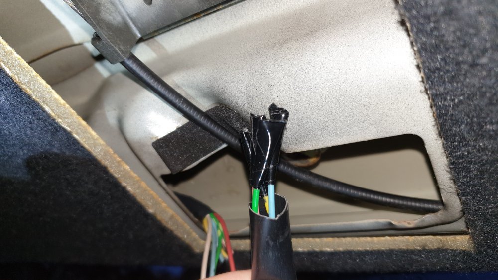

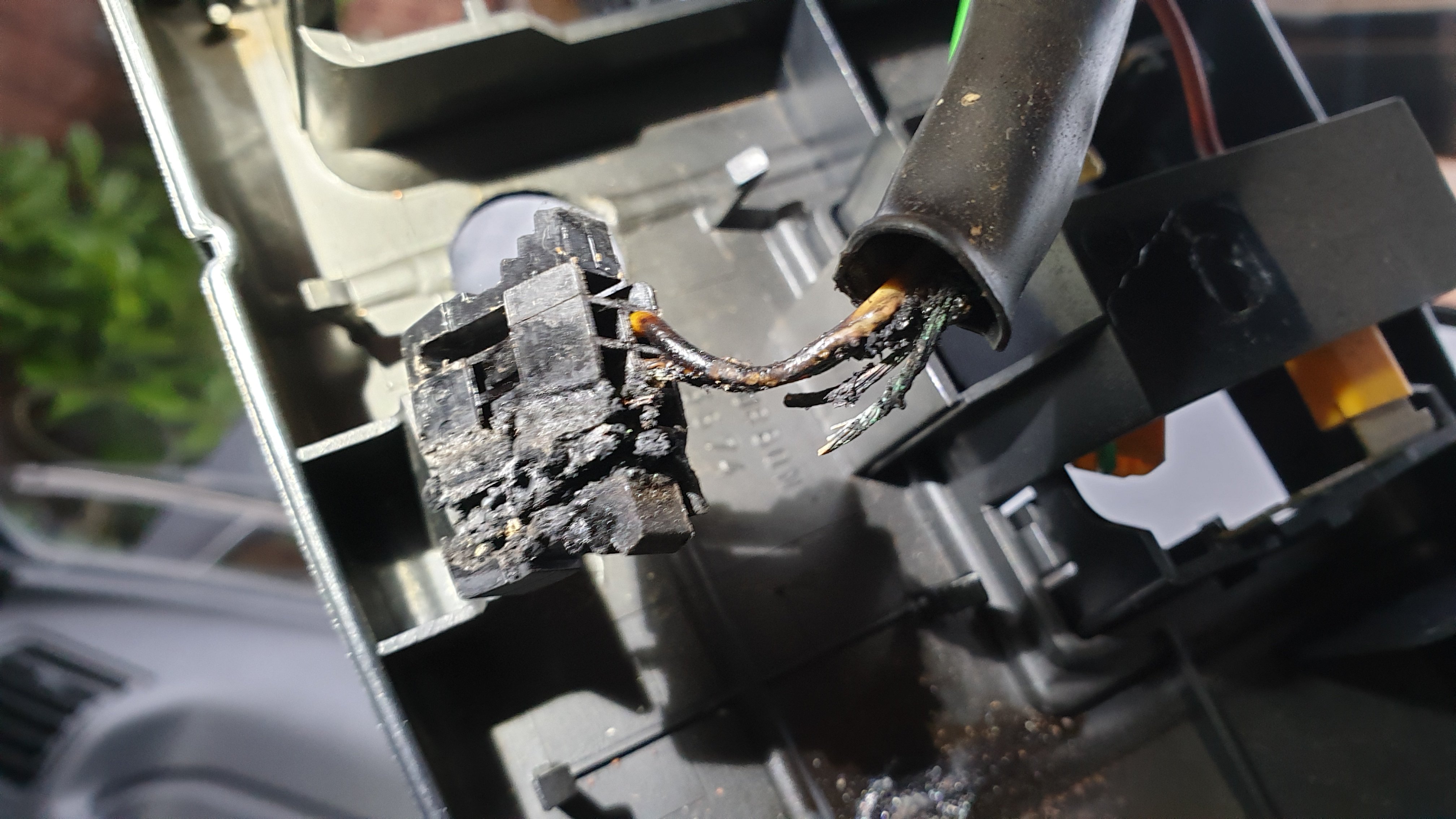

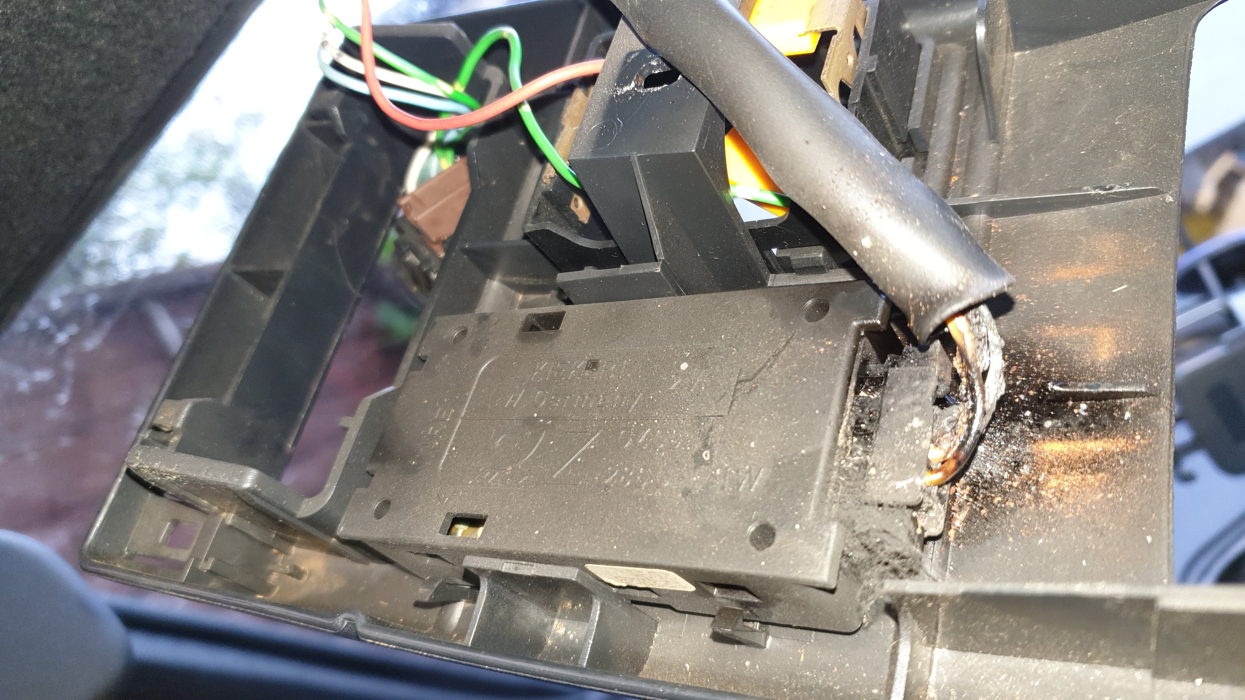

DSYKES5500 22 Posted November 1, 2019 Hi all, While checking for a bad vibration when the engine is between 2000 and 3000rpm inside the car, I pinpointed a big part of it to the sunroof glass. If I push up on the glass, the vibration is almost gone. I thought that I'd push the glass back to check the dash area for more vibrations. When I pulled the sunroof handle down, grey smoke came out of the handle mechanism and it smelled bad, very toxic. I quickly turned off the engine and pulled the positive off the battery. I removed the roof console and found that two of the wires had completely burnt away from the plug that goes into the ir receiver module. The plug was burnt and the console had started to melt. This looked old but the wires must have been touching now and then causing a short. I cut the cables and insulated them. Could the car have gone up if left unnoticed? Will the insulation tape be enough? I've a Toad alarm so the module is no use. Share this post Link to post Share on other sites

jackherer 543 Posted November 2, 2019 Yeah, it's lucky you were even in the car! The remote sensor is always powered up so this can happen at any time. Everyone with a phase two 205 needs to keep an eye on this, even if you don't have a working remote control the receiver is still there and constantly live. I'm going to check mine later today, I think it's OK but I haven't looked for a while. A small fuse added somewhere should stop this happening, the remote sender must only consume a tiny amount of power normally so if it starts burning/melting the fuse will blow. I remember some discussion of this a while ago but I didn't actually do it... Share this post Link to post Share on other sites
pugdamo 112 2 Cars Posted November 2, 2019 I would also like to know what size fuse to put in, I had a similar story, I moved my car to get another car out and when I got back in mine there was smoke coming from the roof console, in a panic I just ripped out the roof console and it was a melted mess in there. Iv replaced everything now but would like a fuse for a bit of piece of mind. Share this post Link to post Share on other sites
jackherer 543 Posted November 2, 2019 A tiny value slow blow fuse would be ideal. Without measuring I don't know what current the receiver drains so I can't say an exact value for the fuse but I imagine it is a tiny amount so the fuse can be a very low value too. Also as it only drains a significant current briefly (while locking/unlocking) the fuse can be a smaller value because it takes a sustained high current load to blow it. The bottom line is that the fuse needs to be small enough to blow before the wire melts which wont be hard to achieve. It's hard to believe that Peugeot built these with an un-fused (or under-fused) circuit in such a vulnerable position. Did you replace all the wiring in yours? If so can you describe where it is routed and where the other end plugs into the rest of the car please? Share this post Link to post Share on other sites
pugdamo 112 2 Cars Posted November 2, 2019 Thanks for the reply, to be honest I could just go as small as possible and worst case the fuse will pop, then I'll go slightly higher. With the wiring, I spliced mine in above the head lining, I got hold of another section of loom and the connector, another IR receiver and the trims (I broke those pulling them out). I'm not sure how far back the loom goes, I guess it goes straight back into the control unit for the central locking and bypasses the fuse board. Share this post Link to post Share on other sites
jackherer 543 Posted November 2, 2019 You're probably right about the control unit, that would be a good location for a fuse too. I imagine it just uses a few hundred mA so a 500mA fuse might be enough and those wires can carry a few amps so they'll be protected by it. Share this post Link to post Share on other sites
