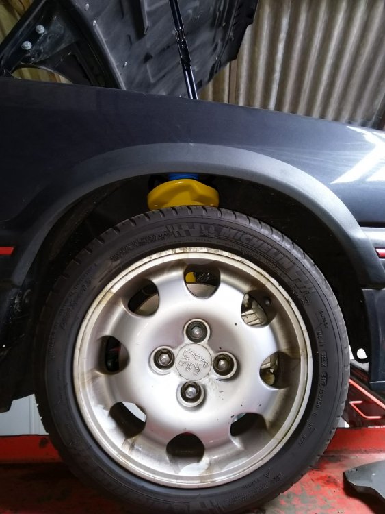

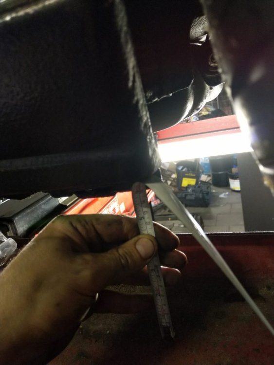

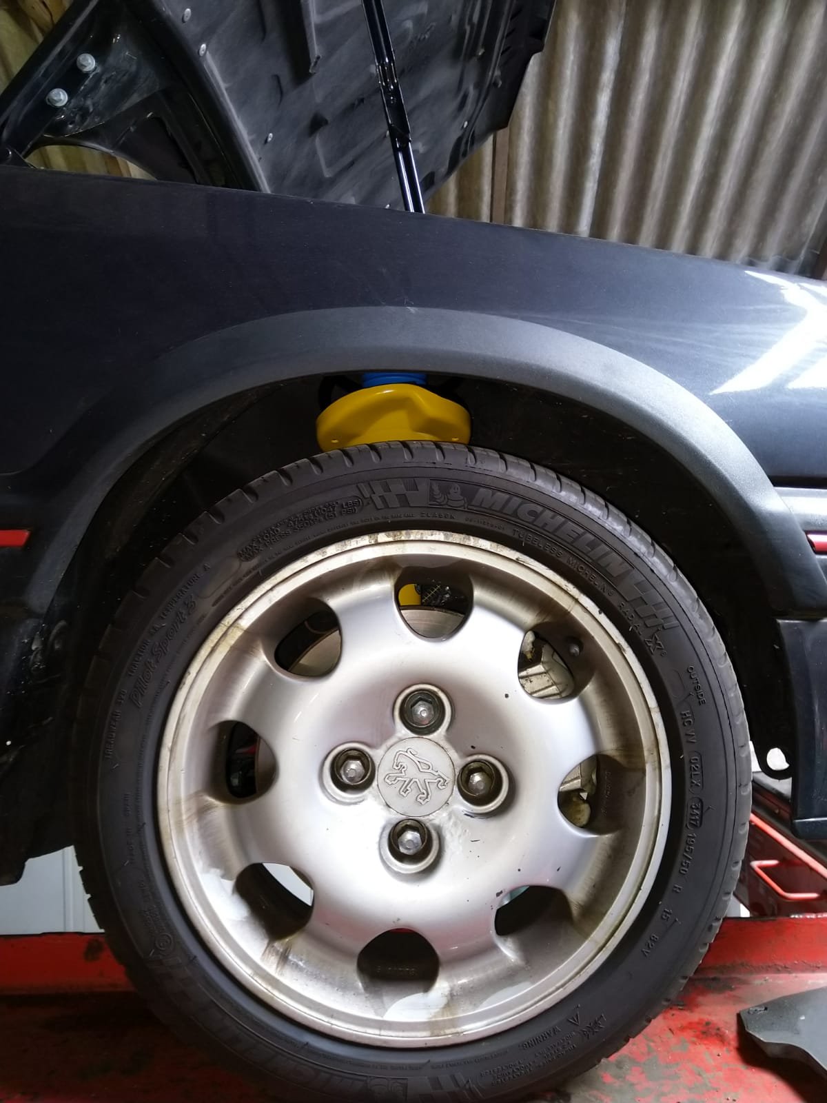

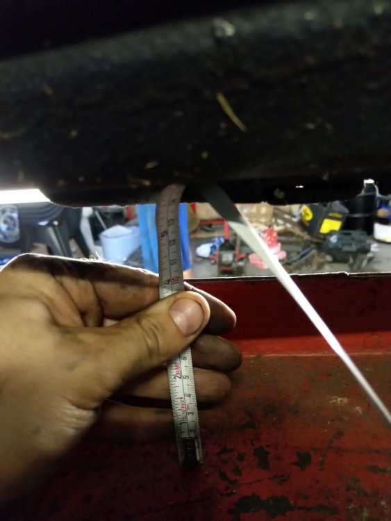

2 hours ago, duurtlang said:
I have brand new Eibach 7025 from a bigger engined 206 on my 205, with normal Bilstein B6s from a 205. I do have to note that I have a CTi with a 2.0 turbo in there, so a lot more weight. Given those circumstances  it's not lowered that far at all.
I do have to add that this has been installed this week. I have not had the opportunity to actually drive the car spiritedly yet. The angle of the picture doesn't really do it justice, it looks lower when you stand next to it.
Great photos! Thanks for that helps visualise it. Cheers
