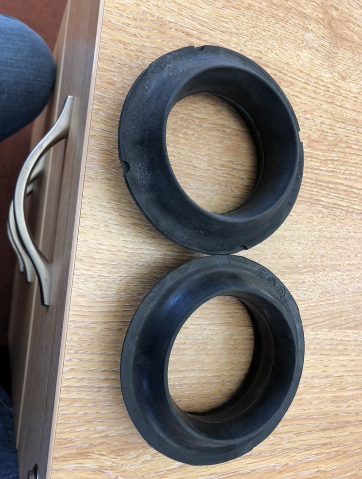

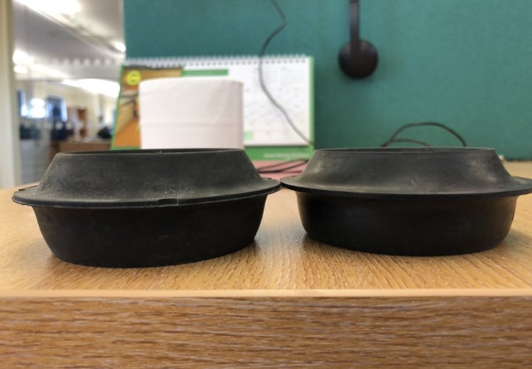

Well I received my bushes today..... they look like two different makes? What do you guys think? Heights slightly different and so are weights and shape
Edited by Porter87
Send them back and never buy anything from spoox again.
  • Like 3
Porter87
Just measured the heights and there is 4mm difference.  Just spoke to spoox they’re going to send out a replacement
Edited by Porter87
