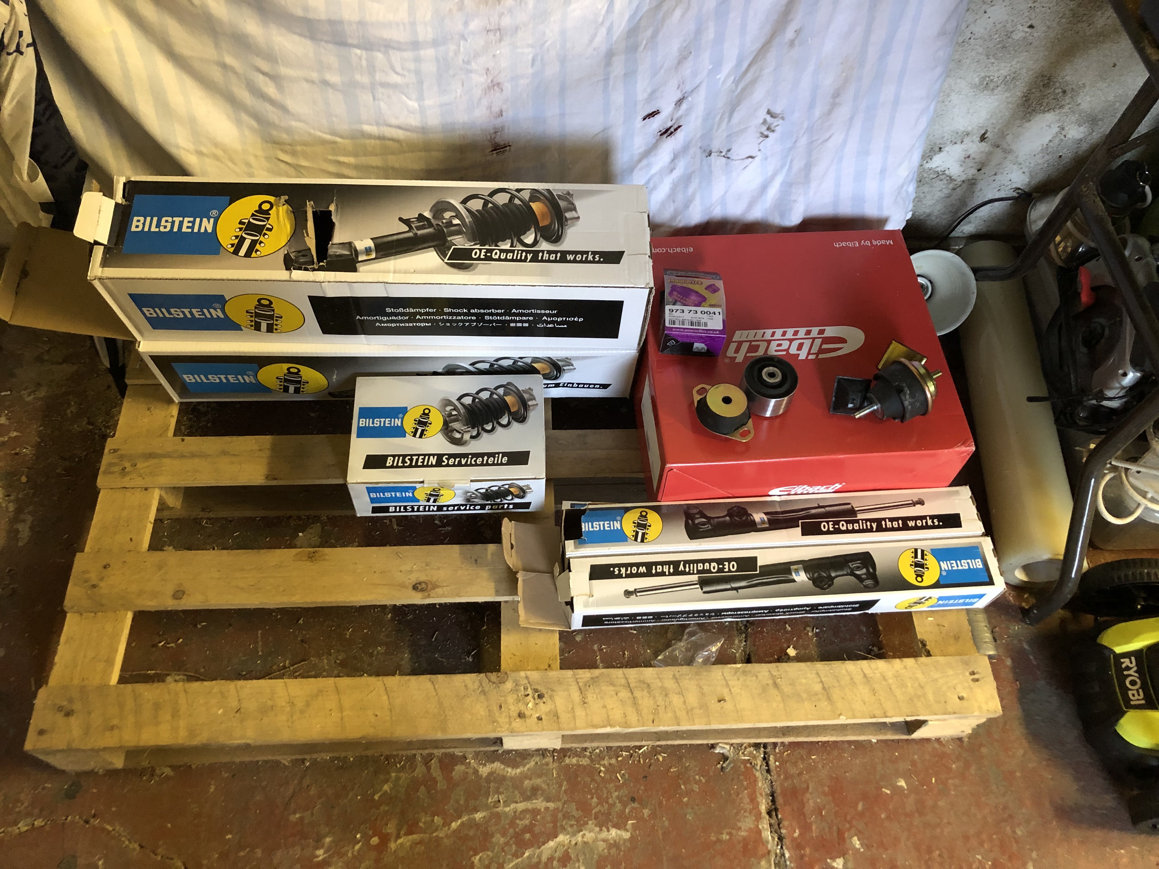

Porter87 18 Posted July 10, 2019 Thanks a lot guys, will be attempting this tonight. Mine also has the cap on Had at a few more parts turn up so I best start fitting something haha I was going to go for b6 but what I’m going to be using it for doesn’t really warrant it. The only thing I’m still unsure of is the ride height with the eibachs also got myself some 1.6 alloys. What’s the best tyre for the 14’s? It Looks like most are eco tyres Share this post Link to post Share on other sites
Tom Fenton 1,650 Posted July 10, 2019 You will likely need to lower the rear beam approx. 30mm to match the front. Makes the 205 sit as it really should as opposed to the standard ride height which looks a bit ridiculous. I run Goodyear Efficient Grip Performance on my 14" wheels, I'm happy with them. 1 Share this post Link to post Share on other sites

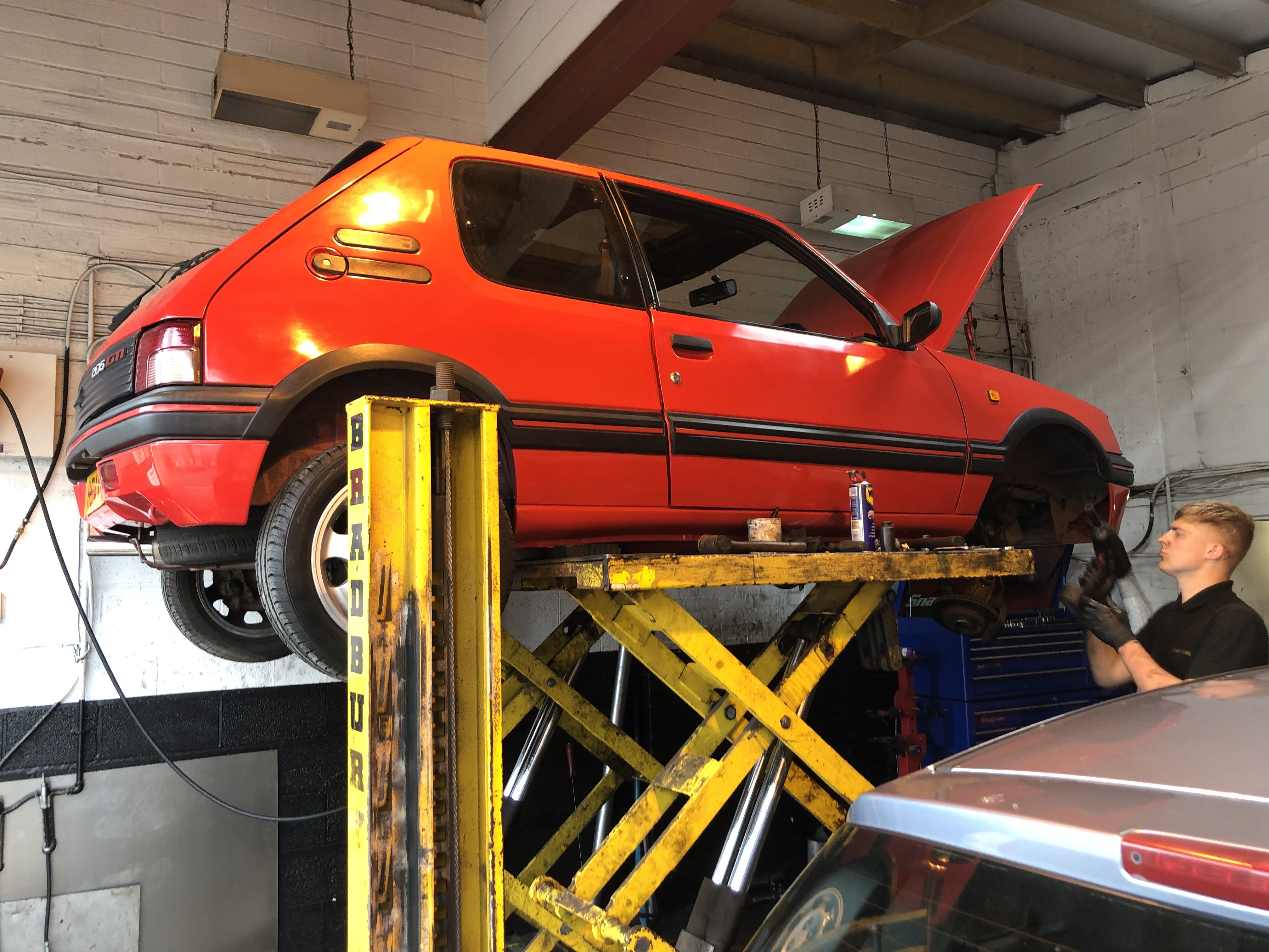

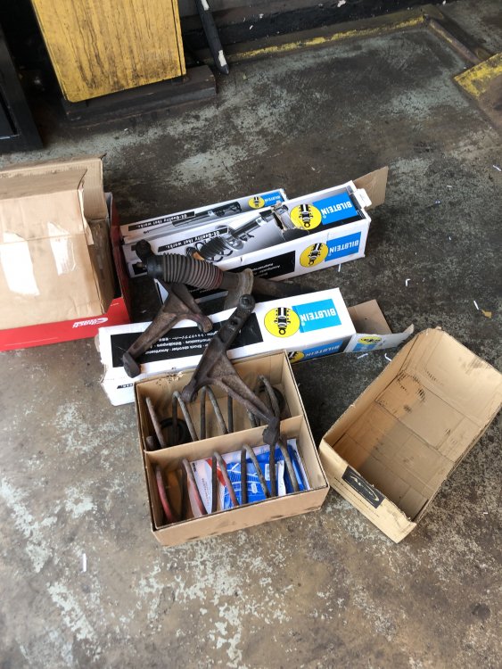

Porter87 18 Posted August 8, 2019 I managed to get a productive day on the peugeot yesterday with the help of a friends ramp. The work carried out was > new “fast road” Bilsteins b4’s fitted with eibachs > new top mount bearings and rubbers > new drop links > new wishbones > new polybush anti roll bar mounts > new tie rod ends > fast road bbm engine mount kit Car feels pretty tight now, just need to get the tracking sorted then I’m about there on the suspension side of things. The top engine mount was split in two! Explains the moment Getting there slowly Share this post Link to post Share on other sites

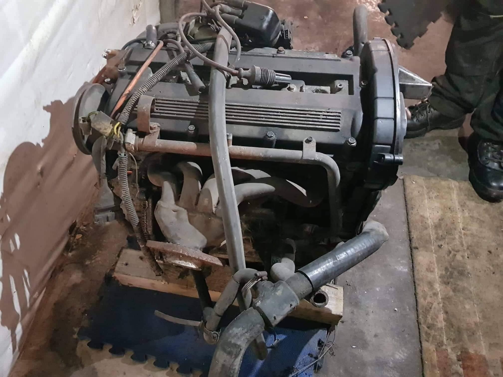

Porter87 18 Posted August 11, 2019 Well just bought my self a mi16 engine. Next task is getting it cleaned up and fresh, then installed. I’m going for the 4 branch exhaust manifold and going to keep the inlet the correct length i think. Any tips on fitting will be greatly appreciated :-) Share this post Link to post Share on other sites
Andy 105 1 Cars Posted August 12, 2019 Whilst you are cleaning it up, may I suggest a new belt, tensioners and water pump for starters . Next, a 4-2-1 exhaust is nice to have, but beware of bulkhead/ tunnel clearance . Be prepared to trial fit first. Some cars are fine, others need some bulkhead work to clear . I presume you know about the wiring changes needed for the instrumentation . Some good guides on here . The xu9j4 engine is a lovely transplant for the 205 . I assume you have the ecu and loom for this engine and plan to run it on o.e management . look forward to meeting you one Monday evening at the Highwayman if you can make it. Next meeting is Monday 19th Andy Share this post Link to post Share on other sites
Porter87 18 Posted August 12, 2019 5 hours ago, Andy said: Whilst you are cleaning it up, may I suggest a new belt, tensioners and water pump for starters . Next, a 4-2-1 exhaust is nice to have, but beware of bulkhead/ tunnel clearance . Be prepared to trial fit first. Some cars are fine, others need some bulkhead work to clear . I presume you know about the wiring changes needed for the instrumentation . Some good guides on here . The xu9j4 engine is a lovely transplant for the 205 . I assume you have the ecu and loom for this engine and plan to run it on o.e management . look forward to meeting you one Monday evening at the Highwayman if you can make it. Next meeting is Monday 19th Andy that's the plan, I'm even thinking of getting a rebuild to be honest. I've got a few full wiring sets, one recently off of Stuart along with the 2 row ecu which should be an easy swap. plan is to run it on OE management to keep a reliable engine build. My last one i had was on twin 45's but used to like to play up. I'll try to get down on the 19th. I missed the last one due to traveling with work Share this post Link to post Share on other sites
Andy 105 1 Cars Posted August 12, 2019 Right. Job number one is to do your homework. By that, I mean check what you already have. Not just the loom , but all the relevant sensors, the inlet manifold and throttle body. Is it a throttle pot or an air flow meter. Whichever, ( probably the latter) , make sure you have it/ them. Miles Horne does a nice 4 branch for this engine in a 205, but another option is to use the 8-1 that you have an a Peter Taylor wedge plate ( cheaper and works an absolute treat ) .Also make sure you have the LH engine mounting ( looks like you have in the picture ) , distributor , coil and ignition amp . Your 8v alternator and starter motor will be fine As for an engine rebuild , remember that the costs can add up. Off the top of my head, they go something like this. Full set of gaskets.........£130 crank bearings plus thrust .......£60 clutch..........£100 belt, tensioners and water pump........£130 piston rings .........£90 liners ( budget for new ones ) ....£200 machine work( allow for head skim and block deck with liner seat reface to get the liner protrusion correct ).....£150 valve guides and valve seat recut......£120 valve springs .....£100 All this above assumes that the pistons are good, the crank does not need a grind, you are not going to have a full engine balance ( another £250if you are ) , the valves and cams are o.k and the that pistons are in decent shape ( they usually are ) . In addition, the above assumes that you are doing this yourself. If you are employing someone, they naturally you will get a quote, but assume the above plus labour and sundry items . 1 Share this post Link to post Share on other sites
Porter87 18 Posted August 12, 2019 (edited) Thanks Andy, I have so far three wiring looms (one properly converted) three ecu’s (1x2 row, 2x3 row) 2 AFM 1 coilpack 3 full length manifolds 1 shortened manifold engine mount upgraded bbm engine mounts mi16 engine (arriving next Monday) 1 ignition amp 1 mi16 starter motor what I think I need to buy us the 4 branch manifold from Miles and the rebuild stuff/service parts. Getting there slowly but it’s progress. After this it’ll be a full respray! £££££ haha While on do you guys have any tips for fitting PAS on the mi16 engine? I already have PAS on my 1.6 8v, it would be nice to transfer it to the mi16 set up. Cheers Edited August 12, 2019 by Porter87 Share this post Link to post Share on other sites
Andy 105 1 Cars Posted August 12, 2019 Pretty well stocked then . Good place to start. You will have discovered by now that 205’s are to money what black holes are to matter or light . Andy Share this post Link to post Share on other sites
jackherer 543 Posted August 12, 2019 39 minutes ago, Porter87 said: While on do you guys have any tips for fitting PAS on the mi16 engine? I already have PAS on my 1.6 8v, it would be nice to transfer it to the mi16 set up. Cheers If you can find an Mi16 pump that's the neatest solution, it mounts above the gearbox and is driven by the exhaust cam so the packaging is really tight. But finding one is the issue, most Mi16 engines were from BXs so they didn't have PAS pumps in the first place and not many 405 pumps and brackets have survived. I've fitted loads of 106/Saxo electric PAS pumps to 205s and I learned a while ago they were actually standard on some late non-GTI 205s in other countries so it could even be considered a period modification... 1 Share this post Link to post Share on other sites
