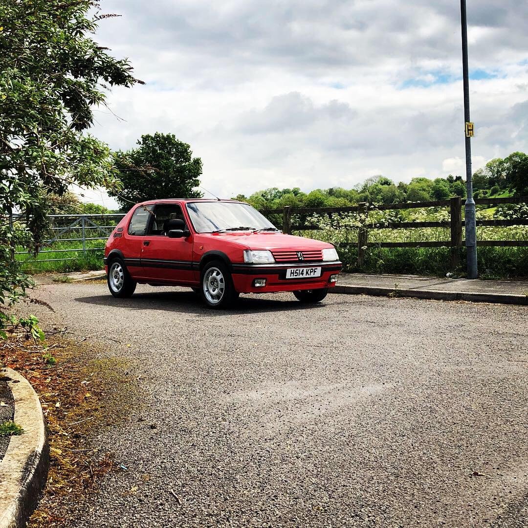

Hi all,
This is going to be an ongoing thread about my 205 Gti I’ve just purchased. The idea is to have a tidy fast road car that I can use on weekends, to teach my little lad about “old” car mechanics and to give him the car once I’m too old and broken to drive it. I’m unsure whether to go down the 16v route or go for a tuned 1.9 8v set up, either one will be on carbs or throttle bodies.
I got permission from the boss (the mrs) to buy another 205 after I sold mine in 2011 to fund a house purchase. I couldn’t believe how much the price had gone up! I sold my track prepared 205 mi16 running around 200bhp for £3,500, looking now for a similar none tracked version I was shocked to see how much they were going for.
Anyway i I went to see 4 cars, one Gti 6 lumped version and three 1.6 versions. The last one (which I bought) looked and drove pretty well compared to the rest when I went to see it so ended up buying it for £3,700 (in the rain, this will apply later) It needed a few things doing like the back end raising up and a drive shaft from what I could tell. It came with 1.9 alloys, 1.9 rear beam, full leather front seats, full stainless exhaust with four branch, all of which i wanted (except the exhaust) and looked pretty good body work wise.
I drove it back from Manchester to Nottinghamshire and it didn’t miss a beat.

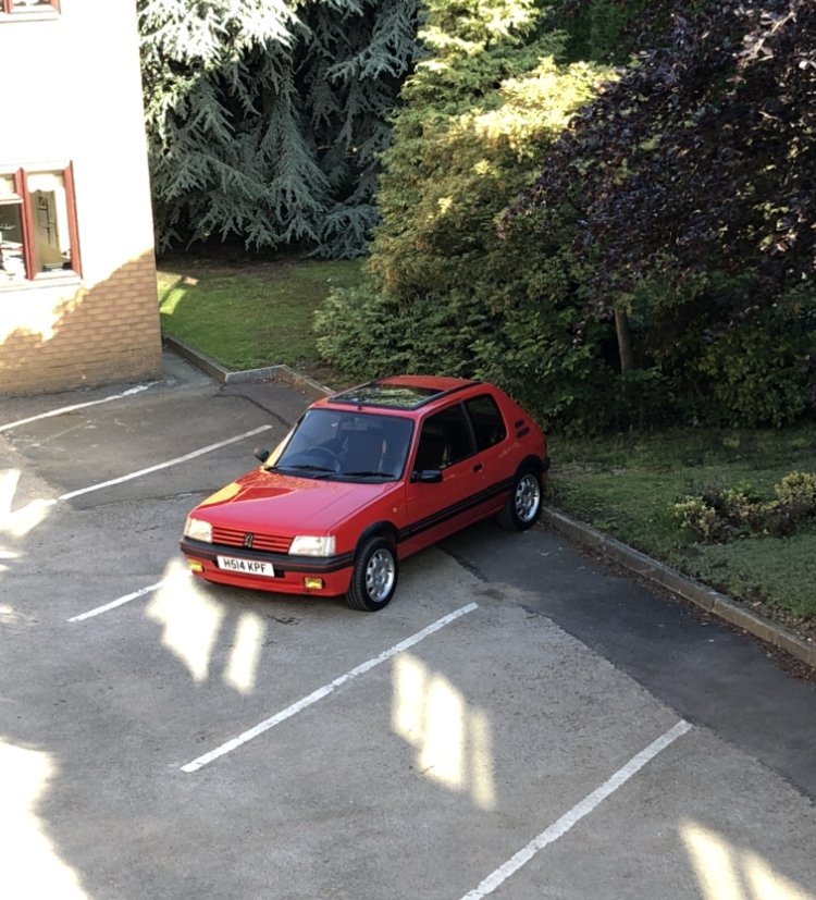

Then the weather dried up, so I decided to give it a polish...... what a mess! The body work was riddled with little dents, paint imperfections and just down right a bad paint job! I was gutted, never buy a car in the rain or trust a picture! A full respray will be coming this summer I think
anyway after a couple of runs out I noticed a smell of fuel, the lines that run down the side if the tank had split, first issue found, easy resolved with some new fuel lines and some cut fingers.
I then noticed a few more issues!

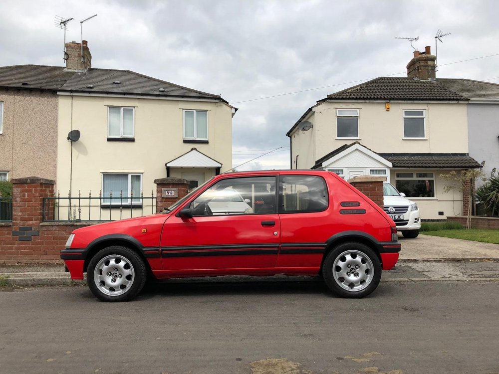

I now  turned my attention to getting the rear beam raised, time to get the torsion bar headache tablets out!
To my surprise they came out pretty easy! I was well pleased. I’ve decided to keep the ride height standard.
Really happy with how it now sits.

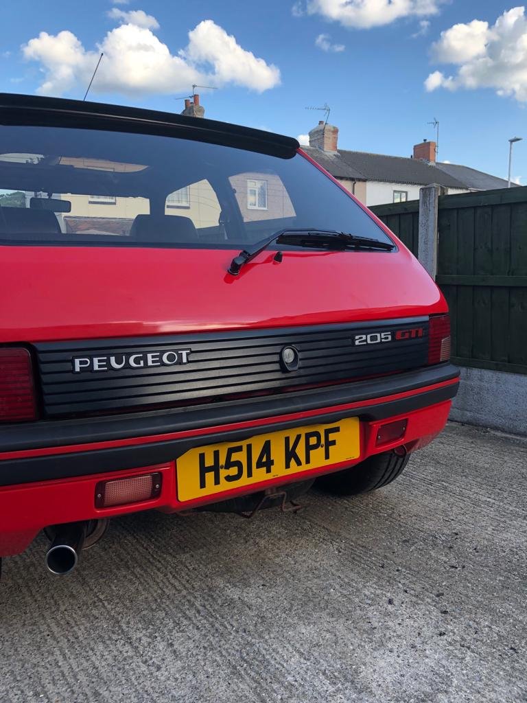

With the rear beam and fuel lines sorted I spent a bit of cash on my old favourite mods. Yellow fog lights and bulb covers. I just love them! I also ordered a o ring for the distributor, a new wing mirror, new peugeot rear badge and a new air hose from baker bm
once delivered I cracked on fitting the fog lights, wing mirror, Peugeot badge on the rear and o ring.

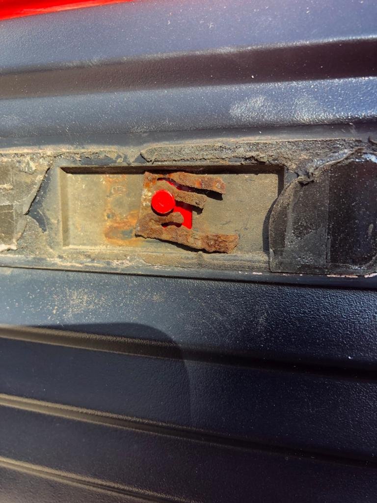

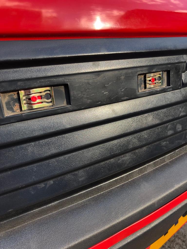

I removed the old faded Peugeot badge on the tailgate trim to find all the clips had broke. So I ordered a full set from Peugeot.

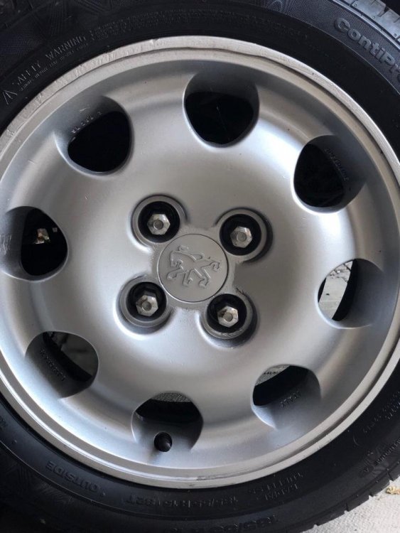

Had a few parts delivered today

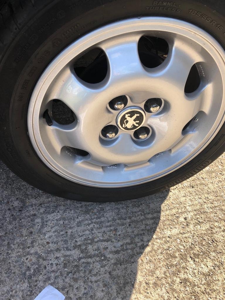

proper centre caps, new badges for the tail gate and new clips for the trim on the tail gate

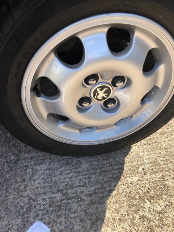

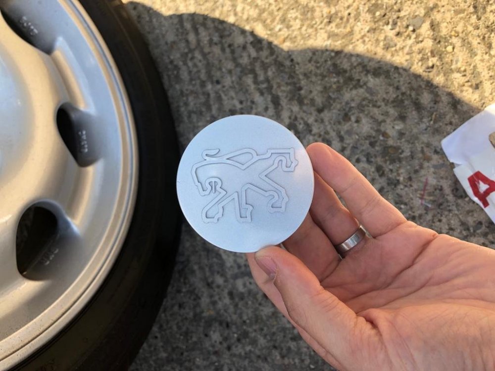

I started with centre caps as the wheels had some weird looking caps on them
Pulled the caps out to find that they had used what look like an old spray can lid with a Peugeot sticker on them?! Who does that!
New caps look 10 times better

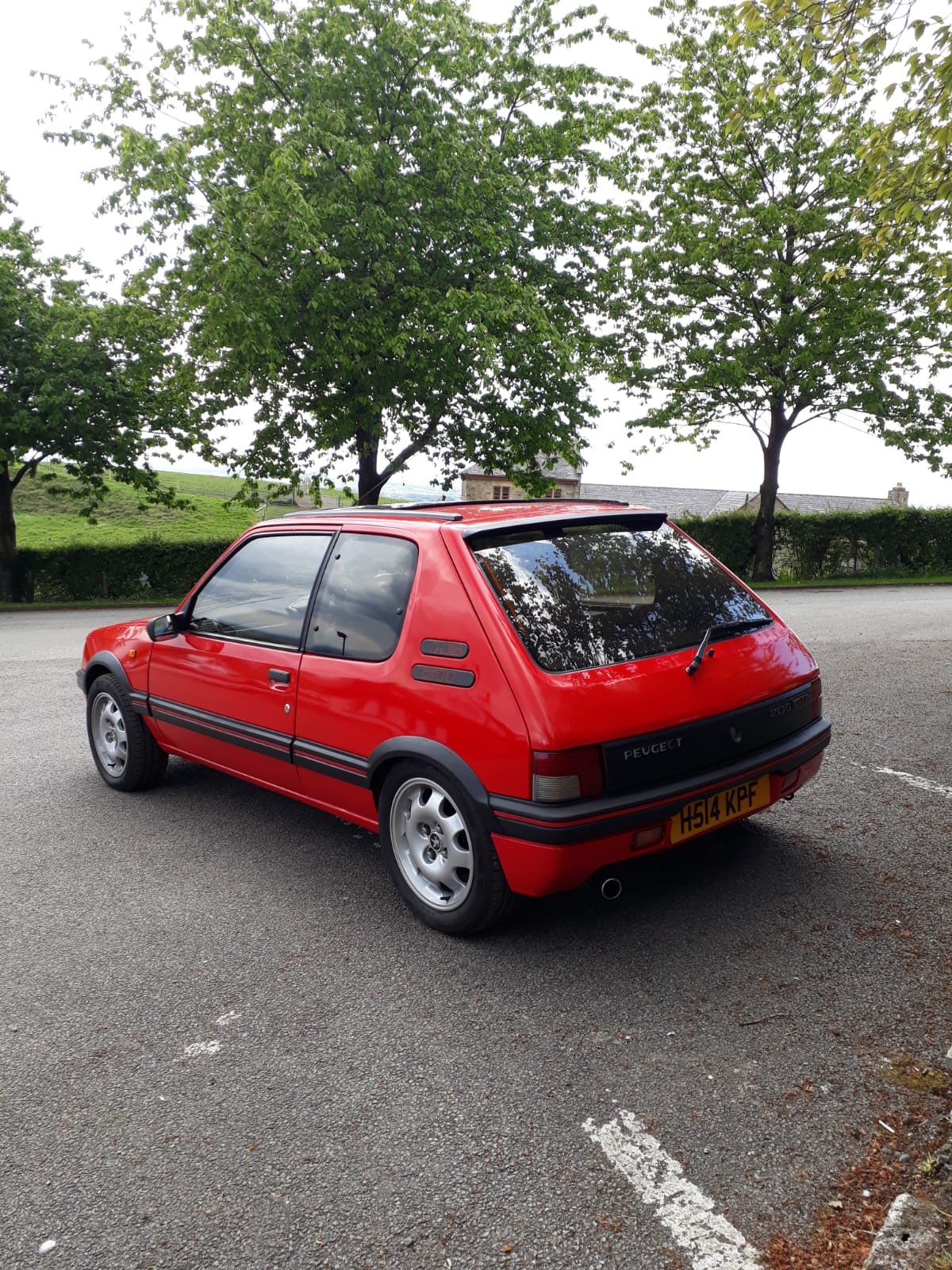

Once these were fitted I removed the badges on the back. They just looked tired. As I suspected the clips were pretty much Brown dust
I removed all the left over sticker pad and put the new clips on
Next was to put the badges on, looks loads better on the back now. Just need some new light clusters I think.

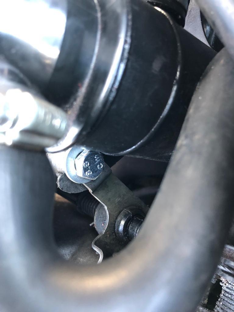

With all that done I git around to putting the m8 bolt back in the inlet manifold.
The car runs better now but also idle’s about 1500rpm now! Bugger

If your idle has gone up the bolt isn't sealing up right, what was in there before?
Those hubcaps are hilarious, I can see why you changed them :lol:
Telf
Those hub caps are some of the funniest pug related randomness I've ever seen! Brilliant and also very crap.

 I'll check the bolts are tight when the linkages come, they are on a 2 week back order from miles at the mo.  the bolt wasn't in there before and idled ok, I'm guessing the previous owner had set it up without the bolt in?  it was such a hard decision to get rid of the centre caps :lol:
I honestly could believe them when I pull them out the wheels! best thing each cap was a different lid haha!  stuck in with silicone :blink:

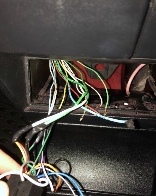

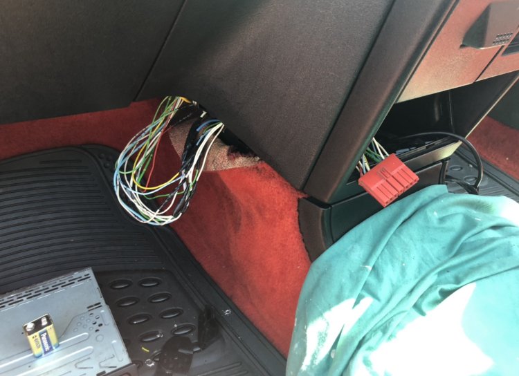

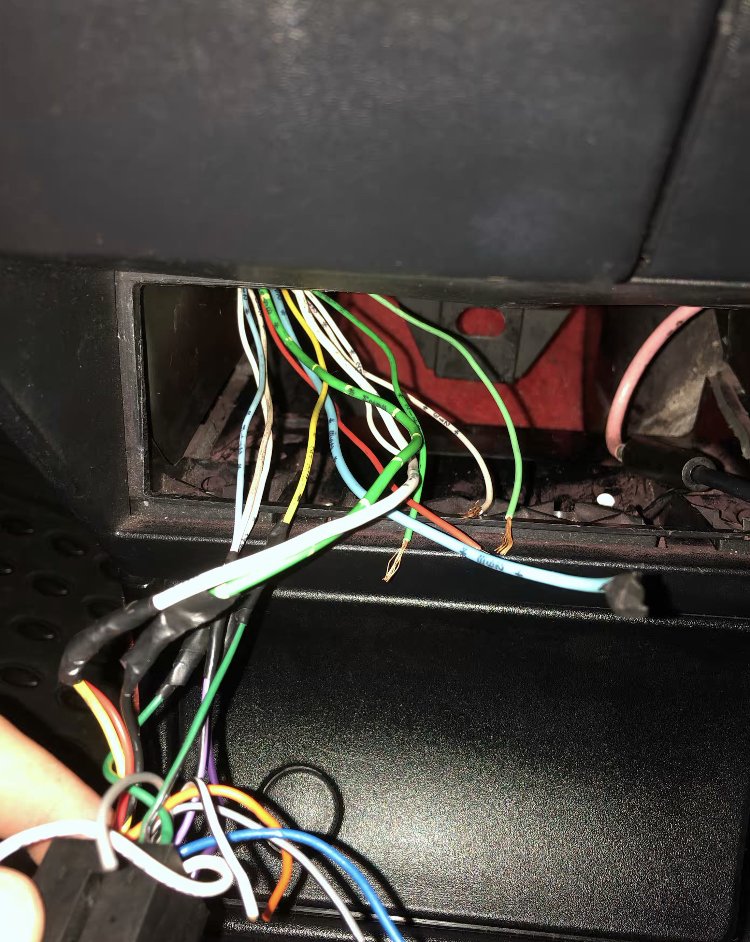

Also the radio never worked so I pulled it out to see what was going off, I need to do a bit more research before I tackle this haha! I want to put an original cassette player back in if I can find one

Keys, get hold of Colin, he can re tumble your locks so they all work off one key.
Original tape player, honestly, don’t waste your time or money. The sound to modern stands is awful. Unless it’s a true concours car.
That sounds like a plan! All door locks and petrol cap are the same key, it’s just the ignition. How do I go about getting in touch?
Ill try try a stereo to see if it’s just the head unit that is knackered. I’ve found a original plug on the bay, is it worth soldering the original plug back on and buying a conversion lead?
Colin is Leet205 on here.
stereo wise if you want my honest opinion buy an iso plug kit off eBay and crimp that onto the 205 loom, then plug in a modern stereo. The originals are now expensive to get hold of but still s*ite.
Thanks Tom, I'll get the multi meter out to see if its the stereo that's broke or something to do with the wiring

Wired up the original red plug connection for the radio today, just waiting on the stereo to turn up now
