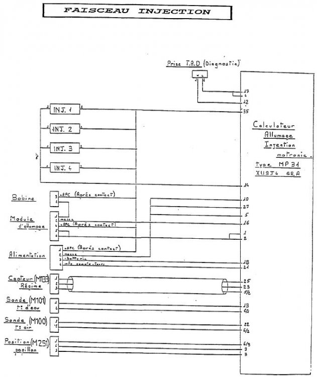

wiring diagrams have been posted on here a few times already for the MP3.1, from the zx and bx iirc, and a scan by a French member of a 106 diagram

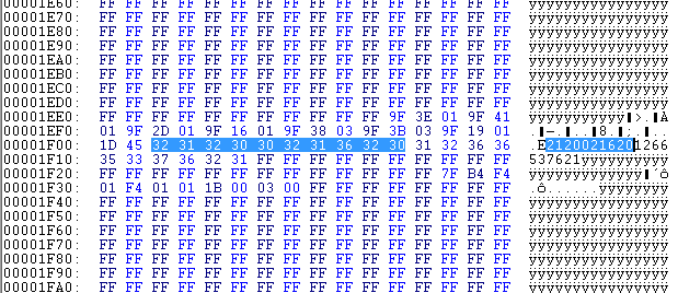

At last I found one for free on the web, the elusive ZX 1.9i .bin file.
On a 8 bit Motronic file you can find the (reversed) ECU part number in ASCII. Here it's at  #1F02 and it's the right one.

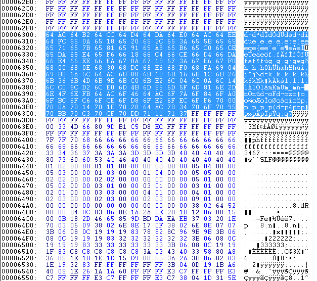

I don't have a .xdf file but the table of maps starts at #6300

ECU part number and software revision are here:
And the maps are listed here:
The first map is at #64AC but the code will only look at the first address on the map list to find it so you can move the map around the file as long as you keep the list updated.

Aaah the infamous table of tables. I should have a tool somewhere which generates a XDF from the table of tables in the binary. It was written by a user called PRJ at Nefarious motorsport, I'll have to see if I can find it on one of my laptops later, it was quite a while ago since I last used this. It didn't work that well and I've later decided to just make my own XDF.
To add to the post of SRDT, if you look at the first address in the table of tables you'll see the start address of a map, in this case 64ACh -> if you look further in the dump you'll see at that specific location the two bytes 38, which is called the header. The next two bytes will give you the length of the axis (and/or table), which is this case is 02h -> 02d. So this table contains 64h and 52h as it's axis, the other 8 bytes are 80h and 80h which are the actual values of that table.
x axis:64|52
y axis:80|80
To double check you can look at the next 4 bytes in the table of tables, which is 64B2h -> this is where the next table starts. If you look in the dump at that address you'll see that are the two bytes next to the 80h of the first tables we've just found.
The motronic ECU reads the axis and table data in reverse and uses conversion factors, which depend on which header the table has. So it reads the last value of the table and subtracts the value of the cell next to it. If one wants more explanation I'd highly recommend using the wayback machine in combination with motronic.ws. It took me _al lot_ of time to get a little understanding of how these ECU's operate and if I knew how much time it would have taken me to get to this point I'd probably wouldn't do it again :'). 3B is RPM and conversion factor is 40, have a go at the dump posted by SRDT.

I have an mp3.1 loom i think is from a BX gti, i has the big brown double relay. I was looking for the pin outs for the relay but can't find wiring diagrams, or the ones i do find  the links dont work any more.
Can any body help.
Thanks Gavin
there's a diagram in the pdf on the first post in this thread.

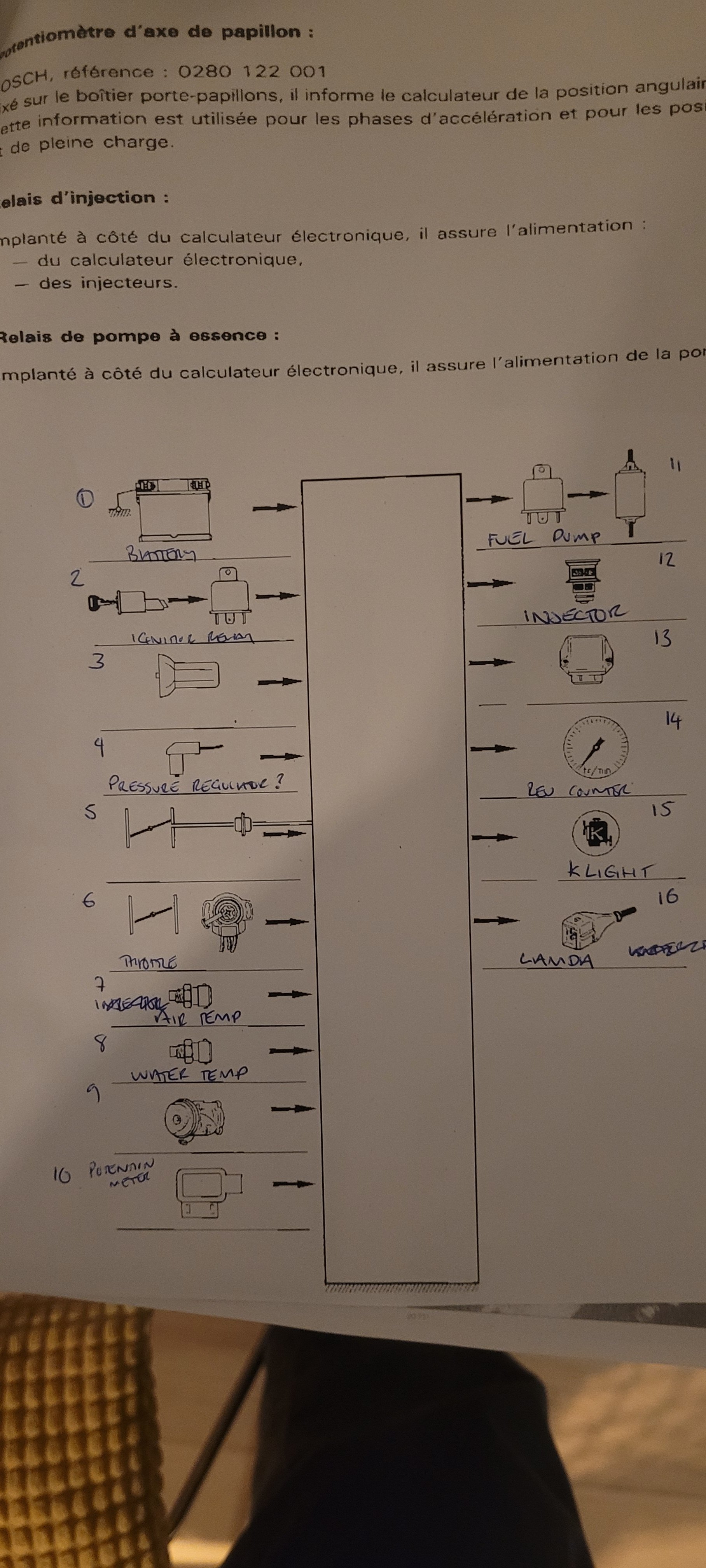

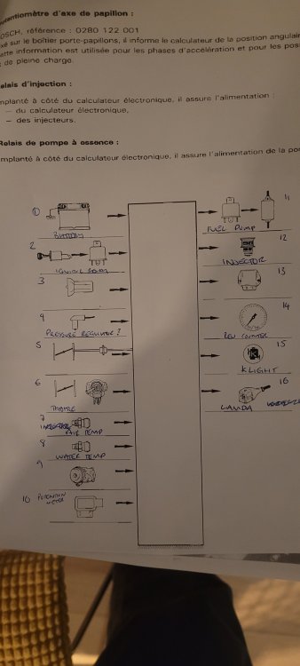

Gavin Waddell
If you mean this one ? I saw it, but it doesnt have the pin outs, and some of the pictures i dont get what they represent. This is what i can think each one might be but I'm probably wrong on some of them.  Feel free to correct me
SRDT
The pictures aren't that good but you can see and read (though in French) that the BX is using two relays. Maybe they later switched to a double relay, if your loom is really from a BX then it should be pretty long as the ECU was under the front seat.
For a better look at the wiring of the double relay look a the TU3FJ2 pdf.
