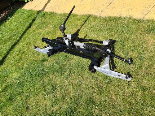

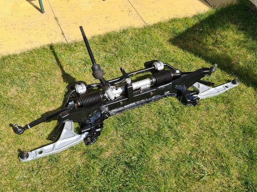

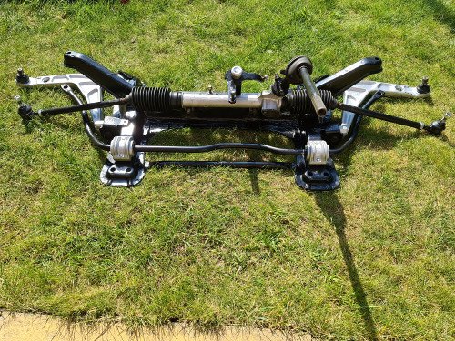

Hello everyone – hope all are safe and well. I’ve taken the opportunity to do some work on the 205 while stuck at home and I hit a major milestone this morning… the front end is finished and ready to go back on the shell :D
20200509_102617.jpg.4b75851467725725a2abd461a94501e6.jpg  20200509_102645.jpg.17e55881e5efe82e48c3dcf1671a04a3.jpg  20200509_102714.jpg.dd39d2543b8b42250ac2925cc4a4834e.jpg
Here’s the story in (lower resolution) pictures.
Making sure the tracking isn't too far out for the drive to the MOT station once the new track rod ends are fitted.
The starting point - although I had pressure washed a lot of the crud off already.
Before and after testing the wire wheel on one of the lower arms.
The stripping station - and not the good kind.
20200425_120804.jpg.1151ca883436b36b7a03f6f108418726.jpg  20200425_120811.jpg.d0bdf471f2126782f77c68de1e136652.jpg

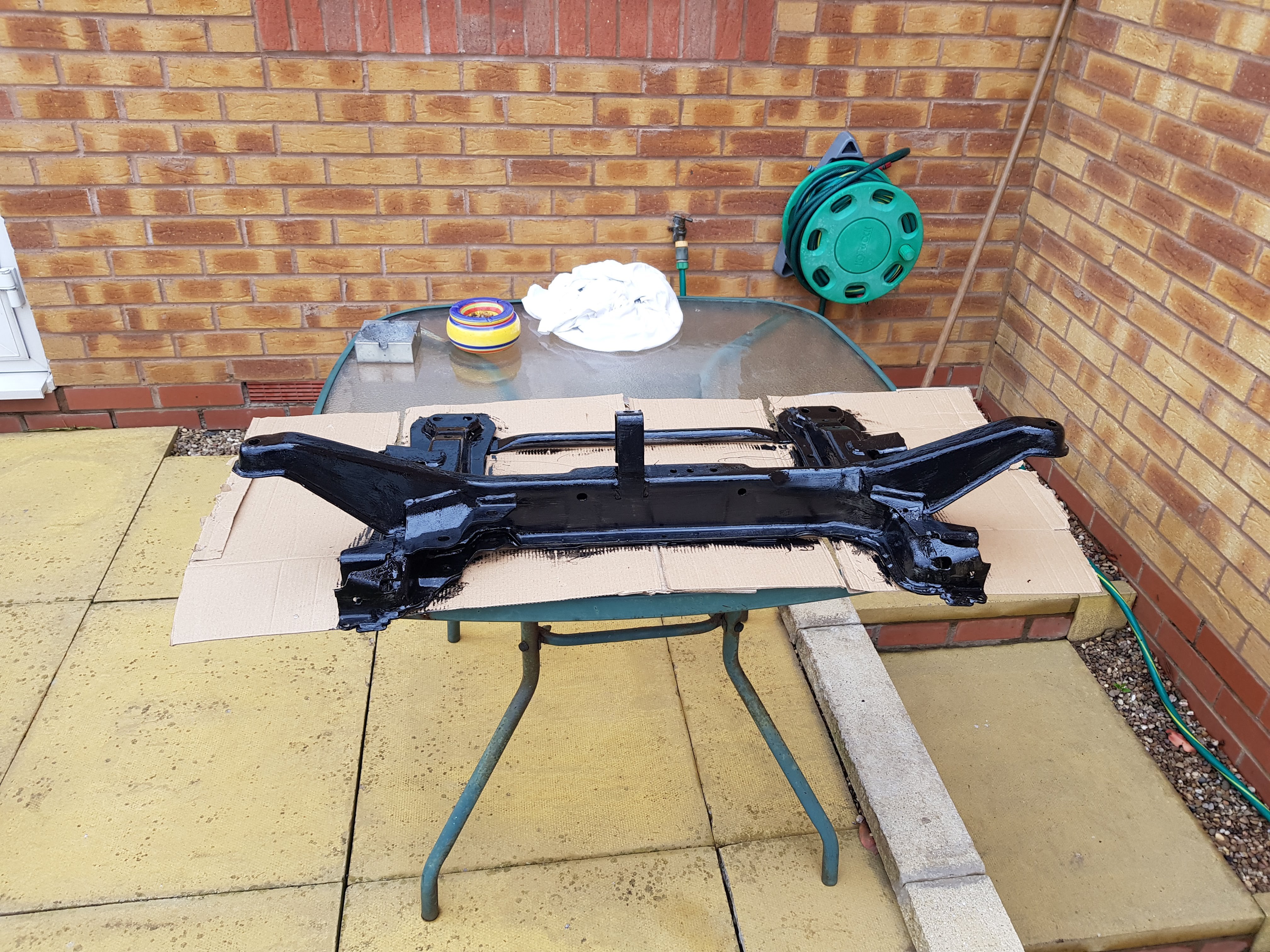

One stripped subframe.

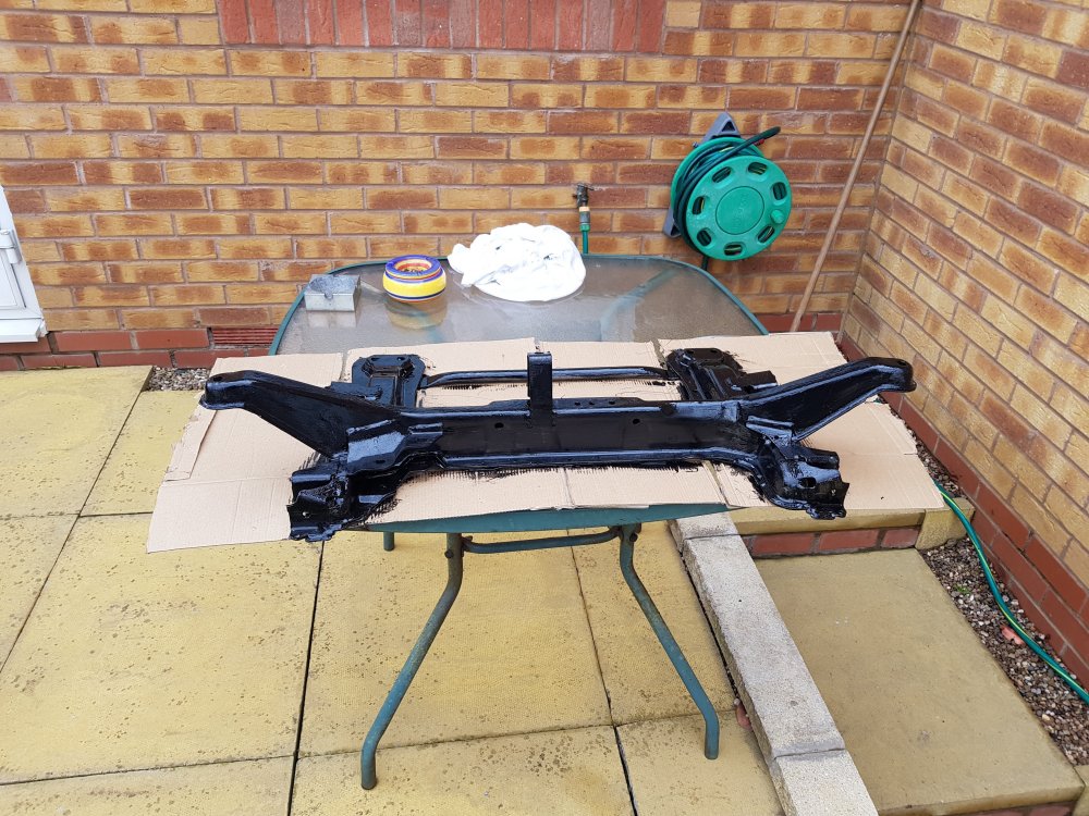

Plenty of Metal Prep on all the stripped surfaces.
First coats of paint going on.
20200503_125254.thumb.jpg.871c1e84f88fa538aa71817b937e9be6.jpg  20200503_125301.jpg.121260a77a2bbf1e425a052f6e2558a0.jpg
The painted lower arms and subframe.
One of the new rubbers.
The steering rack components and ARB were next,
20200506_143846.jpg.cf7bb40e276b05288d913e36a8e06eda.jpg  20200506_143853.jpg.820193dca4cfbb399e91977002410ea5.jpg
Then the hardware was cleaned - I don't fancy that latte!
20200508_165751.jpg.50404cb94bd1f4a36530e84b4e6798de.jpg  20200508_170110.jpg.b65369a307d921648aa2661b75f53687.jpg
All laid out ready for re-assembly - plenty of grease, threadlock and new washers!
20200508_174558.jpg.50731bf5e53a94d6641faf8347e5f533.jpg  20200508_174605.jpg.e5797389d393cce8bb1cab7c4208952c.jpg

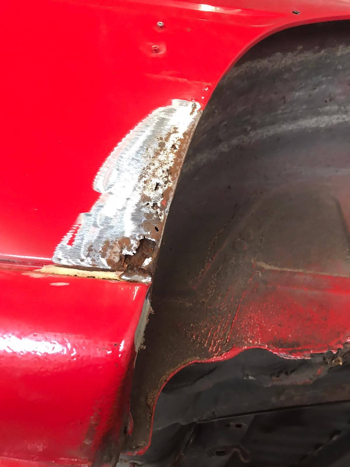

  • Fix the rust on the rear wheel arches.

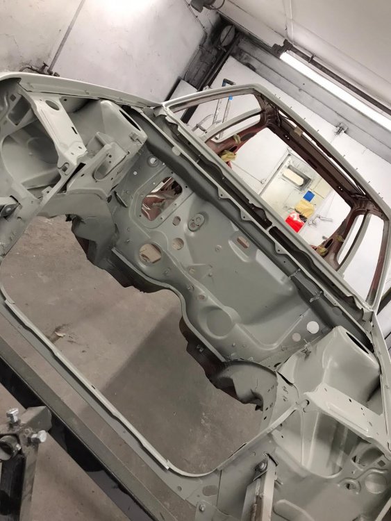

ian010778
Hello all - long time no update, chiefly because of life, the 206cc and lots of other stuff!

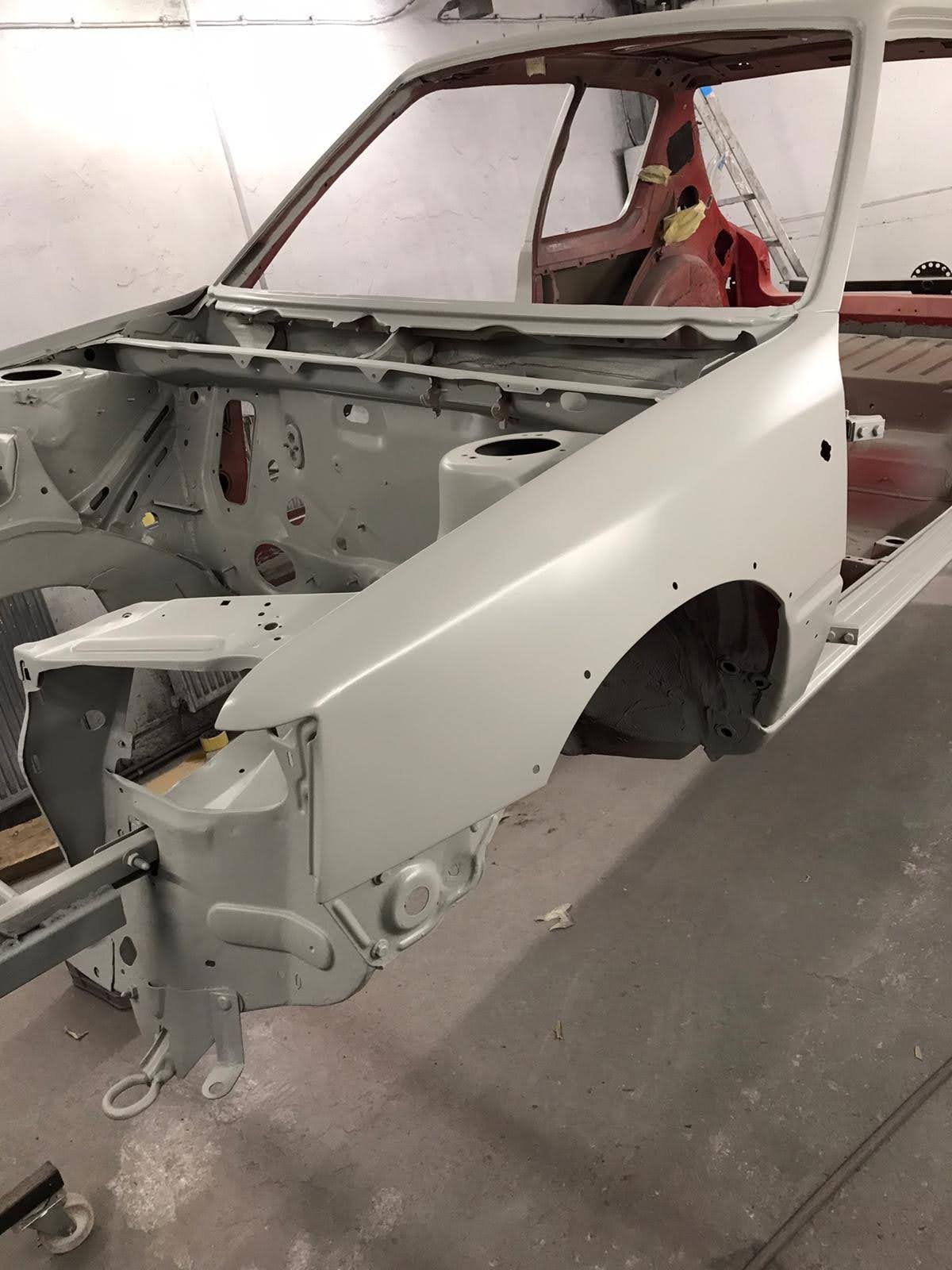

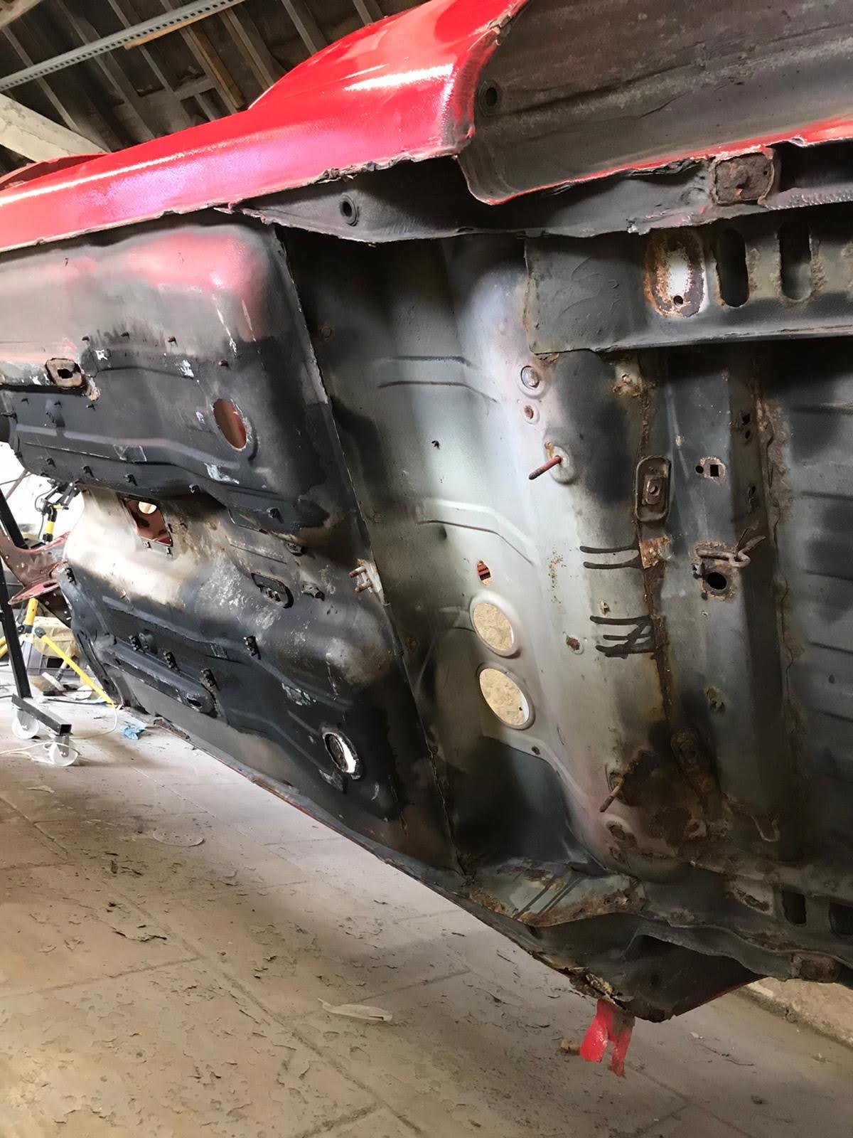

Although I haven't made much progress my end, I've had some pictures from the bodyshop recently and they are certainly cracking on :D
A few more holes and a bit more work than first anticipated but I was warned and I'm just glad they're being thorough rather than rushing it - here's a few of the 21 pic's I received last week - enjoy!
Ian.

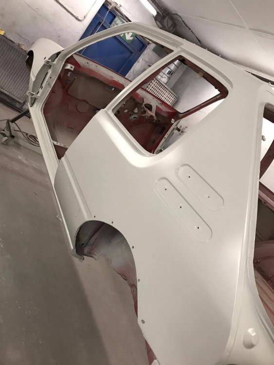

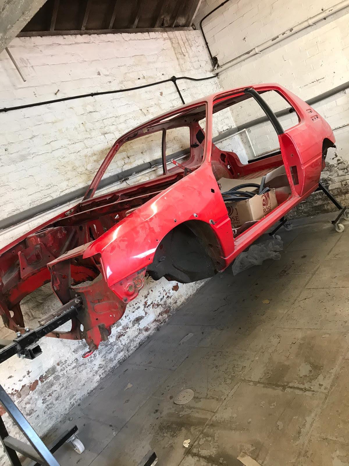

ian010778
Hi all,
Time for another bodywork update - also, those who have been following it will know I've been cracking on with the rear beam recently – see thread here.

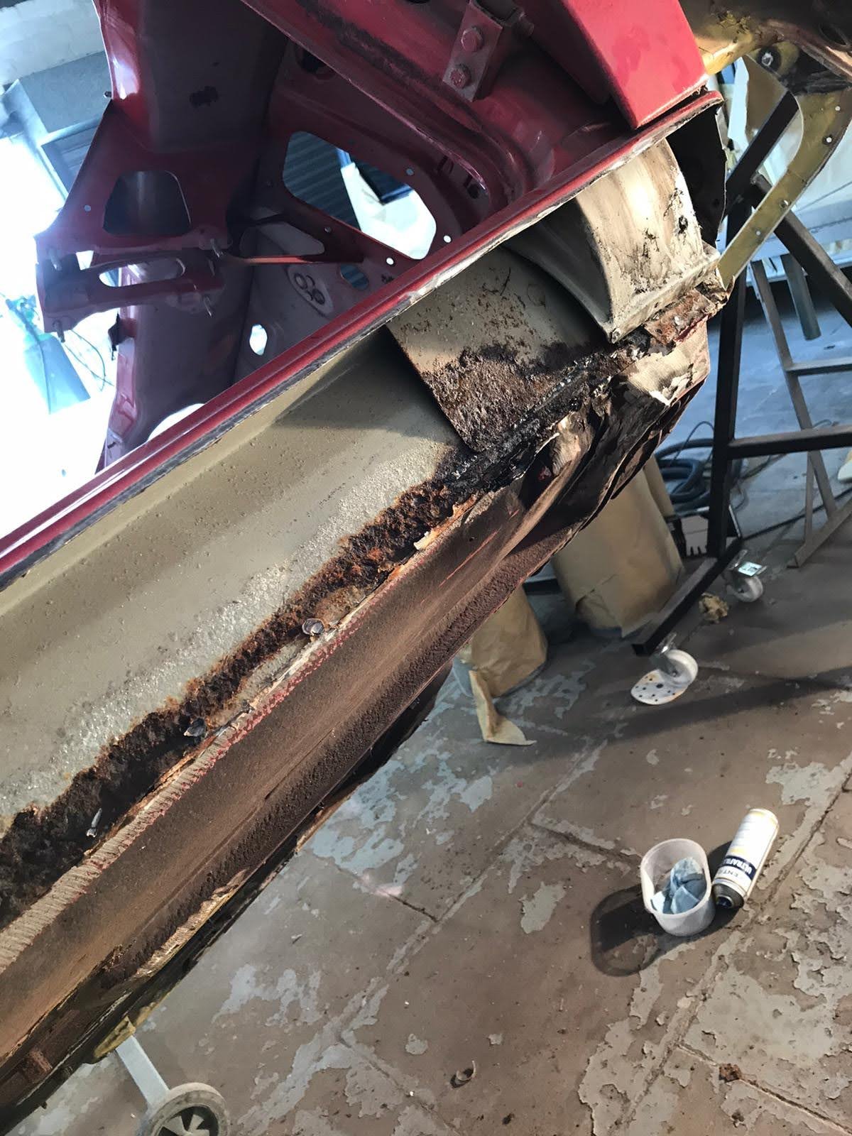

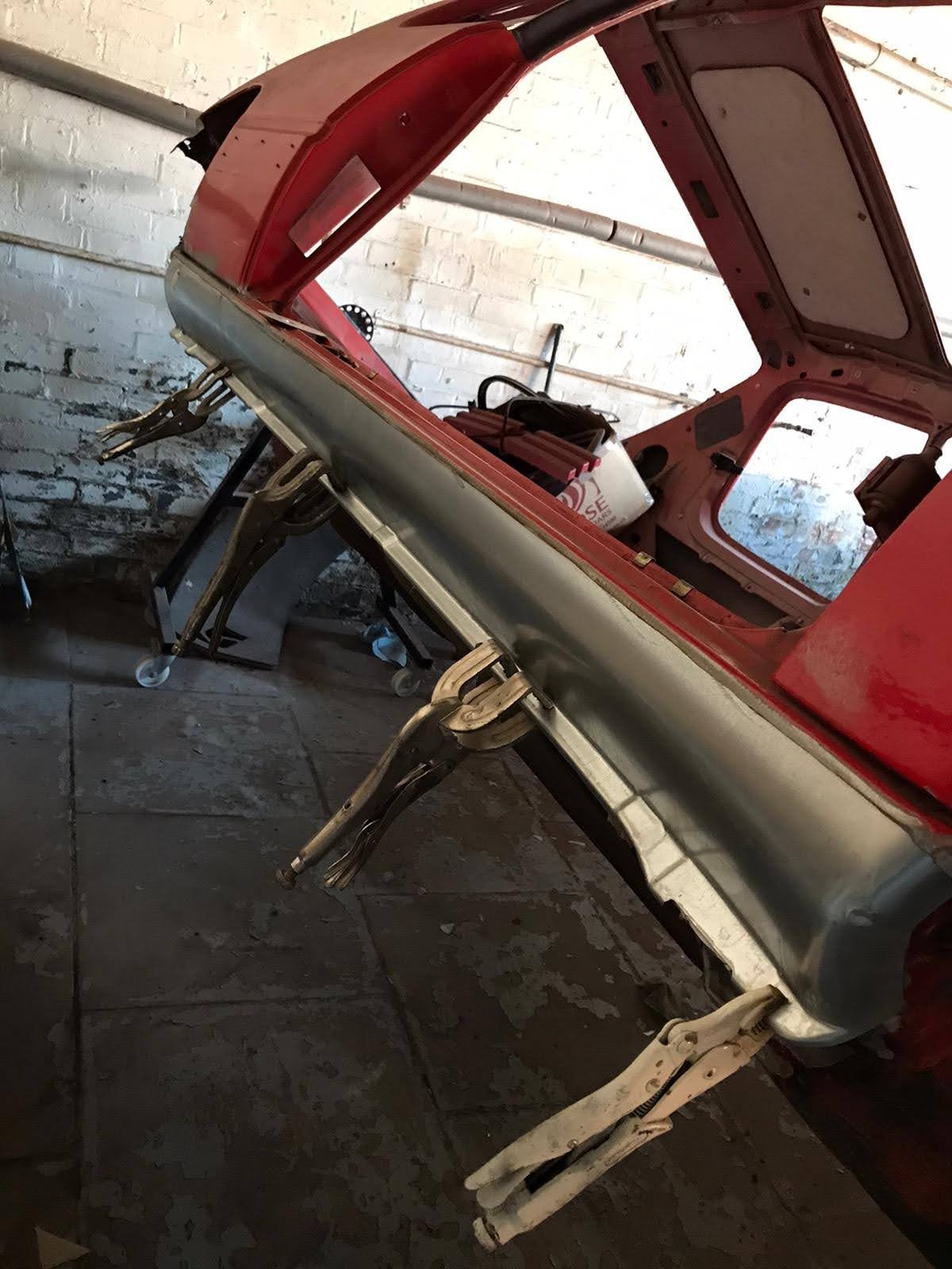

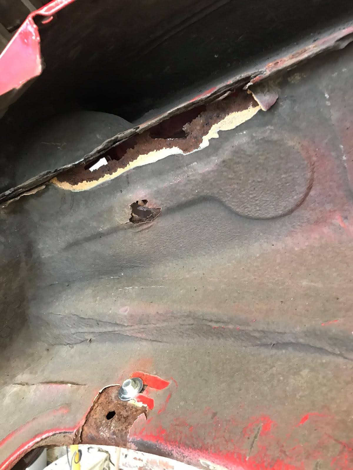

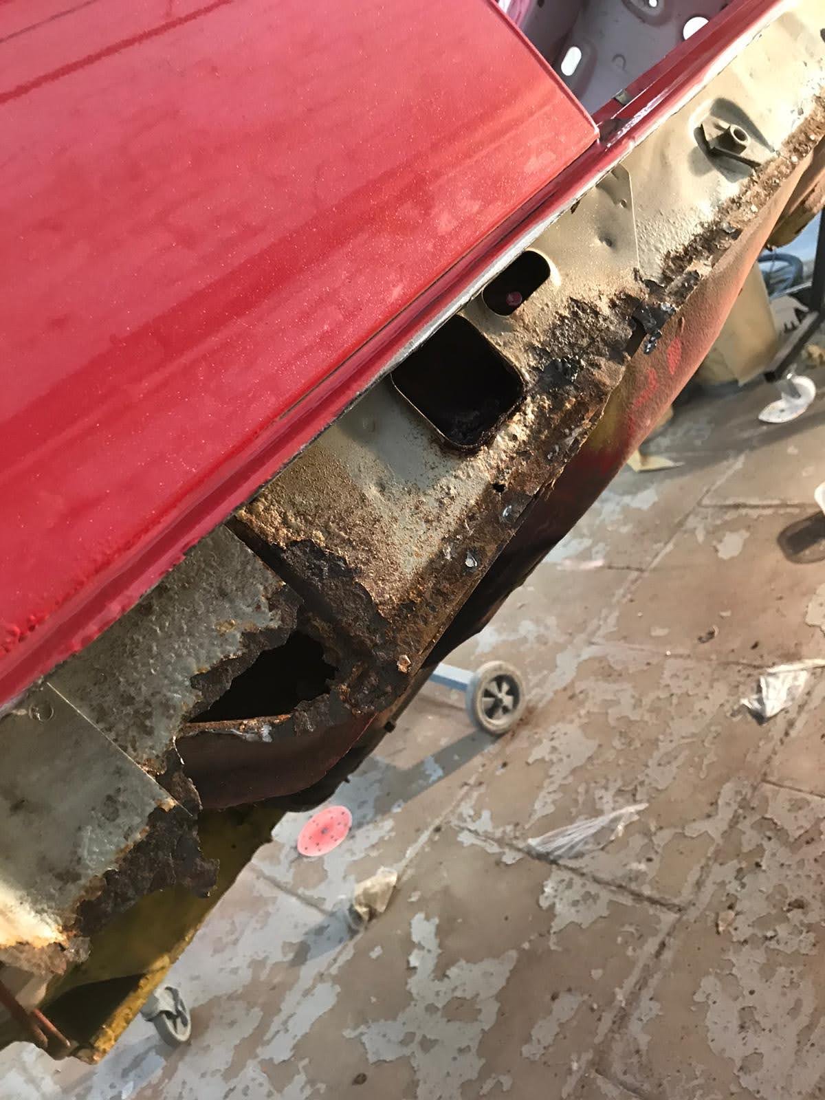

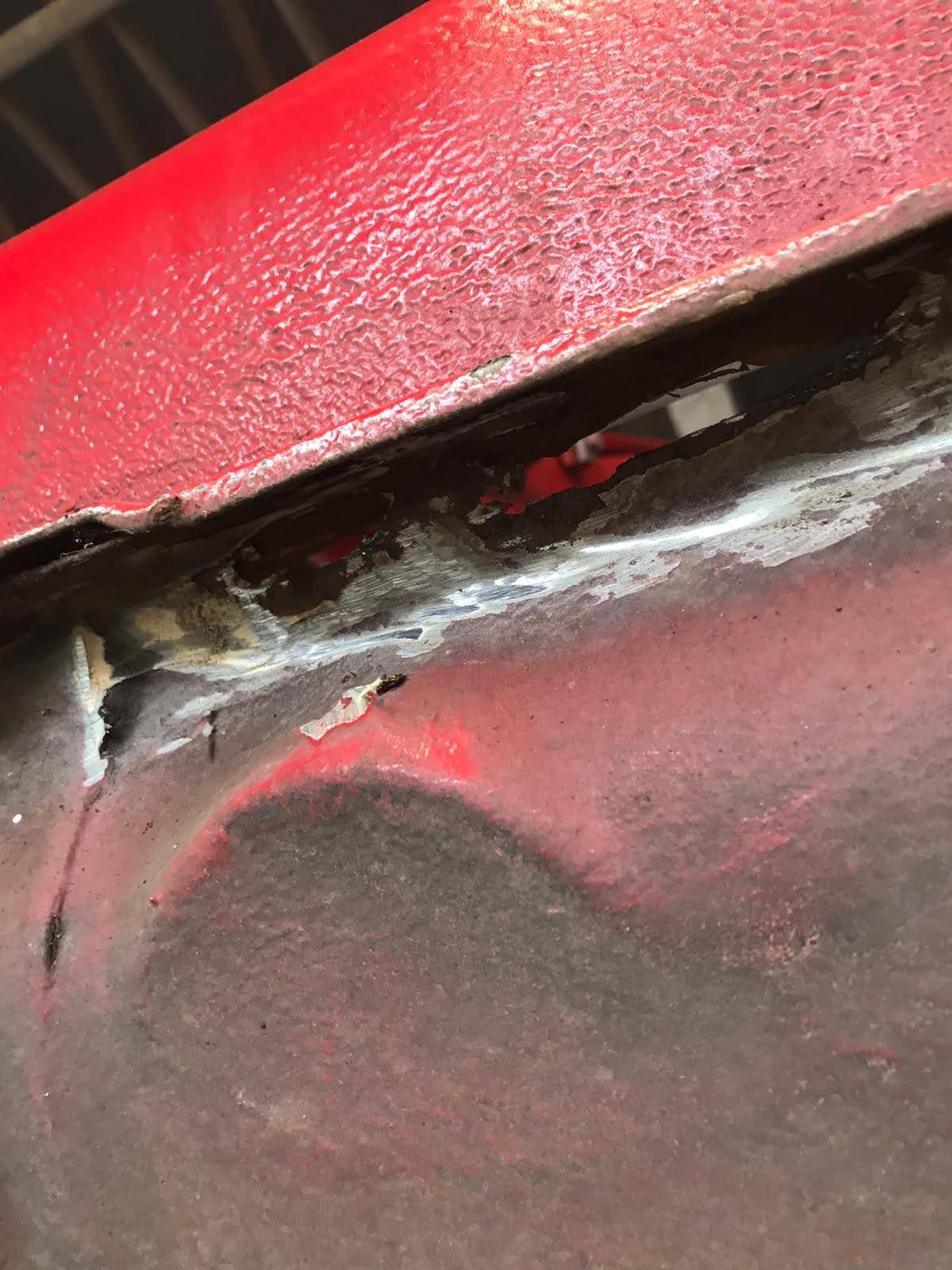

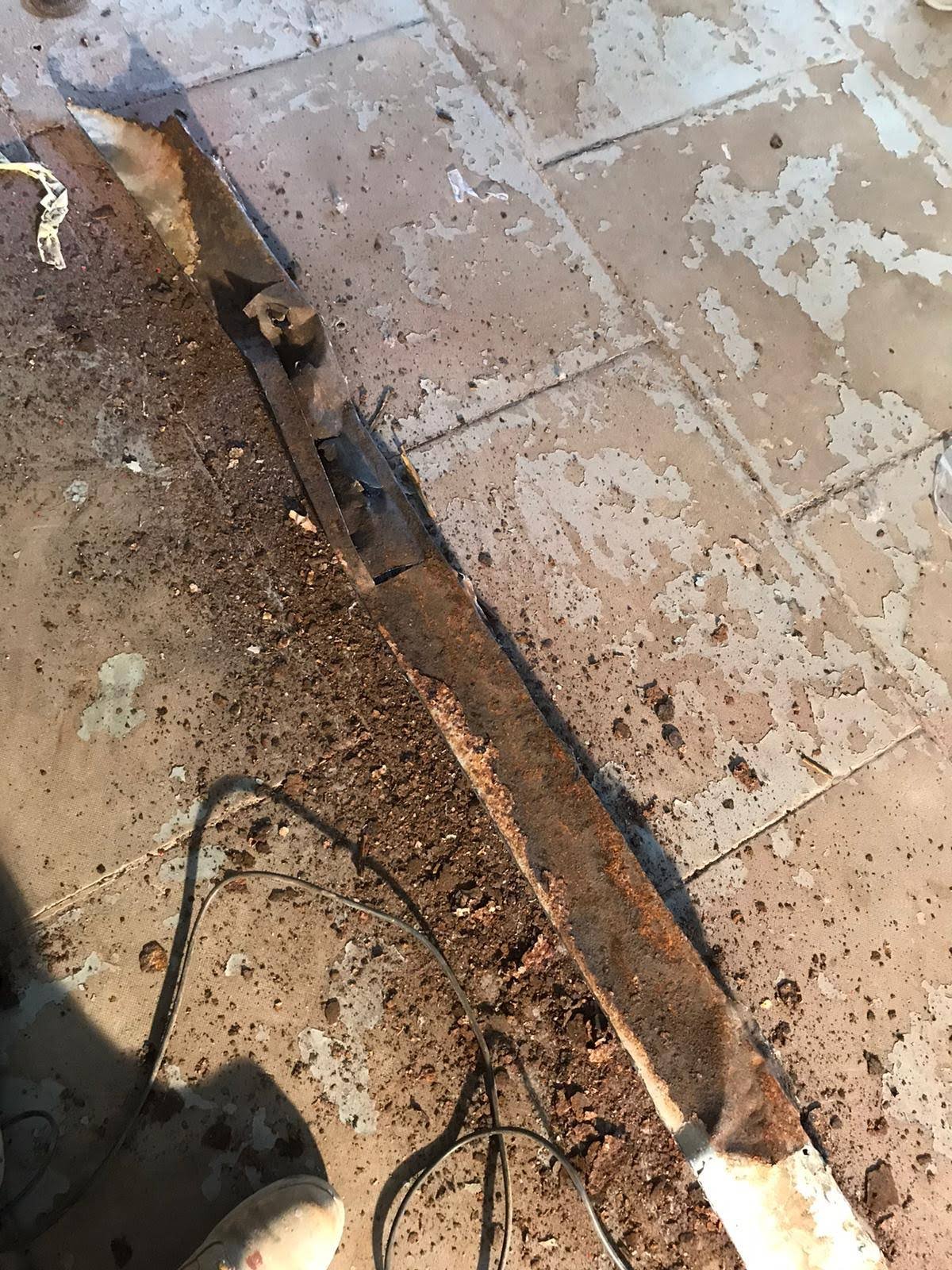

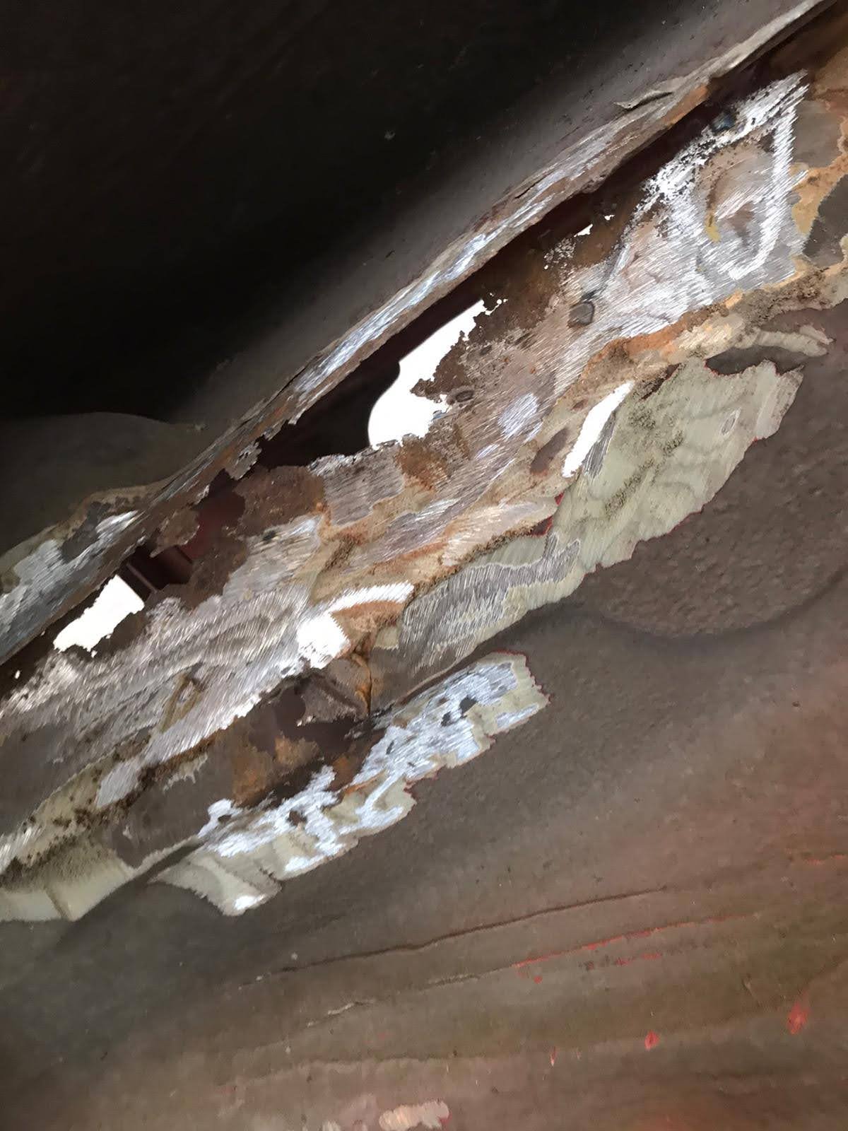

Progress has been made at the bodyshop – mainly the identification of a rotten driver’s side sill and all the work to source a replacement and get it in place. I ended up sourcing the sill myself (about 60 quid) and having it shipped direct to the bodyshop but it was not an easy task finding one.
Not sure if this will play but here’s a video of the crispy old sill and some pictures of the mess it was hiding!
Anyway – the new sill arrived and the last picture I have from the bodyshop is with it ready to be welded in. I believe that will be the last bit of cutting and welding before they move on to flatting and straightening everything out.
@Telf before you ask, they are keeping me updated with costs and we're making sure the extra work is affordable ;)
Ian.

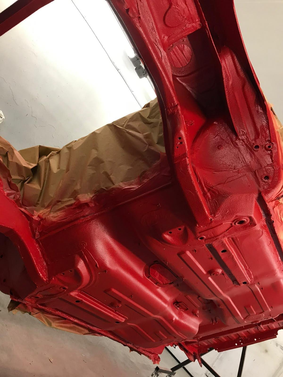

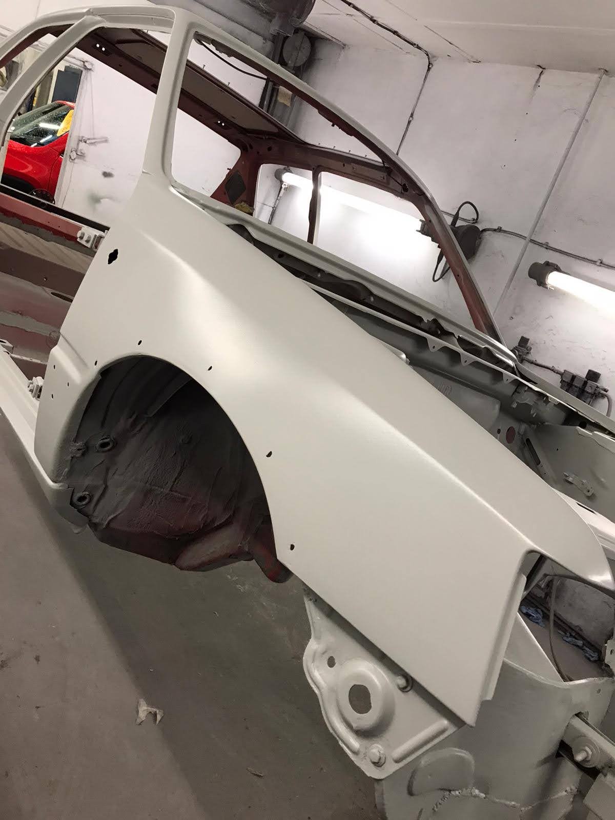

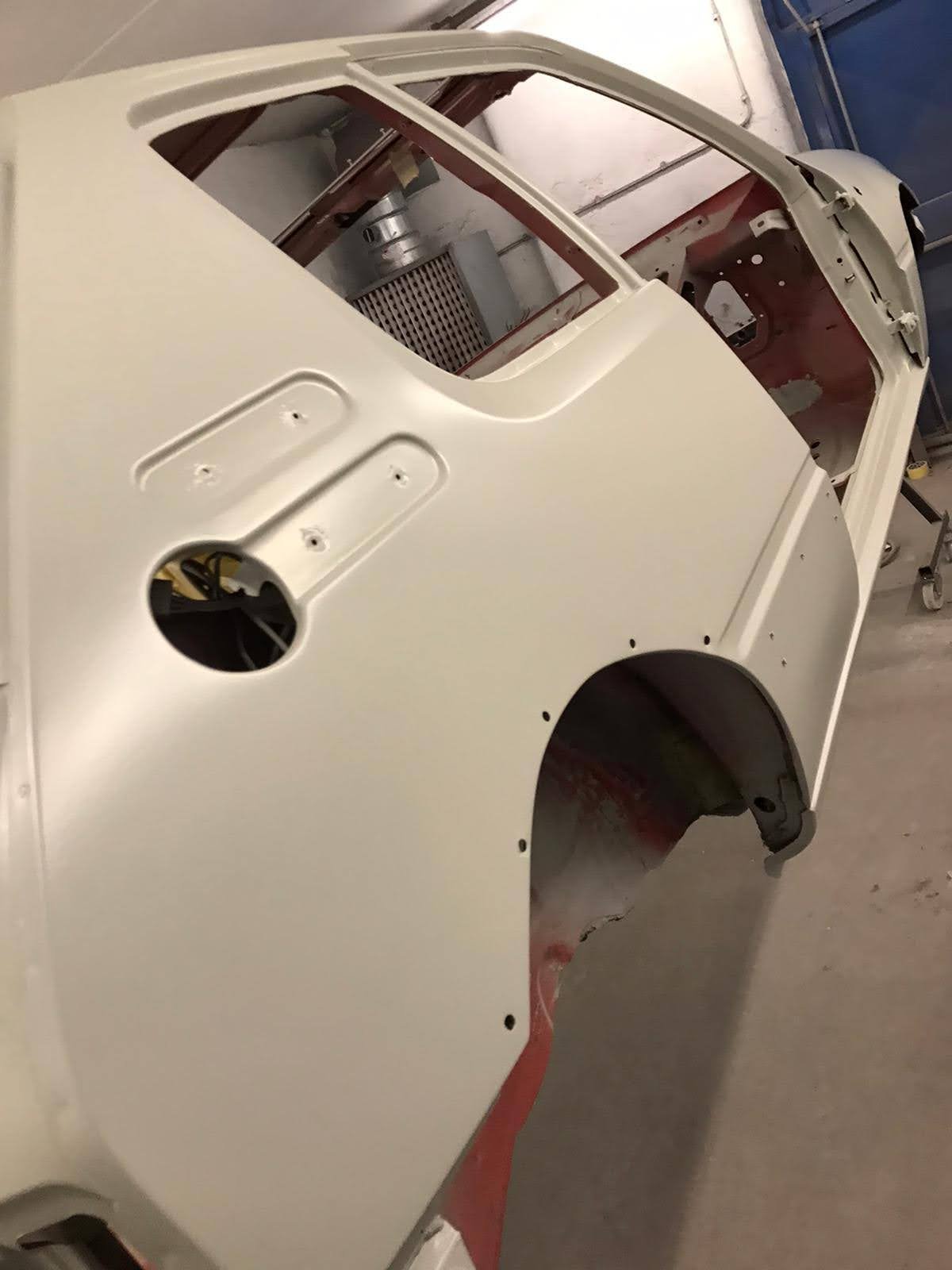

Seeing as my bodyshop has posted about it now - this is my car :D :D :D
Well on the way to being completed - I've visited and received loads of photo updates and I'm very happy with the work!
Ian.

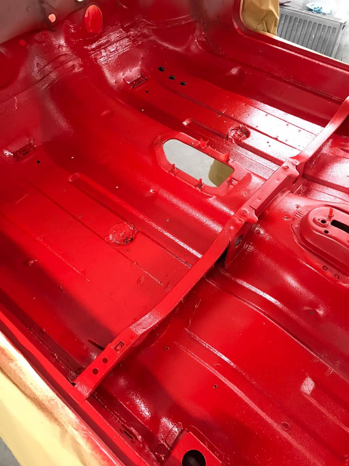

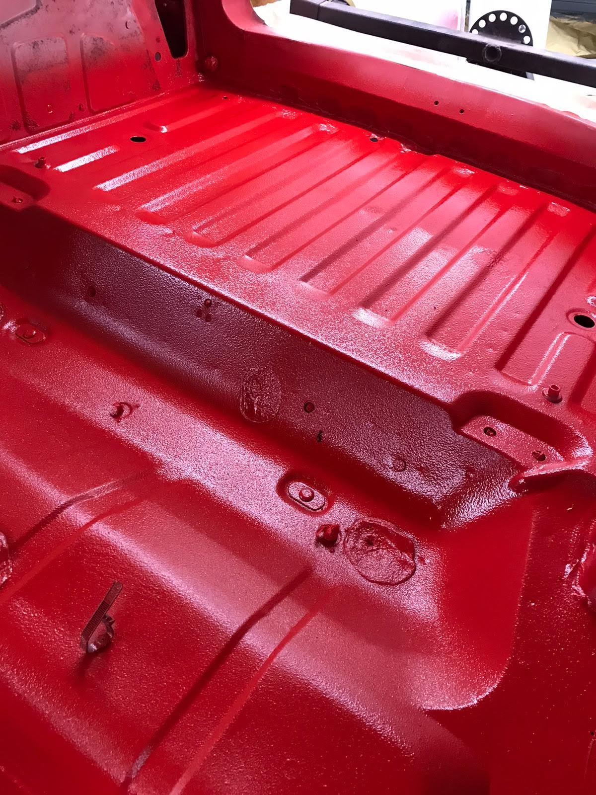

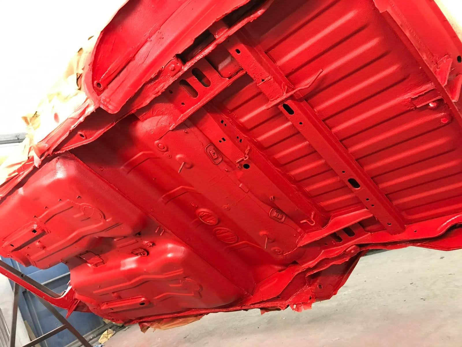

Here's a few as she stands now.
IMG-20211101-WA0002.thumb.jpg.545a80cb9d434be5ad07654a03877c50.jpgIMG-20211101-WA0003.thumb.jpg.eae80284ac6882445c812da6f21541ba.jpgIMG-20211101-WA0004.thumb.jpg.67a533fc3ea726cda41aca02f5e3a0fc.jpgIMG-20211101-WA0005.thumb.jpg.61f1daeec3802ead2e9a4f0b8496f7cc.jpgIMG-20211101-WA0008.thumb.jpg.802d40e511127f17ab41e380d8e2a661.jpgIMG-20211102-WA0001.thumb.jpg.77ee9433b4111847a3eb267a7ac0440d.jpgIMG-20211102-WA0002.thumb.jpg.3a6f5ad21dee39dc43c42c4932d2f485.jpgIMG-20211113-WA0000.thumb.jpg.e5bd9406ea86da1c8324c186b09e1294.jpgIMG-20211113-WA0001.thumb.jpg.adbc95f49be583437b12d1803858a0bd.jpgIMG-20211113-WA0002.thumb.jpg.ff85c93ba13c95fdb8d6216b32baaf79.jpg
Gohn
good pics, that red is super bright !
smooth quarter panels, and nice in undercoat

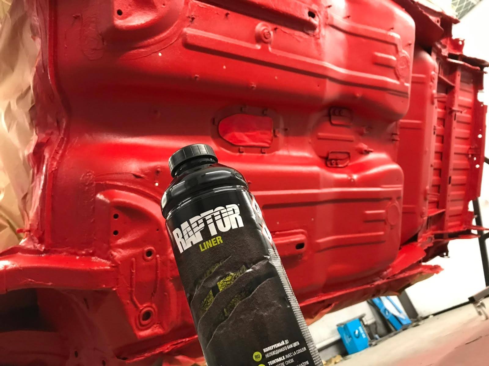

Yeah - I'm gonna see how the red pans out as clearly the panels will be original P3KB (off the top of my head?) so I'll see how the Raptor red looks in the wheel arches against the finish when it's all done. I'm happy with the Raptor as it's textured, like the factory stonechip :D
I've just looked my first post in this thread and it says "I'm not going for a full restoration or respray as the car is basically sound..." :ph34r:

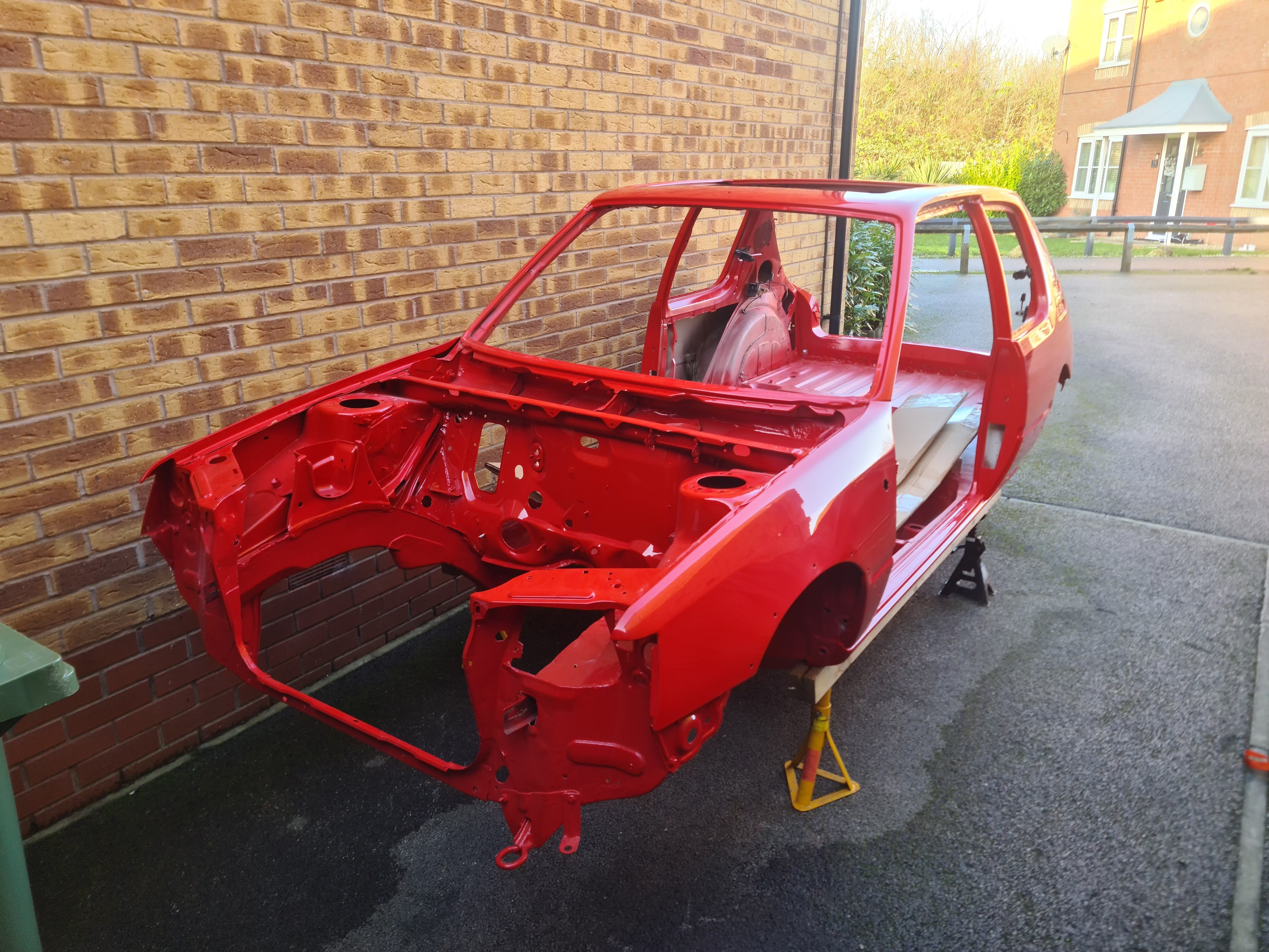

ian010778

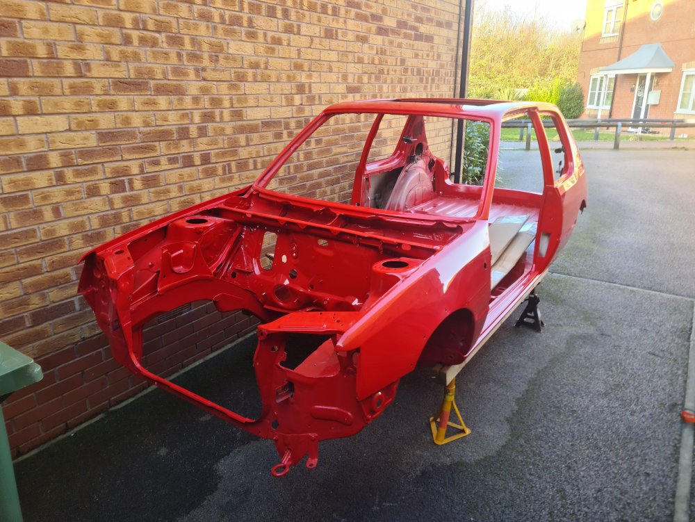

The shell came home Friday - was quickly wrapped up nicely and a gazebo will be going over it this week too - guess I'd better do something with the rest of it now :ph34r:

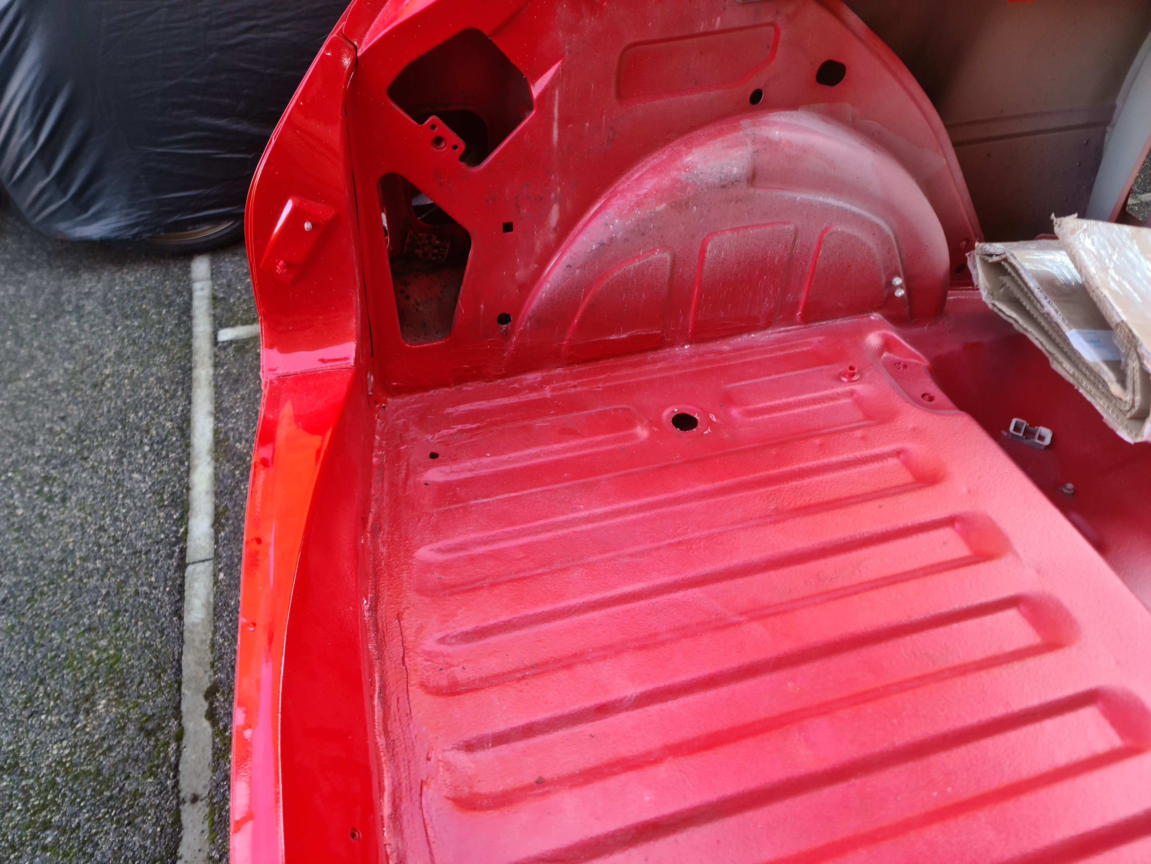

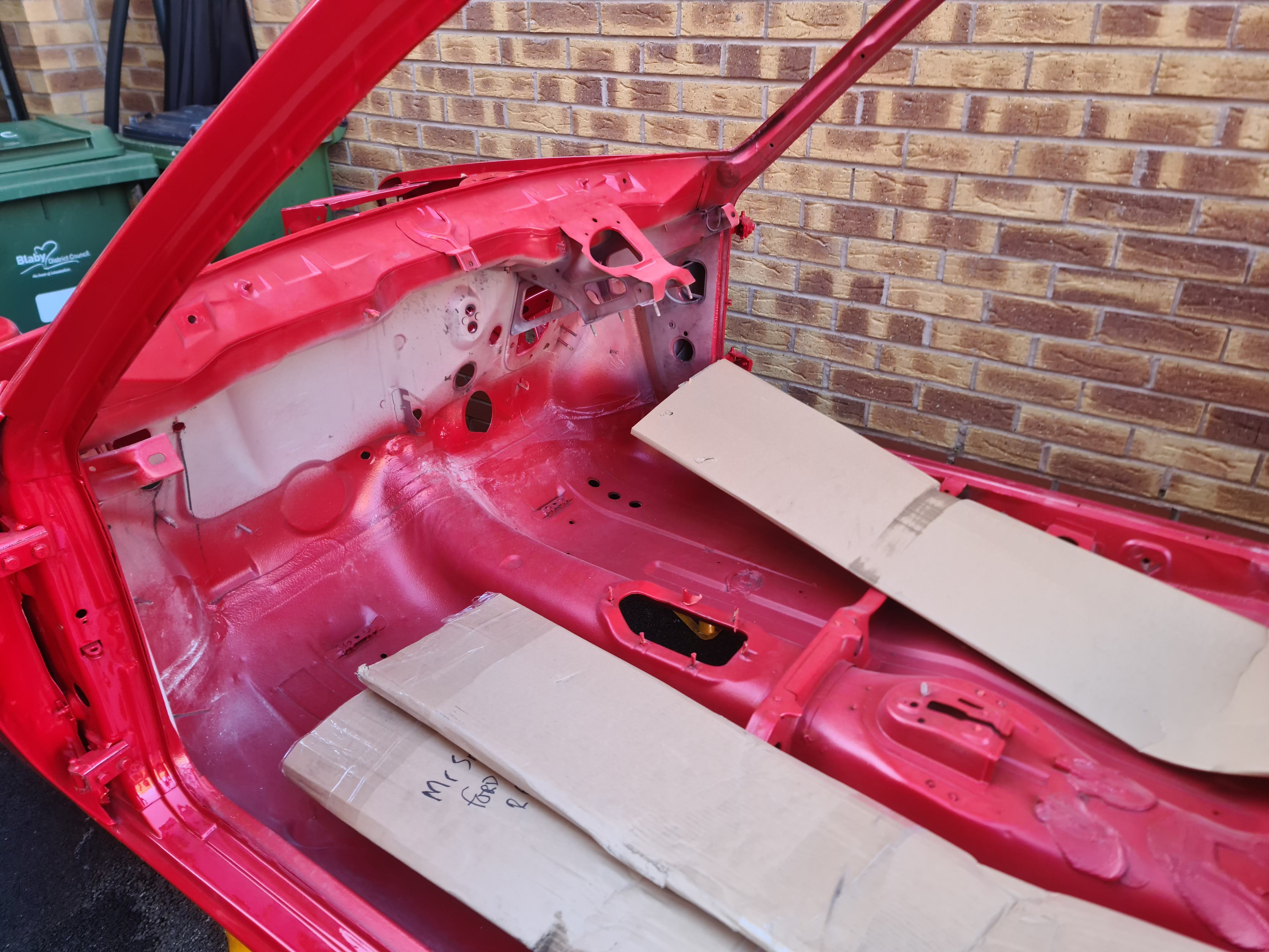

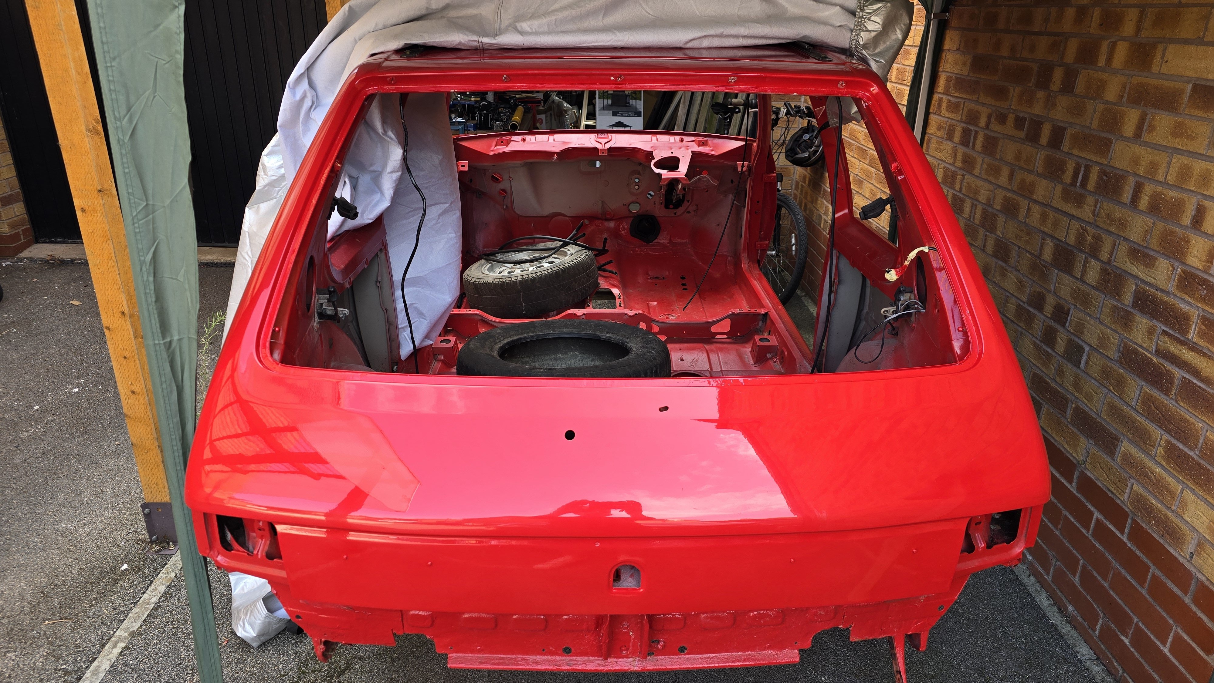

Well, it's been a while, but after a lot of life being lived over the last few years I'm finally back on the 205.
Unfortunately, not much has happened since the body shop delivered her back to me - any effort/motivation I had went into making sure the shell was kept clean and dry over four winters and I'm glad to say that this has paid off. The first cover I had over the shell has rubbed a little on the corners so I’ll be back to the body shop for a bit of correction once the re-build is finished but despite sitting out for nearly four years, no rust or nasties have developed - just a s*it load of cobwebs and dust! The current cover is a nice fleeced lined jobby too :)
I did pick up my parts list in 2023 and I now have a new windscreen, rear window, seals for both and door and rear quarter window seals along with a few other bits from The Museum. I essentially have *nearly* everything I need to get her up, running and MOT'd now. I'm just struggling to source a couple of bumpers and a new set of seatbelts but I've figured; if I don't hit anything then I won't need either :D

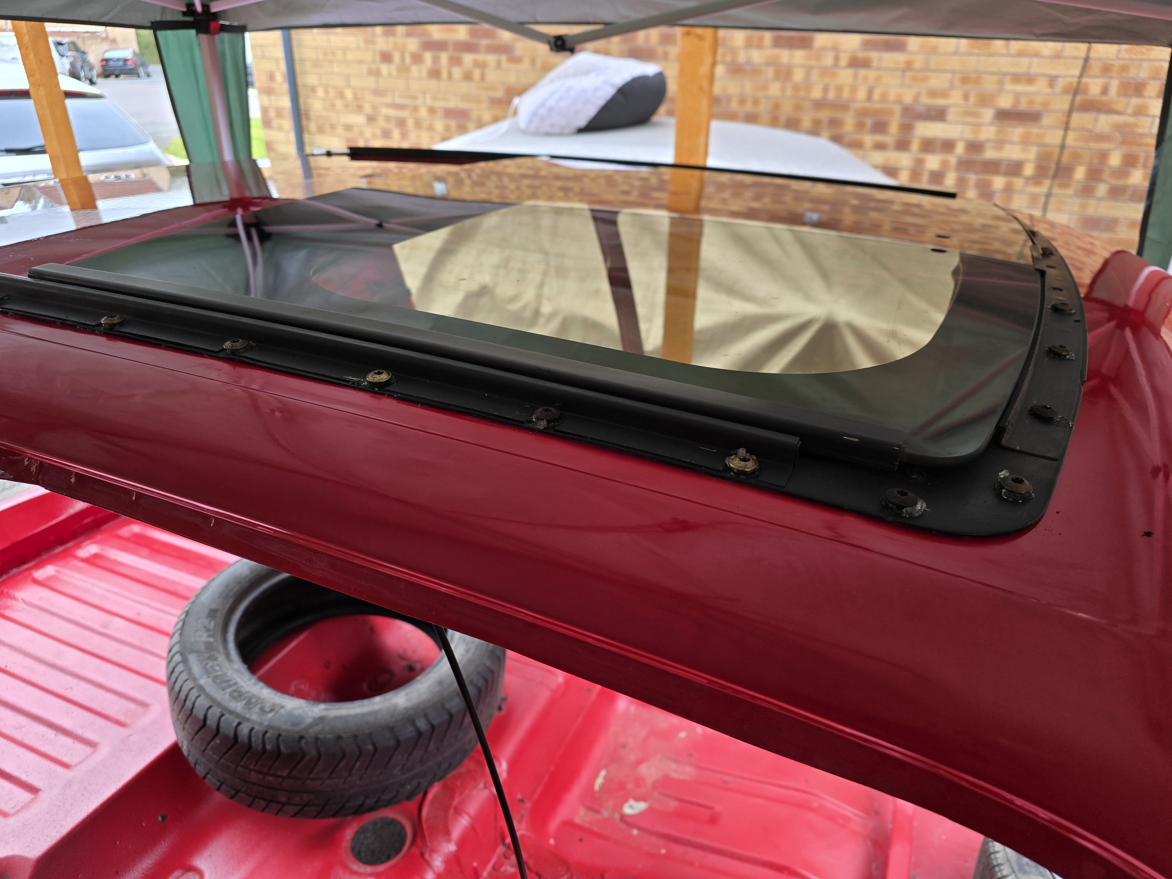

I did put the sunroof in (plenty of silicon @Telf) as this really helped the cover to keep its shape as water was pooling in it, despite having a gazebo screwed to the side of the house and covering the whole lot too!

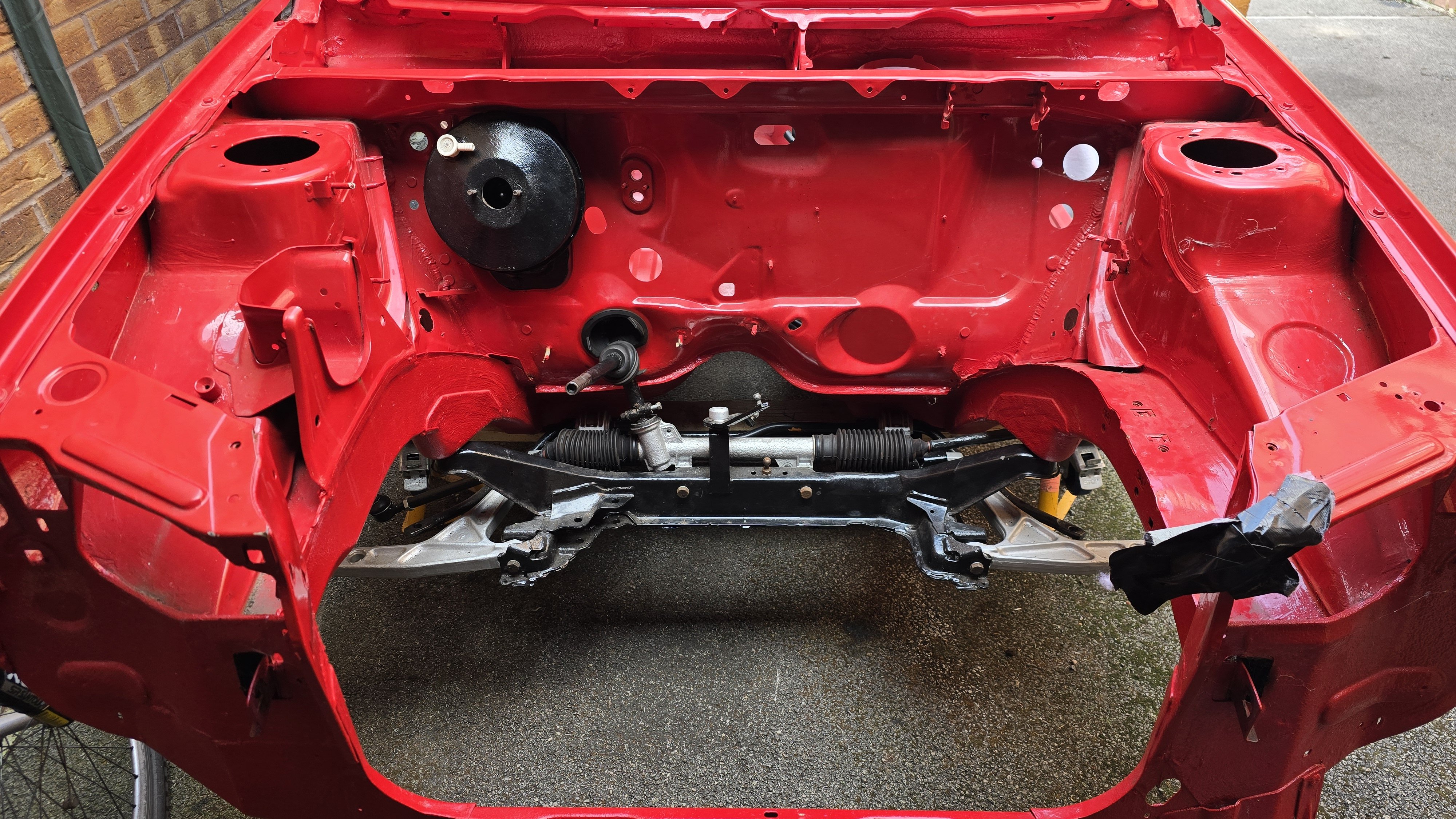

Anyway - after a bit of encouragement from my girlfriend, who can't wait to drive the 205 having owned one in her 20's; last weekend I cleared and tidied the garage, picked the tools up and set about implementing any quick wins that would maximise the garage space and I have well and truly been bitten by the bug... again.
The front subframe had been sitting on a pallet since I re-furbed it and I have the bonnet and boot under covers. The front subframe is now installed on it's front fixings and supported at the rear, the boot and it's new inner seal are on and I have also pressed the front wheel bearings and hubs into the steering knuckles. I don't want to put the bonnet or front windscreen on/in yet for obvious reasons but just getting a couple of bulky items out of the garage and onto the car has given me the room to lay-up the rear beam components and make a start with assembling the tube. The rest of the rear suspension and brakes will be built on the car so that I can leverage against the weight of the car when torquing stuff up etc.
However, the priority for this weekend is to get the front shocks done - new springs and dampers, a thorough clean-up of the cups and top mount bearings and new (stiffer) rubber from Baker BM and I'll have all the room I need to really crack on! The August bank holiday is ear-marked for the rear window and the rear beam tube build and fit.
It'll then be a case of vacuuming and cleaning the inside of the shell as although I'm cleaning (well, dusting really) as I go, I know that lovely fresh paint isn't looking it's best but as the photo's show - with a good wipe over, that, ahem, "showroom shine" is still there!
Oh, BTW - some people might notice that there’s a wooden post in the first and third pic's. My old neighbour went and put a car port up over their side of the drive - it's a proper PITA and they've now moved out :rolleyes: I will need to be *very* careful once the passenger door goes on as I do not want to be smacking it against the crappest car port in the world!
Ian.
20250809_153111.thumb.jpg.dd67ab4ba9ac9d53324f217c595e182e.jpg20250809_153058.thumb.jpg.0a34c6cbc6a6a7e2db1cd7a17ddfae22.jpg20250321_135717.thumb.jpg.8abca0668d5d1c7e1aad31313363194a.jpg
