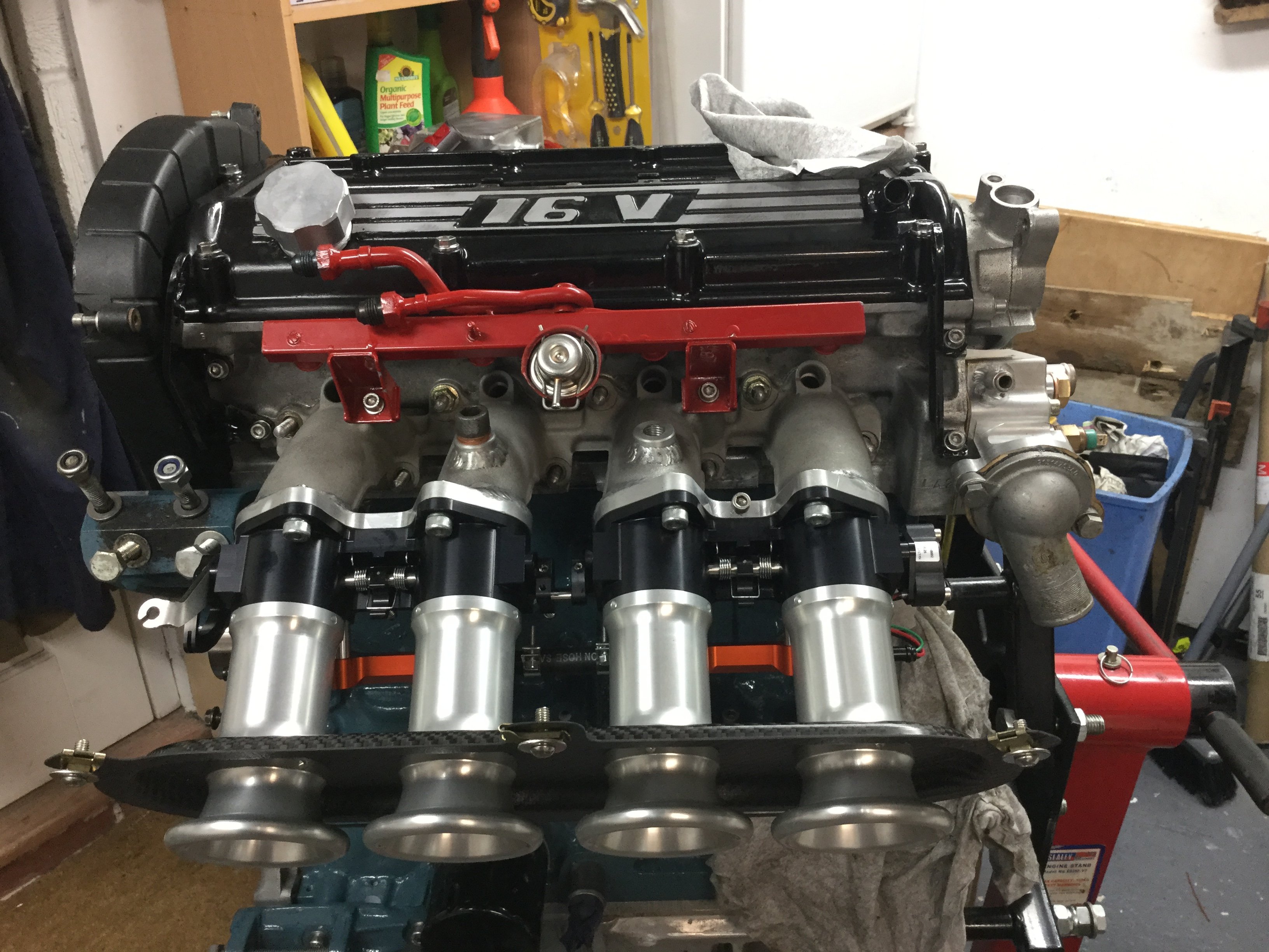

 Hope your plans to move further south are progressing well. I am afraid I know nothing about the xu7 block so nothing helpful to contribute, although it does look like an ‘interesting ‘ engine . As far as I know, PeterT is the man for the extended oil pickup. He sent me mine  very quickly and at a very fair price . I then had it tig welded in place at a small engineering company in Derby . On my engine, all  sealed up now, so I will trial fit the inlet and bodies tomorrow morning so I can work out how the dipstick tube will route, then just about ready to drop it into the car and discover just how badly the manifold fouls on the tunnel and bulkhead !

Beginning to look like an engine. Trial fit in the engine bay this weekend or early next week with any luck, unless the weather improves in which case bike riding will take priority

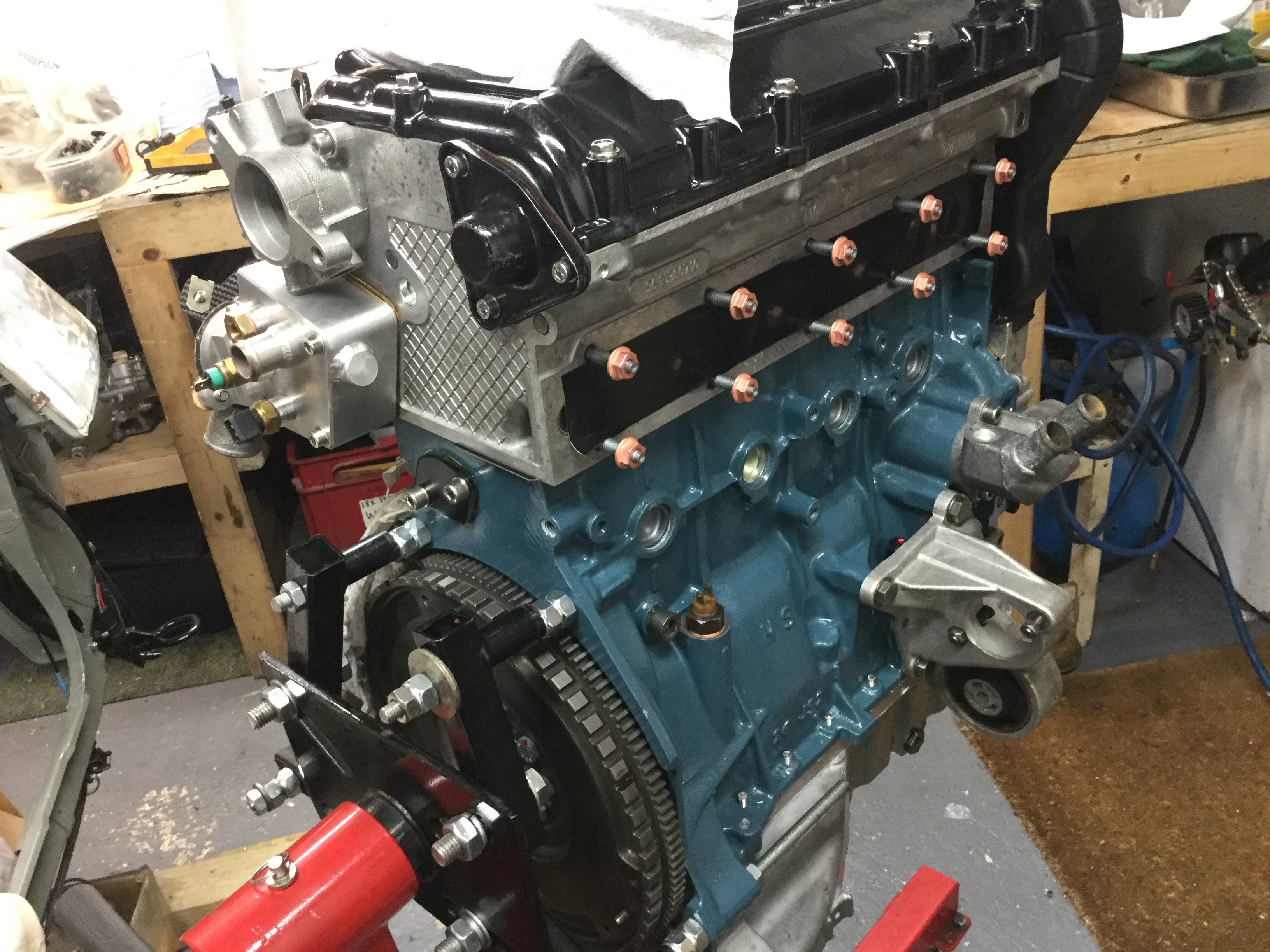

Perhaps related: I'd consider more robust exhaust manifold fixings. I swear by some 'Rolls Royce' jobbies that (ironically) I got from 'Volksbolts'.
It's a steel stud with an Allen key end to wind in, with a locking steel nut. They're not essential, but give that extra assurance.
I also swear by Loctite 5920 (expanding copper?) sealant for the exhaust manifold as recommended by PeterT. The last thing you want is a blowing exhaust on such a canted engine! Get it right first time; for some reason the standard studs and copper nuts don't do it for me.
Did google volkbolts and found stainless studs from them; will that work in an alloy head? My assumption was that you should never use stainless bolts in alloy?
SRDT
Stainless bolt like to seize inside aluminium parts, even during assembly.

I went to their website and found the studs that Richard referred to . Nicely made and a very good price, but they are not studs, but rather threaded SS rod either 50mm or 60mm long , so unless all the blind, tapped holes in the head are drilled to the same depth, these studs may protrude to differing amounts .

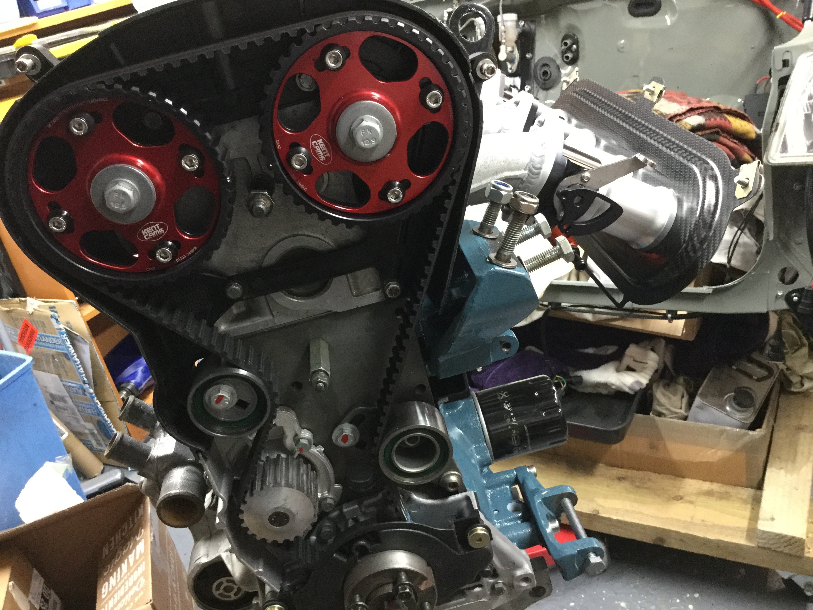

And the next saga. Just about ready to drop into the bay, but I thought I would give everything a final check. The cambelt kept starring at me and muttering , and so it should . Andy the dipstick had installed it facing the wrong way . Now sorted of course, but what an error . Must have being having a ‘senior moment ‘ when I put it in first time .
