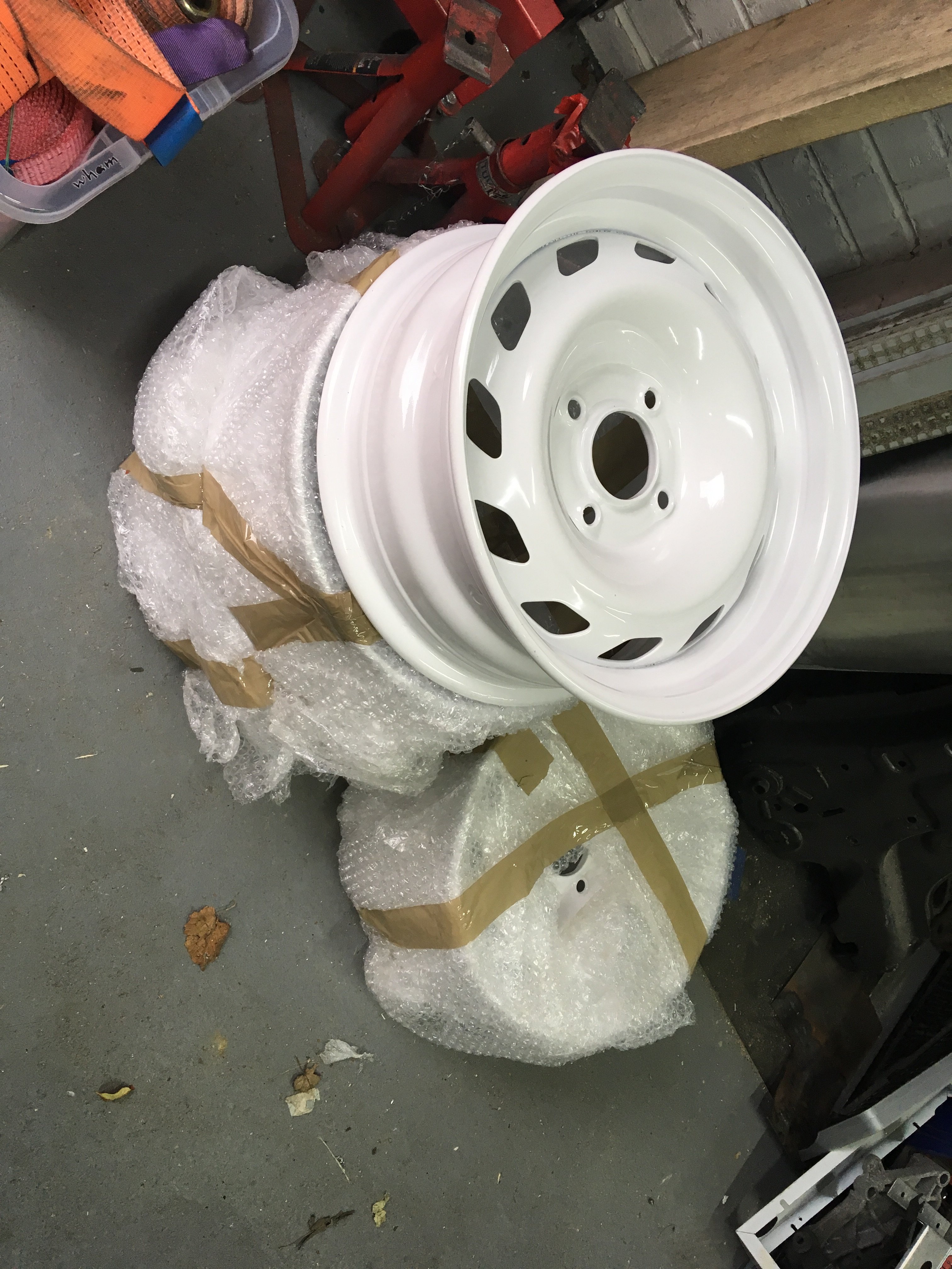

Picked these up yesterday, stroke of luck.... only 30 mile away.
Now to find some rubber....
lovely, you will need to double check what brakes you have on the front, if it has 15" wheels there may be a chance they have been upgraded to something with a 283mm disc, which will not fit under a 14" wheel.
yeh understand, had a look earlier and appears to be some clearance. Fingers crossed, if not....they might come in handy later or for someone else.

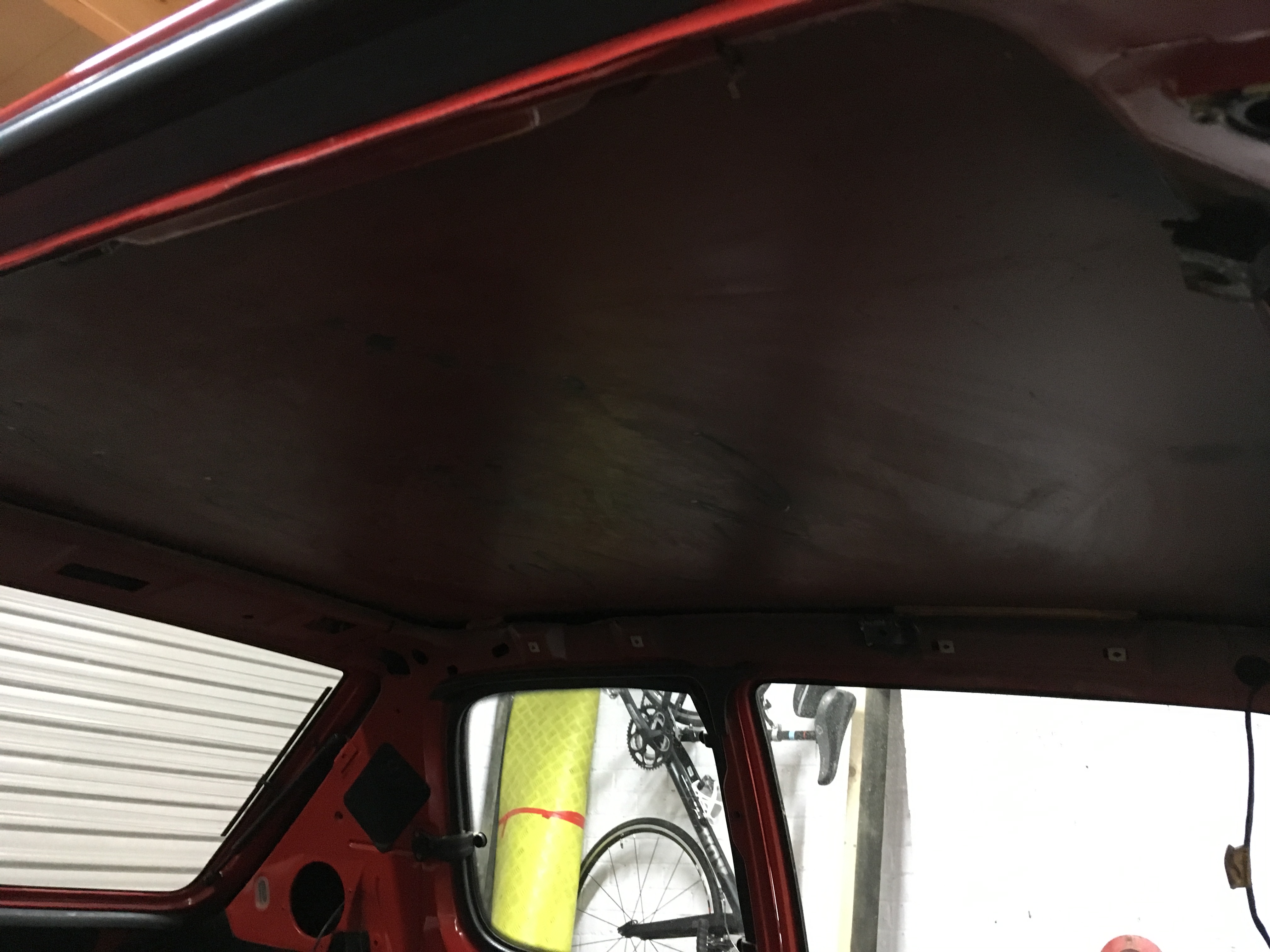

Well no one told me the the headlining would be b@st@rd to get out and remove 30years of glue/bonding agent! Got there in the end.5a80897f0a241_Photo11-02-2018172315.thumb.jpg.bd6eebbd2b6ed4a5cac25464109d02ab.jpg

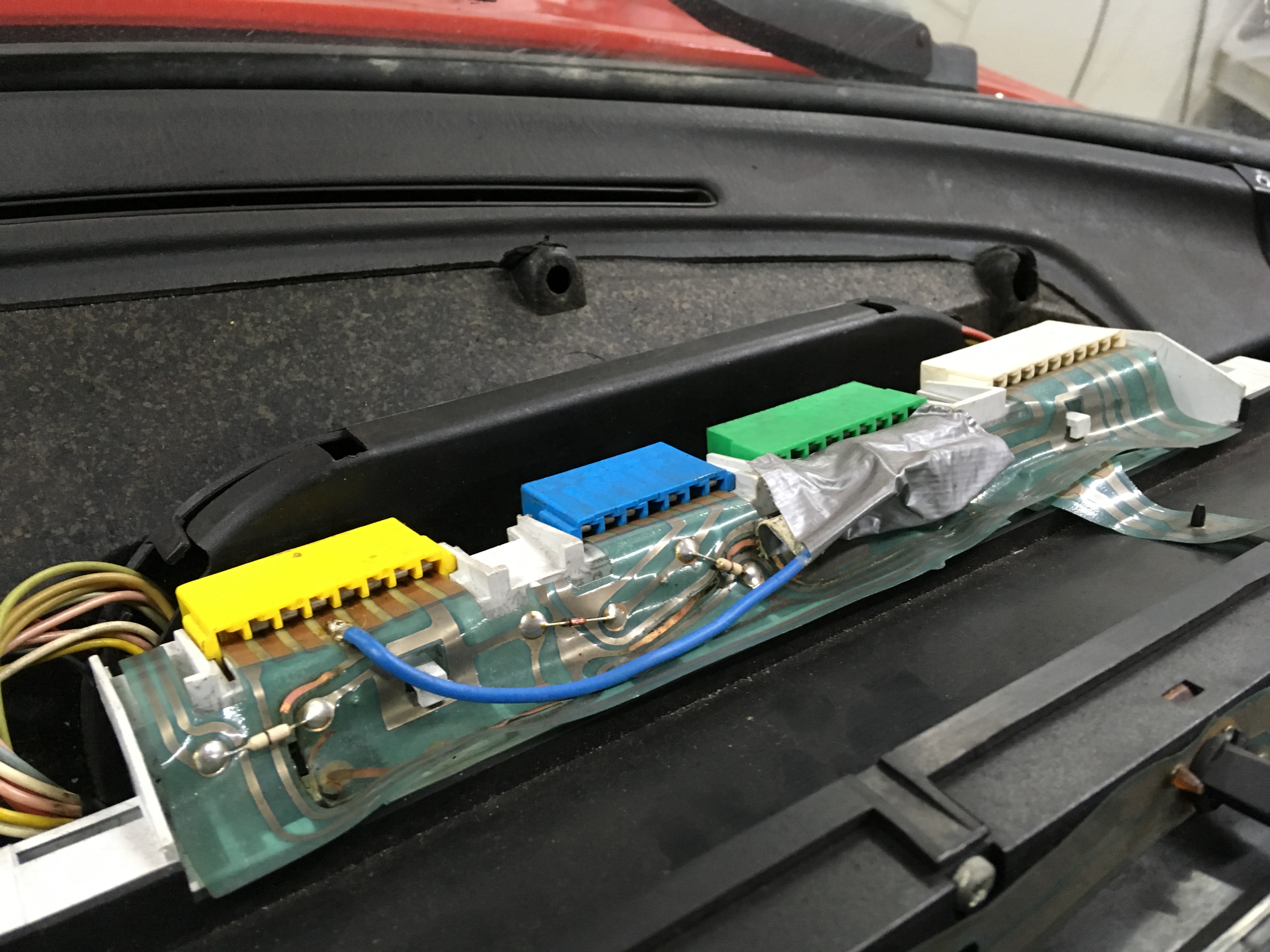

One of many bodges detected....

johniban
What would be the idea of that blue wire then
It appears that the track on the flexible circuit board has burned out and the blue wire has been soldered in to replace it.

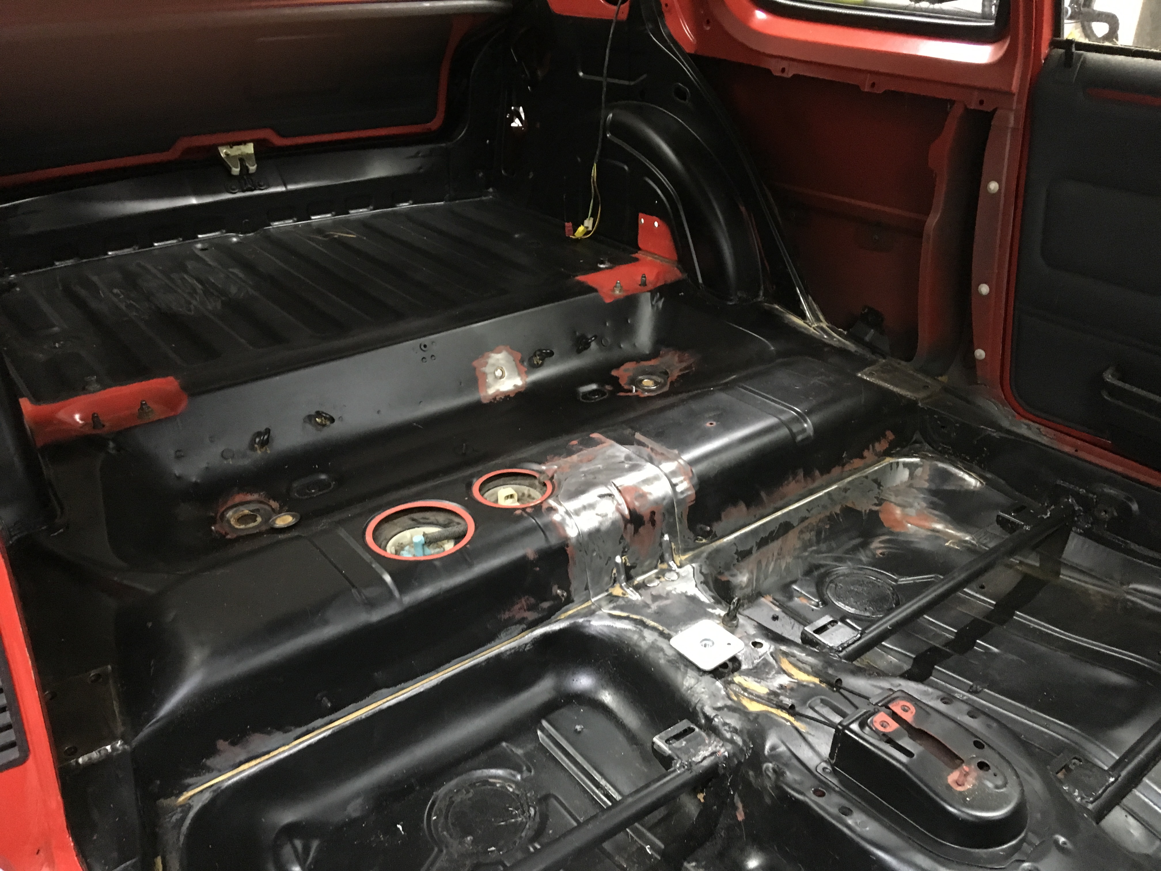

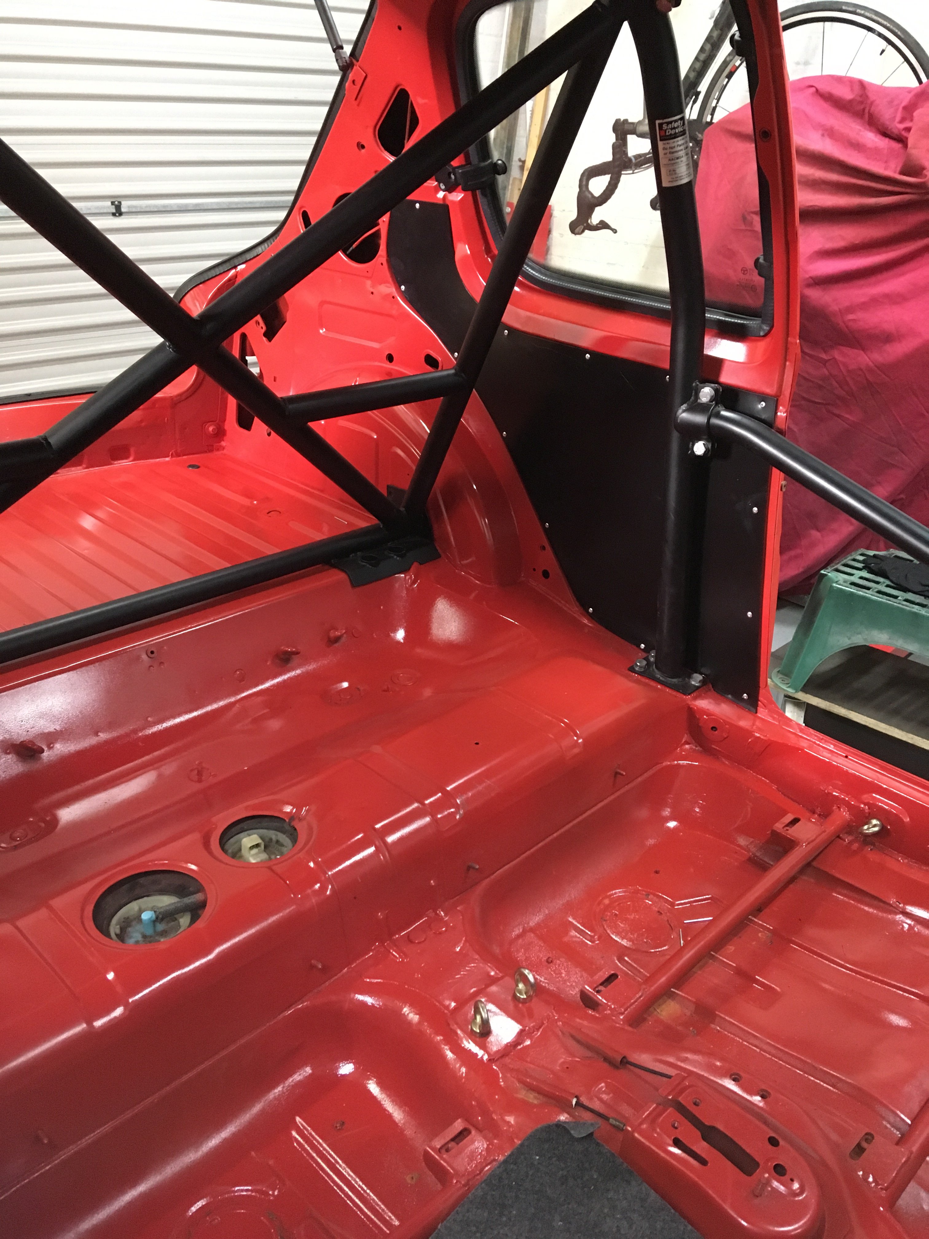

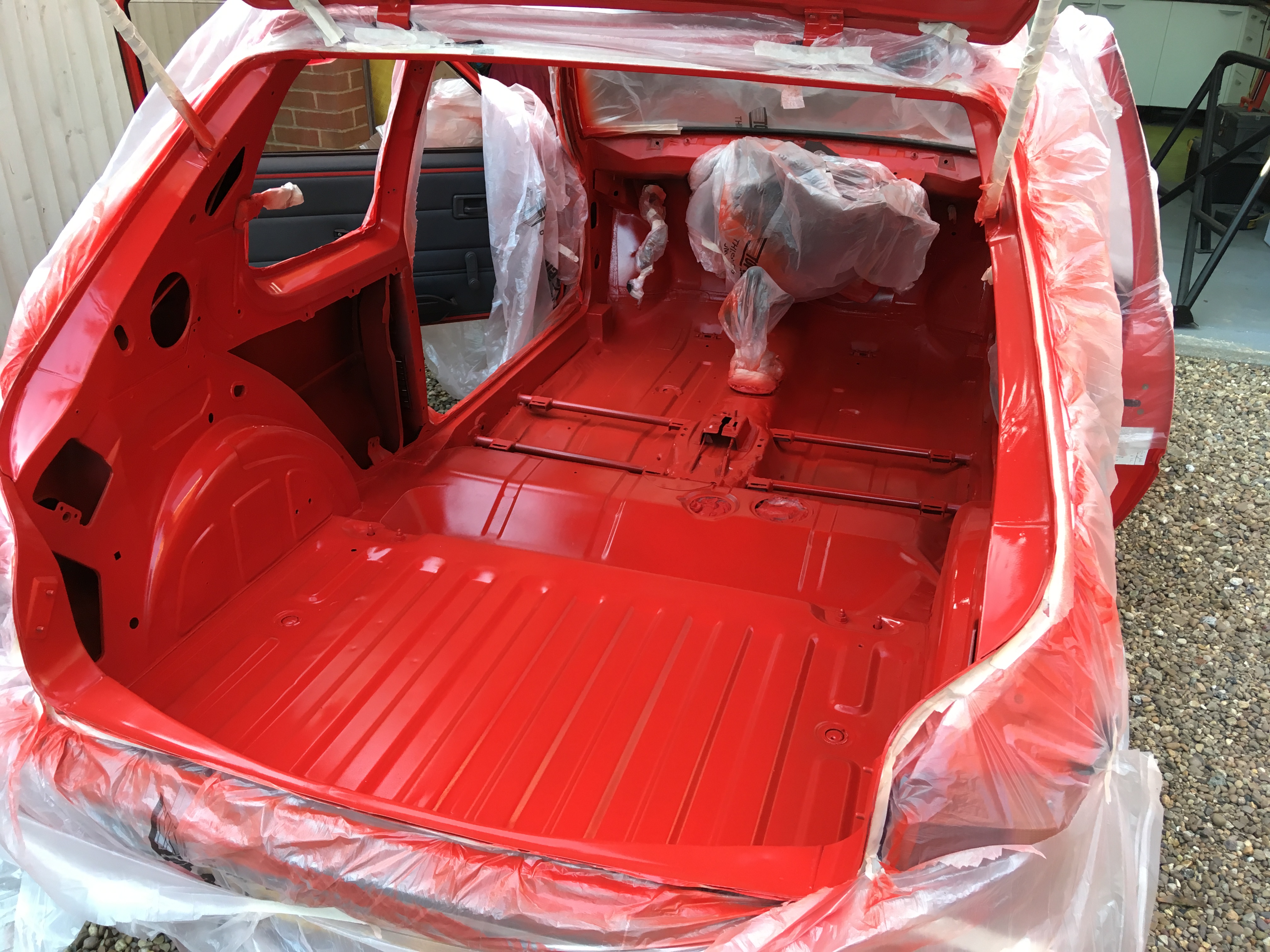

Well some  time has passed  and not as much done as I wanted, apart from repainting the interior. Not perfect but it will do.

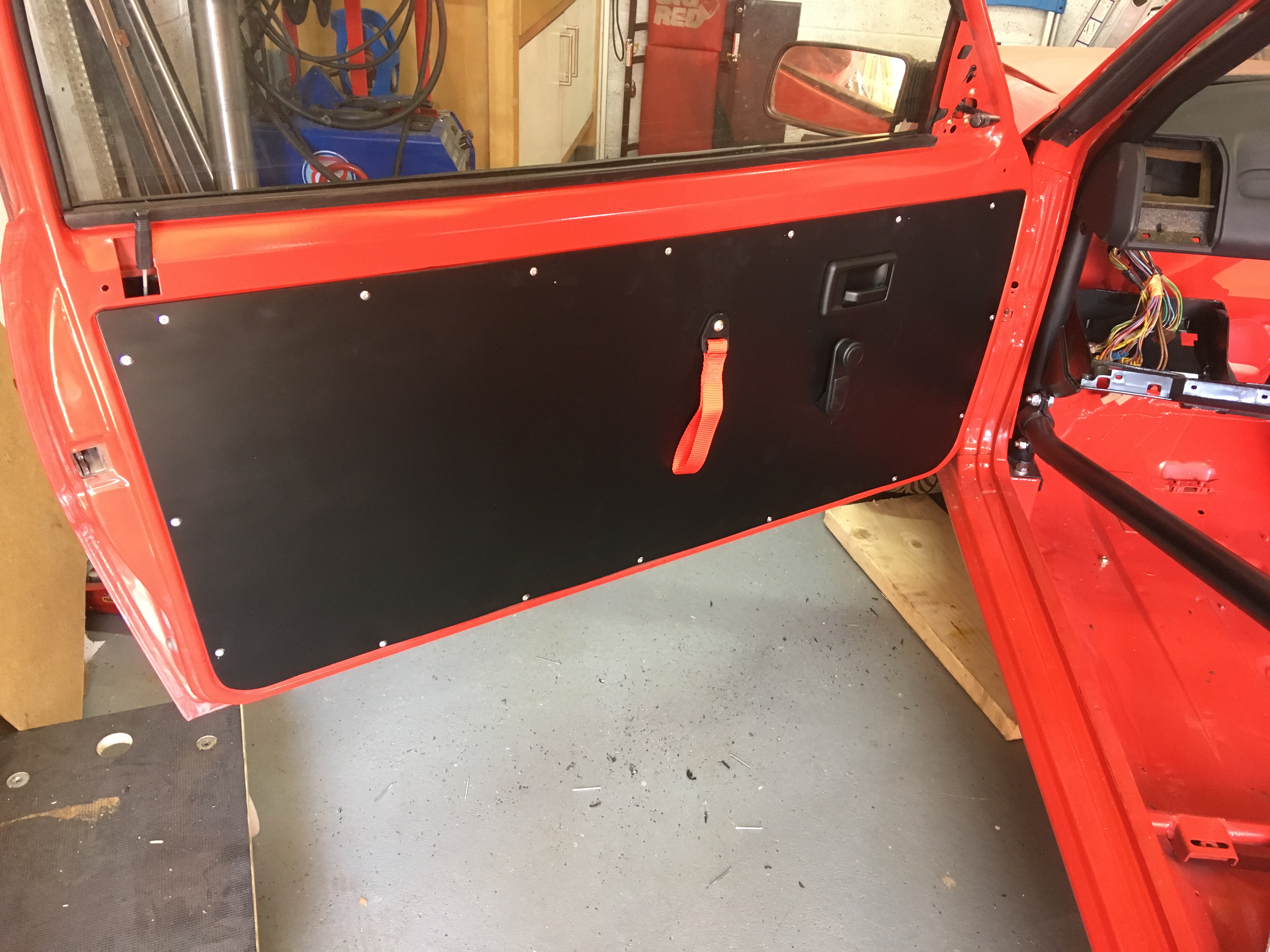

putting the cage back in was a experience. At this point decided to make my own rear quarter panels and new door panels. These made from 3mm Dibond Alupanel (ali - plastic composite)

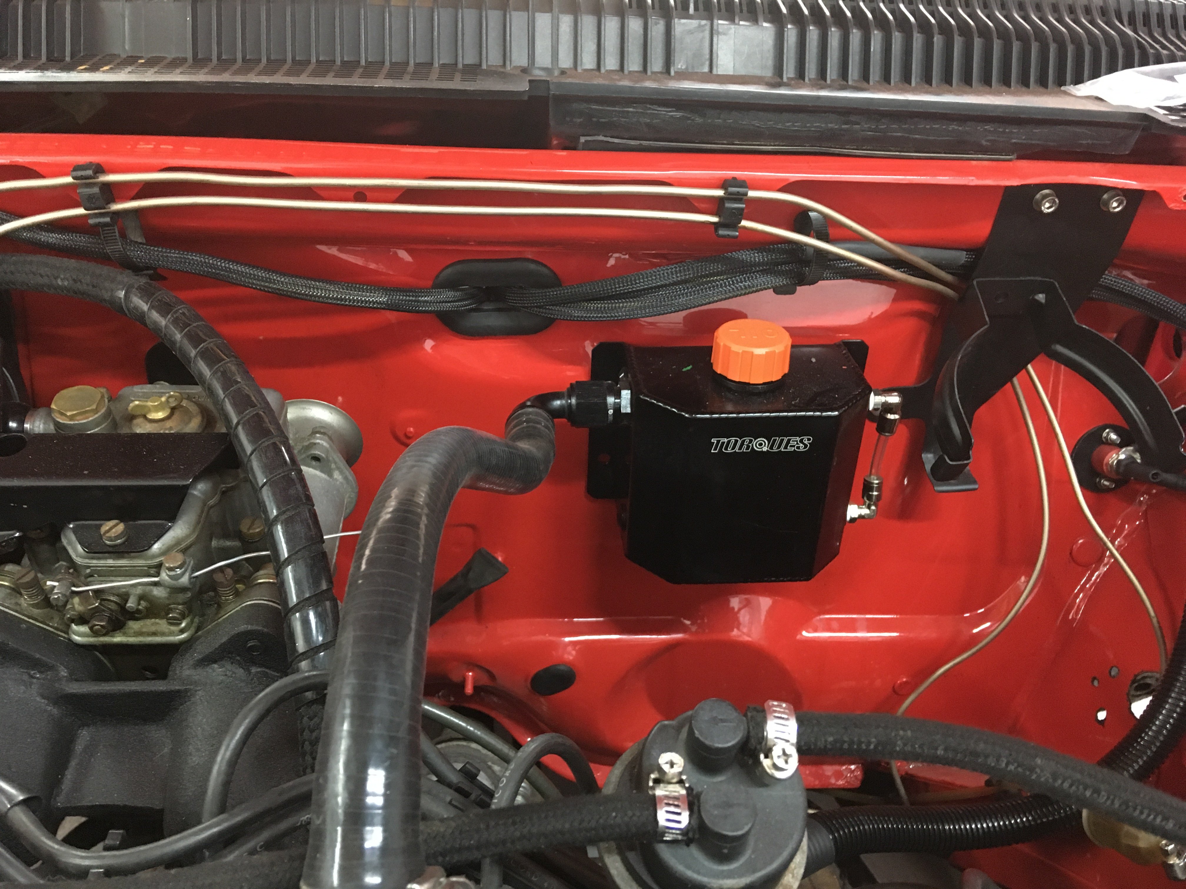

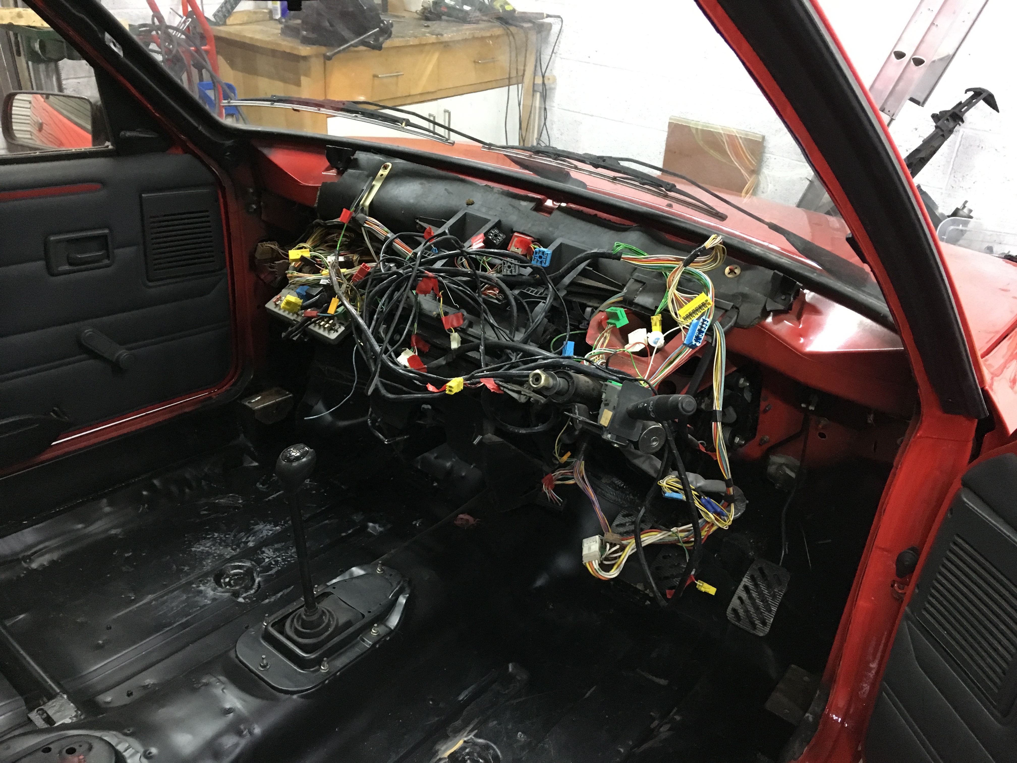

Commenced tidying up the wiring at the rear and within the engine bay
With the engine bay decided to totally overhaul the wiring looms and re-route these more centrally back into the cab. This way aligning  with  the final location of the new fuse/relay board in the centre of the dash

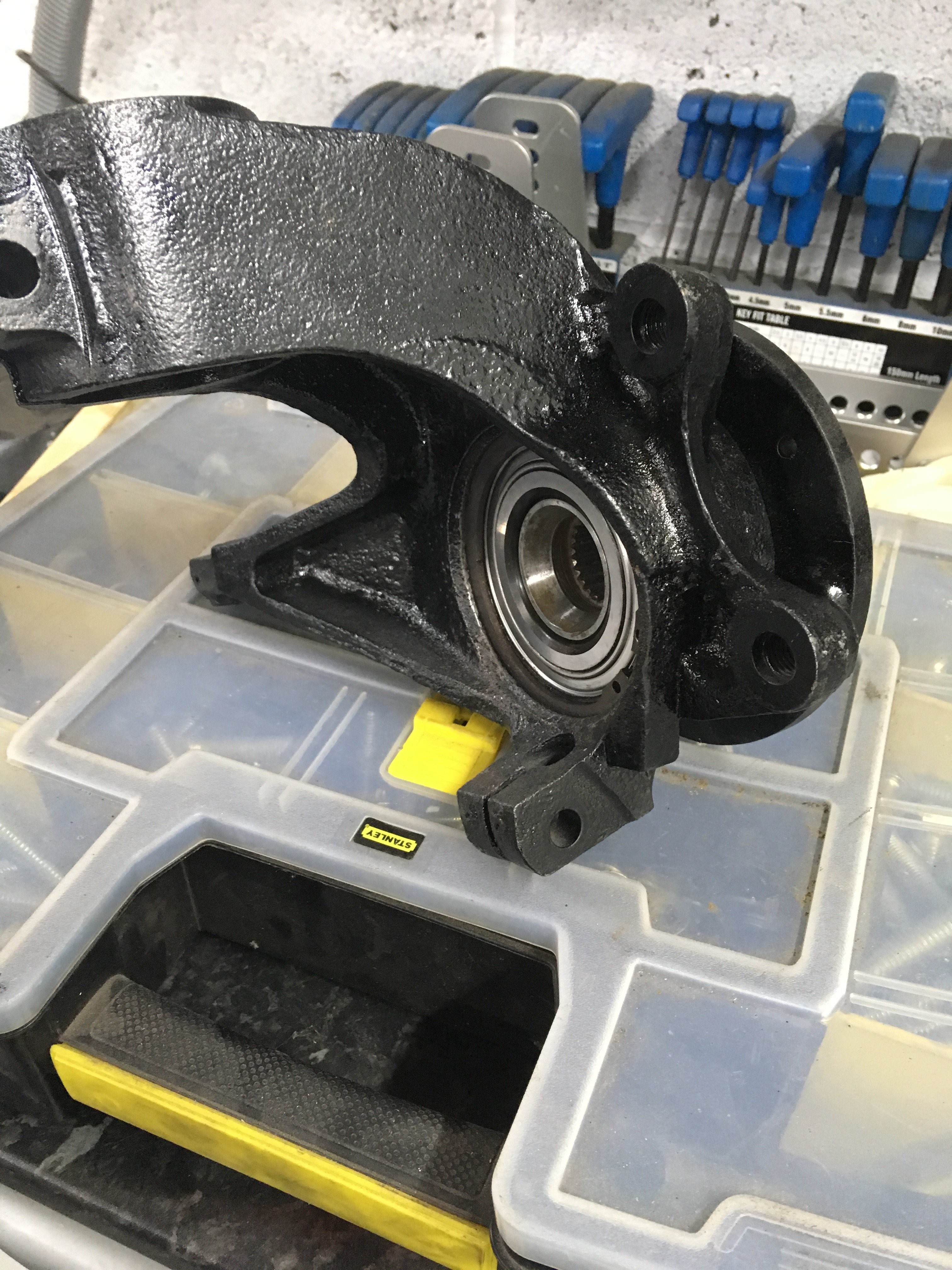

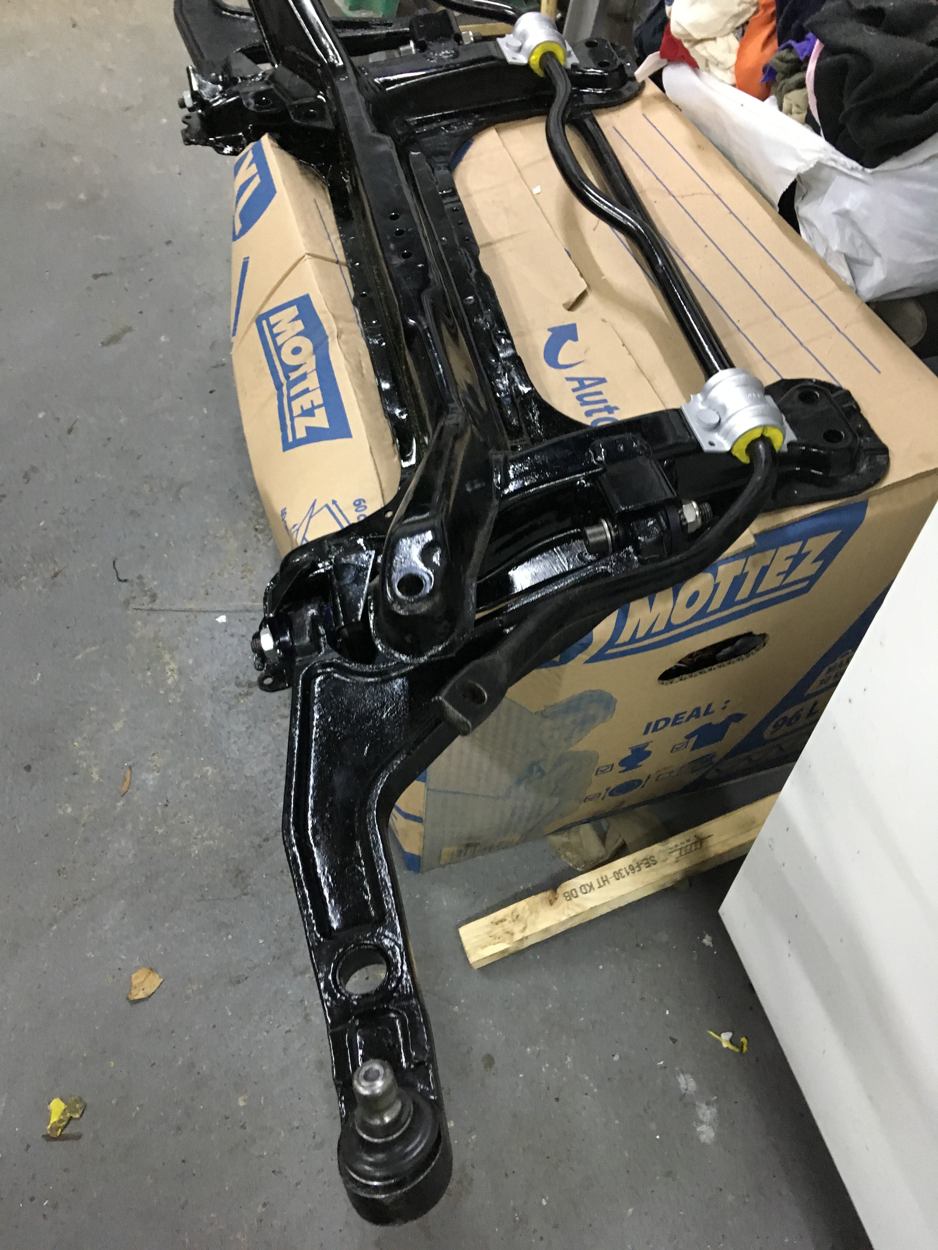

Been some time since any form of update, however tackled a number of jobs since. On the basis for a more sturdier front end for a new engine transplant. Subframe, arms & hubs procured & recon'd in readiness for dropping in. 314054834_Photo15-12-2018140717.thumb.jpg.a321a3d2620f921dc65e7be28af01445.jpg
Arms are 309's, poly bushed with new boots on the ball joints. Subframe, seam welded and prepared for satchshift gear lever unit.
Hubs refurbed with new SKF bearings. Toying with going to stud conversion.

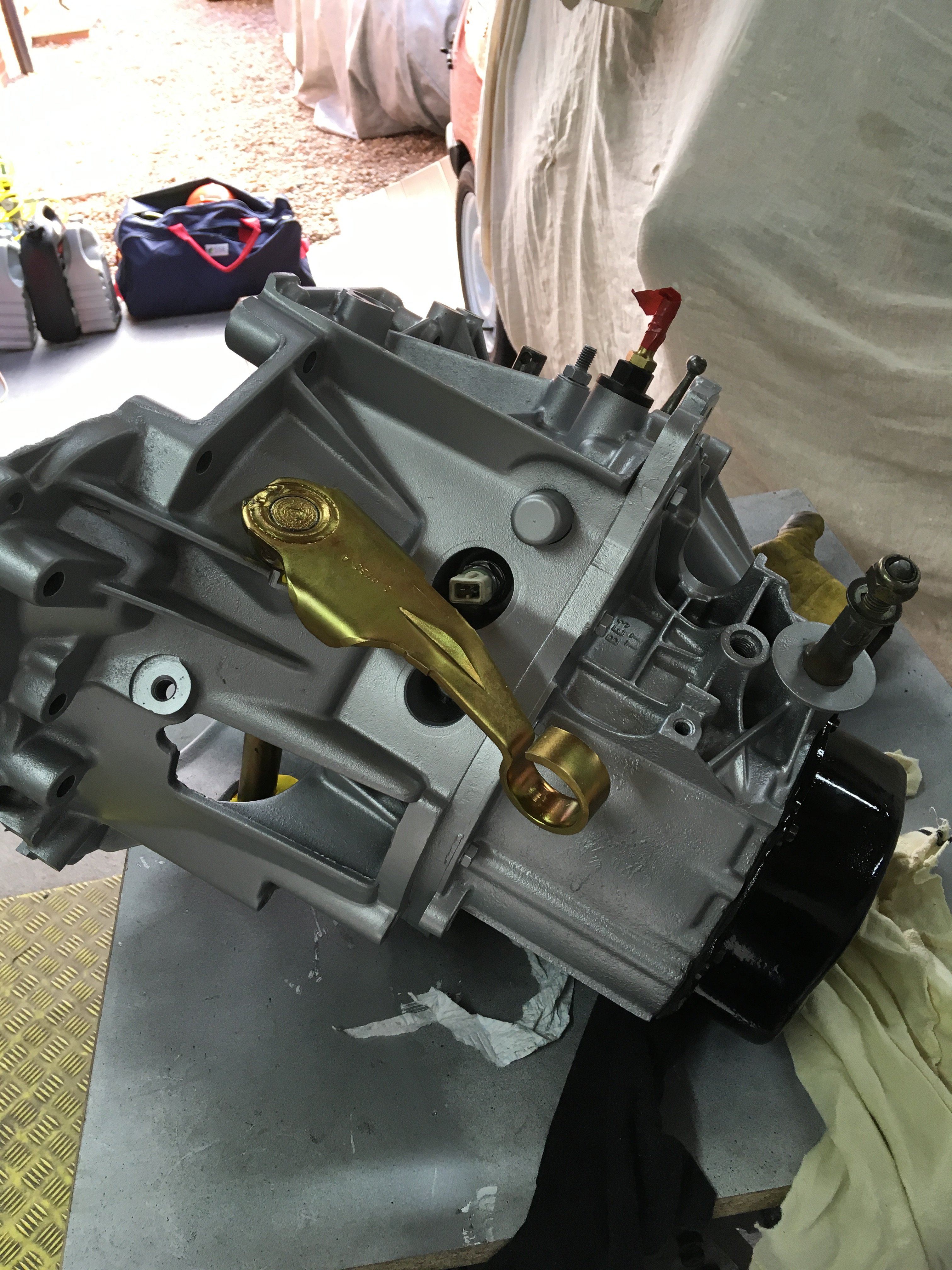

Also procured a Quaife and threw into this. Inspected with new bearings, seals etc

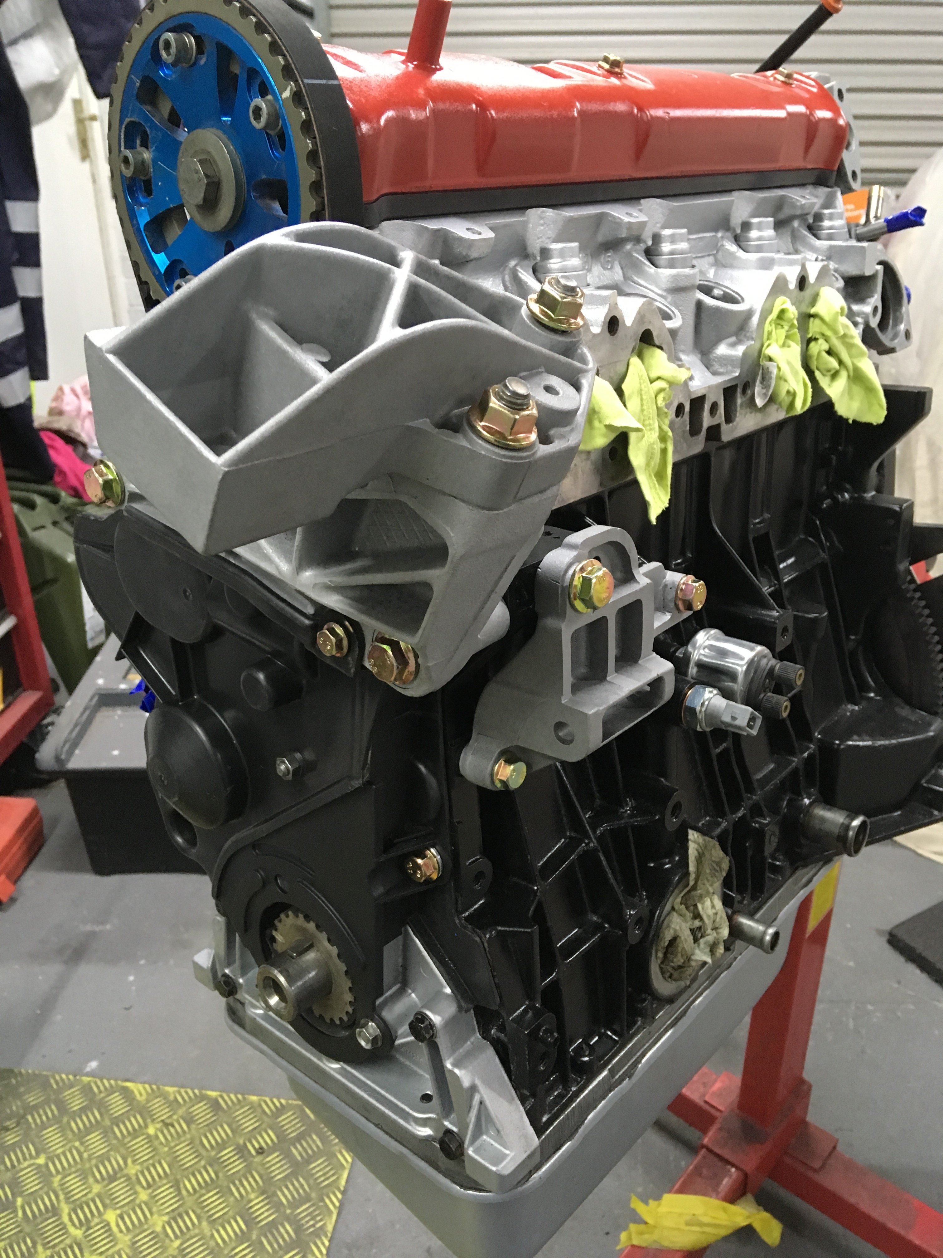

Over the past fair few months been deciding on a engine transplant. Toyed with GTi6, 106 16v etc etc. Wasn't until a 8v unit came about, built for the shale oval racing and only  had a few meetings through it. Fully balanced crank, pistons & rods, piper cam and baffled sump.  Decided to go old skool  so a strip &  inspection, cam belt & water pump, wash & some paint thrown at it , its like this at present. Found that the old alloy mounts (engine, alternator and inlet manifold) glass bead  blasted  and then lacquered come up a treat.
Just saving up now for a lightened flywheel, crank pully and a smaller alternator. Need some new sensors (Temp wise) for the ecu & fan control.
I'm sticking with carb's, but moving towards stand alone ecu for wasted spark set up...why?....because I  like  challenges.

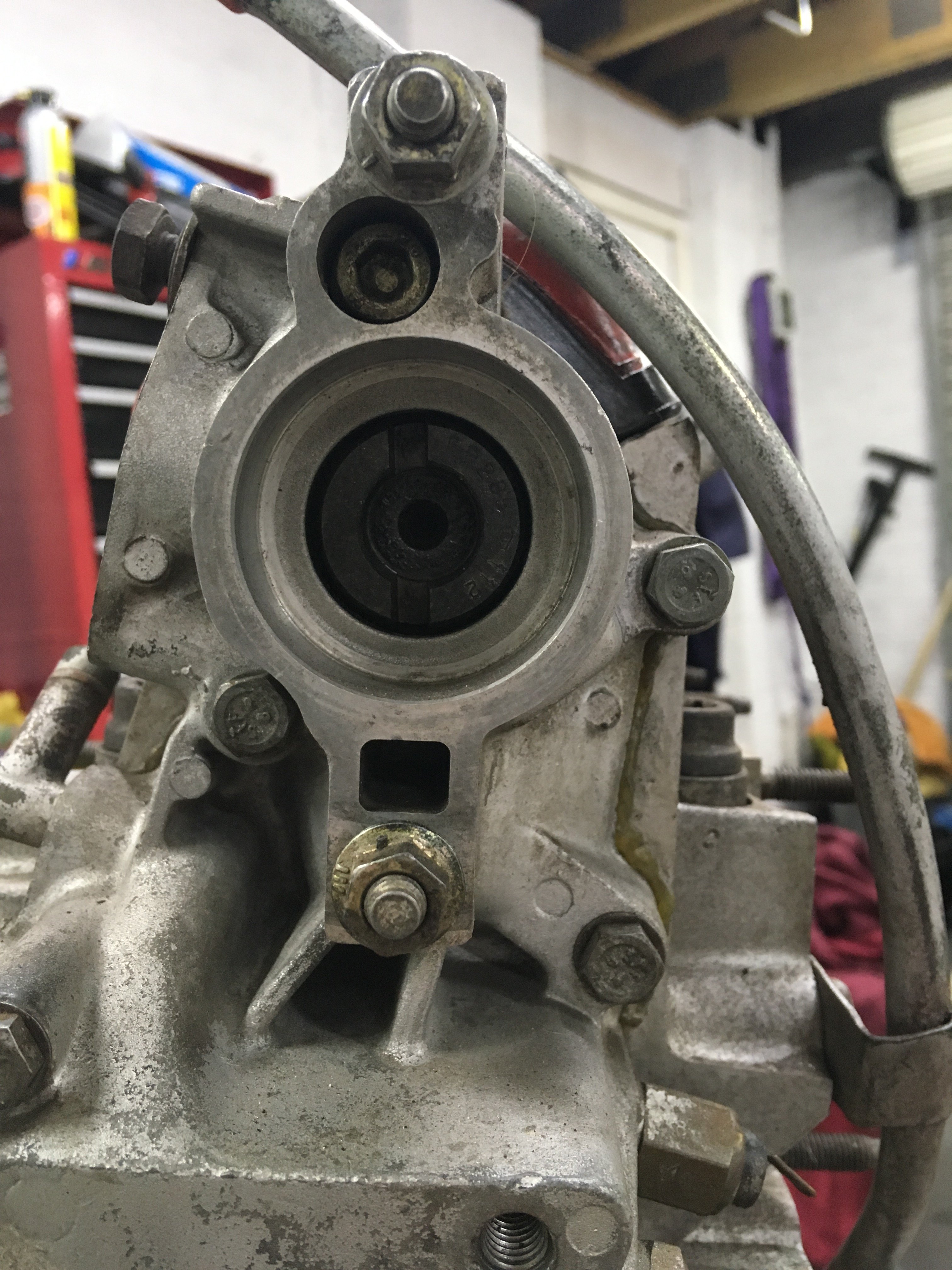

However need to blank the dizzy, as this is where I'm wanting to mount the coil pack. Any idea's.? I have drafted up a CAD drawing for mounting plate/blank - plug for the dizzy opening. But getting this machined is going to be costly.
Anybody with any  other idea's? Had toyed with 3D printing with a  heavy plastic grade.

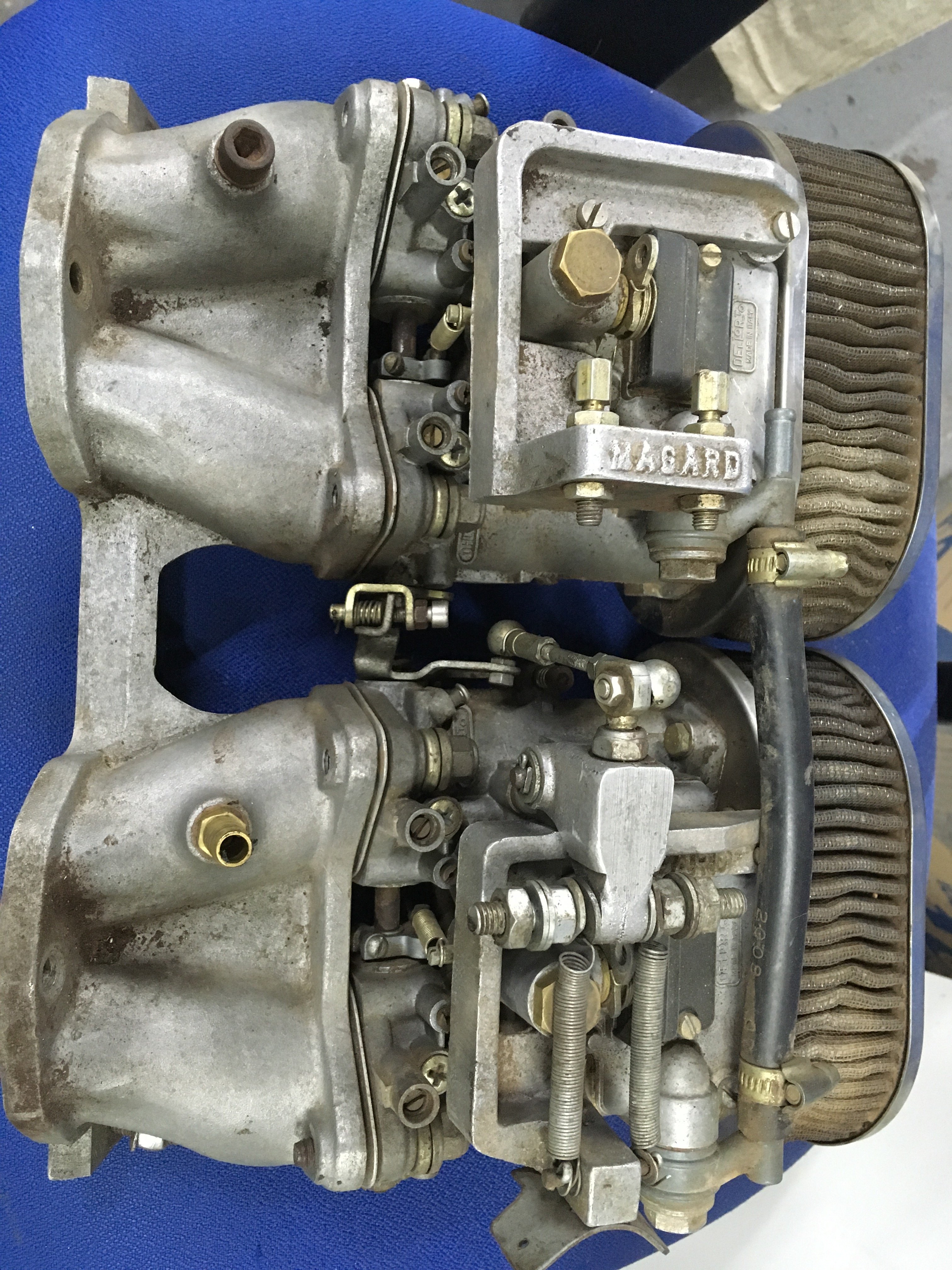

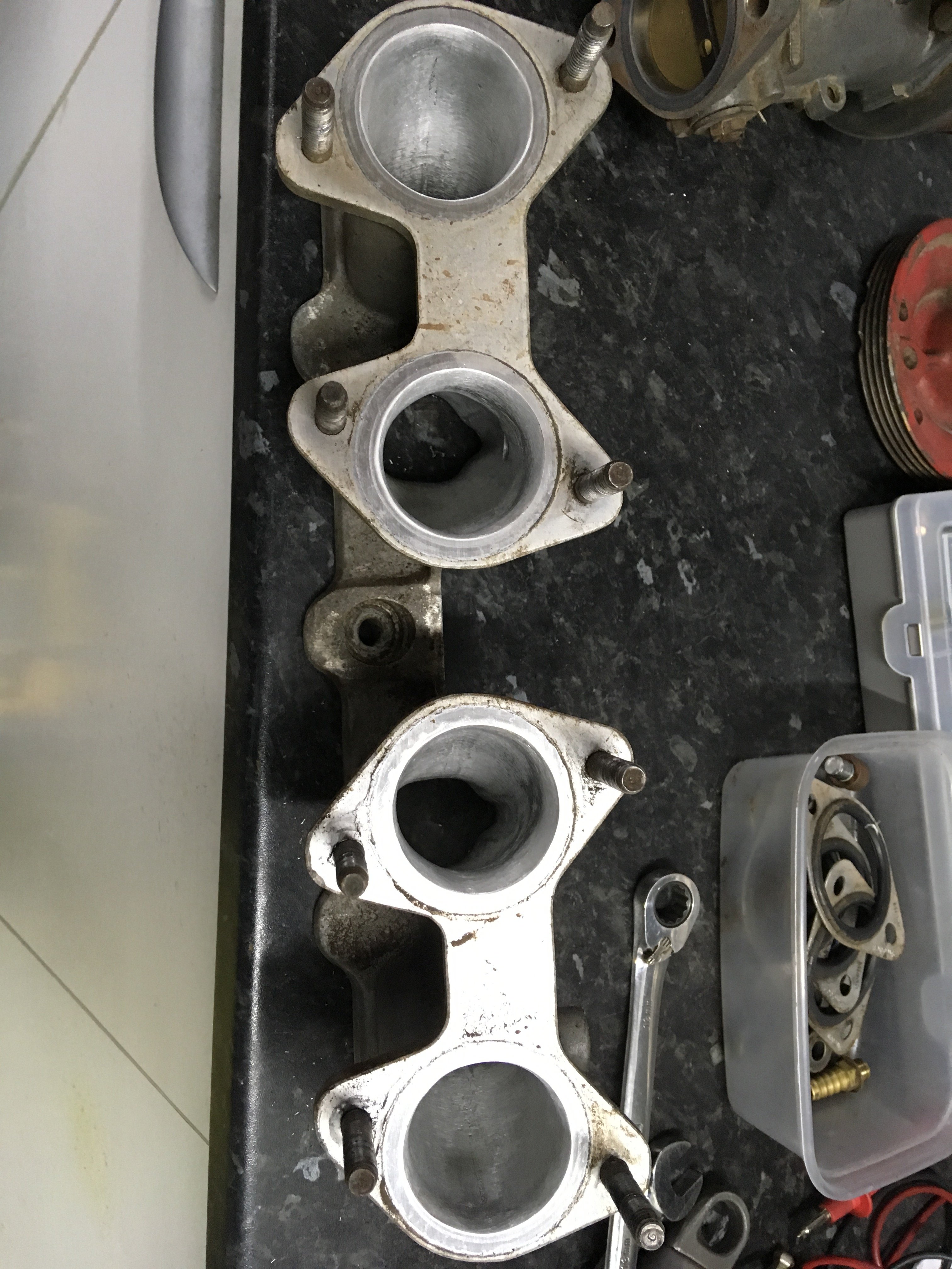

As mentioned  sticking to carb's for now, have these to overhaul. The inlet manifold has already been bead blasted etc. It has been ported/ semi polished in the past. See how that pans out when and if it goes on a dyno.

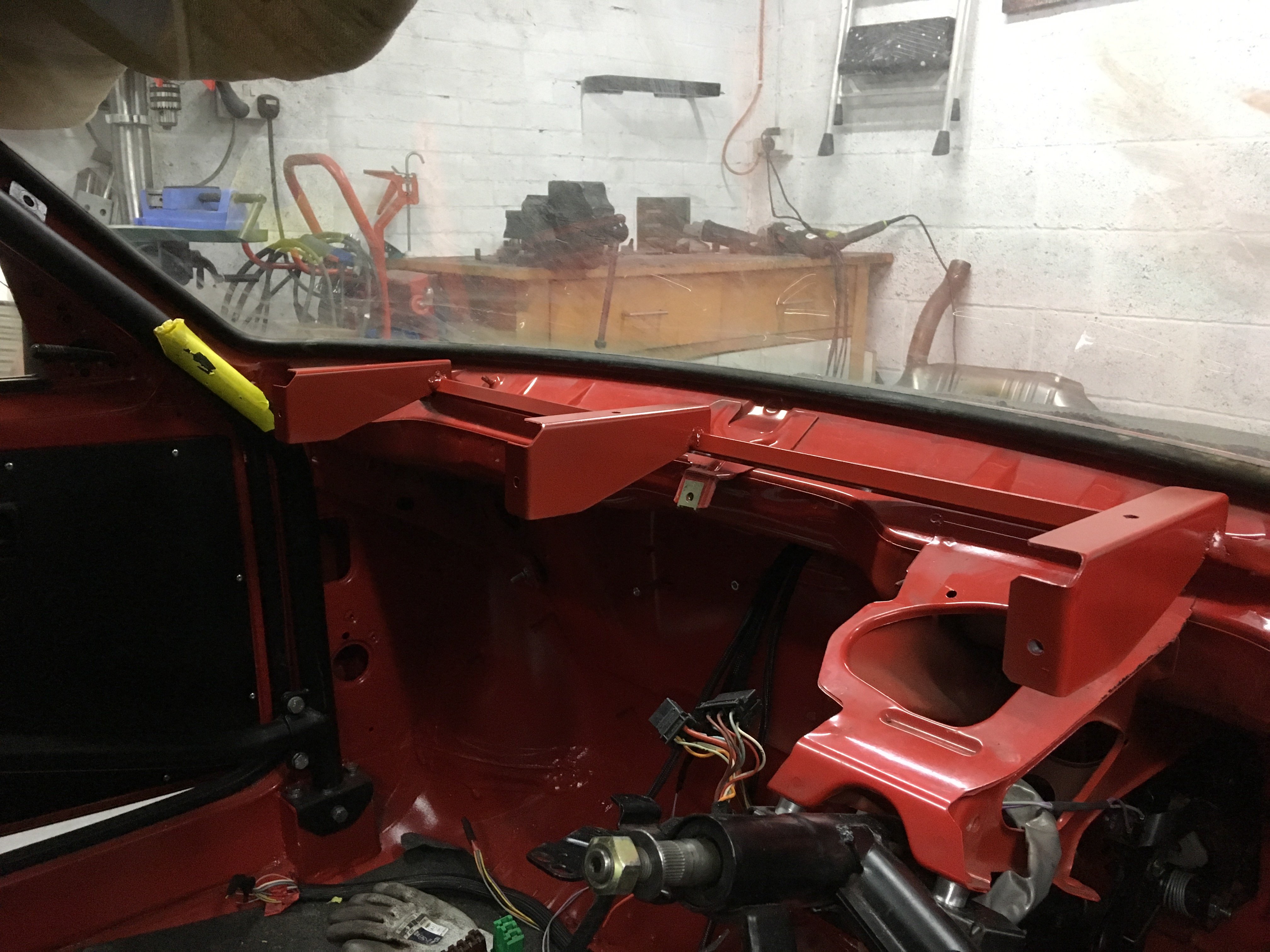

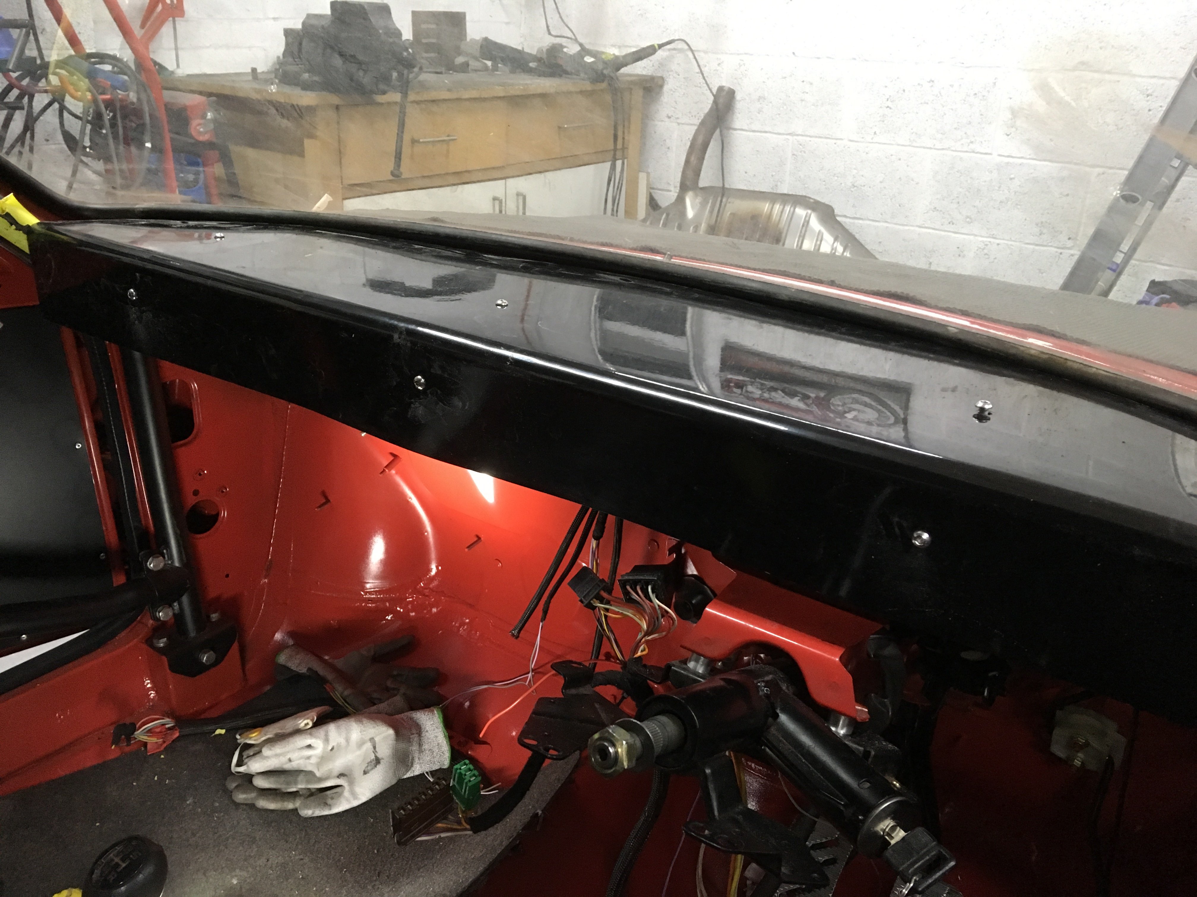

Interior wise and due to me being a short arse had to rearrange things regards seat, pedal  & steering position. As  to make it easier climbing out the car, setting the seat back, bringing the wheel closer with a  combination quick release & extension plus dished wheel, it just left me with pedal position. Unless I can figure out a way of altering and re angling the pedal arms, it looking like a aftermarket pedal box. After seeing a few at the recent Autosport show, it looking like wilwood or tilton (2nd hand of course). this purely on the basis of the sturdy design around the pedal pivot points. Anybody have  any good feedback on any others ?
I've changed my mind a few times on interior dash and after mocking up the standard dash, found out that I was struggling with a few things and wanting to make use of Race Tech Pro Dash2. As this has compliance for road going vehicles in the UK, it helps in simplifying and bringing together a number of aspects i.e.   engine parameters, indications on lights and also providing data logging aspect.
Anyway decided to keep things looking simple for the dash so procured a basic fibreglass set up which looks quite similar to the dash units found in Renault Clio Cup X85 cars.

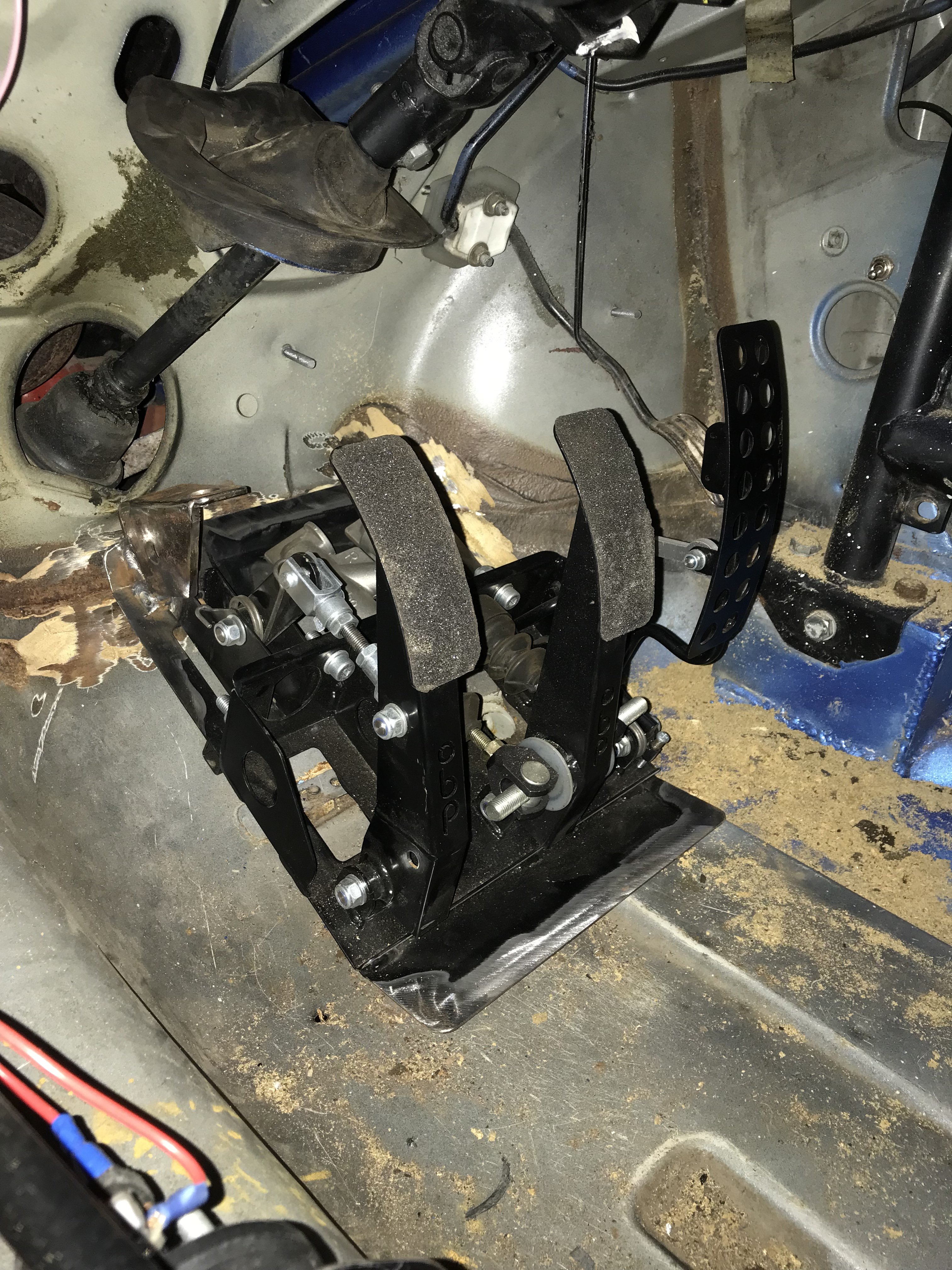

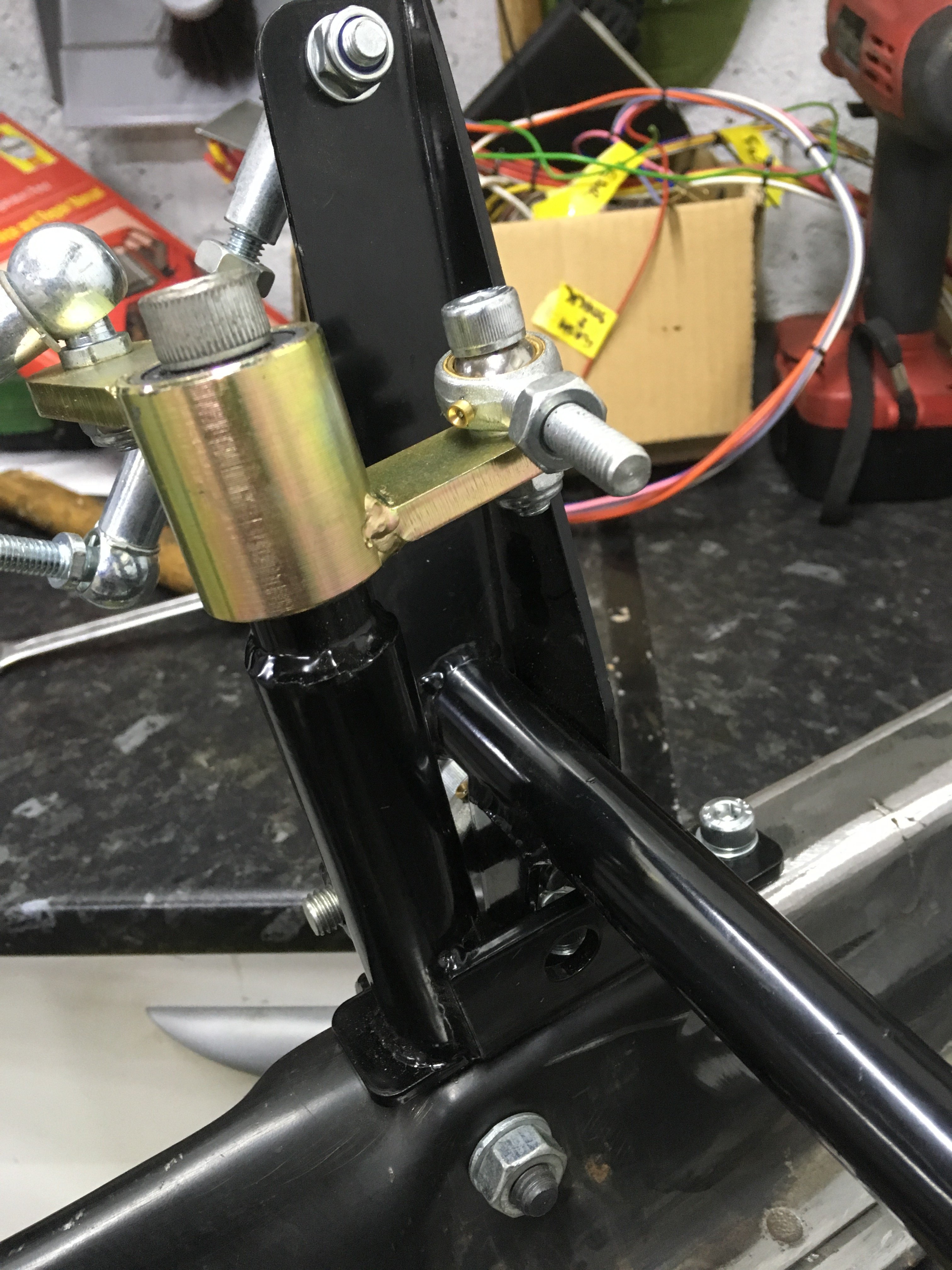

So O'level metalwork skills to the ready , new dash support bar/bracket made and the first part of the dash installed.
499740223_Photo20-01-2019130138.thumb.jpg.a1547702a89dcf2c0aa9ddd107f5cb6b.jpg871200381_Photo20-01-2019134422.thumb.jpg.67850b3452bb4e19aa012438ff4b5434.jpg

and for your dizzy blank could you use a core plug?D7A8565A-B79F-4B44-8618-F70729CC6F31.thumb.jpeg.8f59059ad4ccc85462c1ebbc2fc50378.jpeg

Thanks, seen these and wasn't impressed with the  throttle pedal.
The thermostat  housing can be replaced with  an item from a late 8v xu running  a coilpack, 1.6 dpi auto 205's for example,  and 1.8 405, 2.0 8v turbo and n-a engines.
Or a Renault  core plug fits, not sure which one but Miles  at pugracing has mentioned  this.
