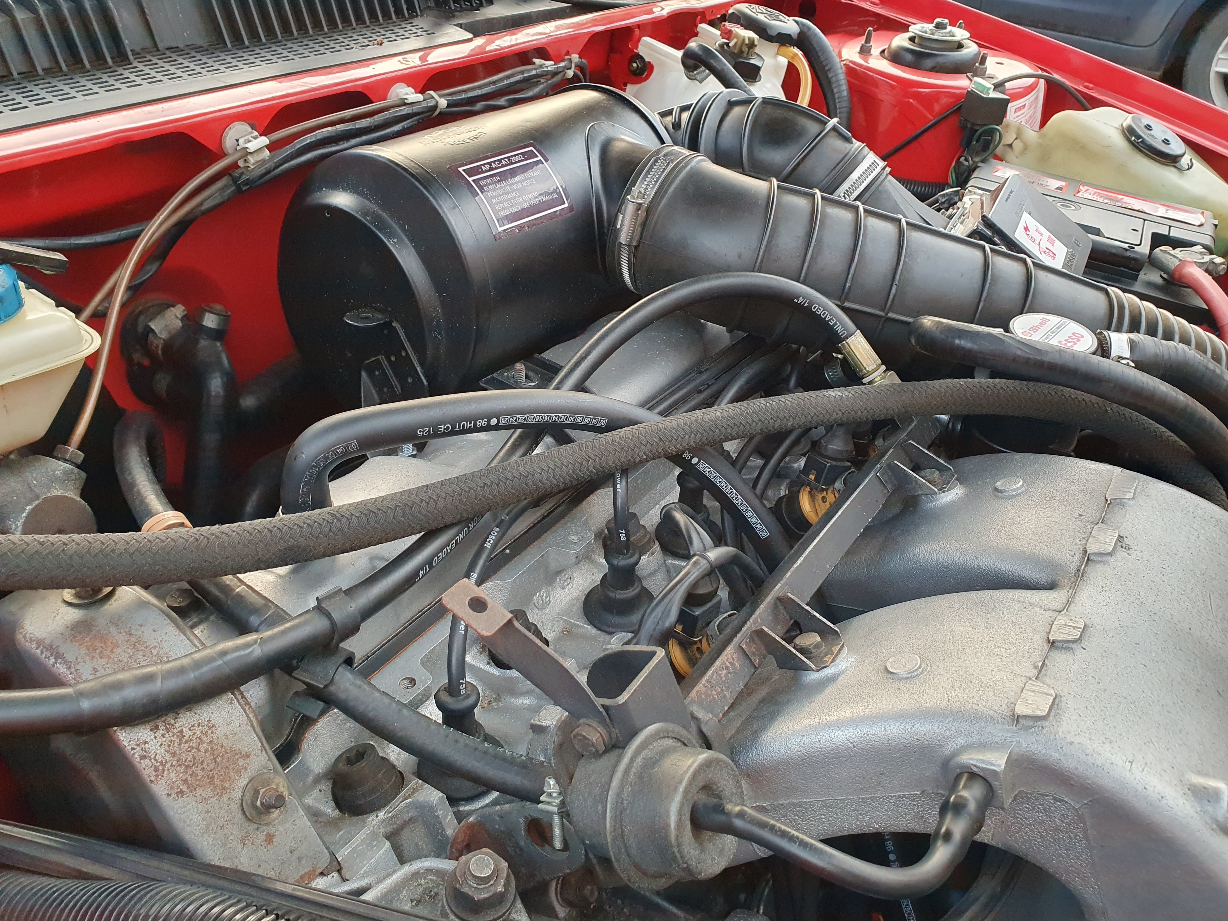

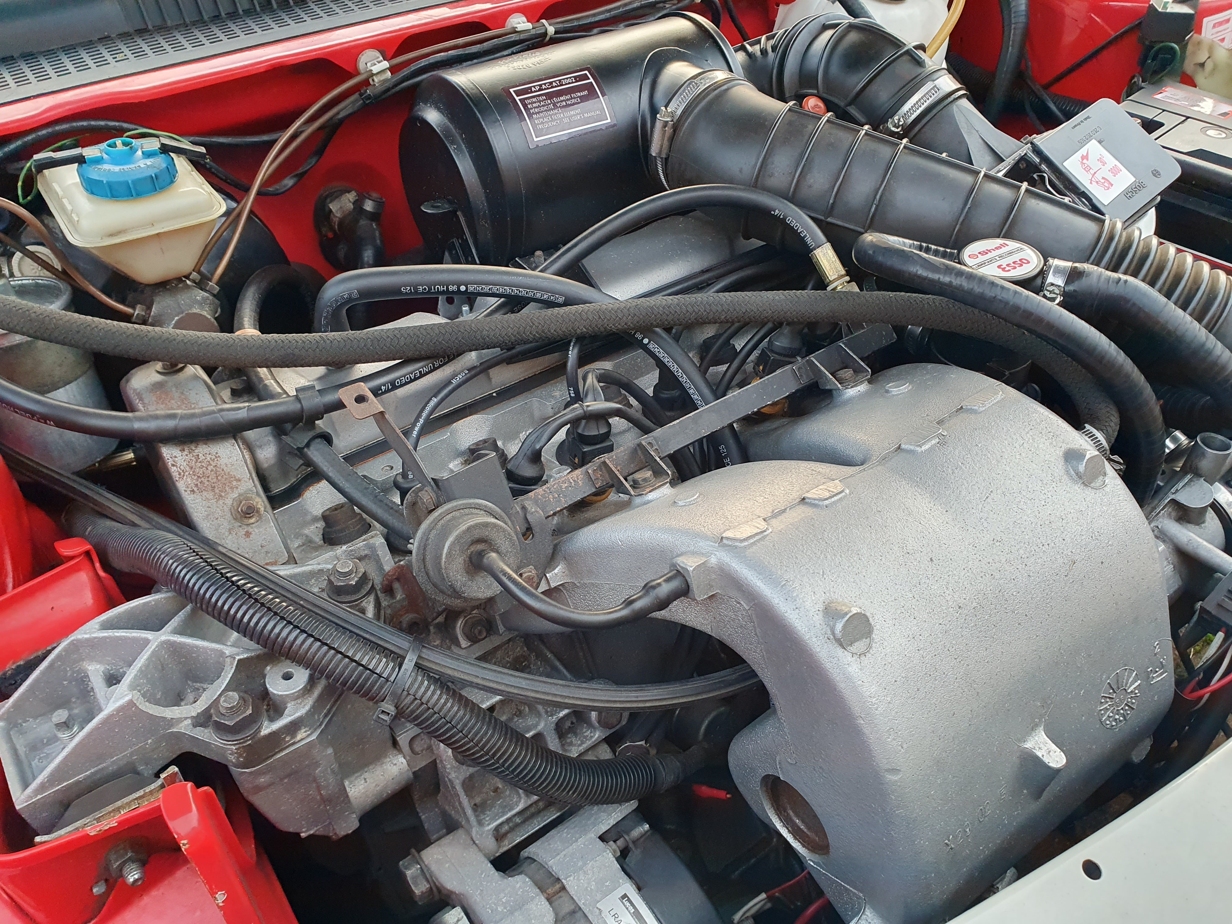

I left my endine and gearbox unpainted. The vapour blasting seems to have worked they still look good 4 years later. Shame I'm now about to send it back into a workshop again for various paint jobs. I guess time and weather really aren't friends to old cars.

I'm surprised it hasn't gone all furry with corrosion Paul , I certainly wouldn't drive mine once salt is on the roads under any circumstances , it just destroys old cars . Blaster still hasn't blasted my box yet as his compressor is broke and he had lots of other jobs on  but says I should have it back before year end , no further with anything as had a few painting jobs to sort in the house which are now mostly complete. I will struggle to put the box back together now as too much time has passed :lol: plus its damn cold in the shed now .
It's not gone furry at all just dulled a bit. The vapour blast guy said it wouldn't andni didn't believe him but 4 years later it still is pretty clean. I'll get a pic to show you.
I'm intending to strip the engine out in the summer and do a mini few 1000 quid tidy up so it should be back to sparkling again. Maybe
