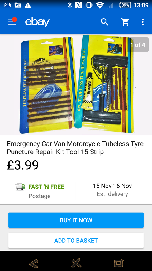

I bought one of these kits off of eBay.
With motorbike and 205 tyres picking up numerous screws. No need to take the wheels off.
It has saved me a small fortune.

IPlod, that looks similar to what they used.
It does say "Emergency" on the pack, doesn't sound like a pukka fix?

iPlod999
Been in one of my 205 tyres for about two years.
Never needed to top up the tyre pressure.
Same on the daily ride on the bike.
Edited by iPlod999

I don't think I'd be happy about having one of them in a motorbike, let alone a car.
