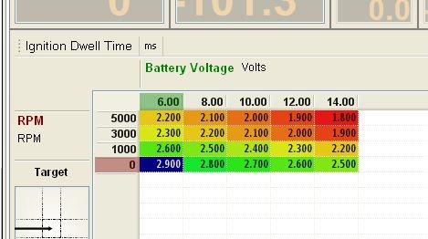

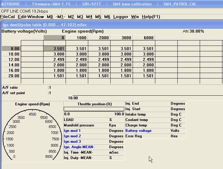

On a related topic Peter, I have tried and failed to find out the inductance of my coils , so cannot calculate the dwell time . At the moment I am using 2.6ms across all rpm and voltage ranges. Clearly I ought to increase that for low voltages . Does the Haltec haves dwell map or do the ignition amplifiers control and manage the dwell in your setup
None of the aftermarket ECU's I've had experience with can ground a normal coil directly.  Ignition modules (or igniters) can be classified as "dumb" or "intelligent/smart". Most ignition modules are dumb and include Bosch 124, 200, 211 etc, where you must set the dwell time in the ECU. Smart ignition modules include Bosch 008, 137, 139, which can automatically determine the dwell time for the coil being used.  Coils which have internal igniters, as fitted to most cars today, must still have the dwell set in the ECU. However, the trigger current is very low. eg TTL.
Yes, I'll find some dwell maps for you to consider. However, you should really put a CRO on a coil and determine the optimum dwell time. I would have though 2.6ms would be on the upper limit for COP.
Dwell tables for LS1/LS2 coils are well documented and usually take into account boost pressure and voltage. Typically you'd be at 3.5ms at cruise and up to 4.5ms at full boost, so the coil has time to cool.
I use a CDI, the input of which is 70/30 constant duty.
Here you go. The default map from Autronic and a Haltech Nissan R32 map.
Andy
Thanks for the tables Peter. I spent some time last evening searching and found the Haltech and Autronic sites. Very helpful. You are right about trying to find the correct dwell time using a cro, hence my comment about wanting to know the inductance of the VE520169 coils I have , because that would allow me to calculate the correct dwell for various primary currents . However, that search proved to be fruitless so measurement would be the next step, especially as coils from different manufacturers or even related the same manufacturer( eg Bosch) stipulate quite different dwell times for their COP coils . Shame I am not using Honda K20 coils. Lots of info on those !
