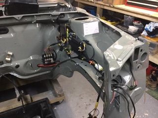

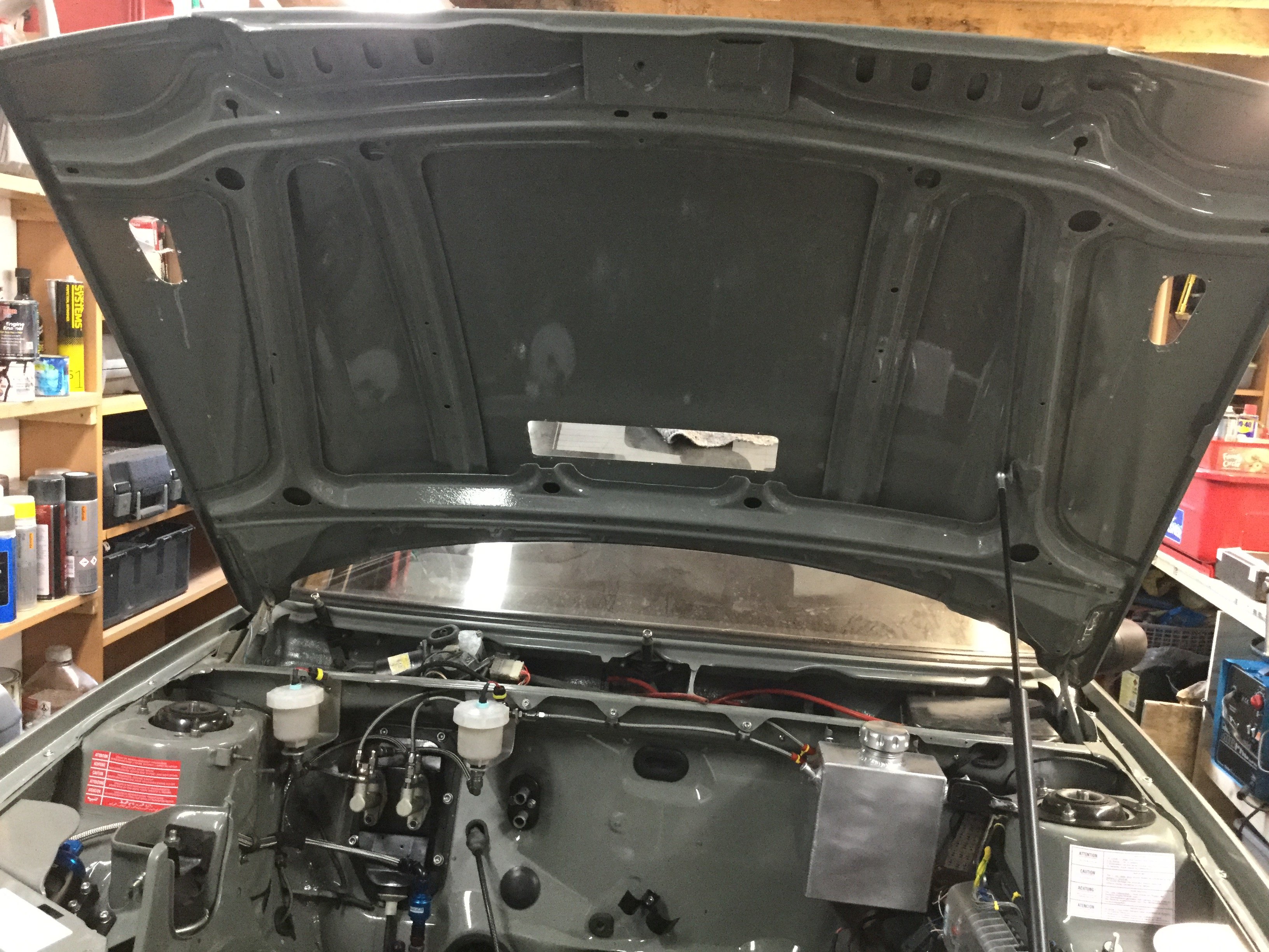

Looks good from what I can see, very neat.

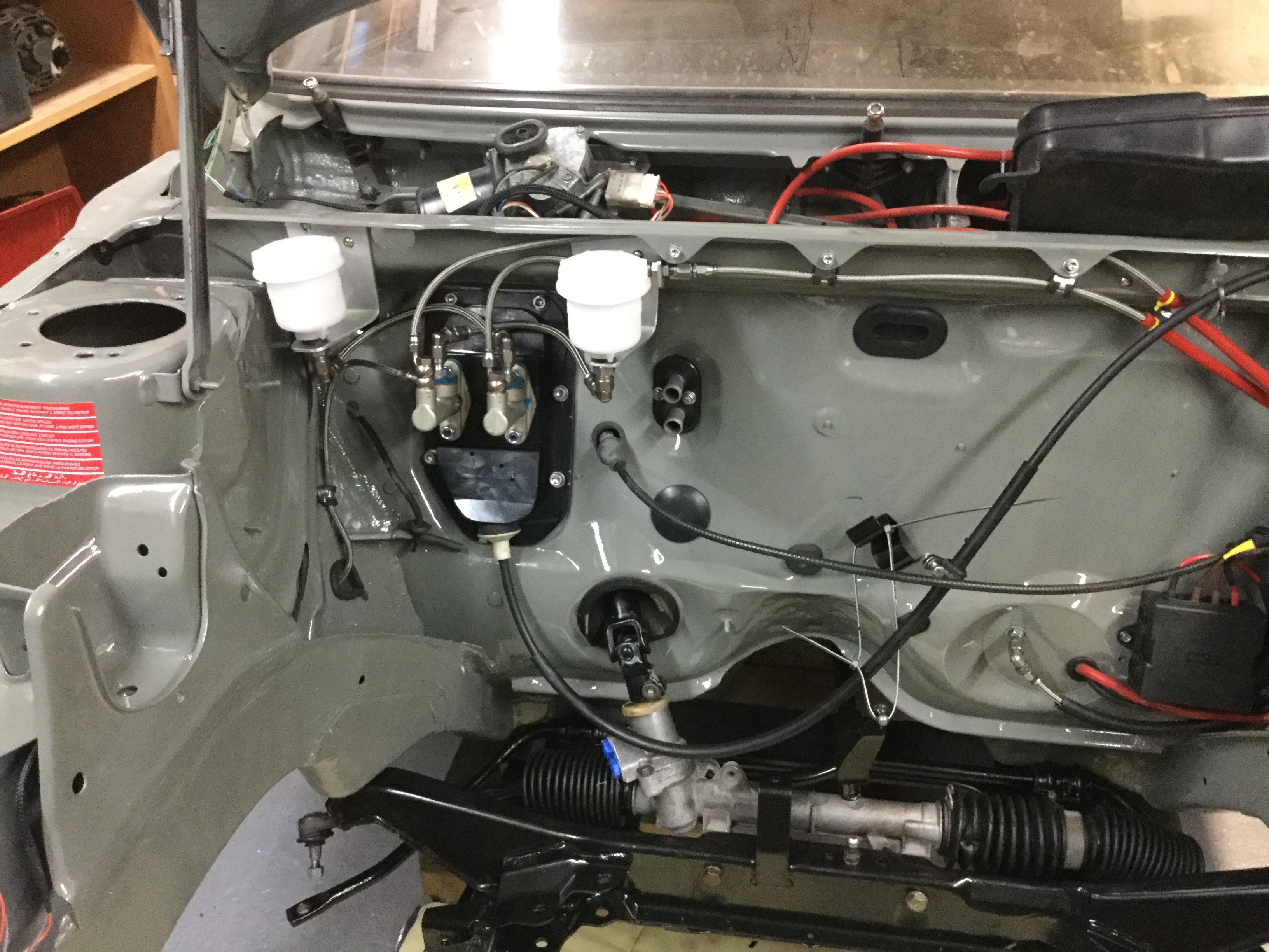

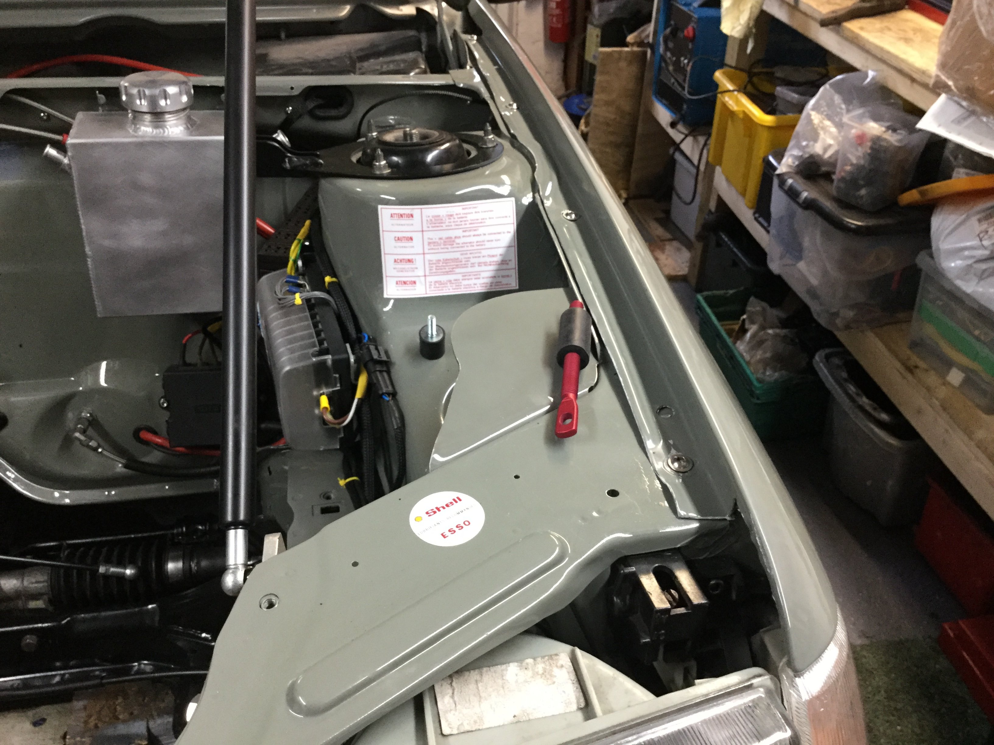

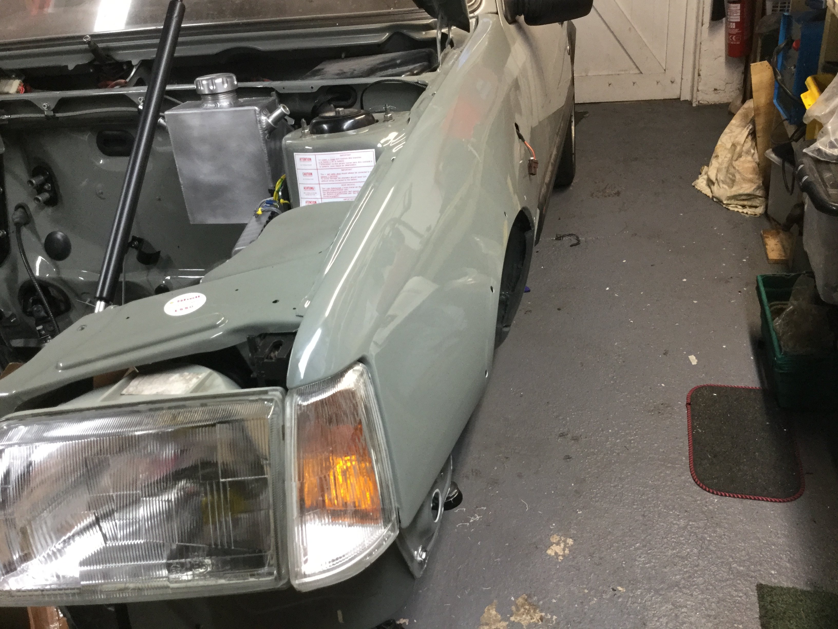

Make sure your expansion tank is in good condition though, I've had one develop a pinhole leak before and it shot coolant straight into the horn relay which kept powering the horn. We were on a trackday at the time and the marshals thought we'd lost our minds.
Andy
Hi. Very small. I have so little space left allocated to upload photographs that it had to be that small. As for the header tank, I have a BBM alloy one ( which does not make it immune to failure but less likely) but I agree, a leak from the tank would give all my relays a really good watering . I might just relocate it a bit further along the bulkhead. Should have thought about that really before I painted
