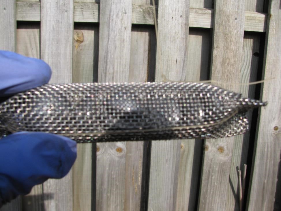

Found a weird guaze with large ball bearings inside rattling in the tank. Pic to follow

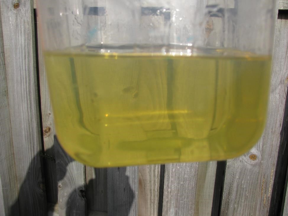

Heres the last dregs of fuel from the bottom of the tank - looks ok
Any heres the mystery guaze thing i found whilst rooting around in the tank

That gauze looks like one of those spurious "lead replacement" cons from the early 2000's when they phased leaded petrol out.
