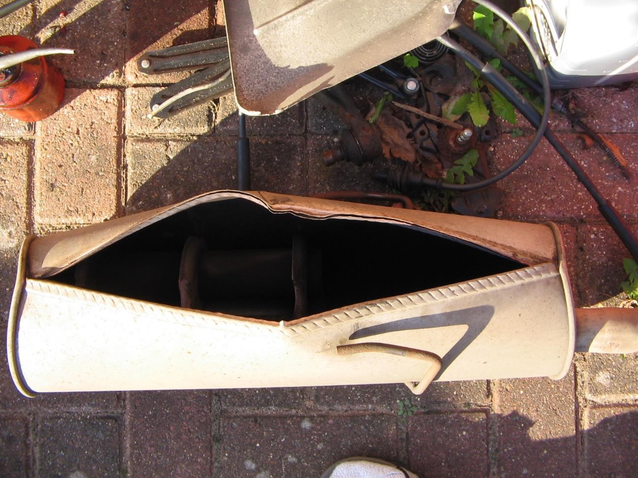

Car broke down on A14. Towed off by police. Massive misfire. Let it cool - got it going - went to mates - played around-changed the ignition amp and coolant sensor. Seemed ok
Set off home -down the motorway- As I slowed down massive BANG -pulled over - the entire back box blown open.
Thoughts? I can only think a HT lead breaking down and no fuel burning in a cylinder- any advice appreciated

When it initially starts and is cold - yes its running on 4. Pulls as it should. Once it warms up -no its not. After changing the amp and sensor it was fine. Hence thought it was fixed. It had however had time to cool a bit. Went down the motorway for 10 miles - as soon as I slowed it started hesitating. Got worse then pretty much died apart from I put the clutch in and revved it to keep it running then Bang -split back box.
Probably on 2 cylinders (maybe 3) at that point.
to be welded back together- it blew as I passed a bus stop- never seen people trying to take over in Rural Suffolk before!

Broken down again. Im Sat im the car waiting for it to cool / evaporate the fuel off. Leads changed. Seems ok runs fine then after 10mins on a duel carriageway I came off and slowed down. Instant hesitation. Had to stop because it was so bad I wad expecting another back box explosion.
scbond
Definitely AFM. As Tom said it's overfuellig and quite badly. I've had a back box blow on an old car where the MAF had been left unplugged...ran very badly and the heavy exhaust fumes cause a blockage and it blew (7am in suburban Manchester...was like a shotgun going off hahaha).
