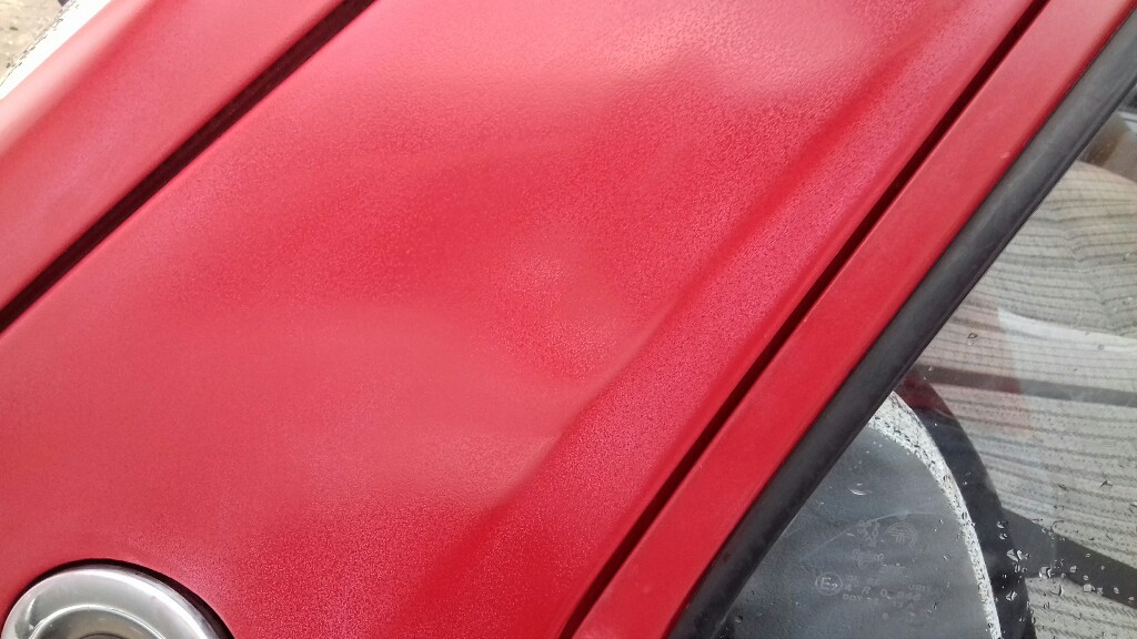

Hi chaps. So when I tried to shine the last coat as a tester I kind of gave up because it just seemed I was removing more and more paint. Using Autogym polish the cloth as I applied the Polish rapidly turned pink.
I just couldn't figuresist this out. I know that all polish is abrasive but had expected the paint to harden and stop being removed so easily.
I used 1000 and 1200 grit to get the paint smooth and realise it's essentially finely scratched but presumed polish would start to shine it. All that happened was more paint got removed. Do you need to wait post flatting to allow the paint to hardenew more maybe?
steve@cornwall
You really need a cutting paste between the paper and polish. Mine is still dull after 2500 grade.
Ok so flat with the wetc and dry. Then cutting paste - on a cloth if not using a buffer?!? Then polish?

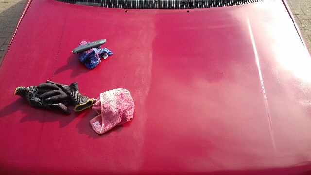

Cutting compound applied to bonnet and wing- it's gone shiny! !!
Here's the bonnet 1/2 done ... I tried polish 1st and it did nothing I cannot believe the difference.

Looks tons better. How satisfying is that???
Very! I did that half and was like- f*** me!
I'm starting to get the idea how to do this now.... metallic paint next...

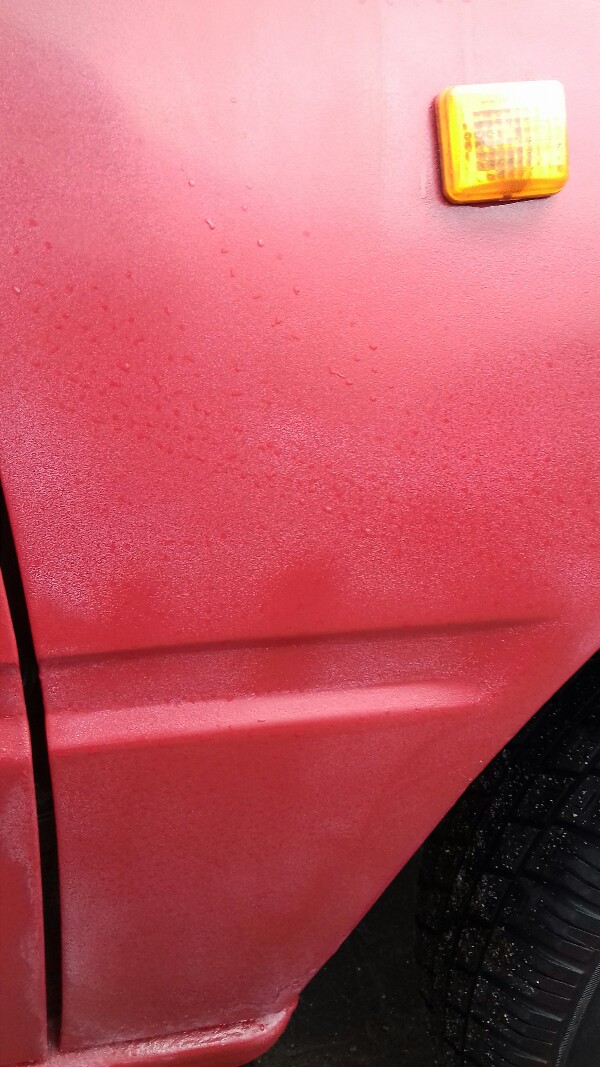

This afternoon Ive hit a bit of a snag. The car got rained on and now there is a 'bloom' on various areas where its been cut back.
Not really sure what to do about this! Its only on the panels that had cutting paste applied. I thought I'd just got got id of all the cutting paste but no matter how much I rub it fades and then returns.
Ive done a bit of research and some sites say it needs to be machine polished/cut to sort it.
My mate has lent me a polisher but Ive got no idea how to use it really.
Anybody else had this issue?

Do you mean it returns after more cutting back? I've had paint bloom like that when painted in damp conditions but has always cut back successfully
No I cut it back yesterday, it rained today and when it dried the white bloom was there.
steve@cornwall
I wonder if it's a film of paste? I'd have a go at cutting it back a little more
hi steve, I'm thinking it is- I noticed on the drivers door where we haven't worked yet there is a similar effect. Like when you miss a bit of polish.
I'm going to have a go with a polisher my mates lent me and see if that gets rid of it as elbow grease isn't working!
