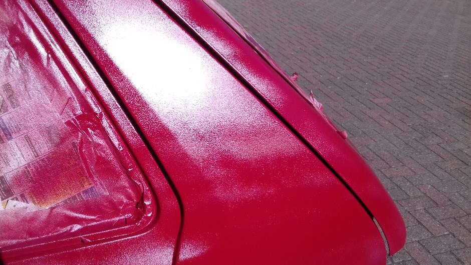

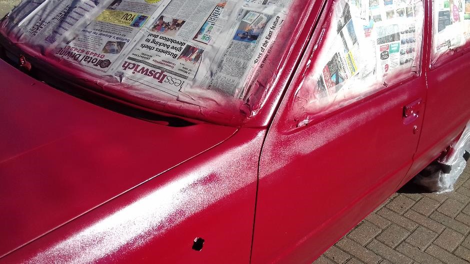

Never used that type of paint, but would assume that as you are adding thinners and the paint has not fully cured it should bond well enough if done now. Put extra on all the curved surfaces and edges as they are most likely to rub straight through when flatting off.
Hi steve
the data sheet says:
overcoatable up to 2 hours or after 48-72 hours according to film thickness
it seems the amount of paint I used was about right 1L =7m2 at 50 u.
Would I have to rekey it or just spray straight on?
steve@cornwall
I would say that within the 72 hours just wipe down and paint. Although if you flatted one panel you could practice with settings on the gun/technique whereas spraying on what's there will just coat over the irregularities. I altered the fan adjustment when I cleaned the gun and have gone from a finish that needed just cutting paste to be flat to a finish I will need to sand too.

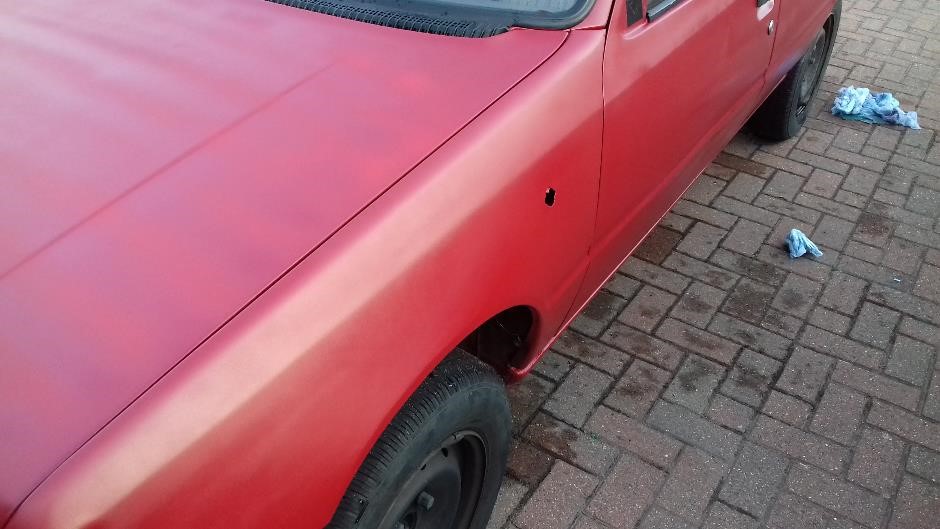

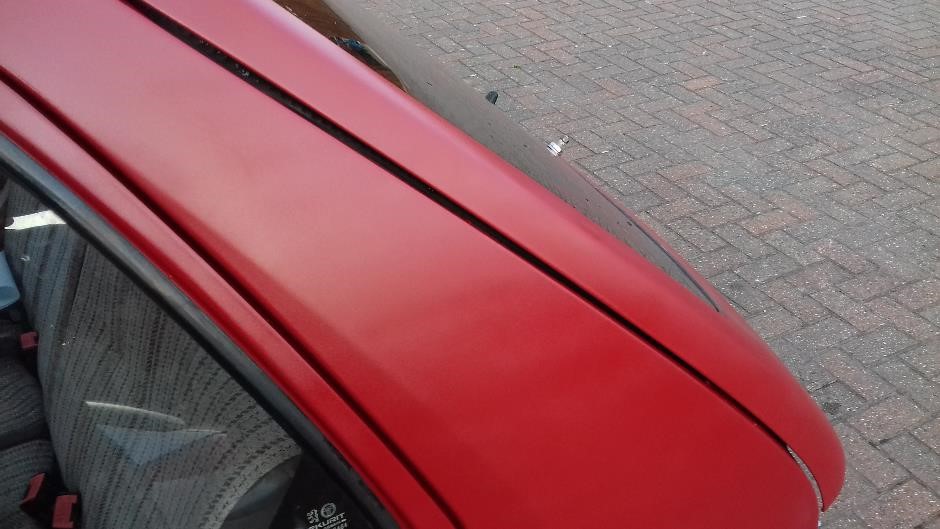

Cheers steve I think in maybe need to spray another layer on ! Not sure it's going to be thick enough for a heavy handed amateur
so against the advice of the paint shop we set about wet and drying the car.
It now looks a lot better- smoother but not perfect.
I intend to respay it in my mates new workshop sometime in October as there isn't really enough paint on it. In the men time we are practising finishing/flatting and polishing.
Results after rub down: (ignore the bonnet- it needs a lot more paint!!

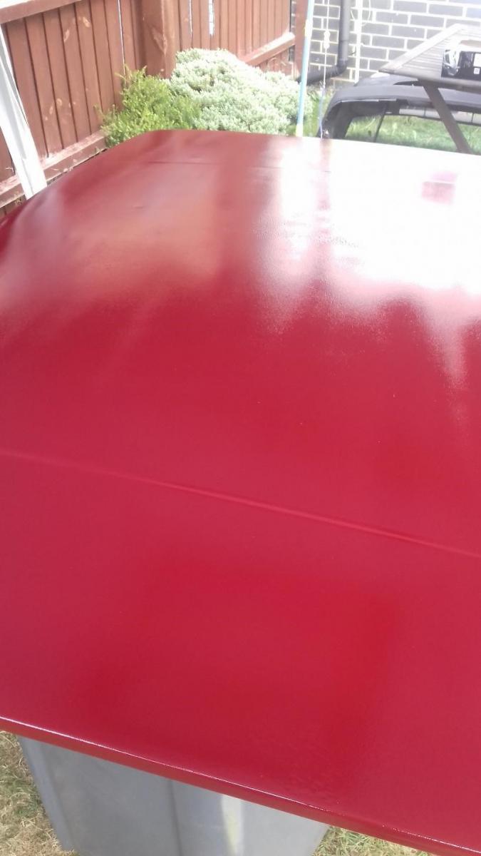

It doesn't really look to great up close! The owners of the paint place told me to strip it and start again. Even after a very hard afternoon with the wet and dry I didn't get back to any of the primer that was added whilst we prepared/repaired so I figure the paint can't be that thin.

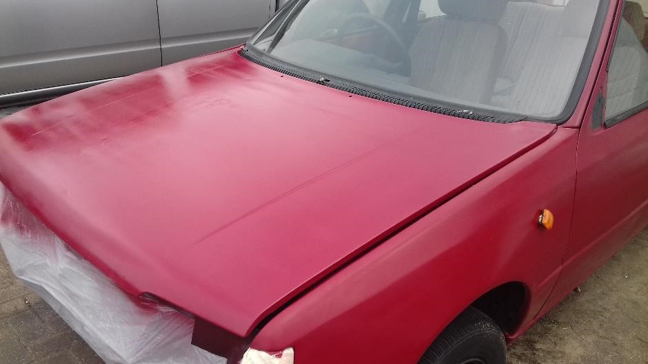

Today we took the bonnet off and resprayed it
its not perfect but we are learning!
The gun still didn't put a decent coat on until I released the paint hopper lid a bit - then it flew onto the bonnet
I guess it was creating a vacuum not allowing the paint to flow
you live and learn!
still a bit stripey but now there is loads of paint on rather than a micro layer so it should cut back
Hoping!!!
