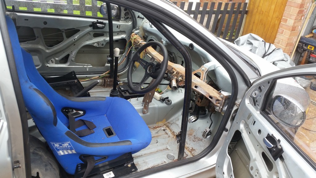

Bit of progress. The interior is stripped apart from some bulkhead insulation. Windows are gone ready for the lexan ones, tailgate and bonnet are gone ready for maxisport fg ones. Cylinder head is in the shop getting done and the bittom end us now nearly assembled with new shells and gaskets etc.
Richie-Van-GTi
But if an update. The car is now going into storage for a while as I am moving home. Progress so far as follows.
Engine is now semi assembled so far as head pistons block etc all togethere. Not timed and no lifters inder the cams yet as not had time to make the solid lifters. Gearbox has new clutch fork, arm and bushes along with shaft seals and Satchshift top arm. Engine and box mated together with RichW flywheel and new push type clutch set up. Then both sat in engine back using some drilled box sectuin as a temp top mount arm.
Started fitting the satchshift but doesnt seem to want to mate with bulkhead so awaiting colin's advice.
Cage is welded in after fabricating custom feet for it since it didnt come with any.
The polycarb windows are fitted all round now as are the fg tailgate and bonnet. Not painted yet as undecided on colour schemes.
Rear dusc beam now on with Koni adjustable shocks. Need to set height when everything else set up and built.
Fromt suspension will go in with new arms, track rods, arb bushes etc when I fit the driveshafts.
Next job is finish the trailer so I can pick the car up to work on it easily as no working at the storage facility.
Few pics on way, not 100% up to date.
Edited by Richie-Van-GTi

Anthony
What's the deal with the B-pillar legs on that cage? Had it been cut out of another car previously and they cut those at the leg rather than removing the feet or something?
Is the aim to try and have it ready for the start of the season next year?
Richie-Van-GTi
Long Long time since i posted on here, car is still sat in storage as I took on another french project over winter. Built a Relay Motorhome for myself :P .
Anthony yes the previous cage owner had the base plates welded in and just cut round the welds so I didn't get any feet with the cage so had to make from scratch.

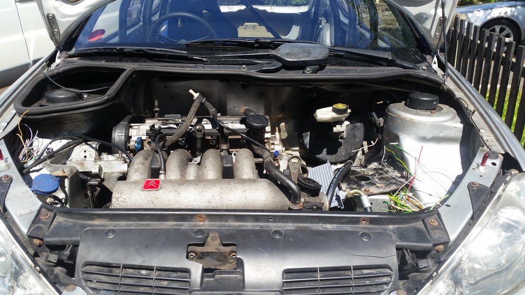

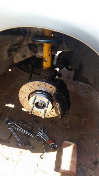

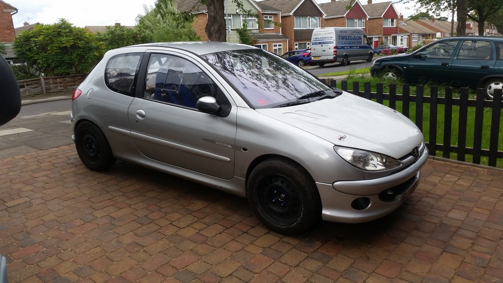

well after nearly 2 years in storage I decide to drag this back out and do a bit. Funds got really tight, had nowhere to work on it and uni took priority. I have decided to get the engine running as a standard 6 lump for now so I dont have the expense of remapping. trackday it for a year then decide if its worth spending the extra to race it or just do something else. Pretty sure I will have some fun with it.
Anyway after 1 week on a driveway the engine is built up and in, engine mounts made and installed, satchshift installed, all the drivetrain stuff done and big brakes etc. Lowered 180 beam in place (it had an SW beam but seized whilst stood). Currently sat on the alloy steelies with some scrap tyres :P
As you can see, all the wiring to do and plenty of plumbing. Since the photos quite a bit plumbing is done and oil cooler is fixed in place etc. Got no fuel hoses yet or clutch and accelerator cable.

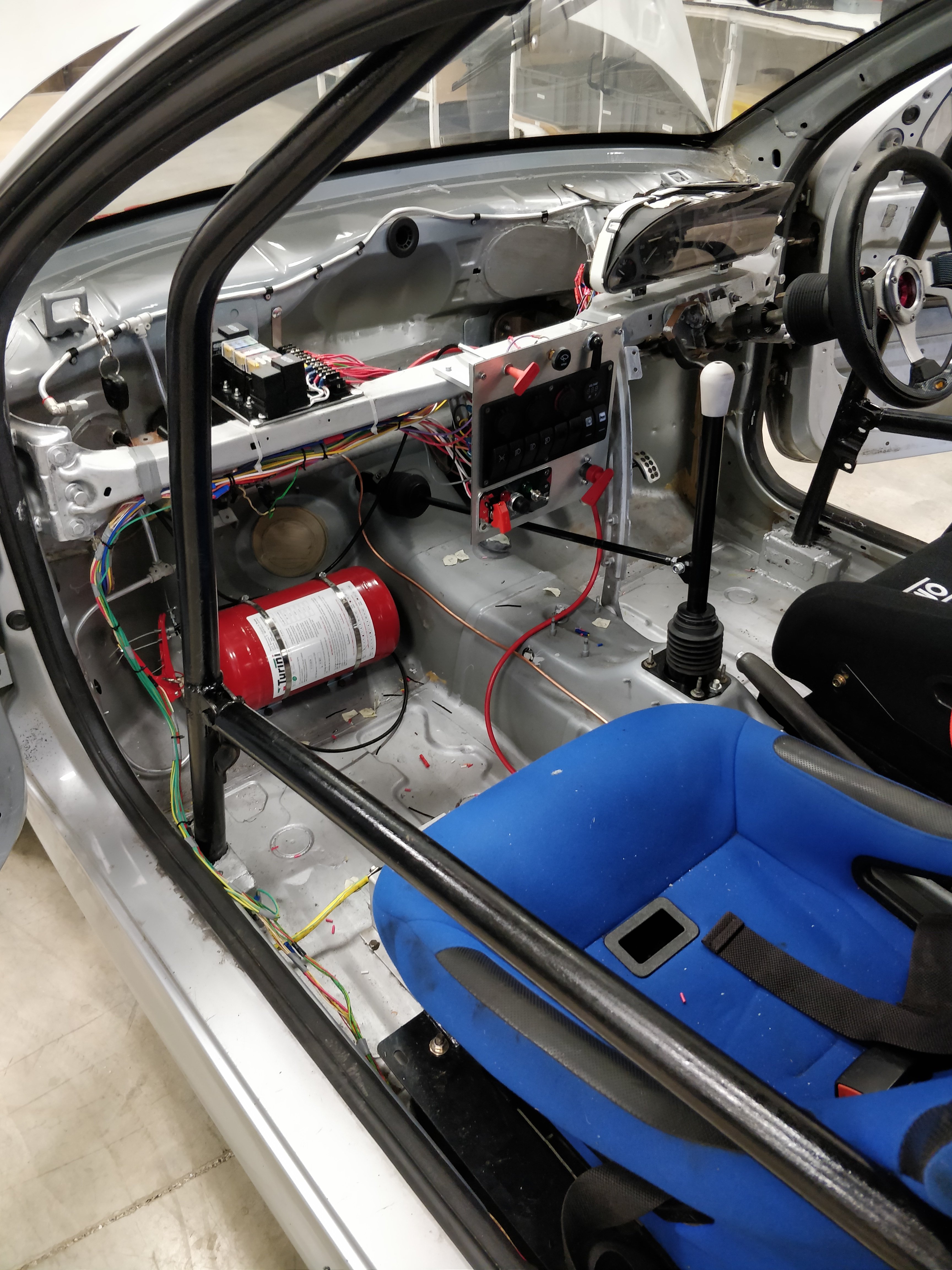

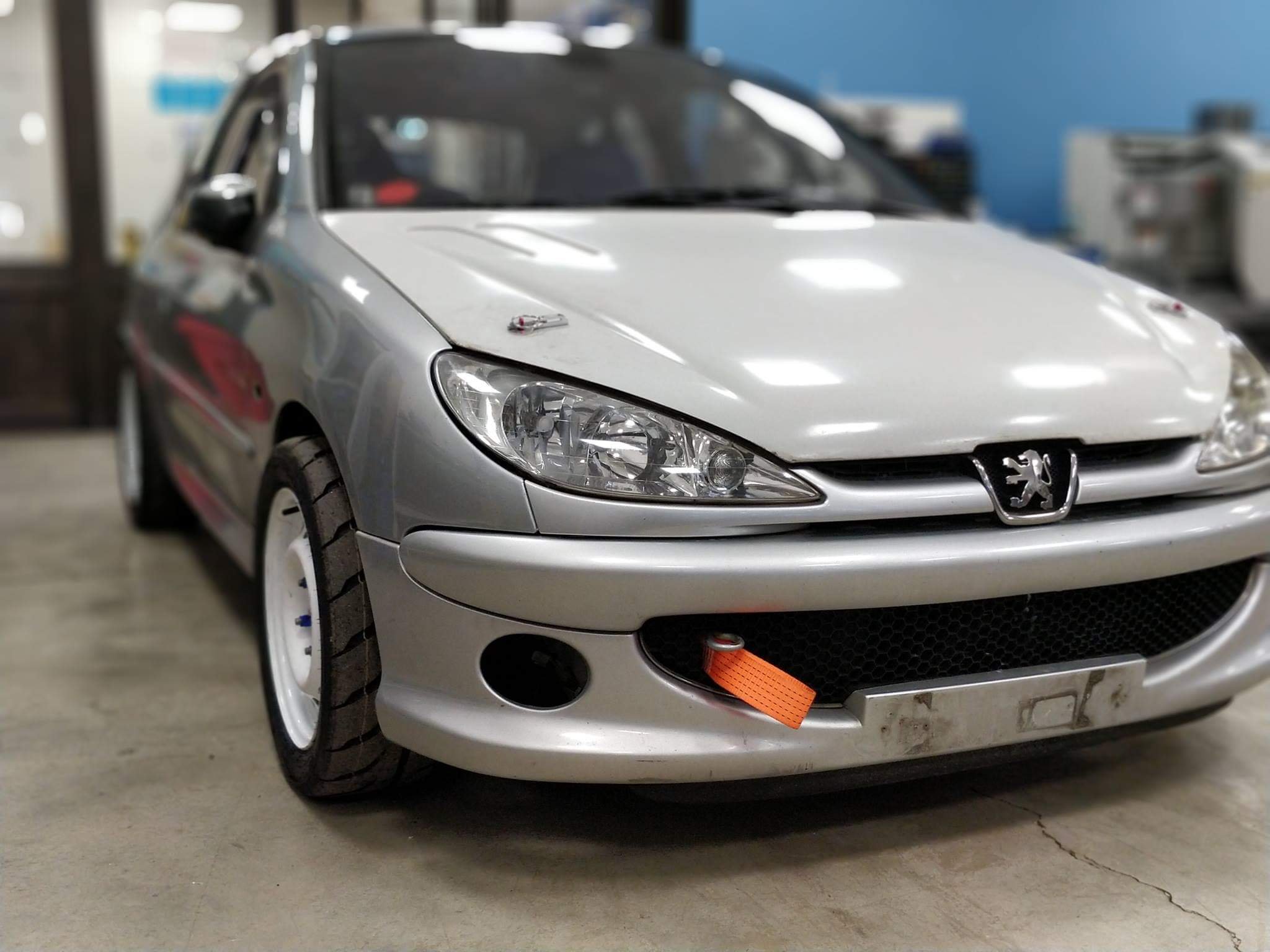

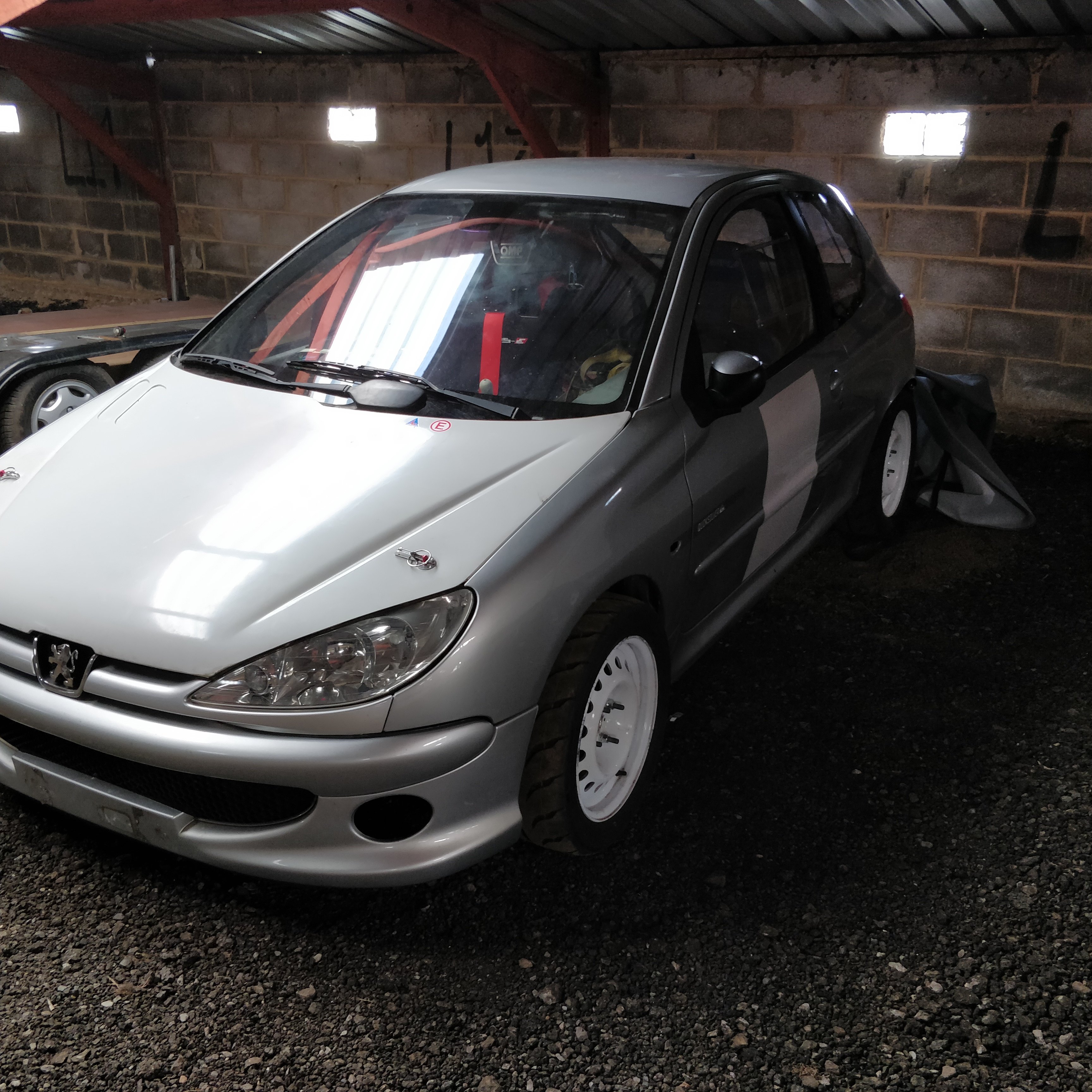

Blast from the past here. I finished this car about a month ago, result was 890kg, running a standard gti6 engine bar a mildly increased CR, bigger decat exhaust system and induction kit. I used a fuseboard from car builder solutions and have fully functional wipers and lights etc so with a cat it would pass MOT if I wanted it on the road. Engine is very responsive with RichW lightweight flywheel. Sat on C5 alloys with R888R tyres, brembo front brakes and 180 rears, carbon Lorraine pads all round. Goes pretty well

Last job to do is to roll the front arches as the wheels poke out a bit. Was going to put some universal extensions on but they looks a bit gash. Rears are rolled and look good enough.

Tom bulk of the weight has to be the interior with carpets and underlay. There was big sound deadener on the bulkhead that weighed around 8 to 10 kg on its own I reckon. Obviously glass is a good weight loss as well. My bonnet and boot are fibreglass as well. I really hoped to get to 800kg but with a blue book spec cage and seat its pretty hard, I would have to attack it with a hole saw as there are no obvious weight loss opportunities now. I will run it for a year, get the suspension and brakes right then stick the throttle bodies etc on it and start chasing more power.
