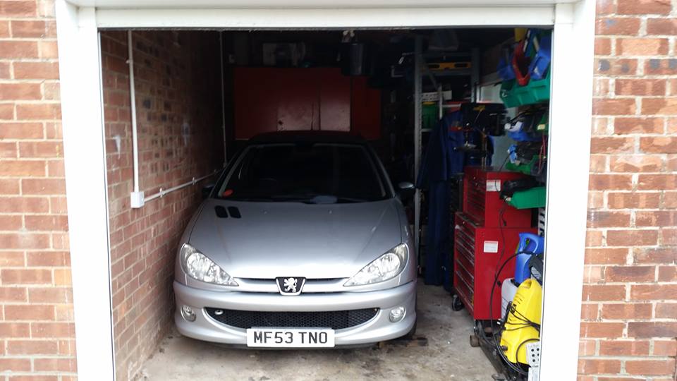

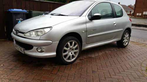

Since I will be pestering everyone for advice over the coming months I thought it right to have a progress thread. I am building a 206 GTI6 to enter (all being well financially) into the NSSCC 1600-2000cc class next year. I know everyone will say why a 6 instead of a 180 motor, my answer is why not. I know the engines, I know whats available and the only real hurdle is the top mount and downpipe which are not overly difficult. Spec will be as follows
GTI6 engine
306XSI gearbox
Pair of PeterT solid cams with solid lifter conversion
40mm ITB's (trying to retain midrange powerband and driveability)
Lightweight flywheel
305mm 4 pots up front (406 discs with CL500 brembo calipers), gti 180 calipers on rear
Suspension yet to be decided
Wheels to be decided but most likely 16 or 17 with R888 rubber.
MS management
6 point cage with harness bar and door bars
1 seat, no dash, fire extinguisher and a small control panel. Probably stack dash if funds stretch, or a coupe of small gauges for temp and revs.
Swirl pot and external pump.
PC windows and no door internals or front lights etc.
This is the car that will become a new toy.
