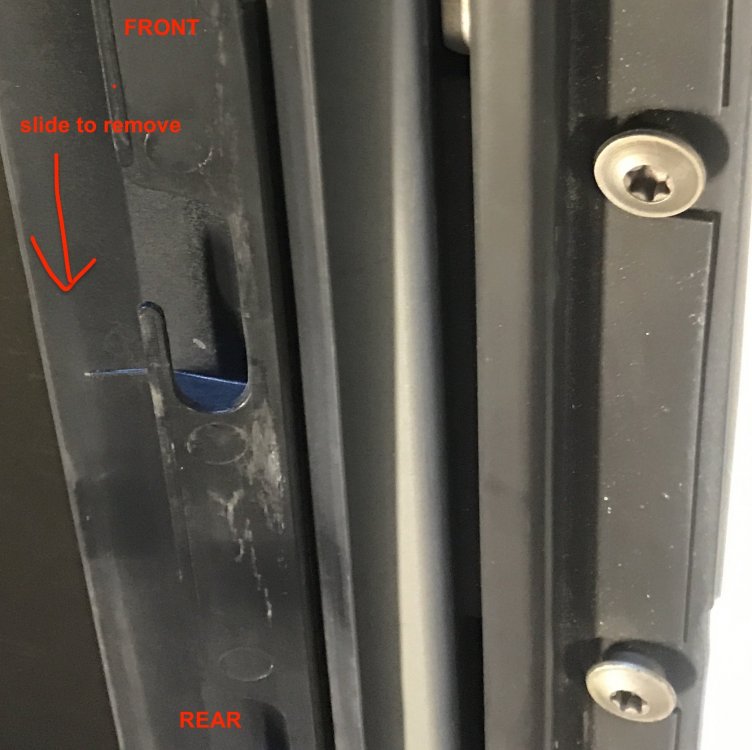

jj007205 0 Posted February 18, 2021 Just to clarify from above: To get to the bolts etc *Front plastic trim has 2 bolts accessed from inside the car (from under interior/map light area) *Trim then slides forward (careful of the little pastic tabs) *Side trims now accessible and each will have a screw *Side trims now slide BACKWARDS and secured by little plastic 'tabs' which can be VERY fragile. Don't force anything. While potentialy counter intuitive, you can gently (few mm) rock/move side to side before sliding backwards ...Suggest wd40 or similar to aid process. Hope this helps clarify. Share this post Link to post Share on other sites
