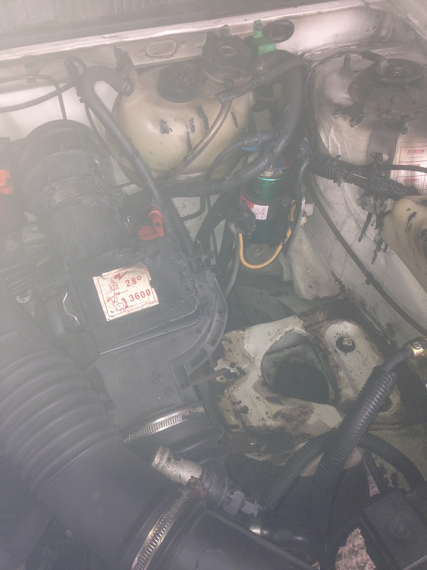

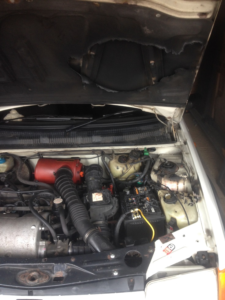

Well I popped out to the garage last week and just buy chance arrived in the nick of time as I found smoke and flames coming from under the bonnet! Bugger!!
Don't have a clue what has caused it, car has stood still most of winter last works been carried out in march last year, its been running like a dream so just been driving it since then.
Can anyone help me out for causes of my mini disaster! Is the most likely reason electrical short from old wiring? For reference the car is completely standard no tricky bits or mods.
I fear the insurance company are not going to be bothered with fixing it!!

battery terminals shorting on the bonnet, or is that dim dip/rad fan resistor left hanging there?
thats the fan resistor, which should be clipped to the radiator with a metal clip.
hard to tell, but does look like a self combusting battery for whatever reason.
Anthony
Hard to be sure when there's so much heat damage what came first, but the main engine bay loom does look to be burnt/melted considerably more than everything else making me wonder whether a short originated in there somewhere. The main power feed to the fusebox is in there which would carry sufficient current to easily start a fire and is constantly live. I have a feeling its unfused too...
Otherwise, it could be a spontaneously combusting battery as Mei says given that the main heat damage is certainly around that and, whilst rare, does happen - someone I know lost their 306 GTi-6 in similar circumstances when the battery exploded and burnt the car to a cinder whilst they watched :(

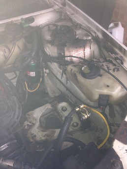

While its easy to say that the battery caused it by arcing on the bonnet, its possible it could be that black wire connected to the strut top.
I was setting my old engine up once and taking my time when that wire suddenly started smoking because it had got hot.
Just a thought as it was completely out of the blue and i hadnt touched anything wiring wise.
Is the battery damaged? Any holes in it? Does it still work?

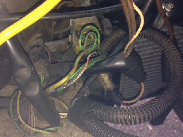

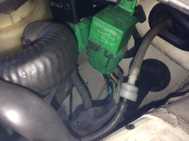

Found a suspect wire, what do these relays control? and the wire into the bottom yellow plug?
How difficult is it to replace the loom?
Anthony
The relays are for the dim-dip headlights and the air horn.
The yellow plugs are earths. Typically, all yellow and green stripe wires are earth wires on 205 looms.
