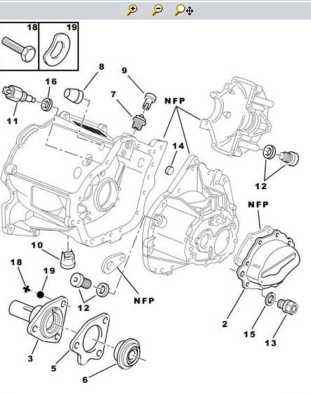

dcc 855 Posted October 14, 2014 Hey Sam Can you clear up what 217515 is? (a photo if you have 1!) As I understand the 217556 are dust protectors essentially to save the bushes as much as possible. I have offered 2 of these posted for £4, but if they're not essential and there's no need for them he could save a bit of ££ here! I do have them fitted to mine though. Share this post Link to post Share on other sites
dobboy 231 2 Cars Posted October 14, 2014 Not got service box in front me, but I thought 217556 looked like blanks/stops for the ends of the shaft, so its nylon to nylon and not metal to nylon. As my shaft is new it has open ends, so I'd rather fit them Share this post Link to post Share on other sites
welshpug 1,733 Posted October 14, 2014 they dont fit the earlier plastic bushes dan, only the later type. Share this post Link to post Share on other sites
dobboy 231 2 Cars Posted October 14, 2014 Sam, I've put in an offer to an genuine new 210535 on the bay. Share this post Link to post Share on other sites
S@m 156 Posted October 14, 2014 Ah i see, i've not seen the hollow shafts that require 217556, but then i've never replaced or seen a brand new one - all the ones i've seen are solid. Dan - I've no idea what 217515 is to be honest, on Cit service it is only lsited for BX's up to April '89, which is long before the white bushes arrived and as such they seem unnecessary - it is not listed for any other model and even Peugeot only list them for earlier 205's and 405's. I've attached the Cit diagram below but i've never seen one in person, they are #10 in the diagram. Share this post Link to post Share on other sites
welshpug 1,733 Posted October 14, 2014 oh, that's just a bung on ball pivot BE1's. Share this post Link to post Share on other sites
dobboy 231 2 Cars Posted October 14, 2014 Item 10 is the bit that pokes into the box from underneath, that the bit inside the box clicks/screws into ? (I think) Share this post Link to post Share on other sites
welshpug 1,733 Posted October 14, 2014 no, nothing goes into it. Share this post Link to post Share on other sites
