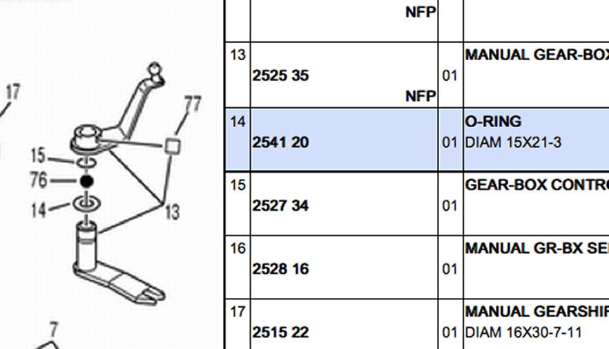

JeffR 51 Posted September 20, 2014 (edited) Regarding Item 1, be aware that the roll pin hole is not in the centre of the shaft so swapping the straight selector for the 'S' arm may not be quite that simple. If you're lucky, the straight arm may fit without a problem. If it doesn't you can remove the shaft (13) from the VTS box & fit it into the one you're using. Don't worry about the shaft falling into the gearbox-it won't. The 'O' ring will prevent that happening. What you have to ensure is that before fitting the other arm that the fork part of the selector which goes into the box is in the central position. It's easy to figure out by pushing down the shaft and turning it one way or the other and lifting it until you find the central position. Edited September 20, 2014 by JeffR 1 Share this post Link to post Share on other sites
