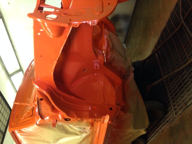

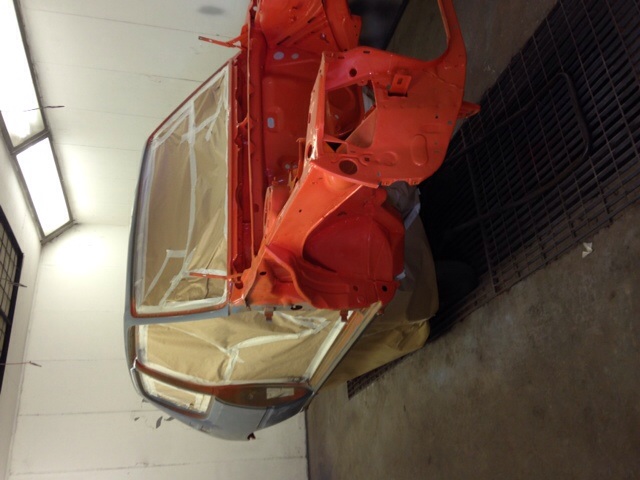

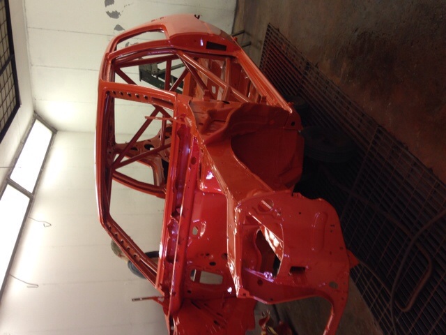

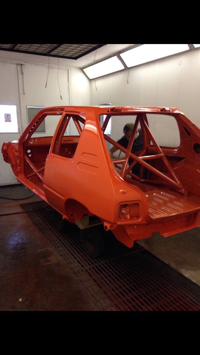

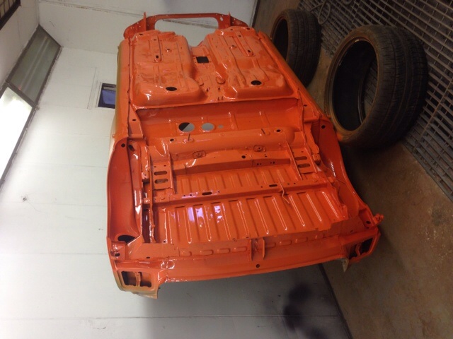

Thought I'd share some pics of my new build Tarmac 205 I bought the shell from Wales a couple of years ago and have had it stripped at Ribbletech in Preston.She then went to Triple R Motorsport for seam welding and cage fitting I opted for a t45 custom cages weld in cage once fit it went over to Rogerson of Bayhorse for a full paint job.Once she was painted I then delivered her to Newton Motorsport where we will commence the build.
Edited by hudson
hudson
Another
hudson
Anyone now how to rotate them as there the correct way when I attach them
hudson
Another sorry for the rotation issues
hudson
Another
hudson
Another

For choice of motor I'm going all steel Dry sumped 2 litre using Oreca internals and 48mm throttle body's and Dta S60 management.Suspension will be swapped from my old car three way Proflex and the gearbox for the time being will be my quaife gear kit five speed but next year once enough cash has been found I'll be going tractive six speed sequential

This looks like it will be awesome with the spec you have detailed.
Anything interesting going on with the suspension?

Three way proflex all round rose jointed front end weighing up the pro s and cons of the 309 rear beam set up

Old car I have has 205 rear beam on proflex handles great

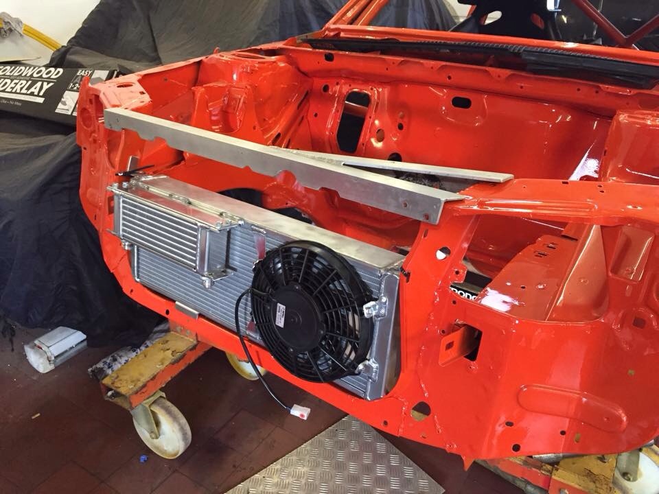

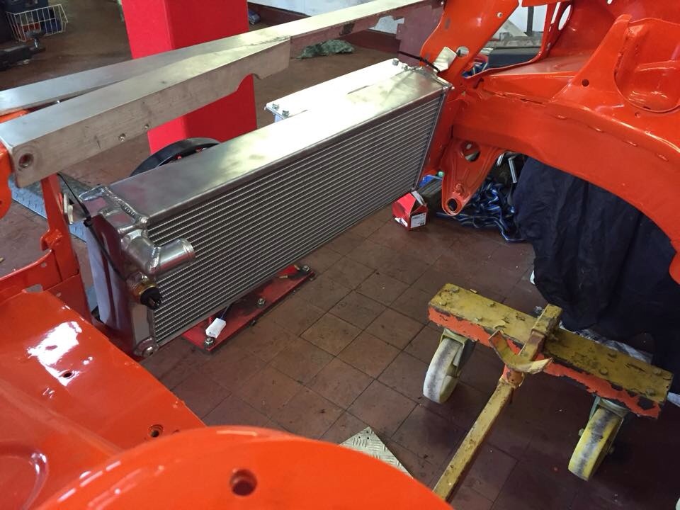

New rad and cooler from rad tech
hudson
Front view
hudson
Rear beam and pro flex rebuilt and refit yesterday ordered dta x dash as well things are coming together now
Plumbob
Looking good! Like the rad!
hudson
Having to send the cooler back as I ordered dash ten rather than twelve plus I'm opting for a larger cooler but she is a lovely piece of kit
