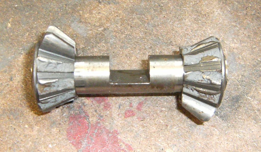

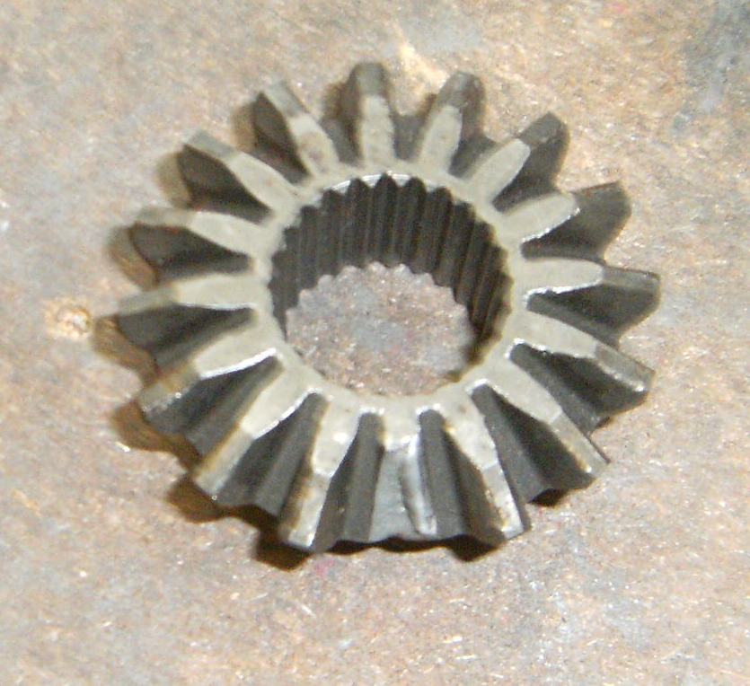

This is what happened to my TranX plate diff

If it's been on the brake tester then it stands a very good chance of being damaged, Good luck with spares now which is why I sold mine

I wonder if this is what had been done on the TranX diff I've got because it looks a lot like this when I stripped it down.
Need to try to source spares which from miles' post above could be interesting. :(
