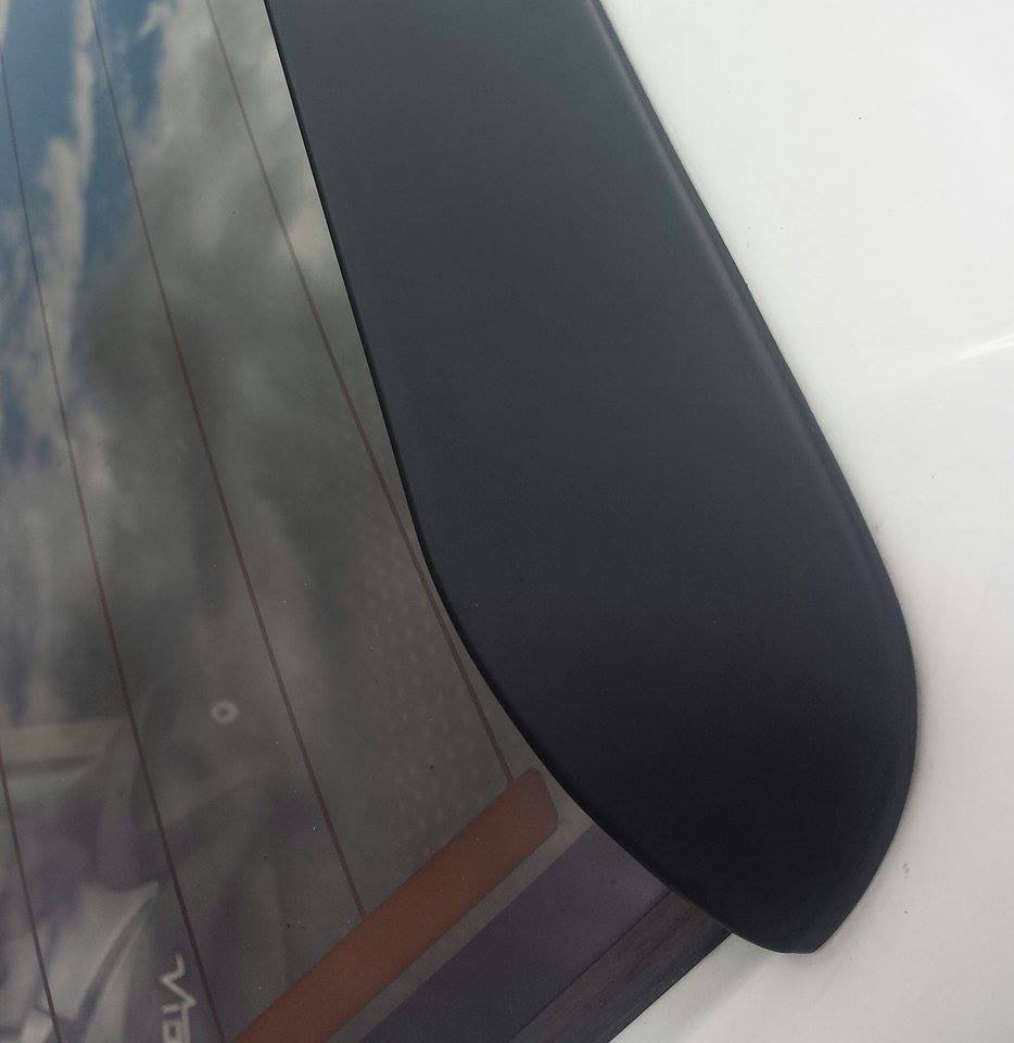

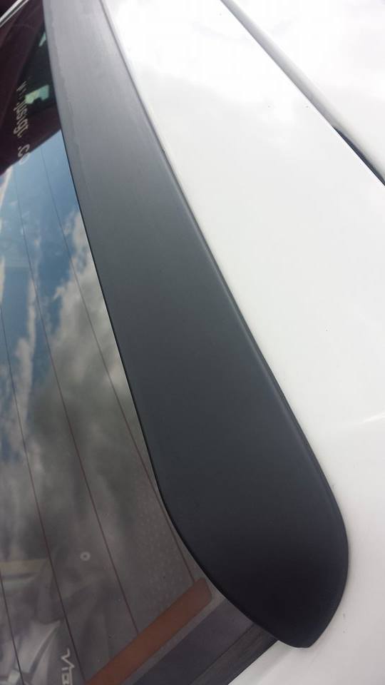

NOS spoiler on my car.
Edited by farmer
Interesting. I always assumed they must have had an obvious texture from new, just like the bumpers/arches etc, but in those photos your's looks quite smooth :huh:
farmer
Hence why I though I would add a photo.
I had black ones in the past,may contact the buyer and ask if his is smooth
