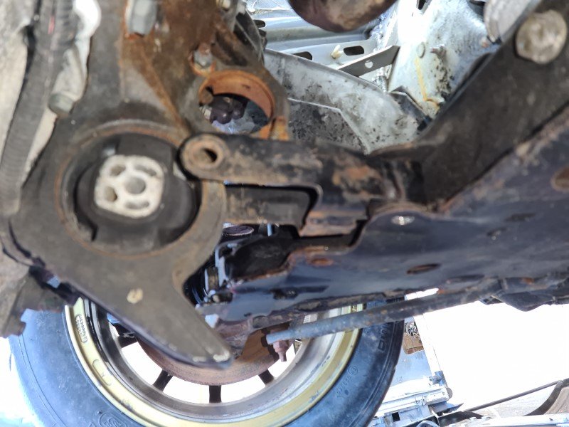

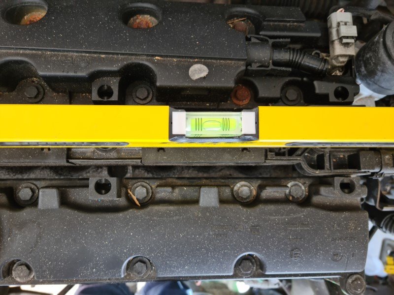

The 205 gearbox stud has worked a treat and the engine is basically completely level:

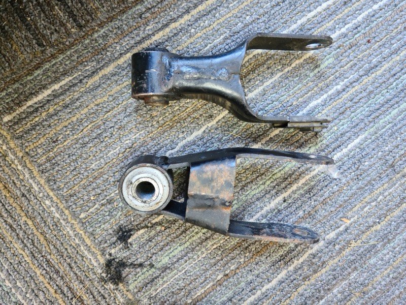

205 vs 206/307 (i can't remember which one is in the image below) mount, there doesn't appear to be much difference, except for the subframe mounting orientation:
205 mount in place with engine hanging from Satchell top mount and 205 gearbox mount, the isn't anyway the factory mounts will work:.

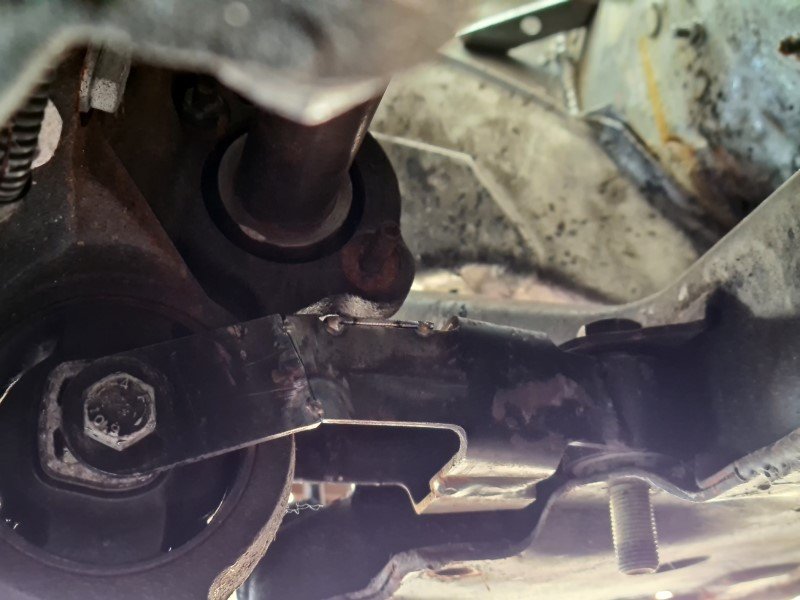

I hacked up a couple of the spare mounts and made this monstrosity, just to test with:

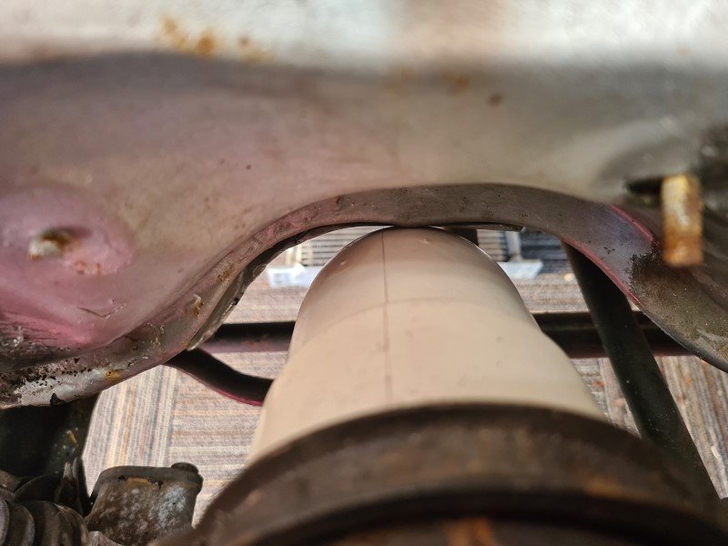

this has the engine sitting about 20ish degrees and the driveshafts look good, it also allows for the exhaust to fit in the tunnel. The manifold is the gti180, with a high precession 3inch drain pipe i had laying around as a clearance indicator:
