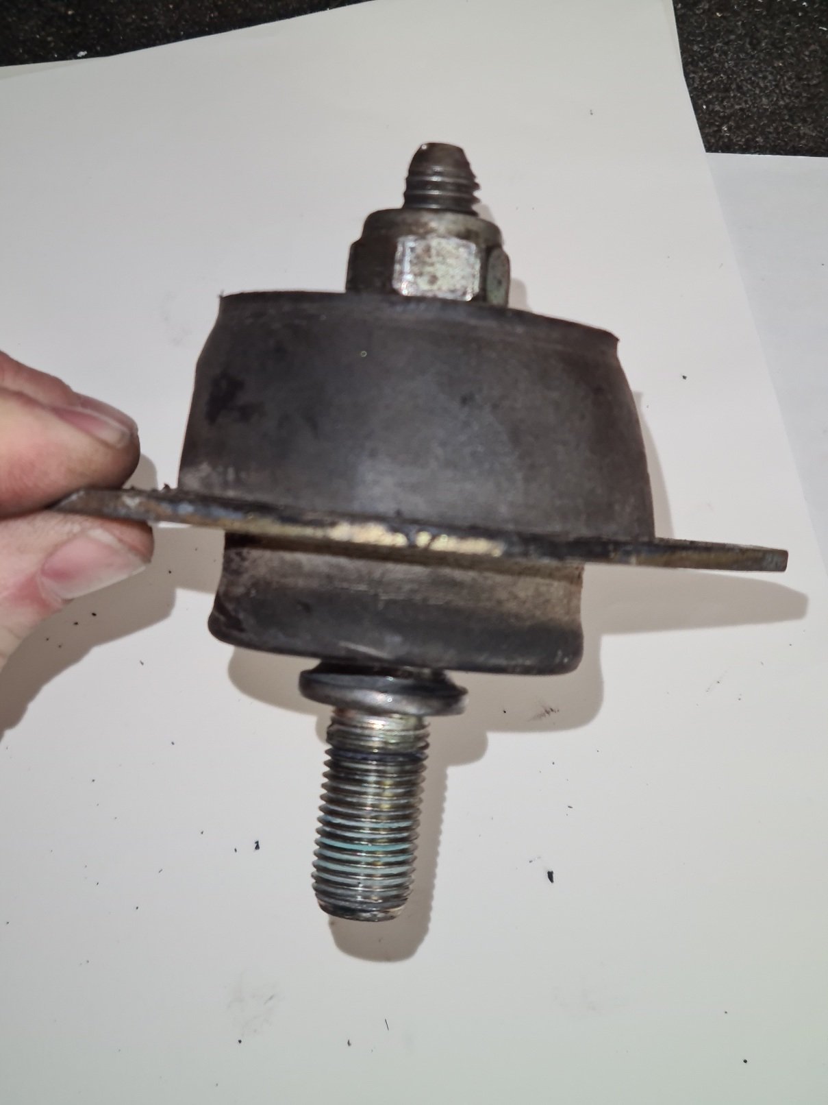

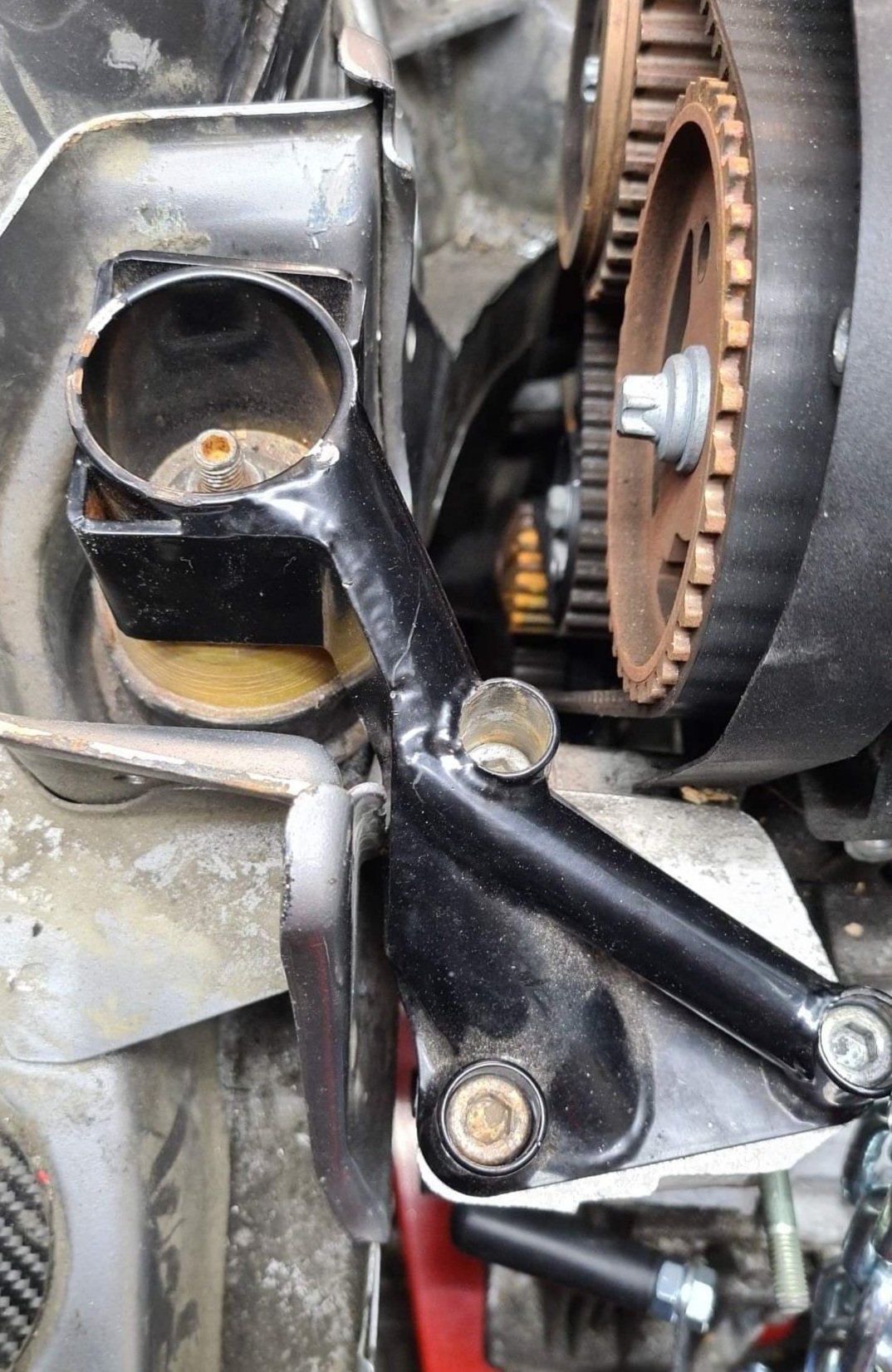

I've got one of the original Satchell EW conversion top mounts:
ABSRlIrfwBdRfycf3wMh9hYkDU81LRurStgYRjHe
ABSRlIo5XdjHP8np93EkeBfMvNiVdaUKFs2b9AMB
I've had an issue with the gearbox mount:
  • if I used the factory 206 setup/location, the bolt didn't line up with the hole for the gearbox mount when the top mount was already fitted - it was out by about 20-30mm if I remember correctly
  • If I remove the spacer bracket and put the bolt into the gearbox itself (outermost hole), the engine is angled forward and upwards on the gearbox side.
  • If I flip the spacer the gearbox lines mount lines up and the engine is level, but the diff hits the rear subframe

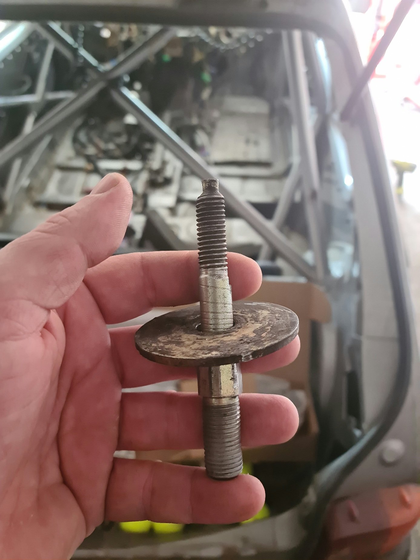

Hi Welshpug,

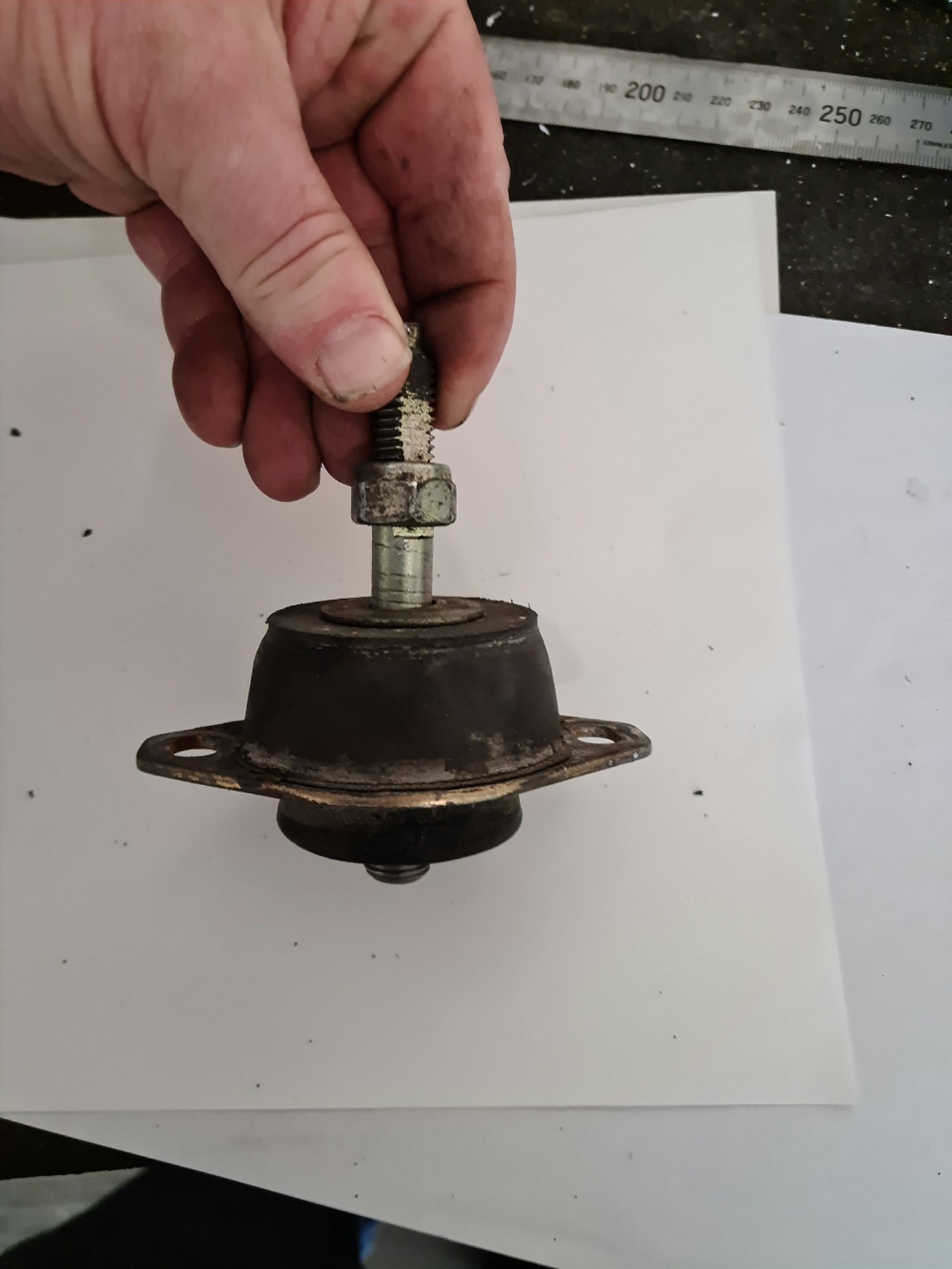

i'm assuming your talking about this one:
aswaMAPGqPxDIuTWzYMgi5m_dDdHyZ86YkHTKQGb
that's what I've been using - this might be the one from the 206 actually...

the 206/306 studs are different,  place the battery tray/mounting on the chassis leg and youll see which hole directly in the casing you need to use

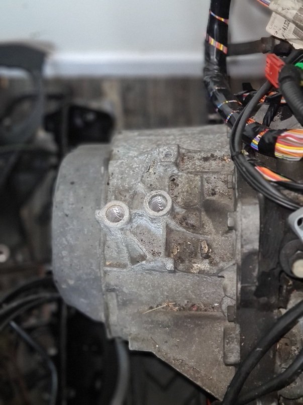

I've reattached the stud image (the washer goes underneath I know) and added a gearbox casing image. You have to use the outer most hole otherwise nothing lines up.
I just pulled it all apart and remounted everything and this time using the stud and the outer most hole it worked... No idea why it didn't on the weekend.
The engine is sitting level and looks to be straight but i haven't measured anything yet.

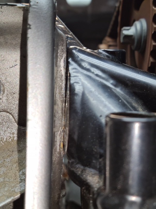

But now the top mount is rubbing on the flared seam of the top mount area, it looks like I'll have to hammer it inwards or grind it down.

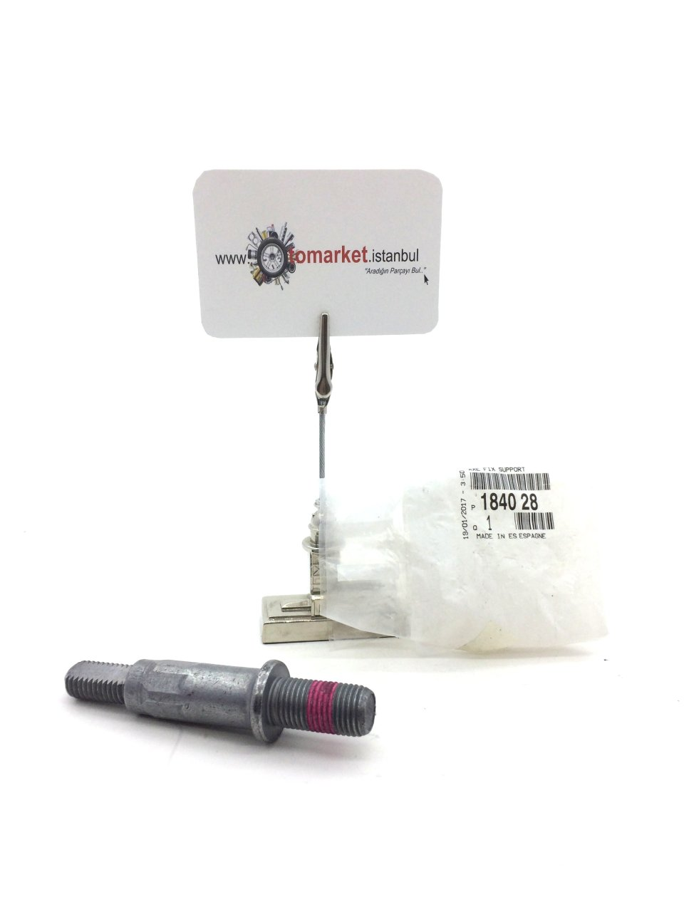

thats the wrong stud
DRTDVL
Ok, the hunt for a 205 be3 stud shall continue...
be1 is the same, 309, possibly a few others.

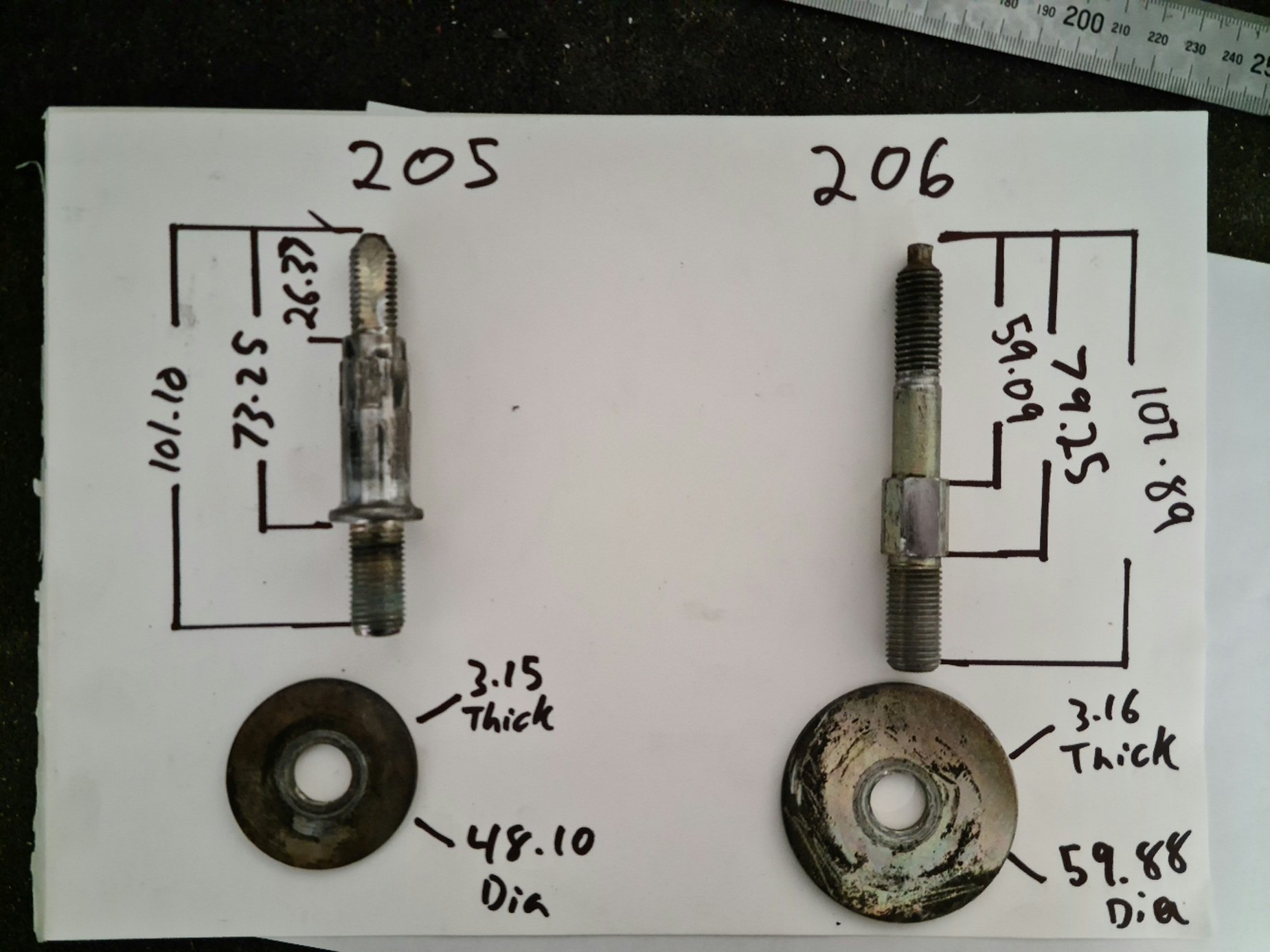

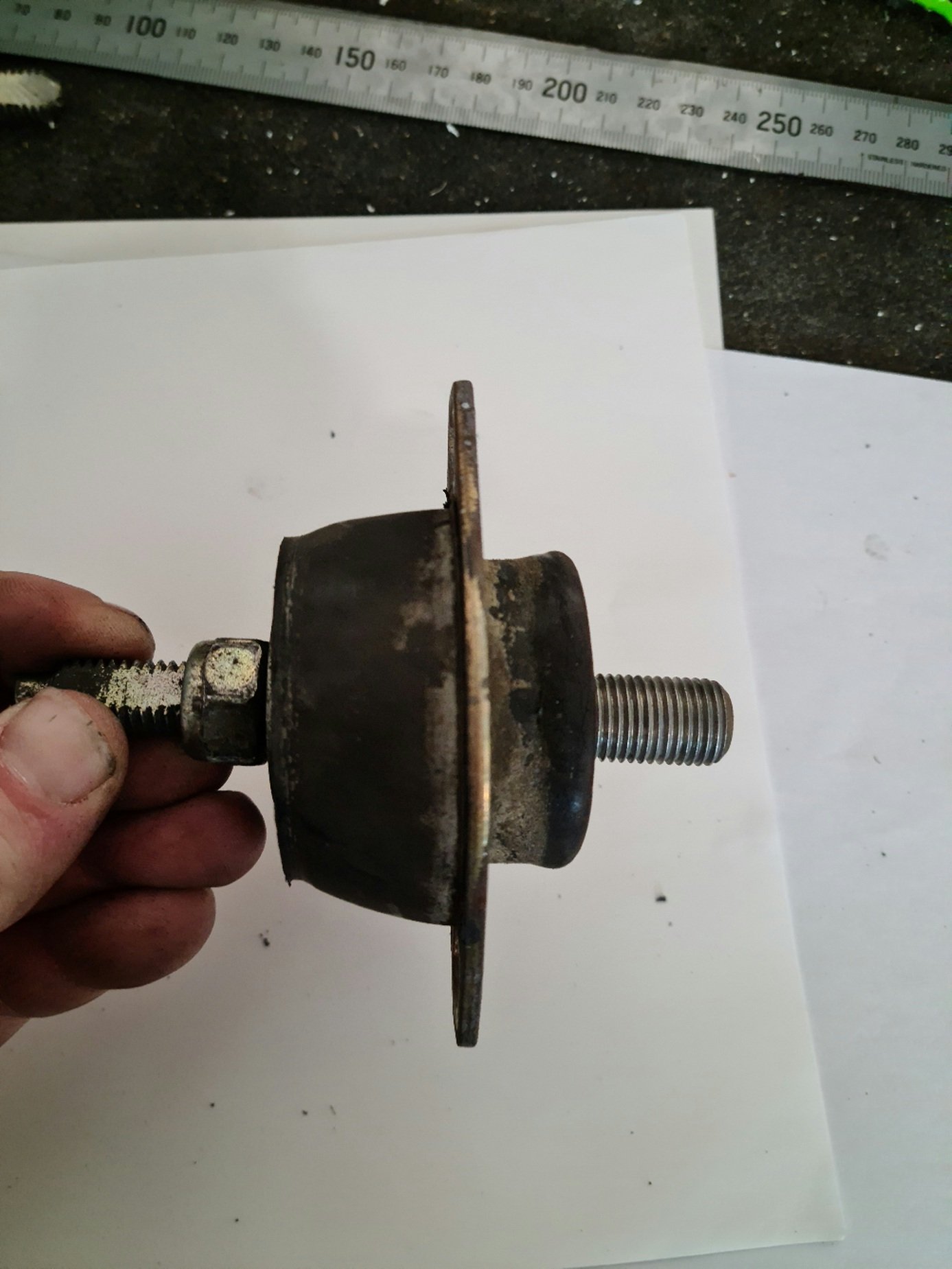

So managed to grab a 205 stud today and bolted it all up. I needed to do a few other things today, so I'll spend more time getting the lower mount sorted later this week/next weekend.
I took some measurement of the 205/206 studs, so others can see the difference.
The 206 stud slops around inside the 205 gearbox mount, where the 205 stud once the nut is tightened is firmly in place.
206 stud uses a stepped sleeve to clamp down onto, which is longer and larger o.d than the 205 stud, same as a 306,  not suitable for a 205 at all but thankfully all the 205 bits fit straight on.
