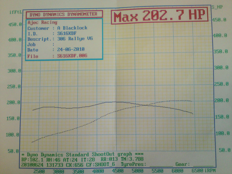

The main difference between all of these is the torque of the V6 is near enough instant. the torque of the Sc is progressive with revs, as is its power.
as I am sure you all know BHP is just a way of comparing cocks.
Just think I should add
George and I (in a very homebrew v6) along side Sarty and Dan (and nico) - the v6 had the grunt, and permitting the road was clear it would have pulled on sarty.
Lets not forget Sarty had 196ftlb, 240bhp. the v6 had 195 ftlb and 196bhp. The difference? Where the engine develops the power.
So Spiky, i am sorry I will have to disagree with you, and assure you a SC 309 will not 'pass' a v6, especially as a v6 pulls all the way to the limiter, as we found (156mph).
Cheeky Edit, but I've just found this - Obviously that's as close to a guesstimate as you'll get with it being done via a rolling road, but its pretty crazy how it makes the power from so low down!
Edited by dcc
