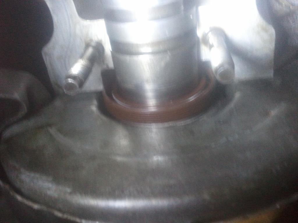

As a side note is this the correct position for the cam oil seal? it is pressed up against the cam cover as much as it will go (please see picture)
Edited by James Cornell
No. The belt side of the seal should be flush with the end of the cylinder head casting. From your picture it needs to move towards the head approx 8mm, and sit in the machined recess.

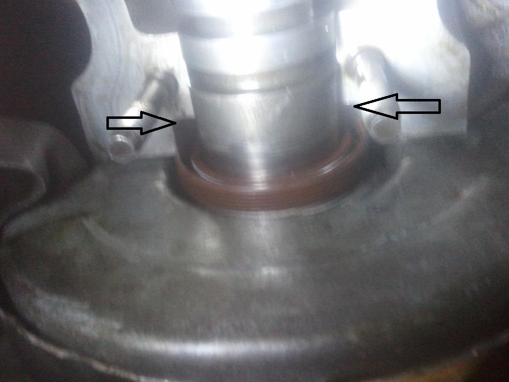

James Cornell
That is what I thought, and I believe that is how I had it originally.
Do you think this seal being in the incorrect position would cause a slow drip to come out of the engine?
(it is a pain because you can't see it with the cam shield in place)
Just to clarify it needs to be here
Slo
yes it will certainly piss through being stuck that far out. The seal does need to go into that recess but not all the way in you should have a slight gap behind it when its in the right place

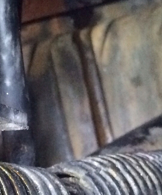

James Cornell
Can you see the line of coolant in the photo? It is coming from the top of the block and running down (almost like there is a hairline crack in the face of the block) but the cylinder head is dry
Photo really doesn't reveal much ?!
Which area is it ? around the head bolt threads ?
If all the areas around bolt threads in the block are fine/dry/without cracks , try loosening all the head bolts for a 1/4 of a turn (preferably with an T bar) and re-tighten back 1/4 ... drive for a while and see what happens .. Maybe it'll settle down after a few miles if it's gasket sealing issue rather than crack .
