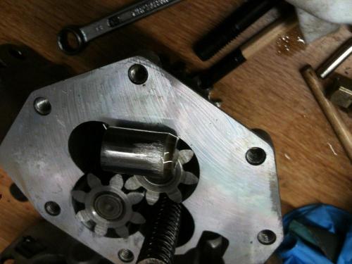

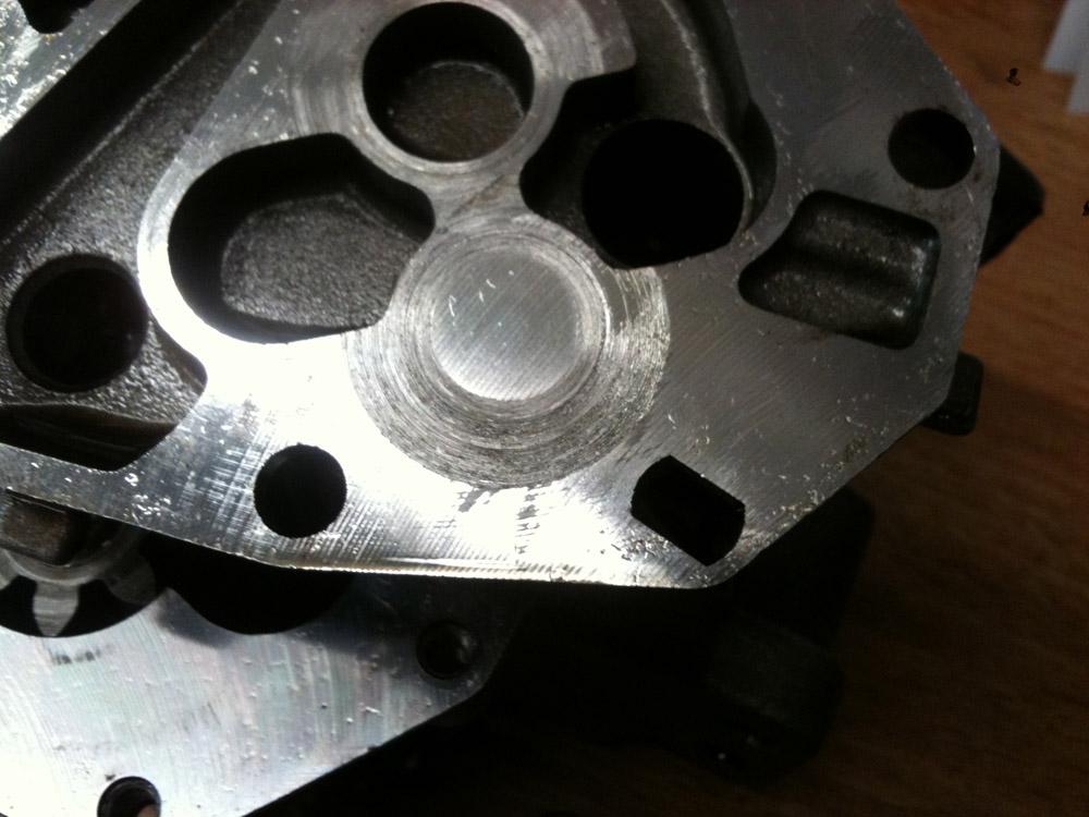

Ok then, after a hectic weekend I finally got the Sump off and checked over the oil Pump, there seemed to ba alot of silt in the sump which was a worry and when I opened the pump up I found bad things :unsure:
Bad scoring on the pressure relief piston which was stuck fast probably slightly open which was causing most of the issue with pressure, also bad scoring on the mating face where the pump cogs turn. This seems to be a lesson in not getting your block aquablasted and or being extra anal about making sure every last bit of blast media is expelled. Next on the the bearings, I'm pretty sure I know what I'll find..... <_<
