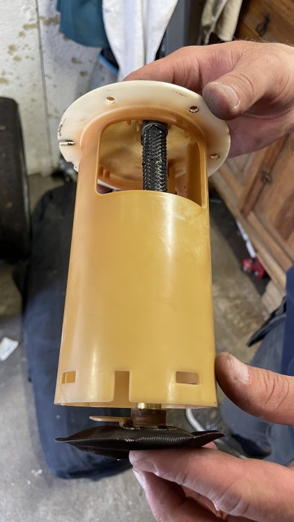

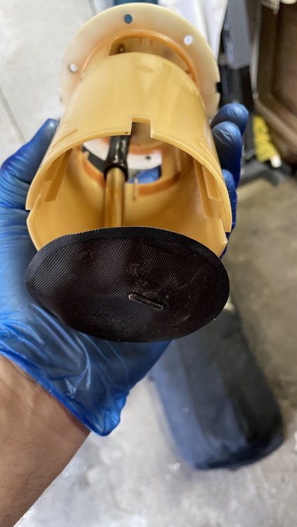

Skip 1 Posted July 22, 2021 On 7/1/2021 at 11:14 PM, barneys66 said: I run an original pump, Filter King reg and twin 45s on my 1.9 8v and don't have a return line - works just fine. Ha, clearly I've spoken to the wrong people Anyway I came up with a solution in that I removed the pump from the tube it sits in and put a straight pipe in it's place using the original filter. Works fine. 1 Share this post Link to post Share on other sites
Skip 1 Posted July 22, 2021 Here's the solution btw. Share this post Link to post Share on other sites

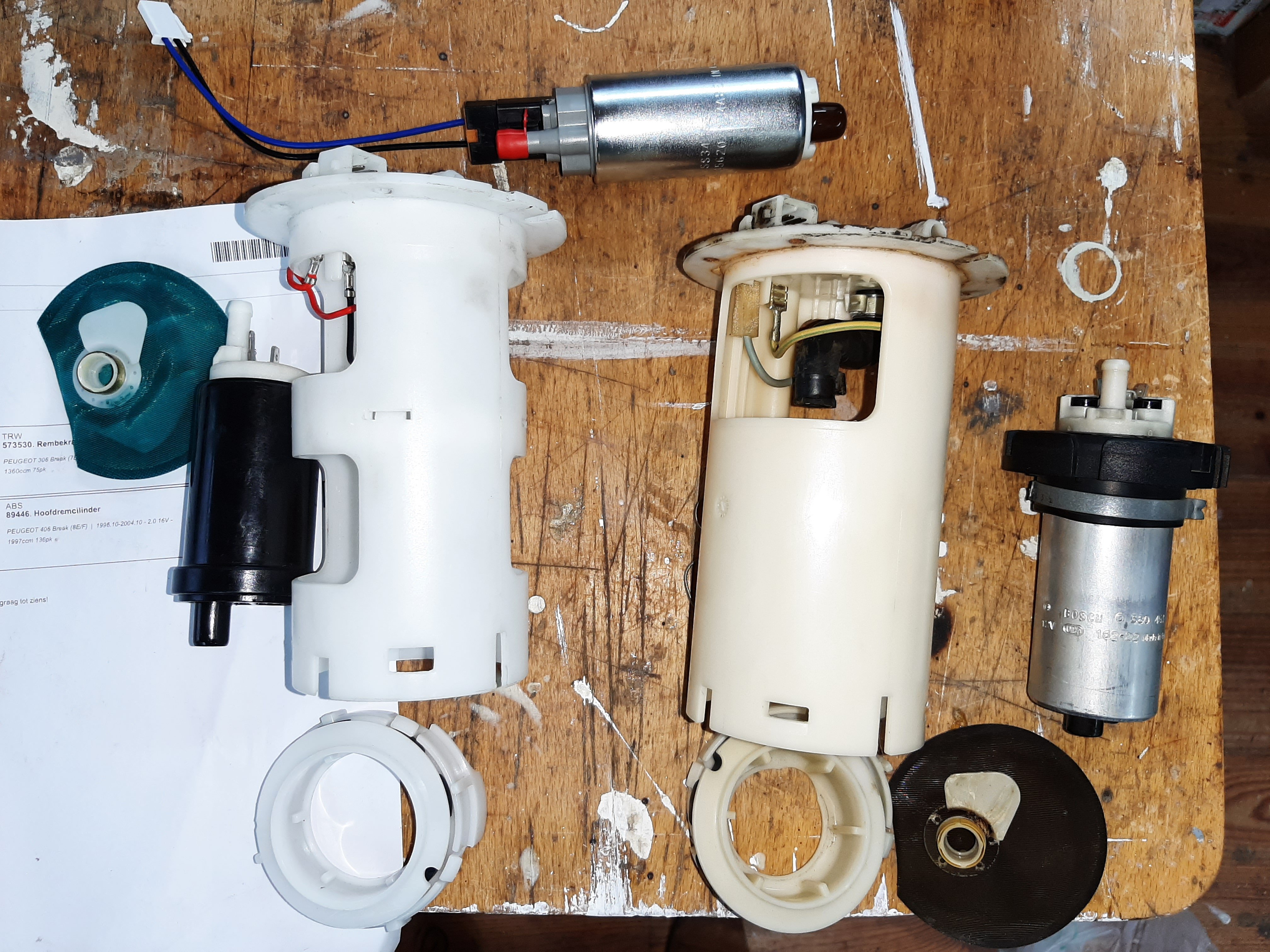

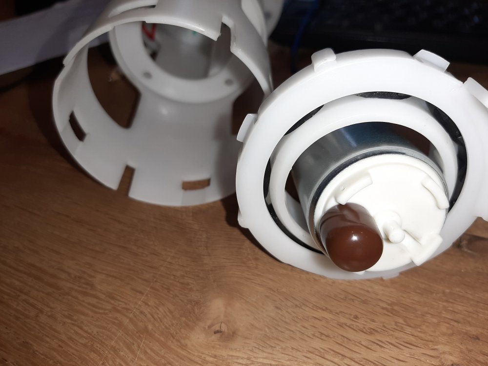

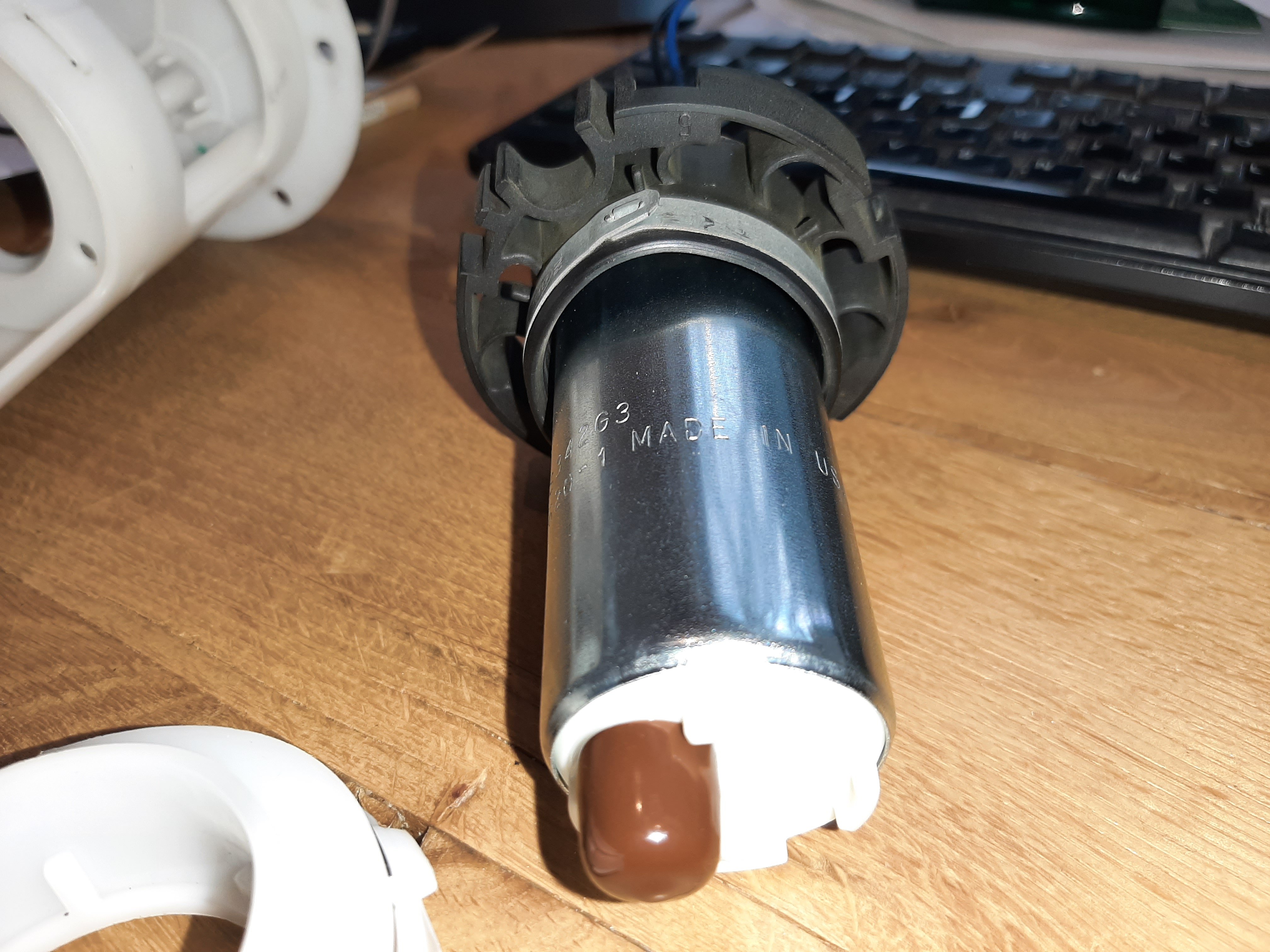

joris_andriesse 8 Posted November 19, 2021 And another bump on this topic. I just bought myself a Walbro GSS342, of which I thought it would be a direct fit in my '92 car, but not at all. In the first picture, left my new fuel pump housing and on the right side the old one. Some differences, but sizes are the same. Then on the second two photo's the Walbro pump and as you can see it's way to narrow. Any idea how this is possible and perhaps ideas for how to get it solved? Share this post Link to post Share on other sites
