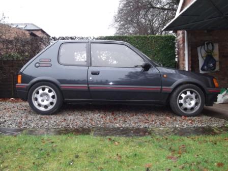

are you sure its not leaning on the stops?
got a pic of the ride height?

Dear all,
Thanks again for all your input. Here's a pic of my 205 as it is currently set up. Its sat on a slight downwards slope. After reading all of the responses, I think that I'll wait and review the situation once the 21mm bars have been put in and the rear has been raised to match the front. Might try putting my old challenge rear dampers back in (currently have a pair of 600/300 in at the moment).
Perhaps when the rear is raised, it will put more weight over the front wheels improving the understeer and reducing the 'bobbiness'.
If all this fails, I might just go back to standard ride height and try softer settings all round.
Still fancy some lighter alloys and callipers though!

Make sure the dampers are working (it sounds like your rears are dead), check the ride height at the rear and make sure there is enough suspension movement before hitting the bumpstops, then drive the car again. Then you've got a proper evaluation point.
